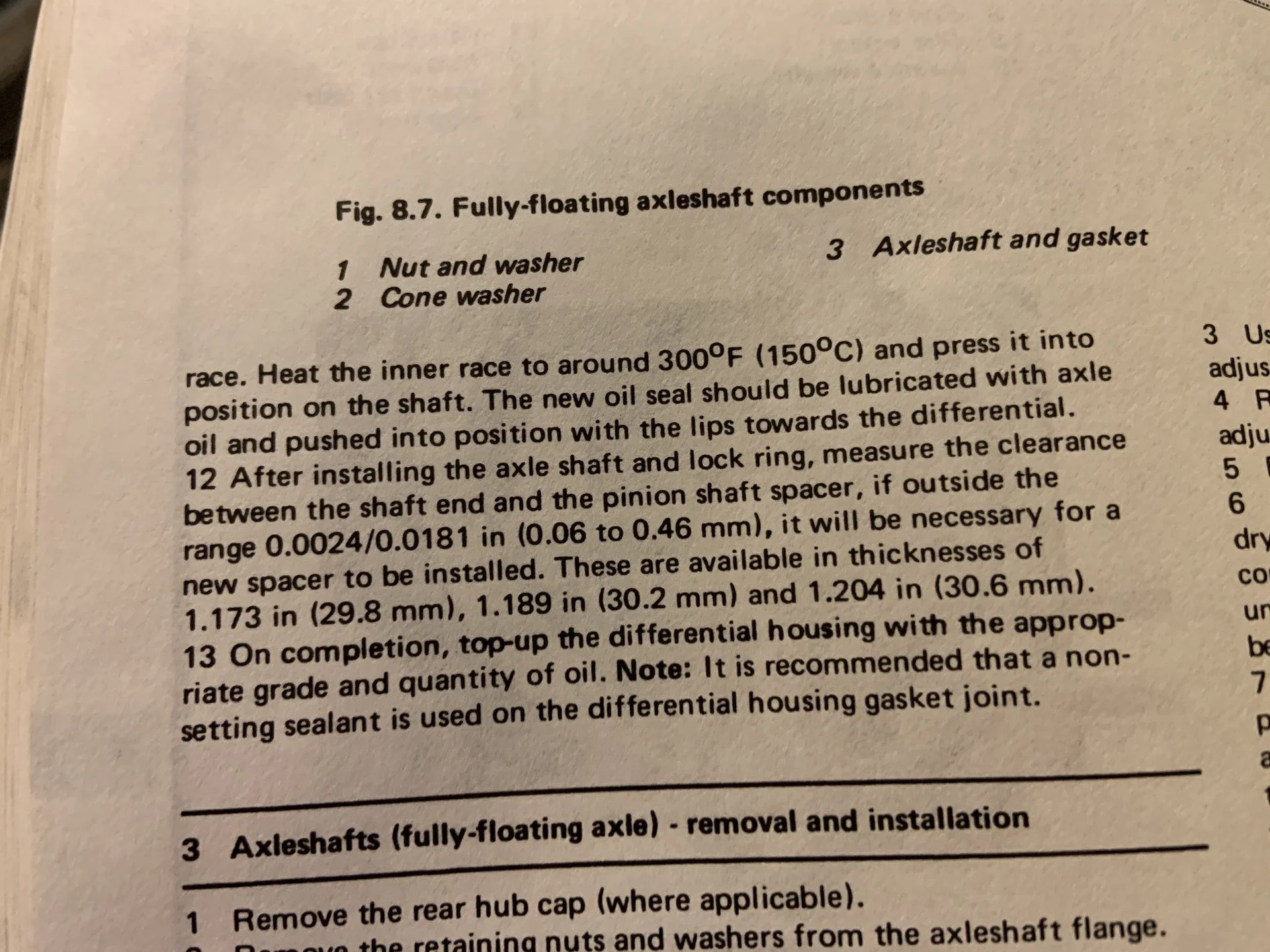

So this kept me up all night, tossing and turning. This morning got up and pulled out Haynes manual. The instructions make no mention of the washer I think you’re speaking of (#4 on the exploded diagram?). It’s supposed to seat in the axle housing behind the “outer race” portion of the bearing.(?)
I don’t understand why it would help stop oil flow if that bearing is dependent on the gear oil for lubrication and you have an oil seal on the other side. To me it looks to set the outer race and bearing at a specific location. How thick is it?
