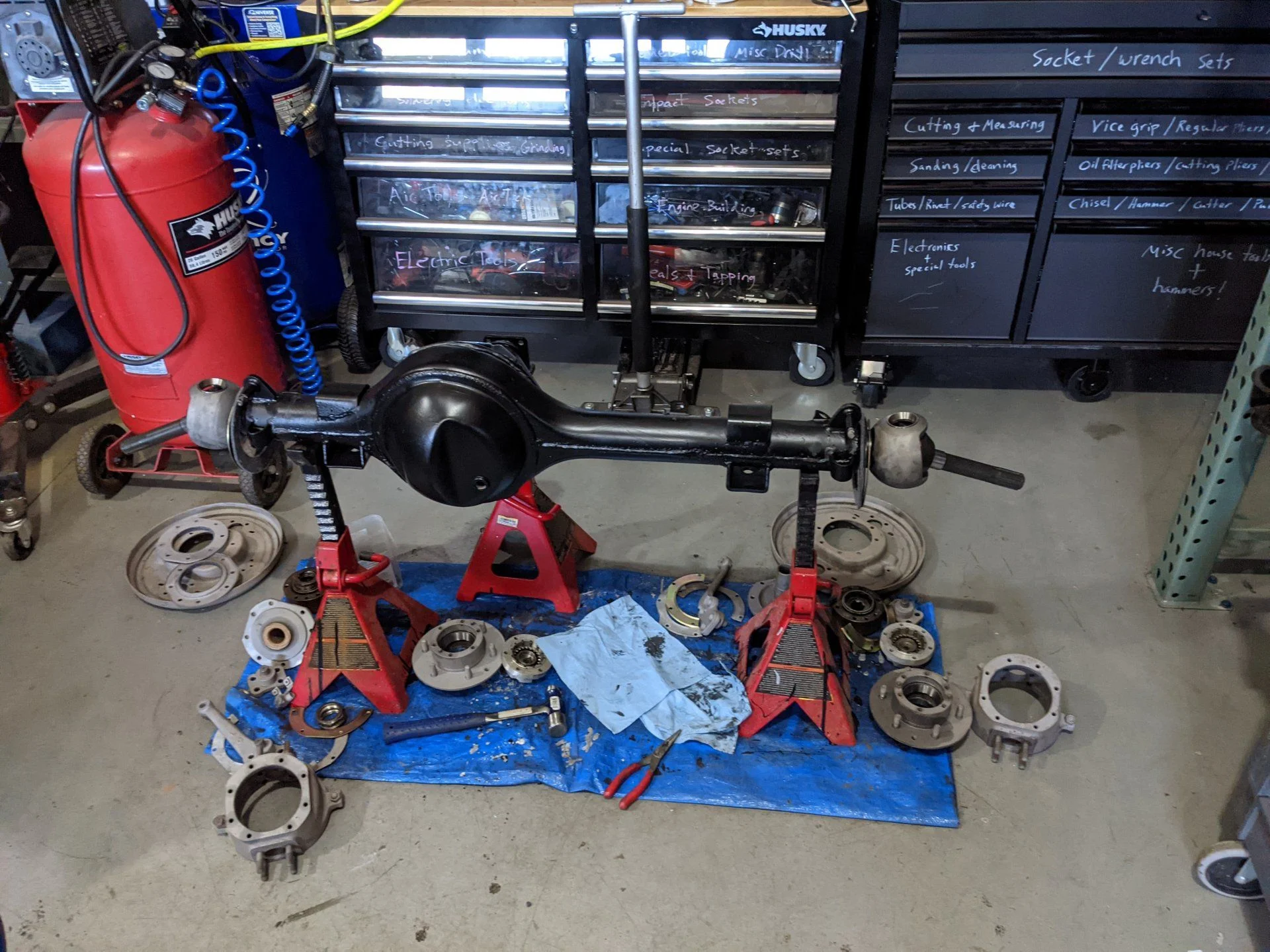

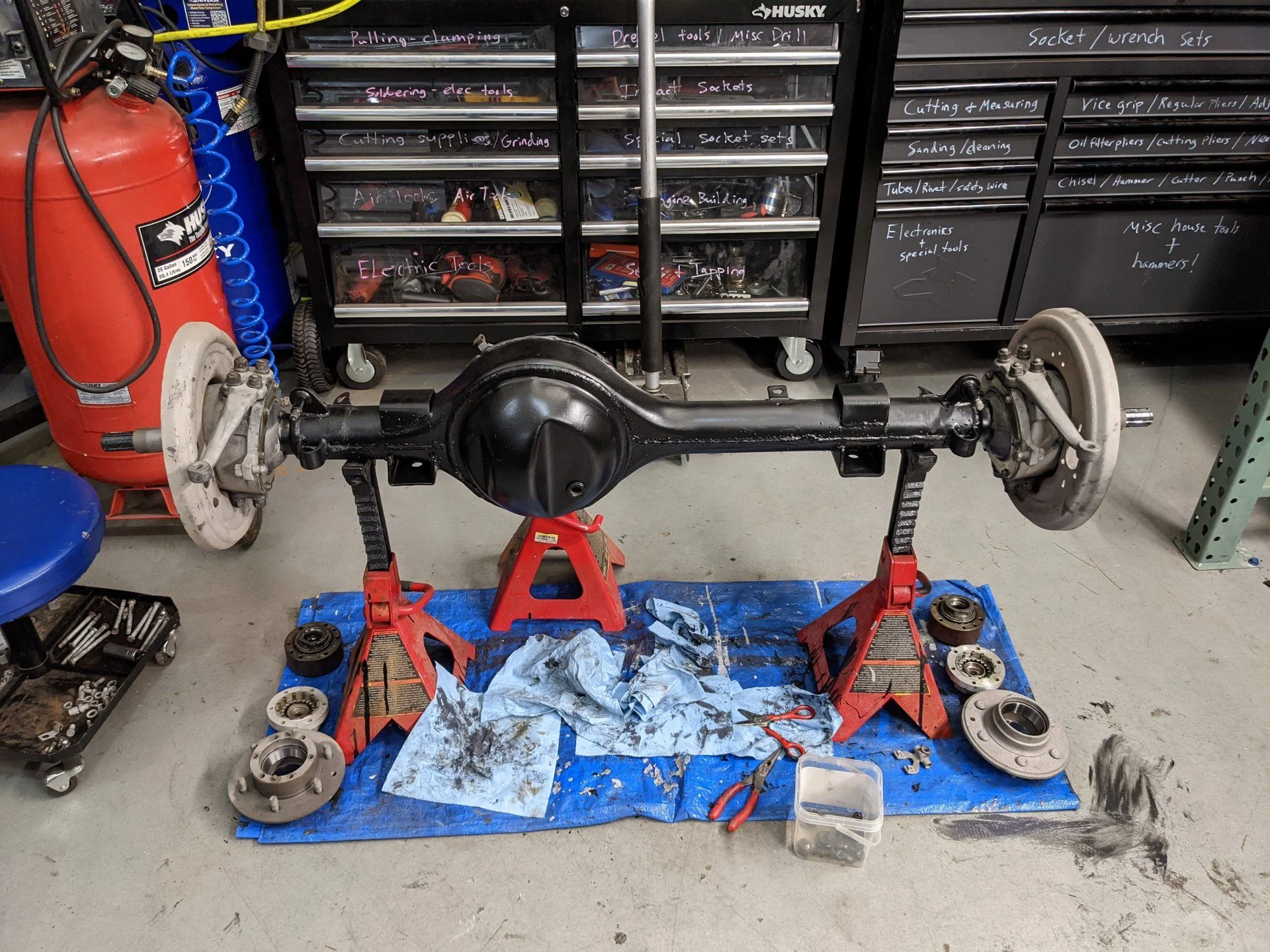

72 FJ55 rebuild begins.....I'm going to have questions
Bunch of drunk apes welded this thing.

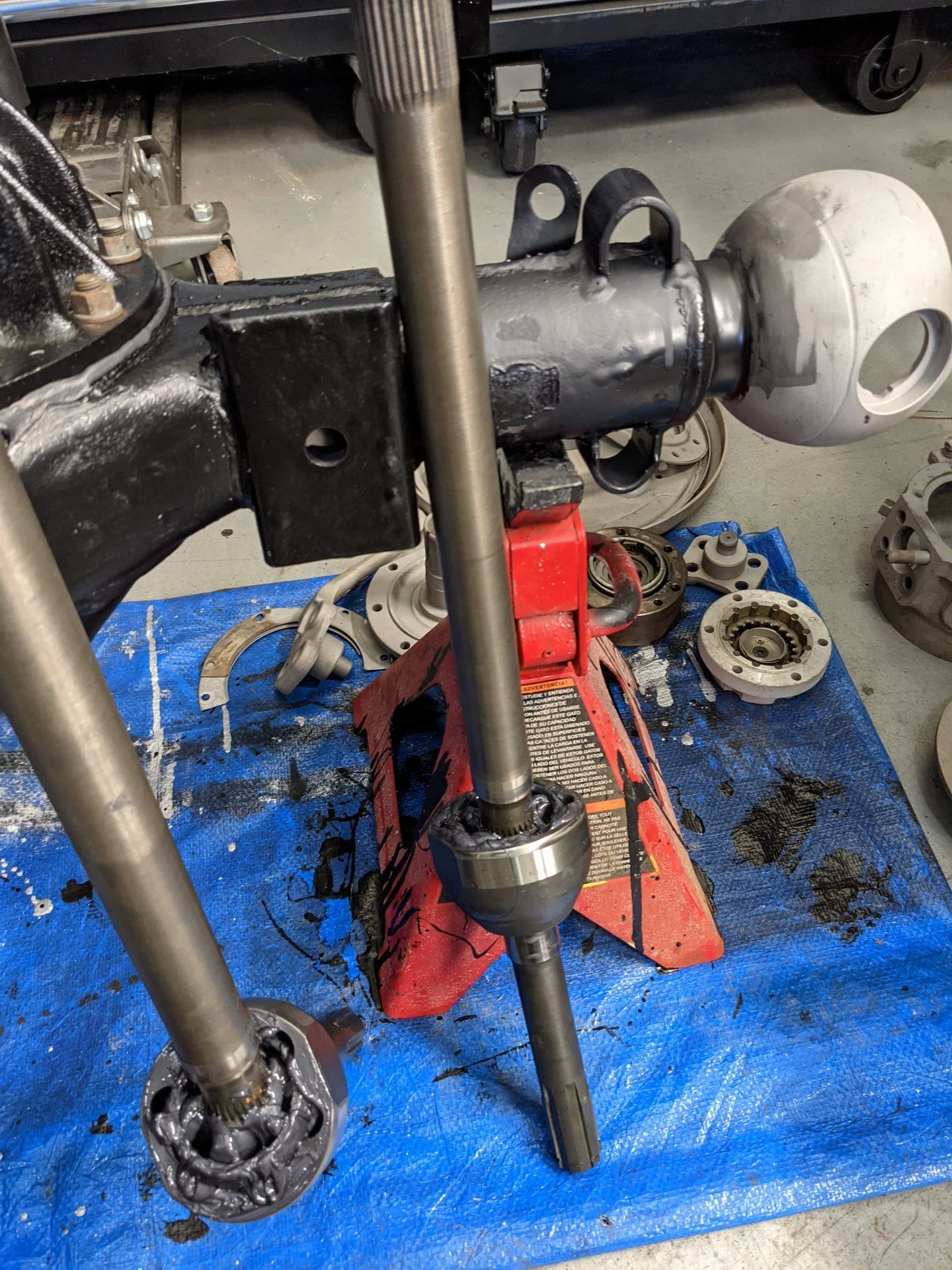

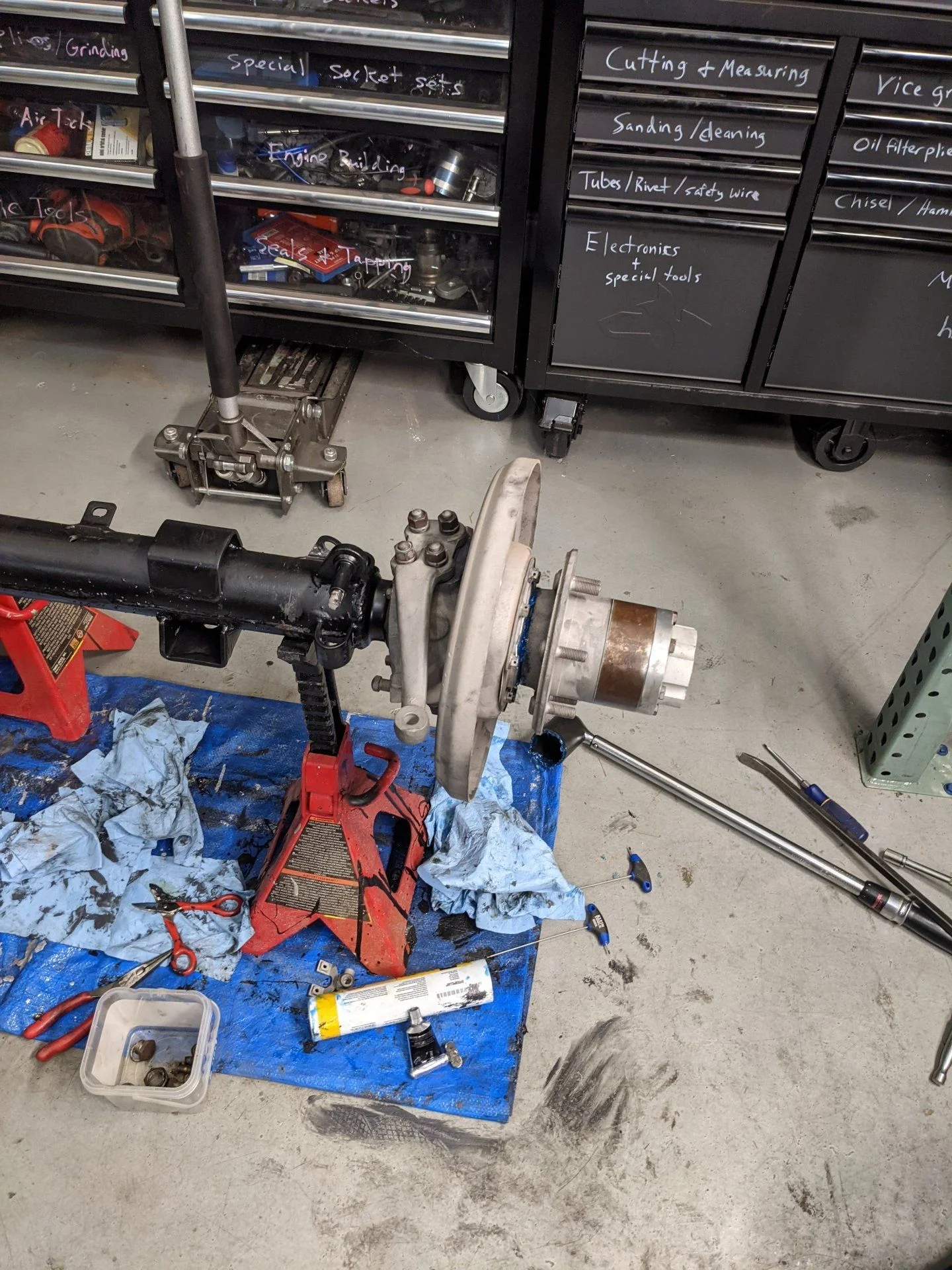

Is it me, but I'm seeing a large groove in your knuckle ball. Is that some damage due to the bearings failing?

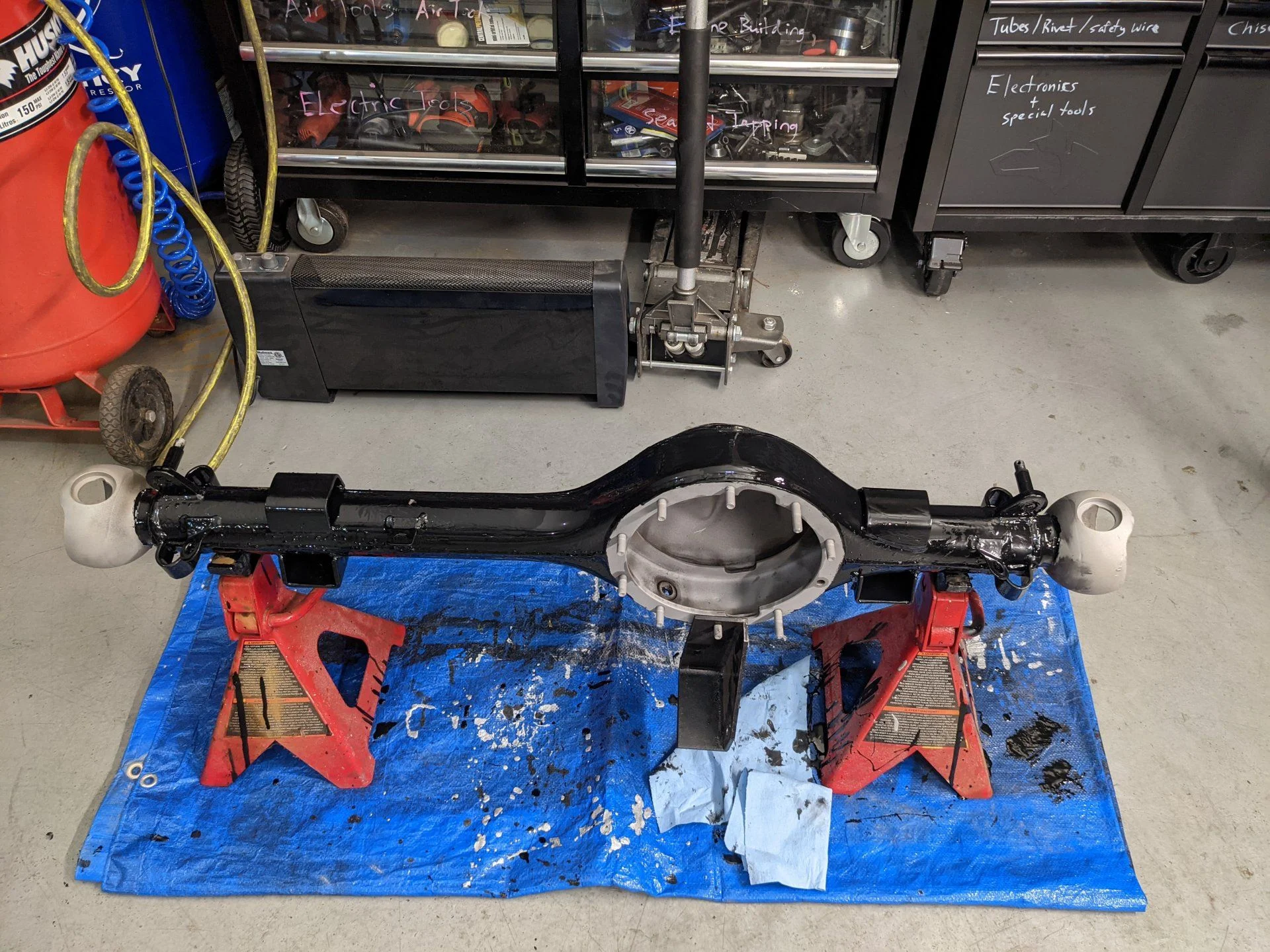

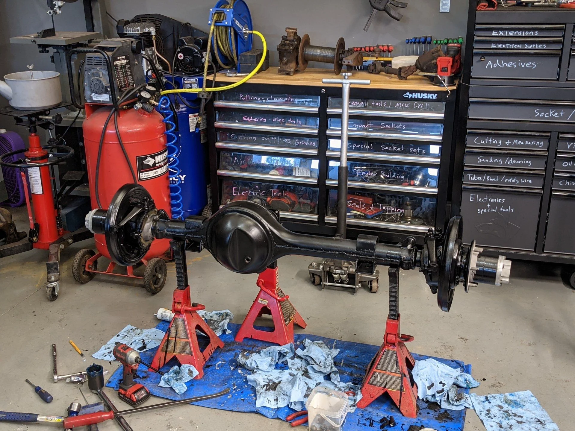

Can you share the paint you us for the axles?
I wasn't sure exactly what was going to be exposed and what wasn't, plus that paint is THICK so if you get it on a mating surface area I just didn't want to deal with it. Stuff that is on the inside sealed with grease I'm not worried about.
