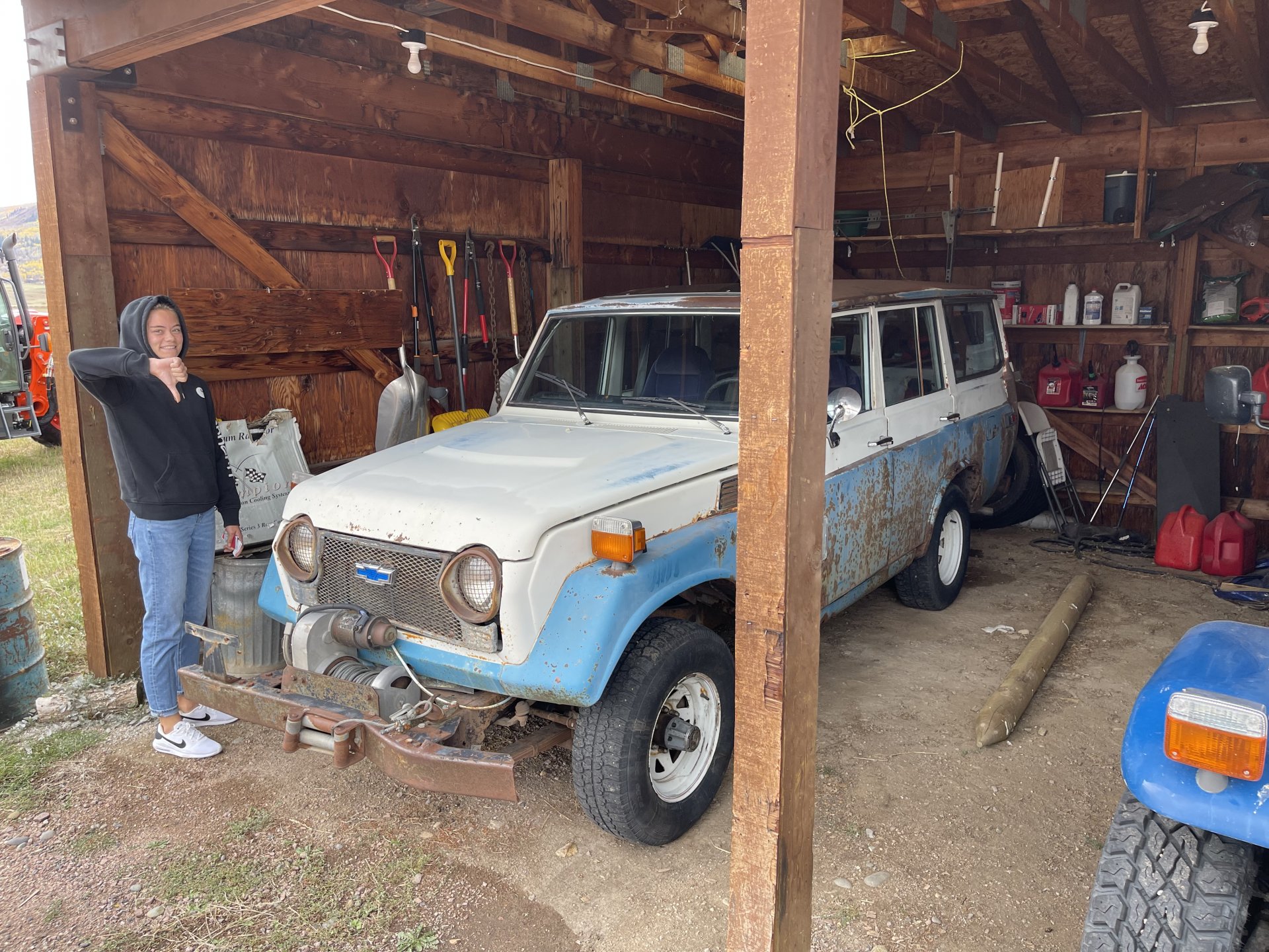

Then the daughter and I just drove the parts pig to another barn couple miles away so I can dismantle it. This after I had to install new fuel pump this week. The daughter really enjoyed it…..

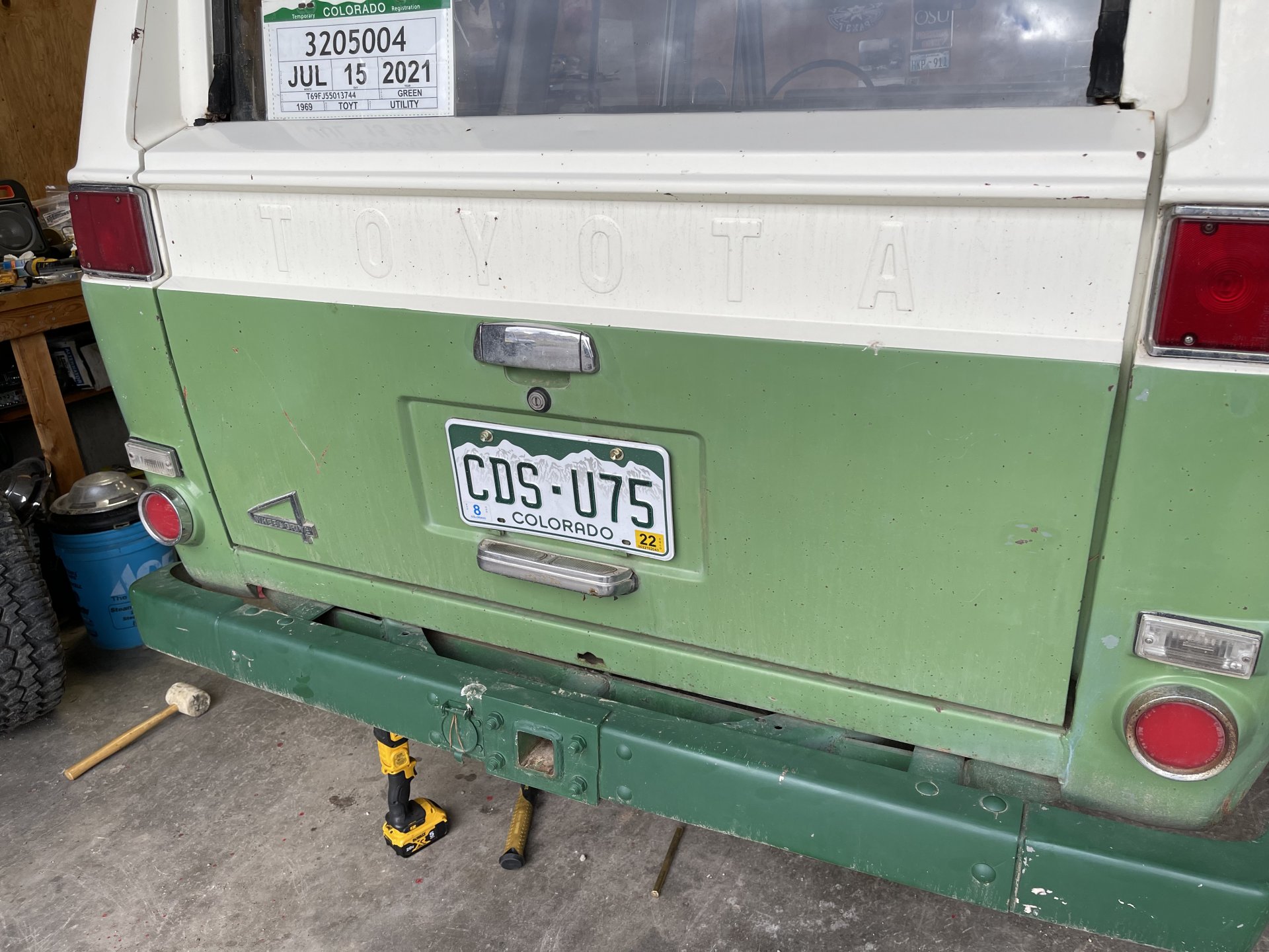

Maybe I should reword this, when she gets her new paint I am entertaining painting the TOYOTA on the tailgate. Background will be Cygnus white.
Curious if this was ever standard. Personally l love highlighting the fact it is a TOYOTA.
No but that shouldn't stop you. It's one of those things that seems obviously correct even though Toyota didn't do it. Kinda like having white door jams top to bottom so you get this weird vertical stripe effect in the middle of the contrasting body color. You just ask yourself why did they do that?
Funny you say that. Wife specifically told paint guy to not do that. Frankly I had never noticed it.

You nailed it in 1st sentence!! Highlight your letters 😉

I hope to build some wood blocks tomorrow to jack of the donor pig so I can start the process.

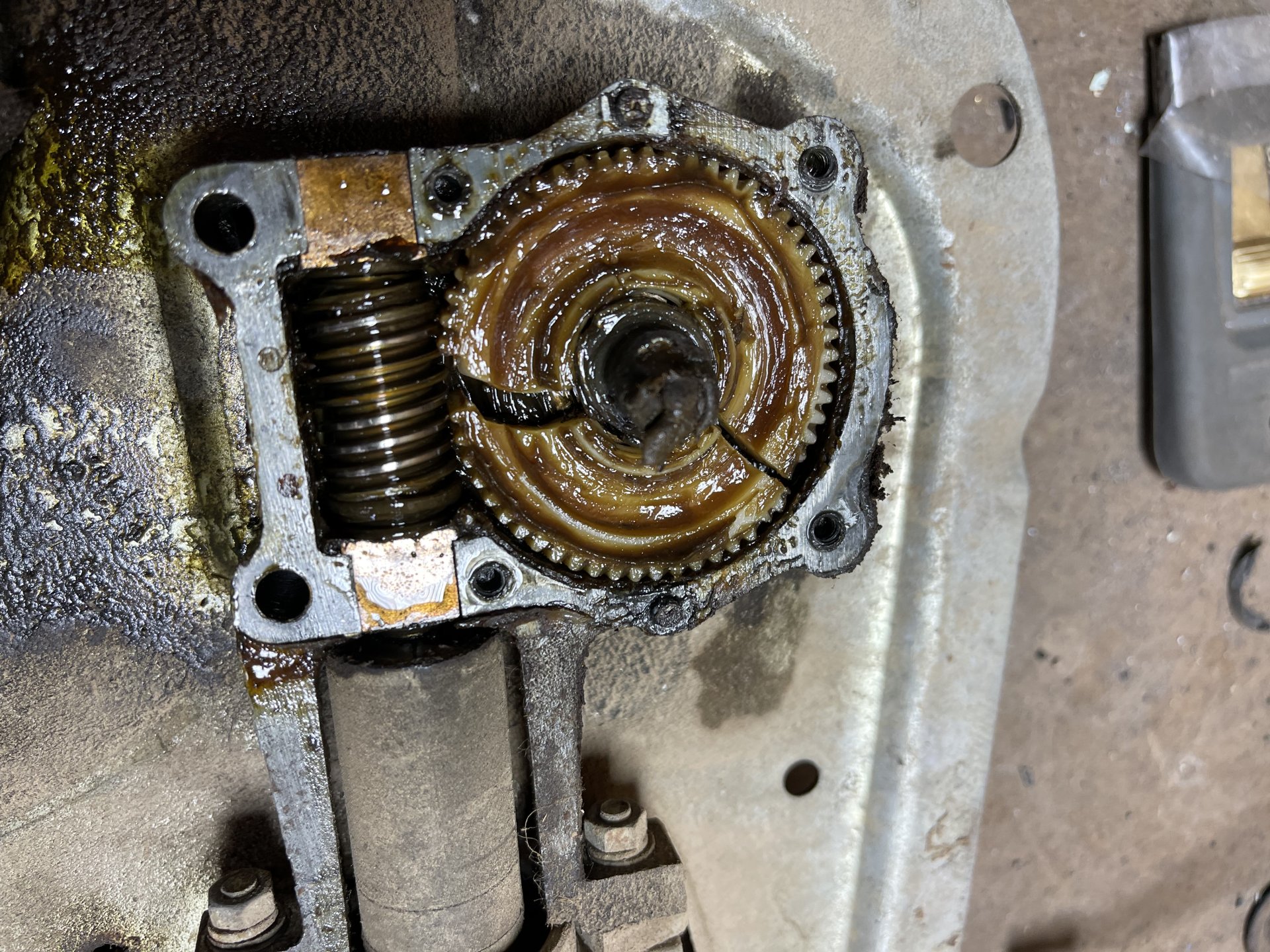

Spent day trying to get the back window functioning, problem was window was up so couldn’t open the tail gate. Working from inside and with some assistance from @PabloCruise i removed the gears and worked the arms off the tracks attached to the window.
With window down I lowered the tailgate and proceeded to figure out what the hell was going on.
Opened up the gear box and of course the gear was crap. This was replaced and I proceeded to get it back together. Before I put the gear set up back in the tailgate I confirmed motor worked with another battery.
Once back in I wired everything back up and nothing would work. “Well f***” I said, unwired things isolated just the rear window control and nothing. Went the other way although I had little confidence the front switch would work after looking at wires going to tailgate. They appear crimped and a few bare wires are showing. With the motor now directly wired to the front switch and the wife pushing on the safety switch things came to life. Of course it had hard time going down past half way.
The wife had some difficulty understanding what the heck I was asking about noises we were hearing and eventually I found found the felt on drivers side was bunched up preventing the window from coming down. Then I sprayed copious amounts of silicone spray around things to see if that would help.
The window now goes up/down without any issue but I’ve got to figure out the rear tailgate switch. Where the wires all come together in the tailgate I’ve got to replace the small board they attach to as it’s broke in half. Hopefully city racer has another.
