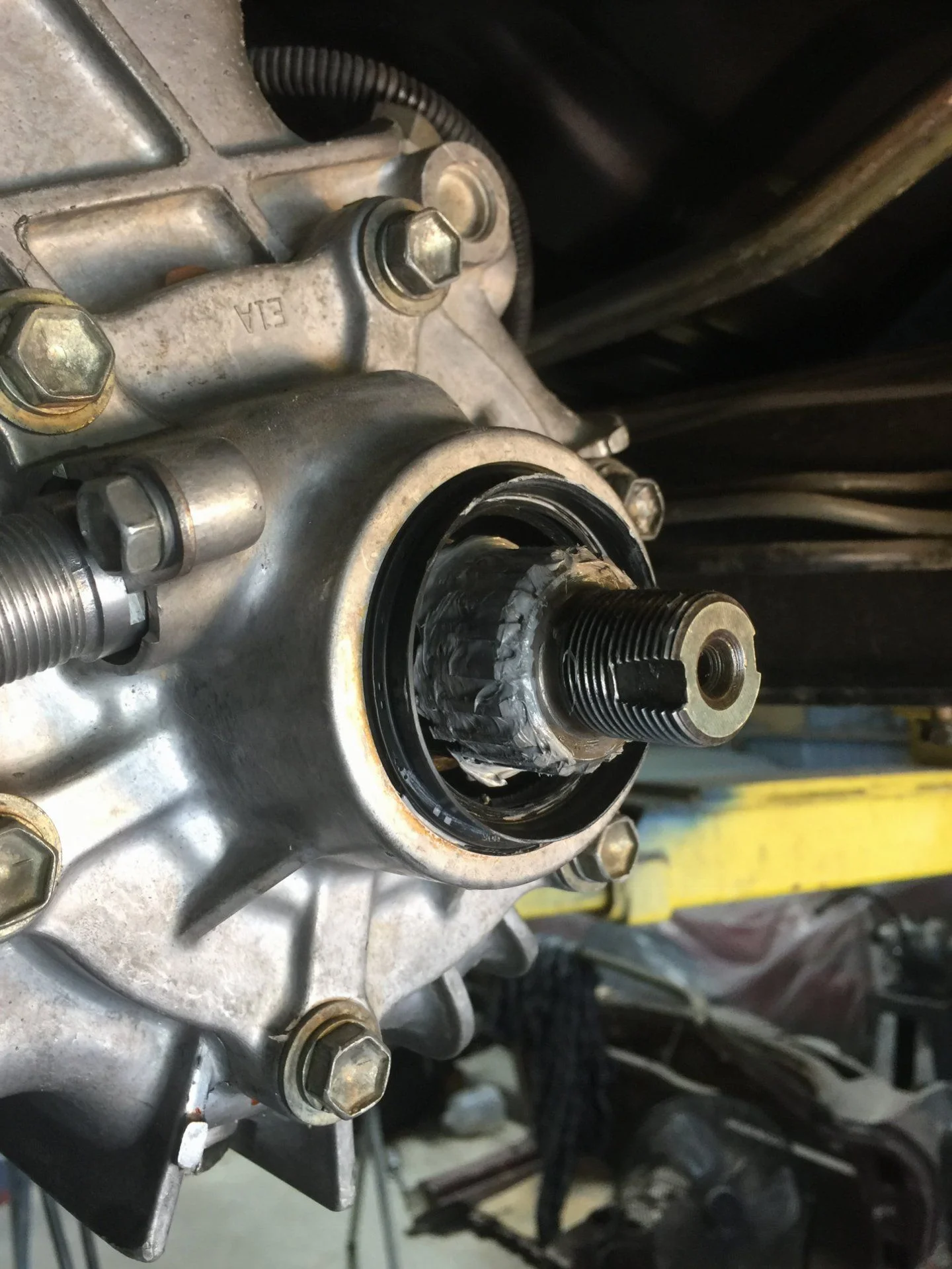

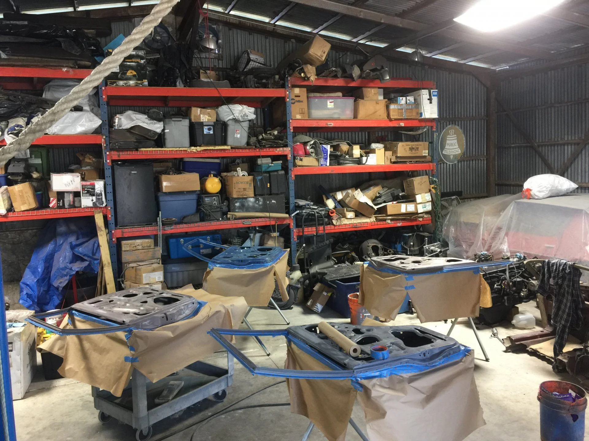

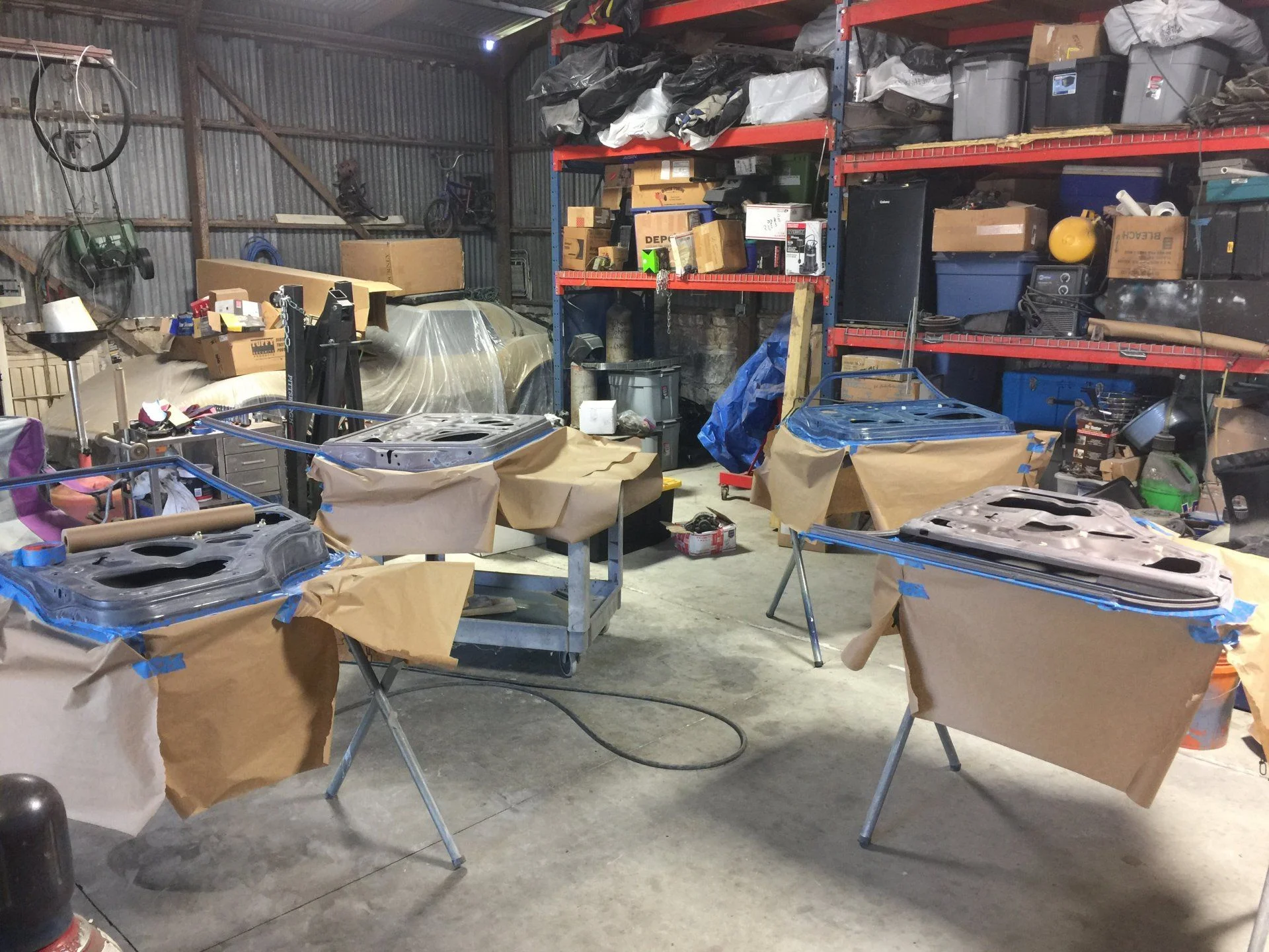

Sticking to my plan. Wanted to hit the doors with Epoxy but I'm running out of daylight. Don't want to risk bugs this time of day. Will shoot it in the AM and then primer surfacer after lunch. Block it tomorrow night and base/clear on Friday. This is just the inside of the doors. Will work on the mechanicals for a few weeks and shoot the outside of the doors after the inside sets up. Have most of the bodywork/sanding done on the outside so I'll get to the paint process pretty quick. Ever since we got the new motor in that's all I can think about. Painting is usually my favorite thing but not now. Glad the doors are the last of it. Oh...and I had a bit of an issue with the t-case leaking. Had some great input from the experts on a separate thread. Some gray epoxy and a lower mileage (75k) flange and I hope I've solved the problem. And the pretty Coral snake decided it wanted to hang outside the shop :). Don't see too many of these. 2nd one in 11 years (thankfully).

Also curious about the gray RTV fix.

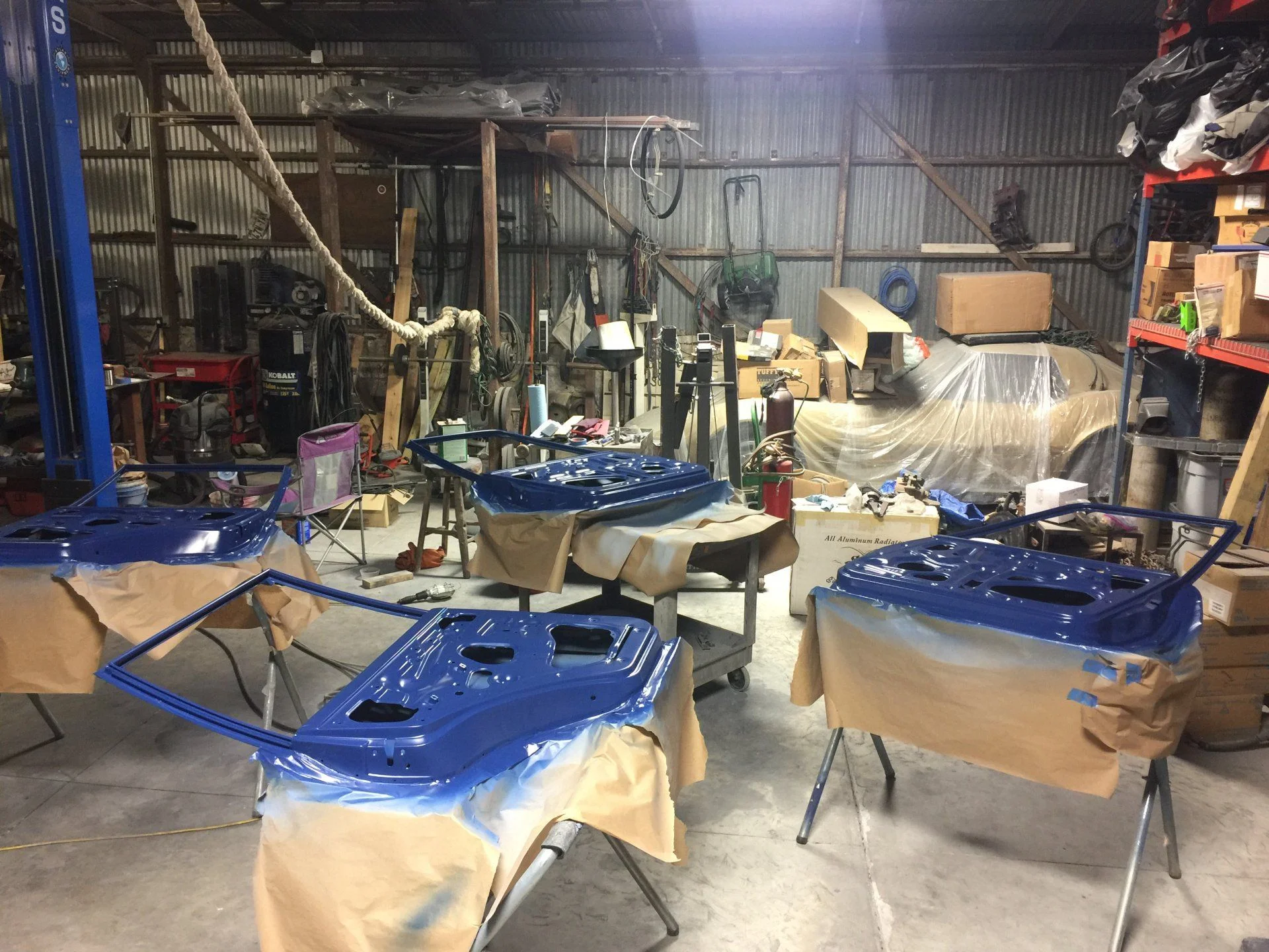

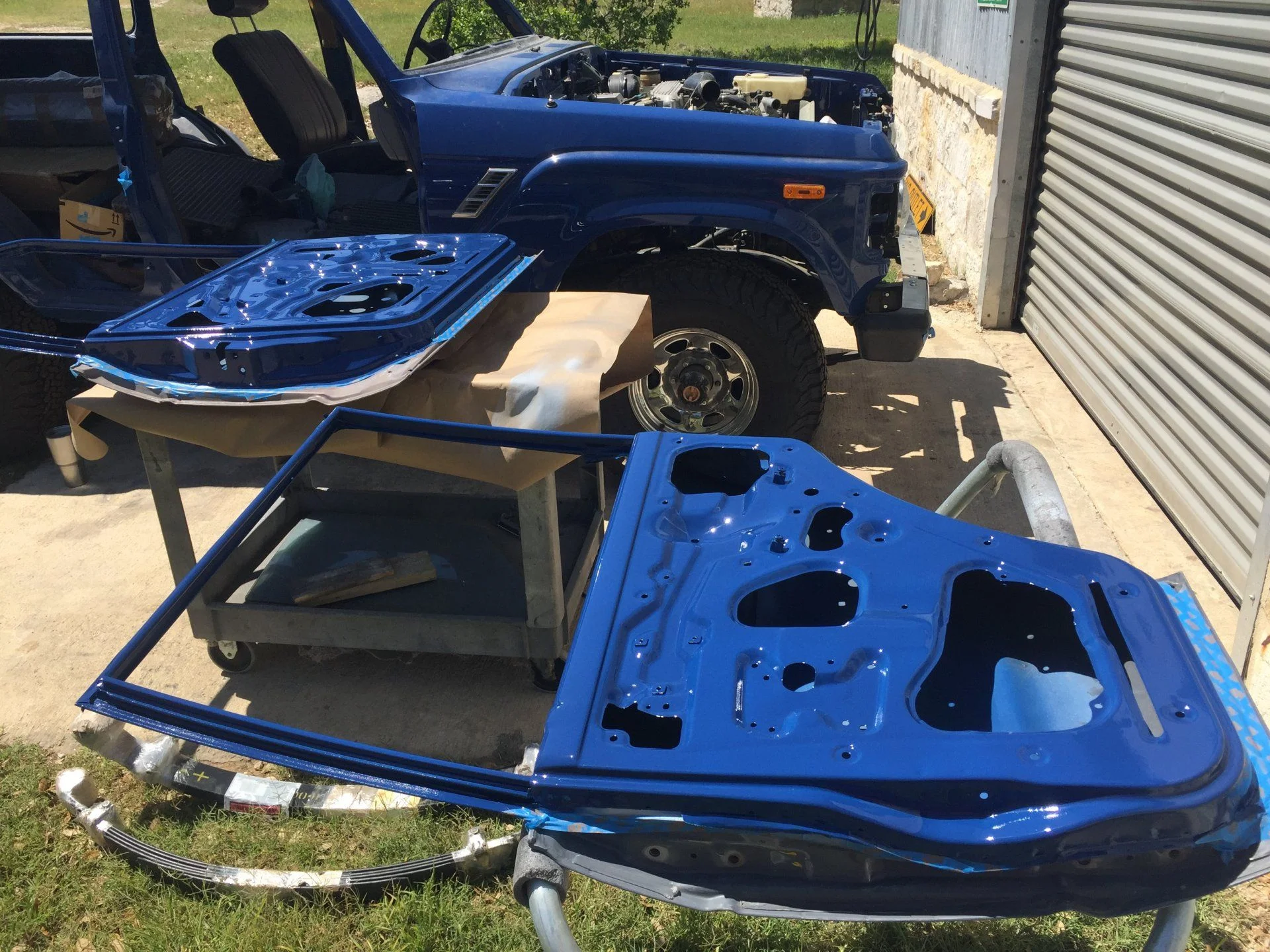

Clear is about done. These two were first. Since I don't have a paint booth I try not to paint (clear coat only) too many pieces at once as the plume of clear dust will settle on a piece where the paint has flashed. So I'll let the paint set up for a few weeks then flip them over and do the other side. Can do this with the doors as they have a break (door gasket) all they way around. Will hide where the two paint jobs come together. Reason for this is being a novice (prefer hobbyist) painter, I can lay the clear much better on a flat surface :). Now I can get back on the mechanicals of the cruiser.
