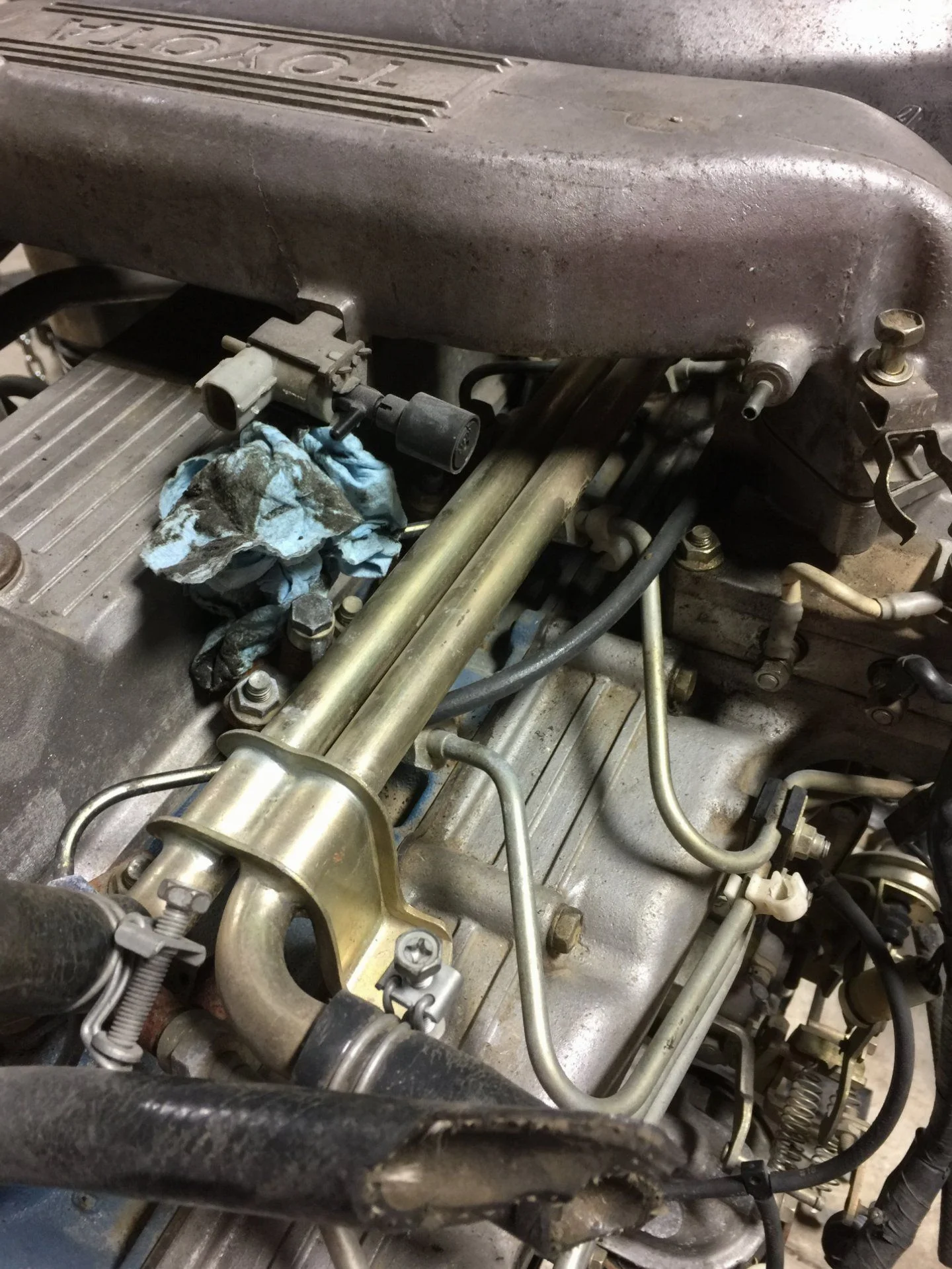

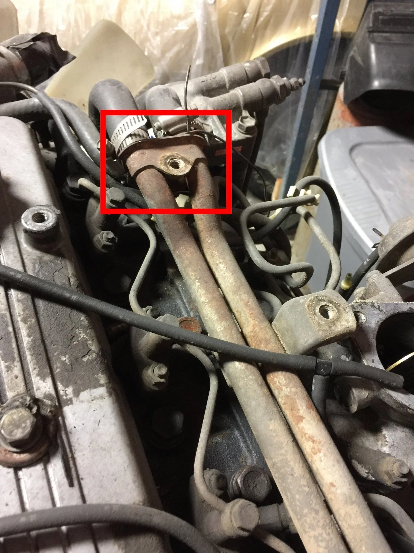

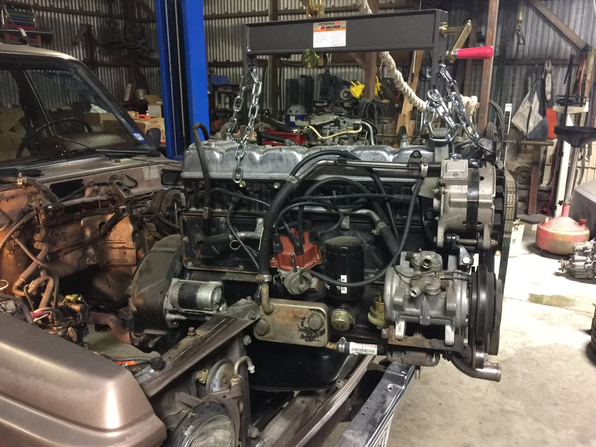

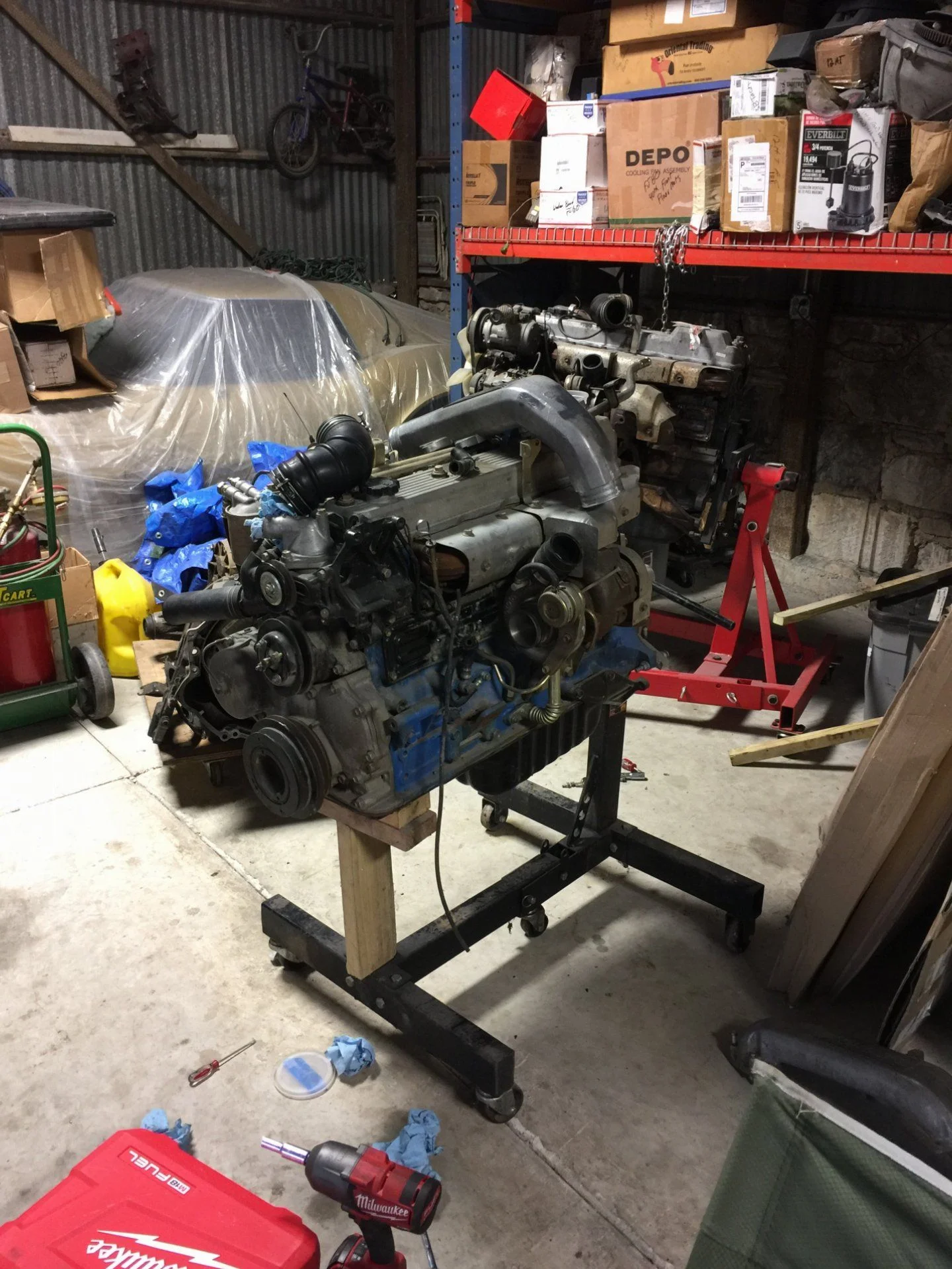

A little disappointed to find out the upper cooling lines are different between these two motors. The Coaster bus motor has a steel intake pipe and I was going to swap over the aluminum ones from the other motor (came out of a HJ61). Unfortunately the CB lines don't have the built in bracket towards the front to bolt down the pipe. Not sure if this is available still but I shot @beno an email. If it's not then I'll go with the original setup for install and then get the lines from the 61 re-plated.

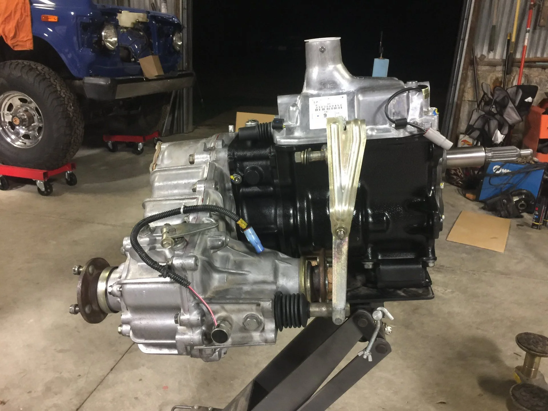

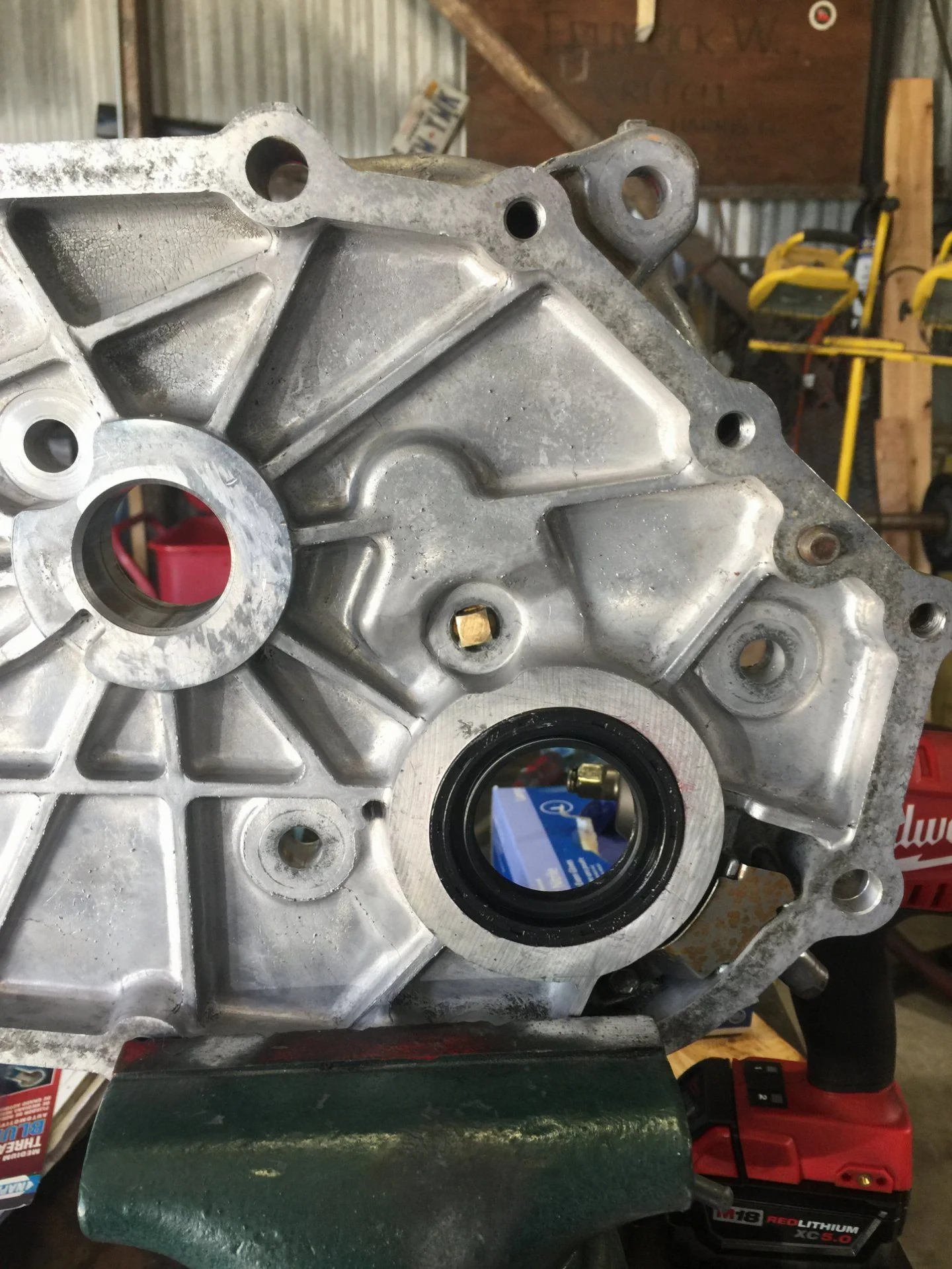

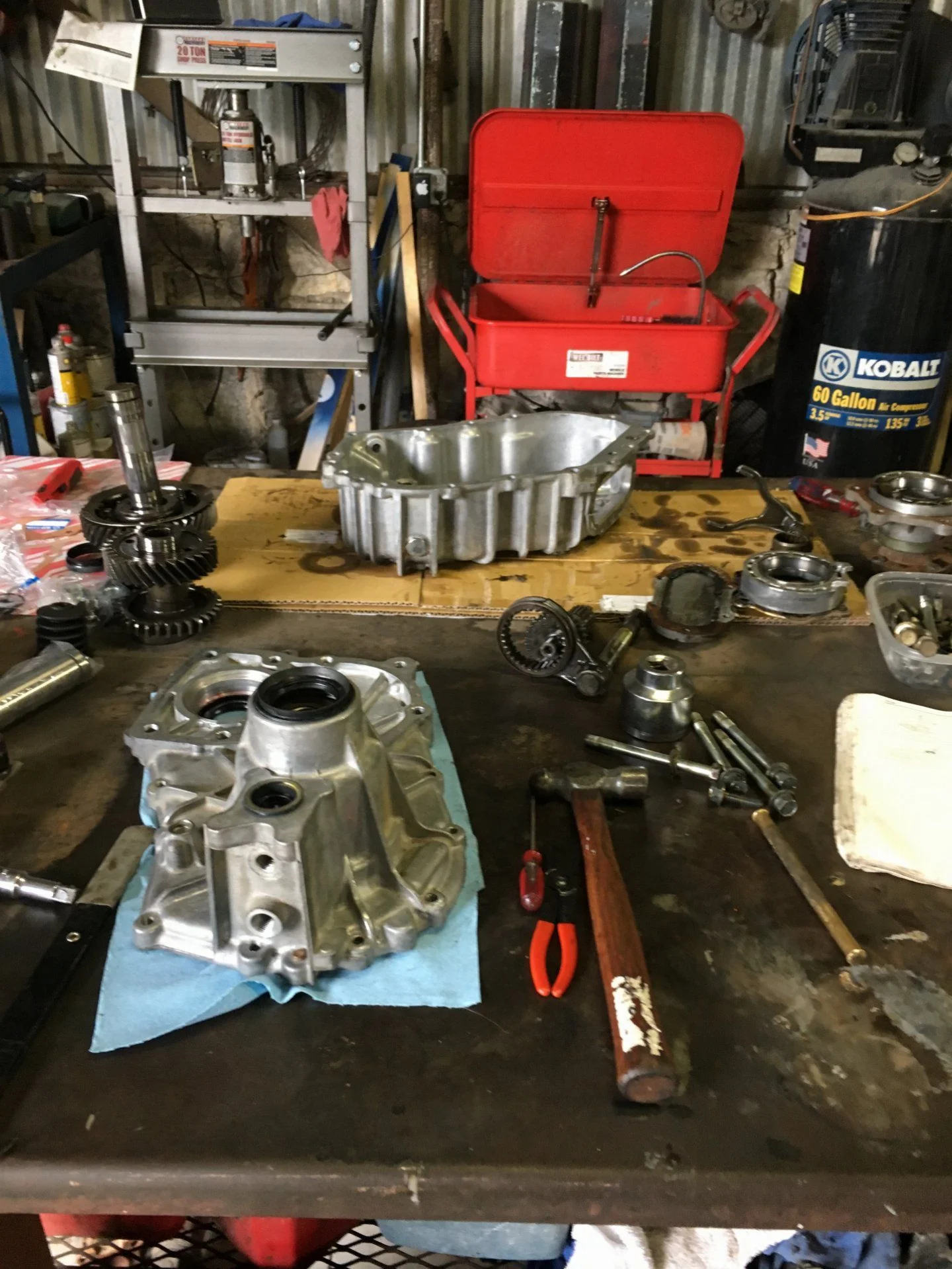

Man this is Pretty! Not sure what's better looking...the inside of that motor or the new h55 with the rebuilt case hanging off the back. I got lucky and did some t case research just as I was bolting up the front half of the case to the trans. Found one of @orangefj45 posts about the hole that needs plugged in late 60 cases. I would have definitely missed this one. Plugged it with a 1/4" plug. Also, had a hell of a time getting the back half of the case on then figured out the thrust washer would not fit over the idler shaft. Had to file the inside tabs down a bit. All worked out once I did that. I'll keep at it as I'm on PTO this week. Trying to get as much done while my oldest is home for spring break. Problem is he's been gone (hanging with friends) more than he's been here. Oh well...part of turning into "the old man" :)
