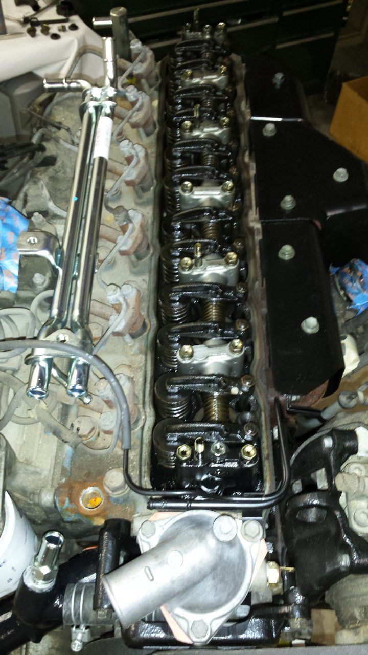

Quick dry run mating things up. We're gonna grab some dinner and then lay it in there and tack up the motor mounts. Will blow it apart and burn them in and hopefully stab it for the last time :)
All welded up. Will touch up the paint in the AM and then hopefully drop this motor in for the last time. We lined everything up starting with the trans cross member. The frame mounts fell right into place. Dam 12HT sits really close to the firewall. MJ assured me it's the same with his setup.

Man I just can't get over how awesome that engine looks. The valve cover and charge pipe are different from any other 12ht I've seen. None of my 4 valve covers have the "Toyota" embossed on them and the turbo lettering on that charge pipe is cool. I'm guessing it faces rearward because of the orientation the engine would be in when installed in a bus.
