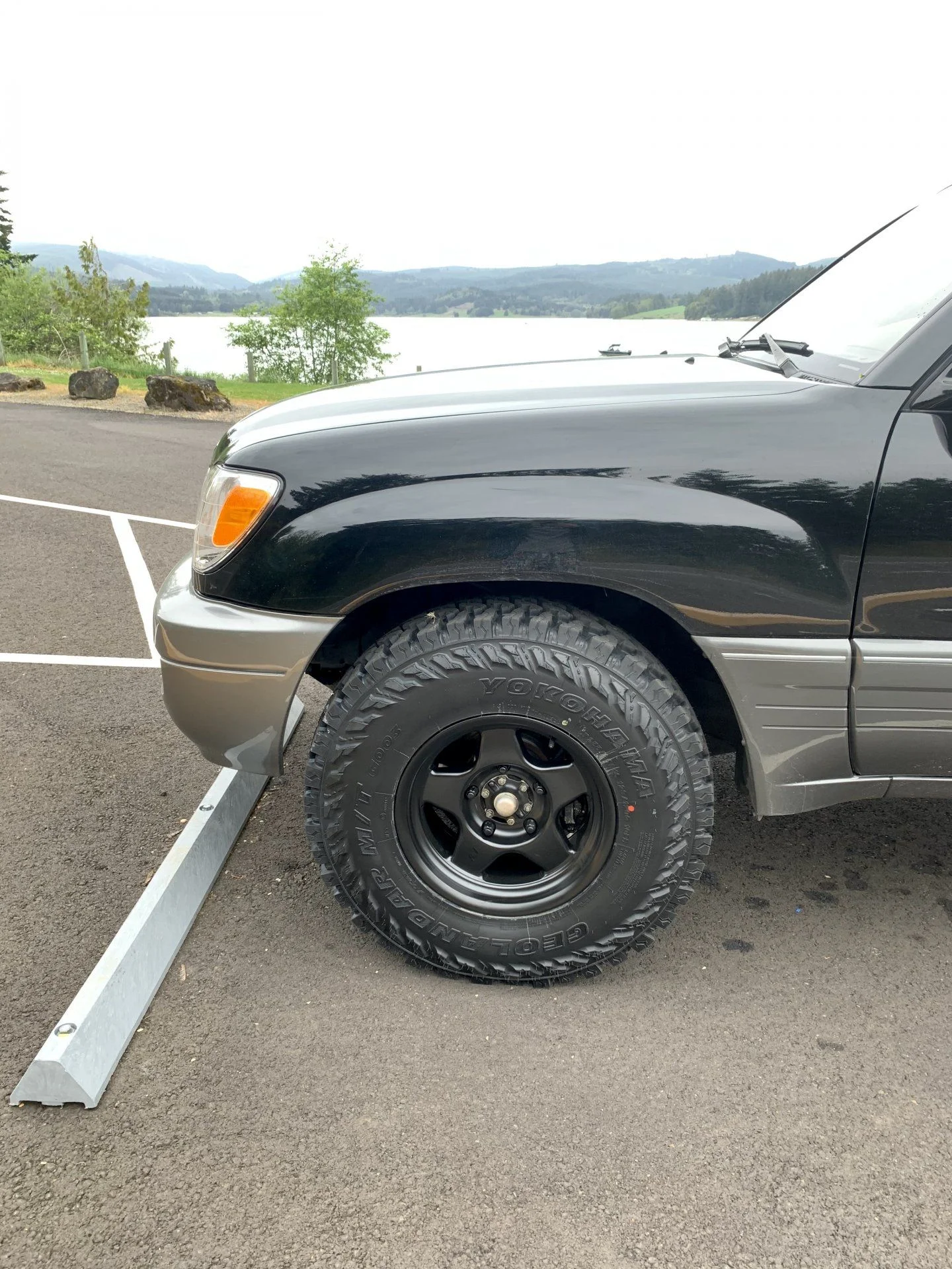

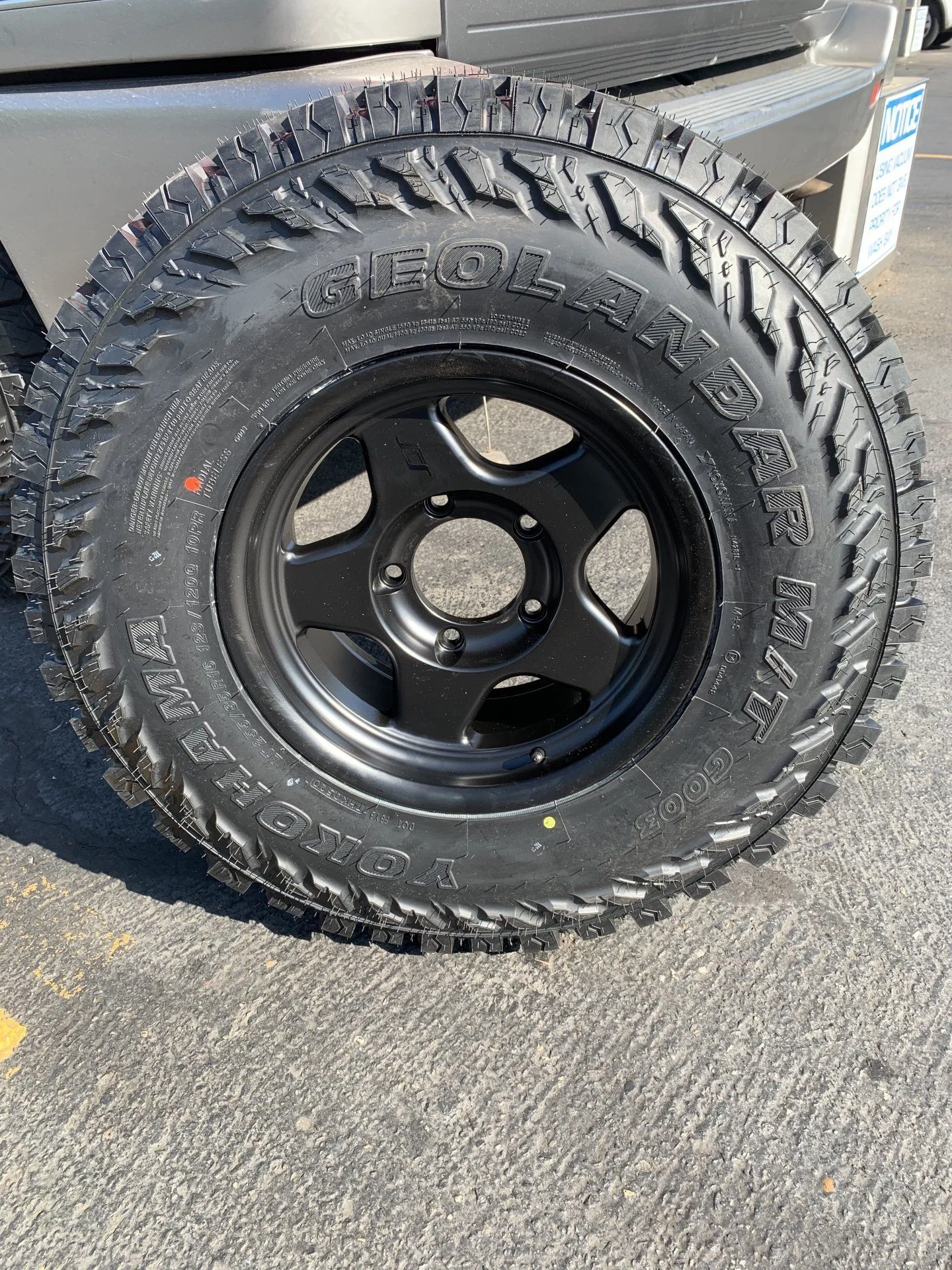

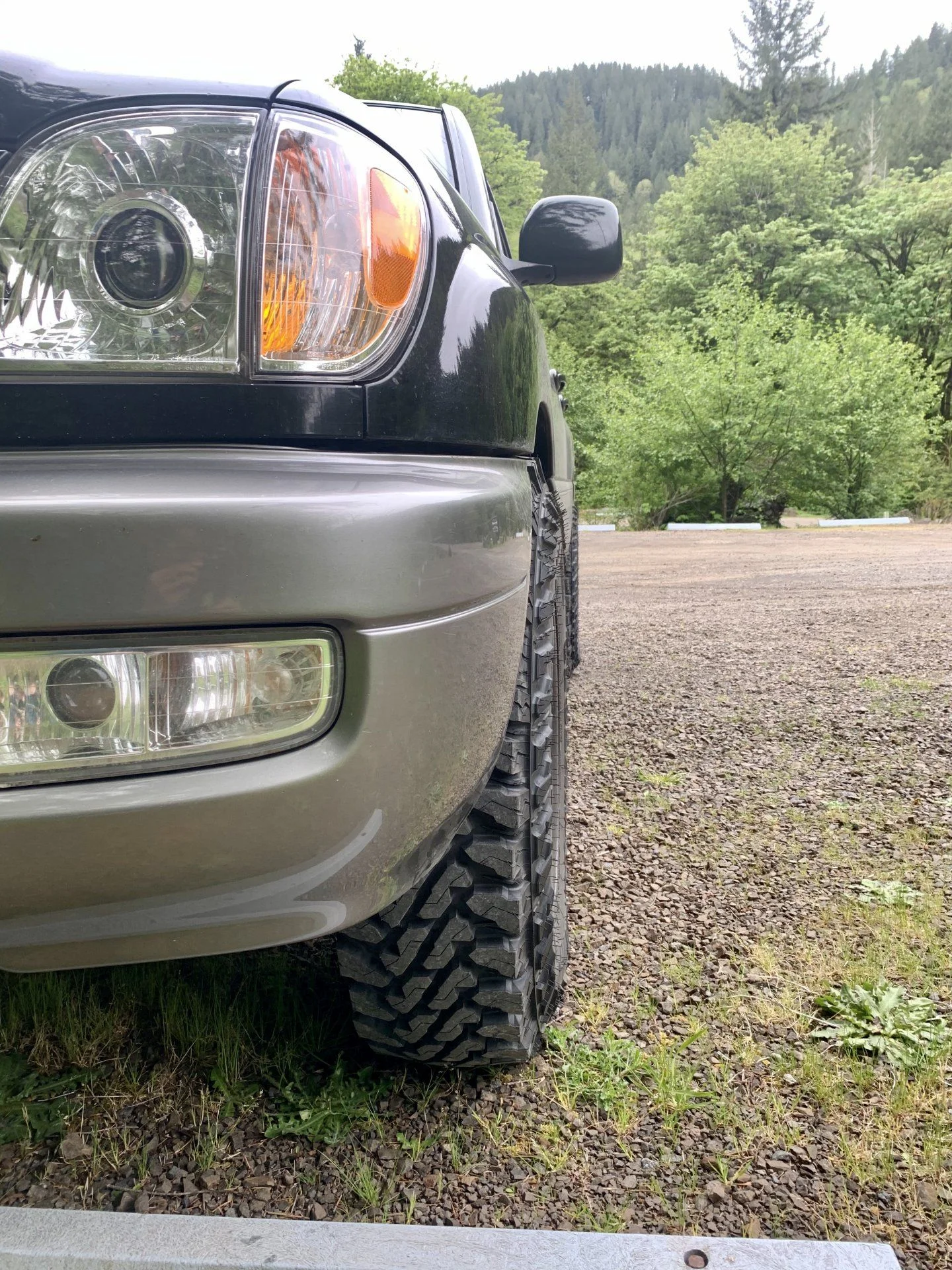

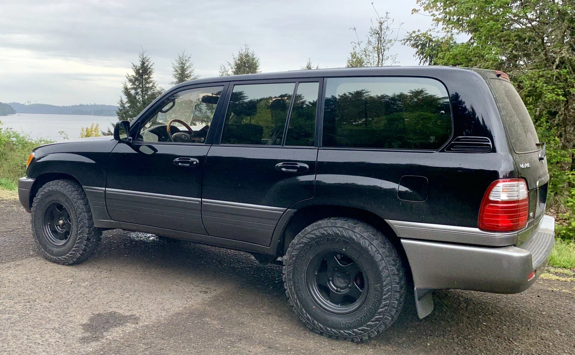

5x150 SCS F5 Wheels 16x8

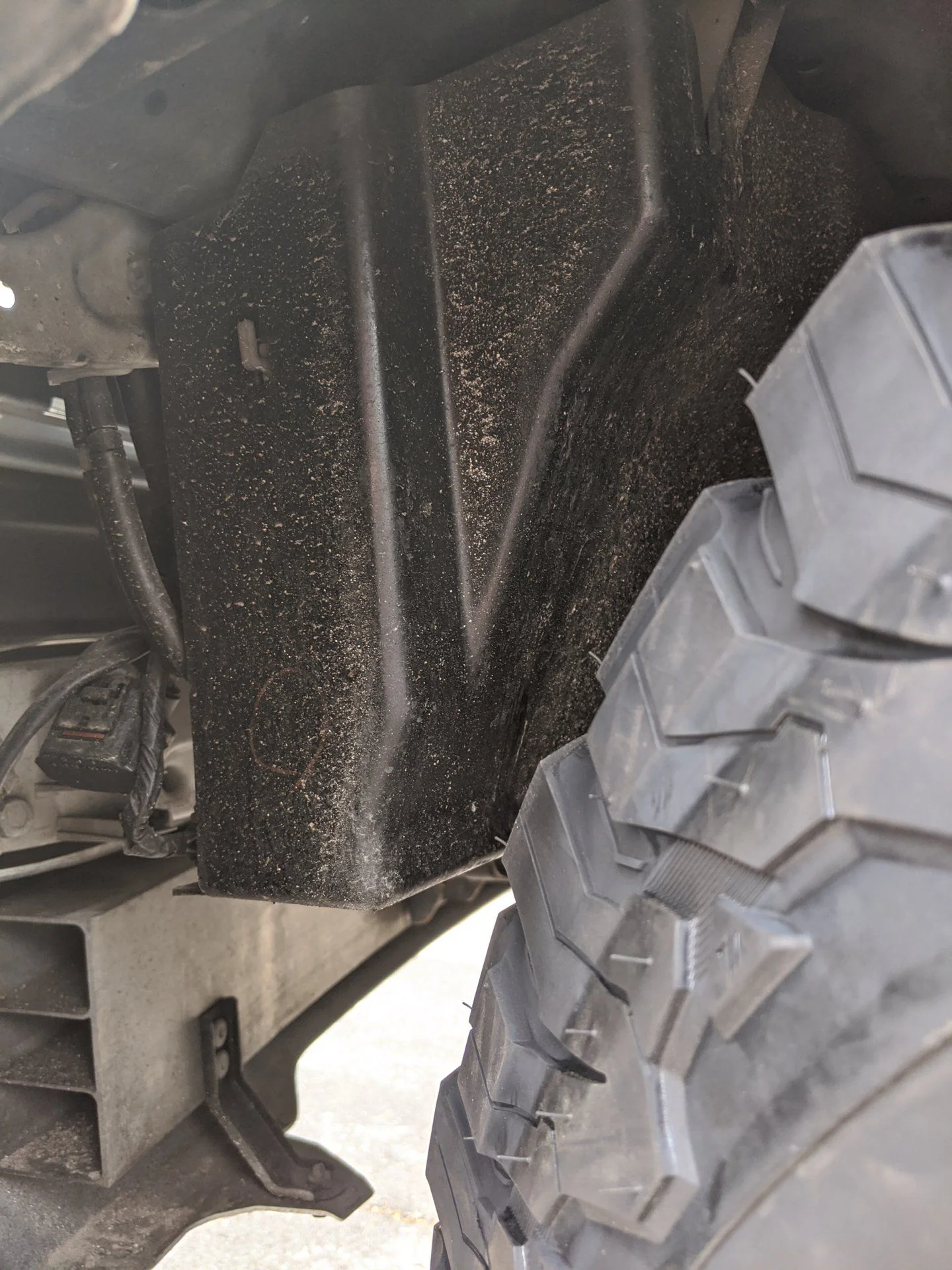

Finally got these on, looks amazing. Some minor rubbing on the front drivers side, only with the wheel turned all the way right and under some compression. There's a black piece/box of plastic right in front of the tire, it's not the fender liner. Trying to figure out what it is before I remove/modify it, haven't had time to inspect it really. Whatever it is, it's just on the drivers side.
(EDIT: it's the cover for the windshield washer tank)
Otherwise no rubbing so far, AHC with 285/75/16, and pinch welds done.
Love the way that looks
Me too! I almost went with bronze, but this looks perfect.
I'm surprised no one has run into rubbing with the windshield washer tank. I think I will relocate it using a smaller universal tank when I have the time. Seems like an easy project, and a small price to pay for this setup!

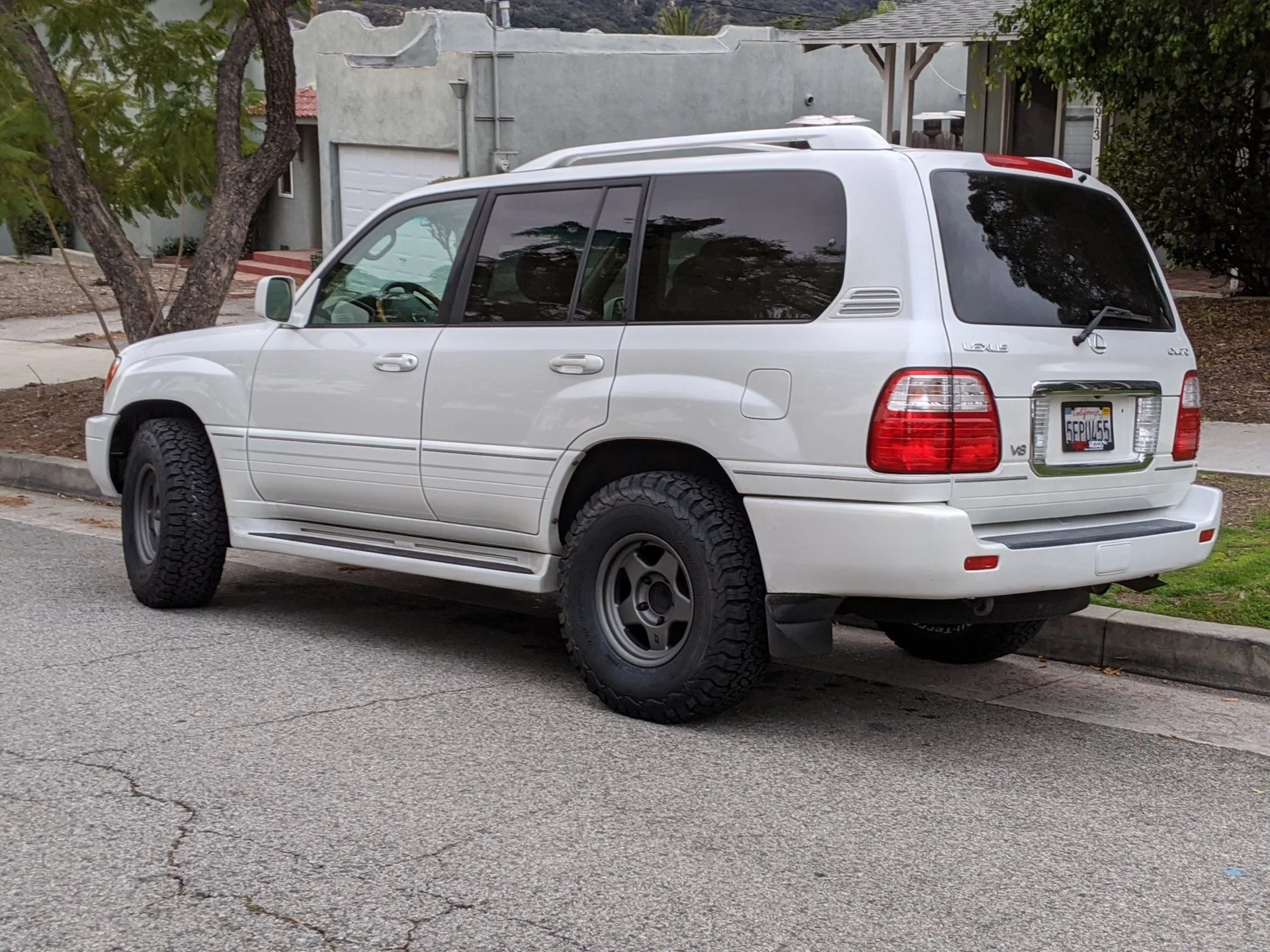

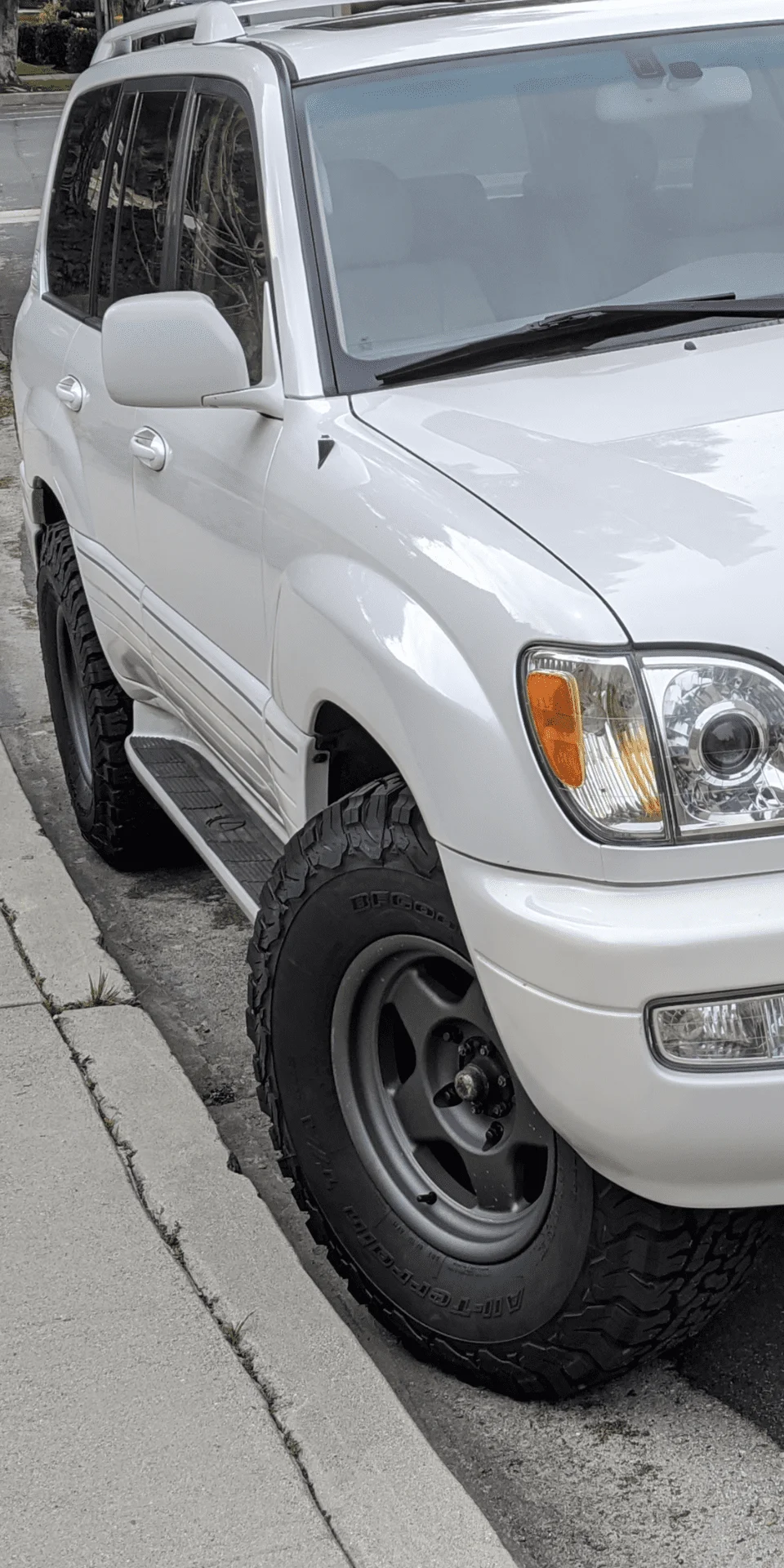

I think I like the grey better than my black F5's, but I have a pearl truck, so I didn't want to risk it looking off.
I have experienced zero rubbing. I'm taking off my running boards soon and installing the Owl Expedition lights when they arrive. I'll throw up some new photos when complete.

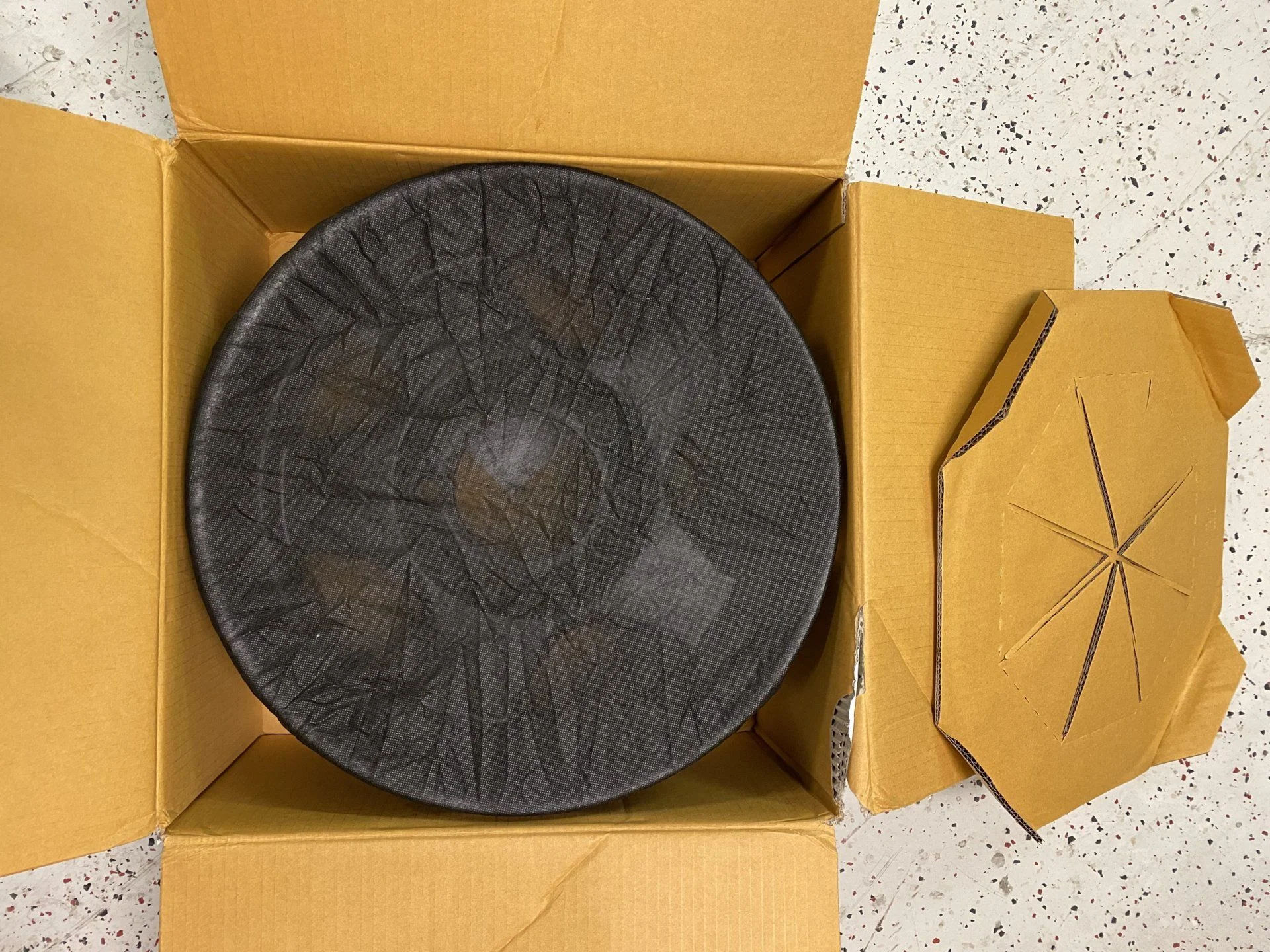

I have one brand new F5 for sale in the box, If anyone is interested-

Is this stock height? Sits really well. Trying to decide if it’s worthwhile to lift the truck at the same I buy the wheels/tires.
Yessir. I’m going to exhaust and enjoy the ahc until i build past it’s weight capacity. It’s done very well for me on the trails thus far!
