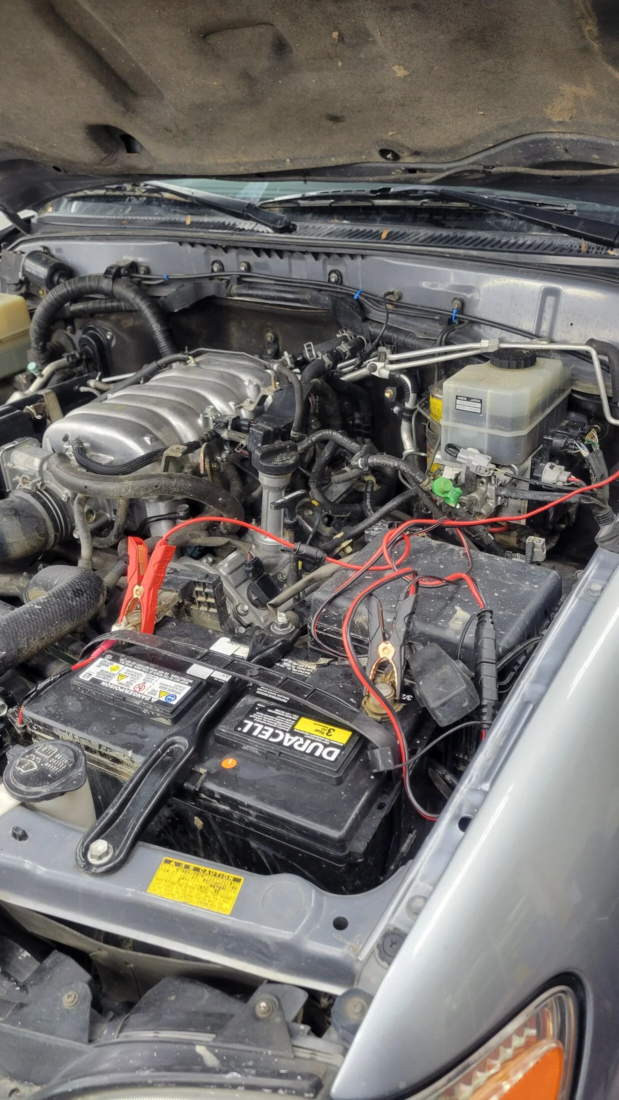

#1: make sure you have a battery charger on your battery while you wait the 30 minutes (saw this in a video)

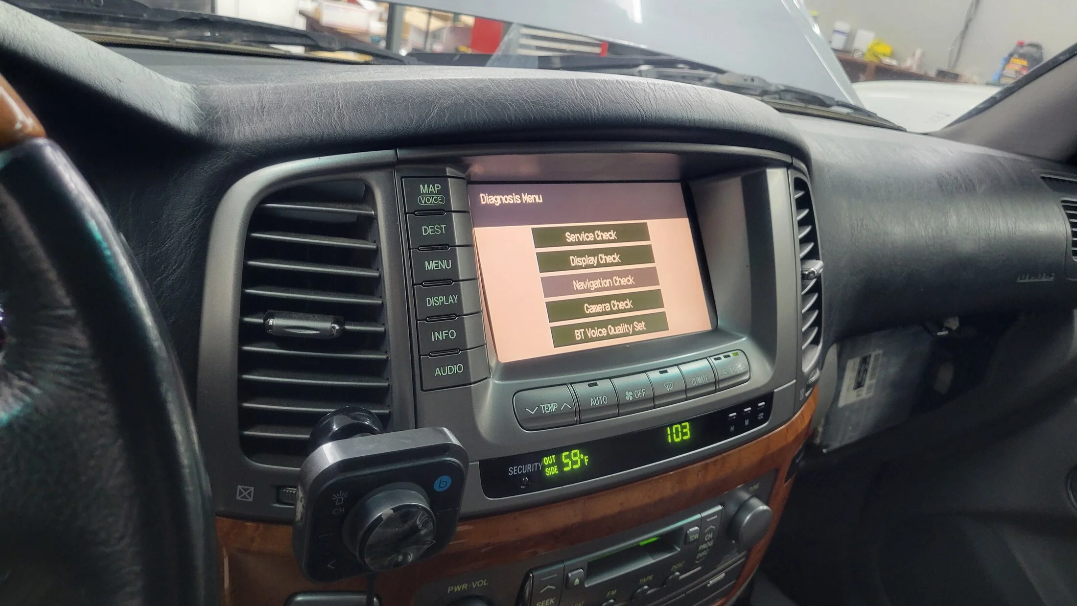

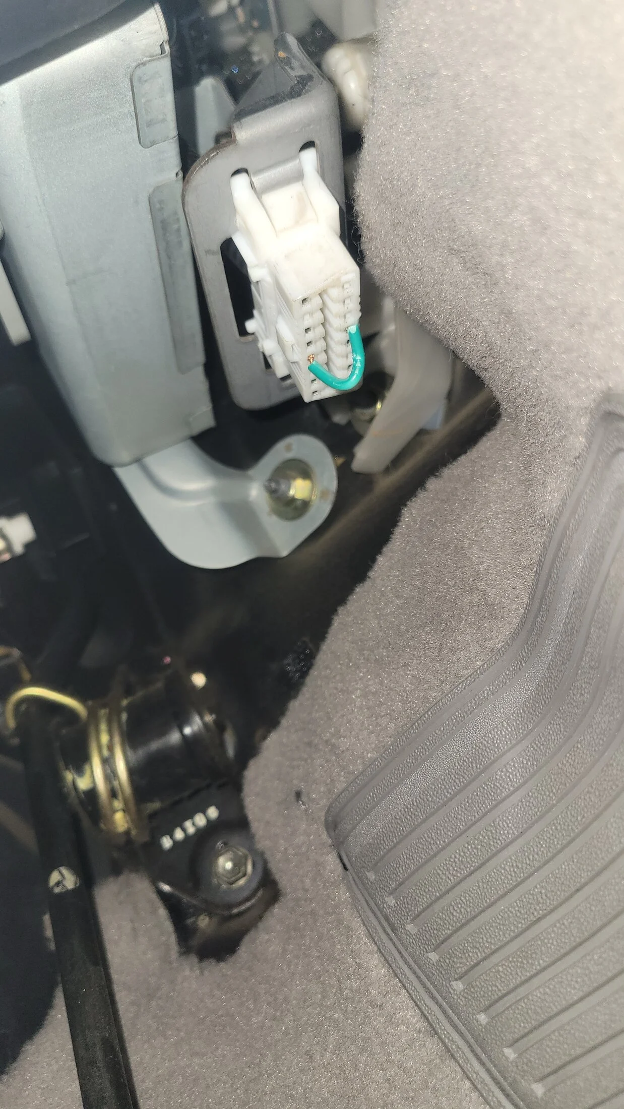

#2: you'll get quite the Christmas tree when you out the key in and and turn to 'on' after jumping pins 4 and 13 on the OBD connector.
You also get a diagnostic menu for the screen/audio system. Swanky!

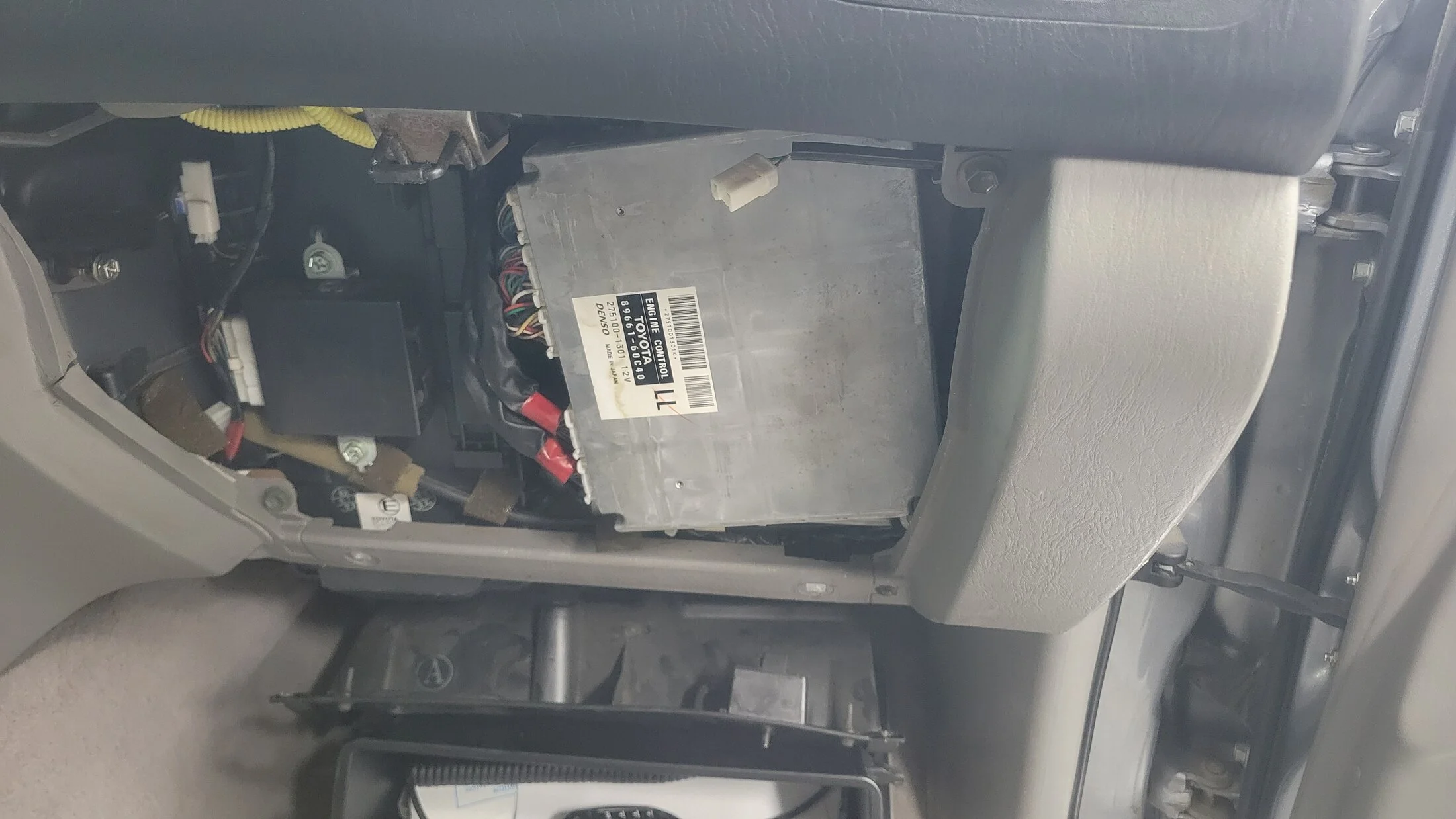

Well, @MongooseGA has a pretty special ECM.
It turns your 5 speed into a 4 speed, and has this cool 'catapult mode' permamently enabled. Any time the truck shifts into 1st gear (but especially when it down shifts from 2nd to 1st) it does its best to put you through the windshield - sheesh!

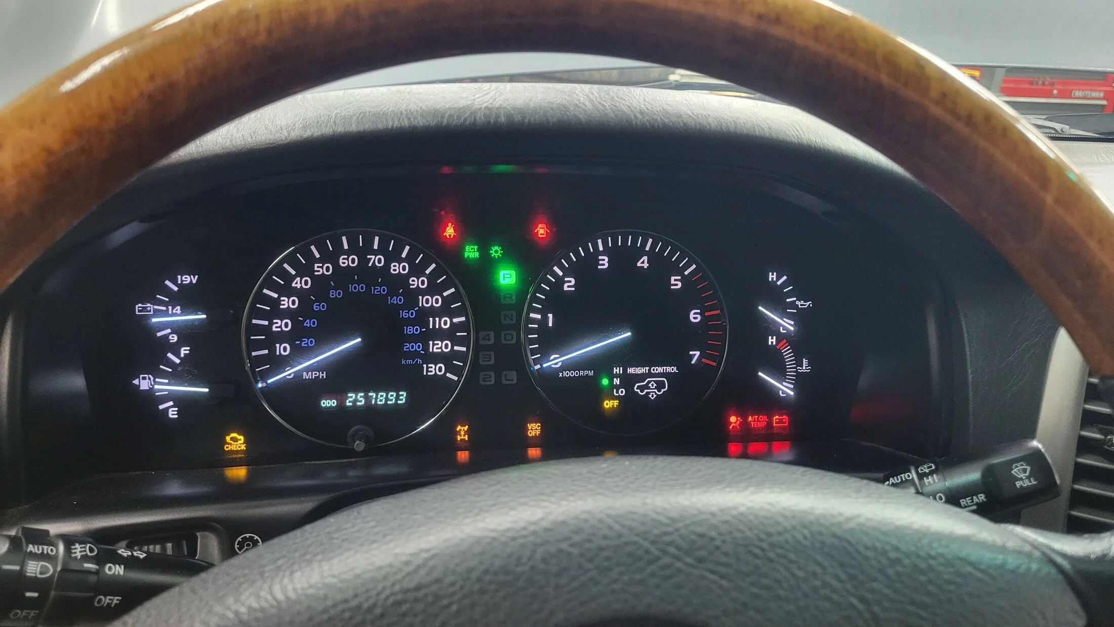

Made two runs with the truck with the suspect ECM - cleared codes & disconnected battery between runs. P0771 (Shift Solenoid E) fault returns.
The truck definitely tries to shift to 5th - RPMs drop momentarily, and a small lurch, but nothing actually happens. So it's not another sensor that's affecting the shift logic somewhere - the ECM is commanding 5th, but it's not happening.
I'll admit - I was highly skeptical that it was an ECM problem, but whatever output line controls Shift Solenoid E must be toast somewhere inside of it.
