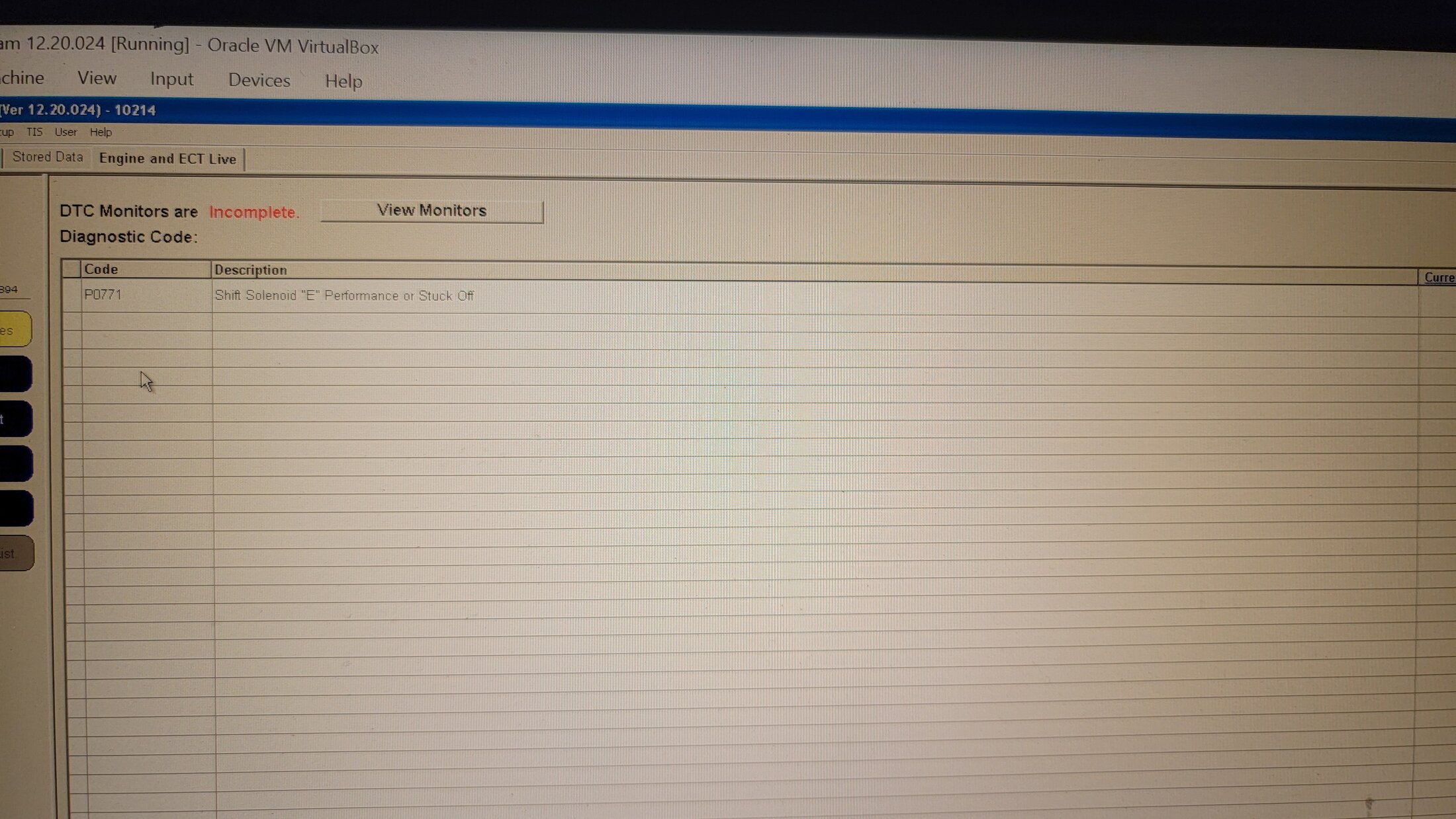

Interestingly, at the moment there are none of the previous DTC codes, but the P0771 persists.

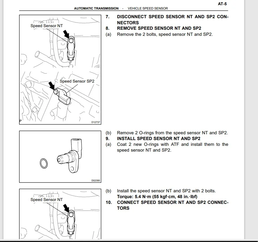

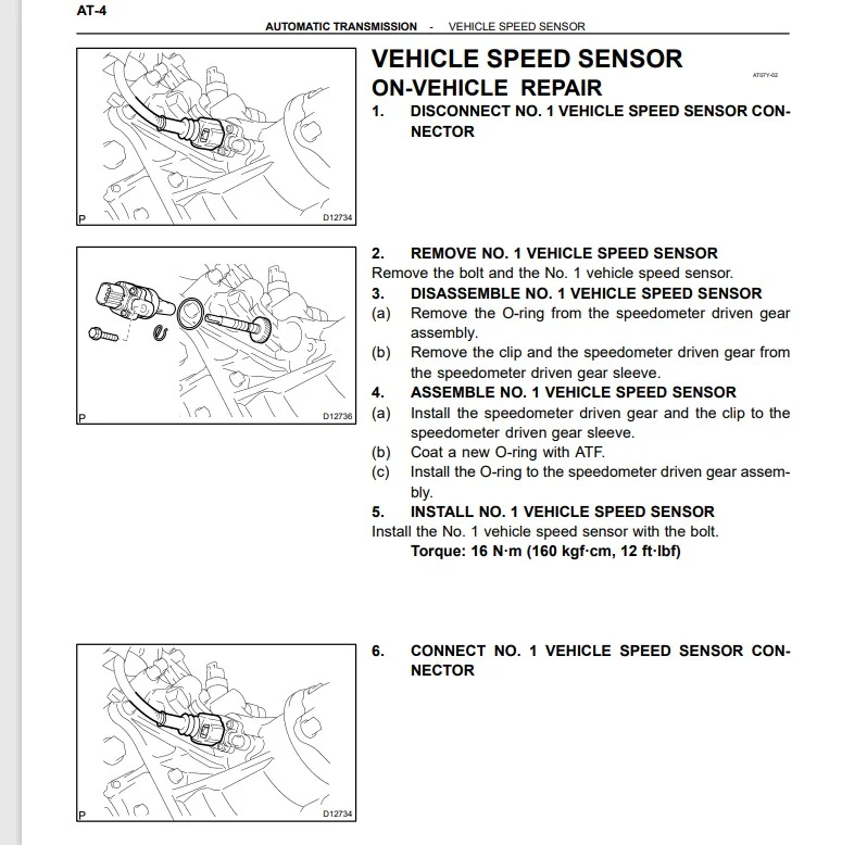

Also, a correction/clarification to an earlier post- I've replaced the No1 speed sensor, not the others (NT and SP2) shown below.

Throwing darts here, hoping to hit something that rings a bell:
This is a head scratcher for sure. When I've gotten into them, when dealing with electronic signal. It's been issue of resistance. Either ground fault, wire housing block issue or frayed wires. Many faults have been due to water entry, either into cabin via windshield or into wire housing blocks found under the body (undercarriage). Frayed wire faults are mostly from rodent chew or rub due to improper routing. Incase of wheel speed sensor on built rig, often wire gets damaged from being screeched.
It's a long thread. I do recall the P0771 DTC does return after cleared, and mention of "some" wheel speed sensor (WSS) seen but did not return. But not which WSS DTC. I doubt WSS is an issue here with AT shifting to 5th. Those WSS DTC (4 of them), point to which WSS of the 4. Why in another thread, he found bad WSS without a DTC, is unusual. All bad WSS I've seen, do kick off a DTC and shuts down ABS. So we get warning lights on dash.
I've yet to find a cause and effect in FSM between AT & WSS. But perhaps I need to look deeper!
Looking at some diagnostic in FSM for P0771. It starts with many of which swapping AT would or should have taken care of. That and test of the various sensor & solenoids, your shop and you did.
All to often FSM tree, points to EMC or some CPU. When the issue, is resistance in wiring, not a controlling computer.
Some of sensory input to EMC controlling AT, that are not in AT. Like ECT sensor and "KCS" sensor circuit. I'm not sure what KCS is. But since it mention Spark Advance. This may be, a knock sensor. Anyone know?
Anyway, it need to see a 0 percent "CA" or more. Again, I'm not sure what FSM saying with "CA". But I assume crank angle of zero or more. So this would be read by crank position sensor (CPS). Could a damage wire of crank sensor, have a fault, and not set off a DTC. Perhaps. I'd certainly check the wire to CPS. So many routed wrong during T-belt and or fan bracket service, and the wire rub serp belt and get cut. Sometimes only part way through wire strands. Thus changing resistance, yet we see continuity. That wire, many have later been routed correctly behind fan bracket, out of sight. I'd inspect, just to rule out.
Also FSM states, "transfer range be in high". It's unusual to replace a TC, but IIRC, you have. So I'd be looking at it's switches, wires and their wire housing block also.
With deep dive, we find. EMC also uses other signals. Such as EMC gear position. Also throttle valve opening angle. Again this should kick off it's own DTC. But perhaps did not.
Digger deeper the lock-out uses MAF, crank position sensor, brakes and a few others. Any of which "should" kick off a DTC. Lock-out, may be unrelated to overdrive/5th, I'm not sure?

WSS was the RH rear. I visually inspected mine this morning and compared to the other thread where dude replaced his and fixed trans issues, mine looks to be in great shape. No obvious signs of breakage.

I doubt WSS has anything to do with your AT issue anyway. FWIW; Rarely is there visible signs a WSS is bad. Most WSS I've replaced. Indications were, the wire had been stretched. Which damaged wire, changing resistance. All had current DTC, clear and DTC would come right back.
