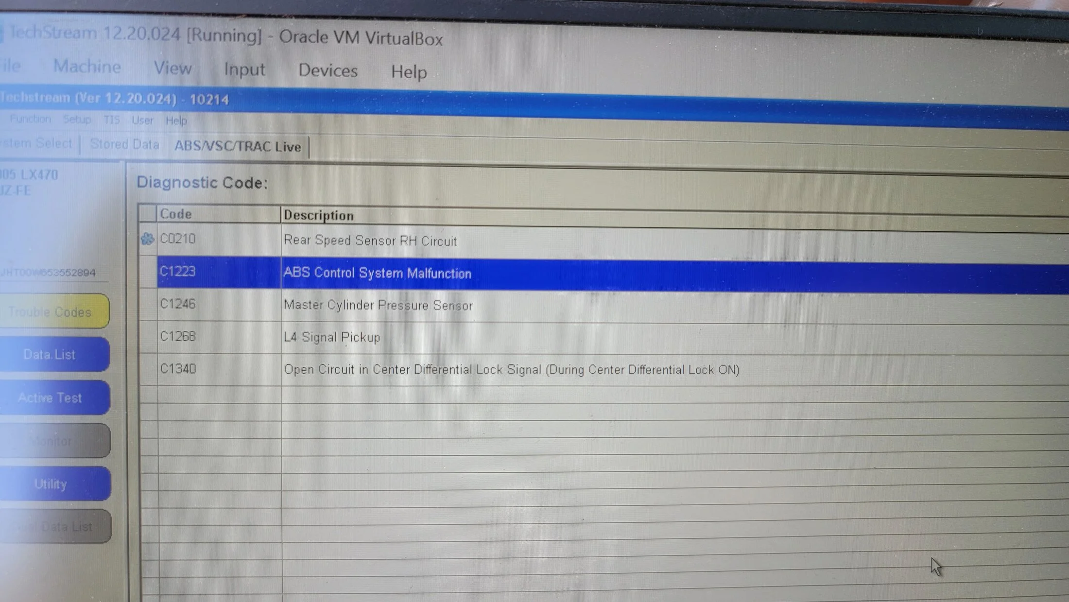

IIRC, there was a trans issue on here recently that was caused by a bad wheel speed sensor. Have you checked them? On my Fusion app I can call up all four and see if they are all the same.
That was for the 4-speed but might also be applicable?
Linky
I did pull a speed sensor code when I hooked it up to TS at the trans shop. At the time I suspected it may have just been a low battery thing, but this is a good thought that I can look further in to. Since clearing the code that day, it hasn't returned on the dash. But I'll hook up TS again and see if there's something there.

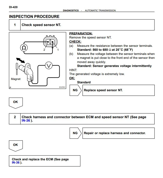

Per pages AT-4 and AT-5 of the FSM, there are 2 speed sensors on the trans case (not at the wheels). Did the parts cannon hit those in its initial volley?
I replaced one of them on the trans this Summer before going to CRockies. It's the one that the speedometer wiring hooks up to.
So that's the output one. Reading in the FSM it says the other one is the input one and controls shift points.

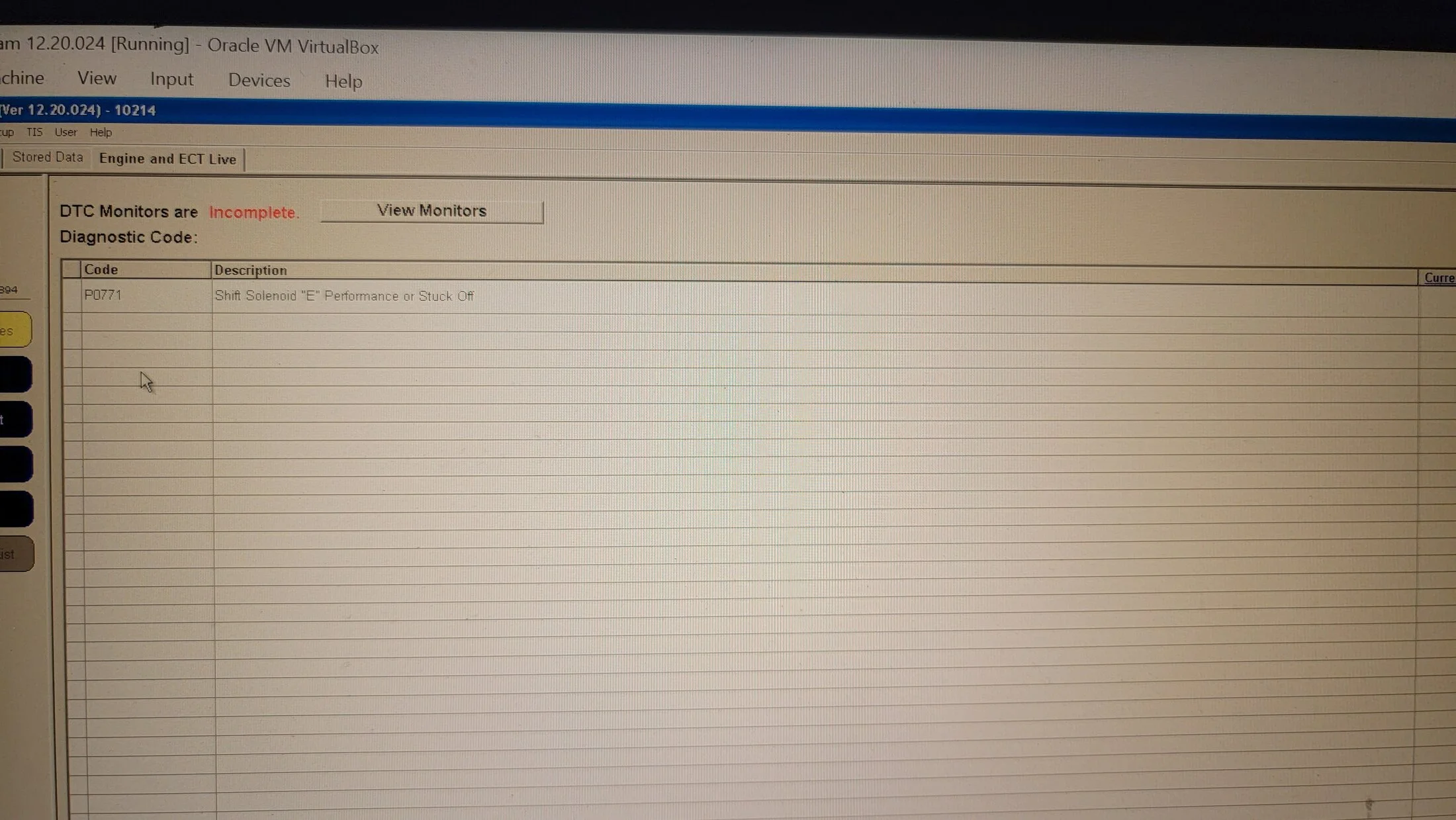

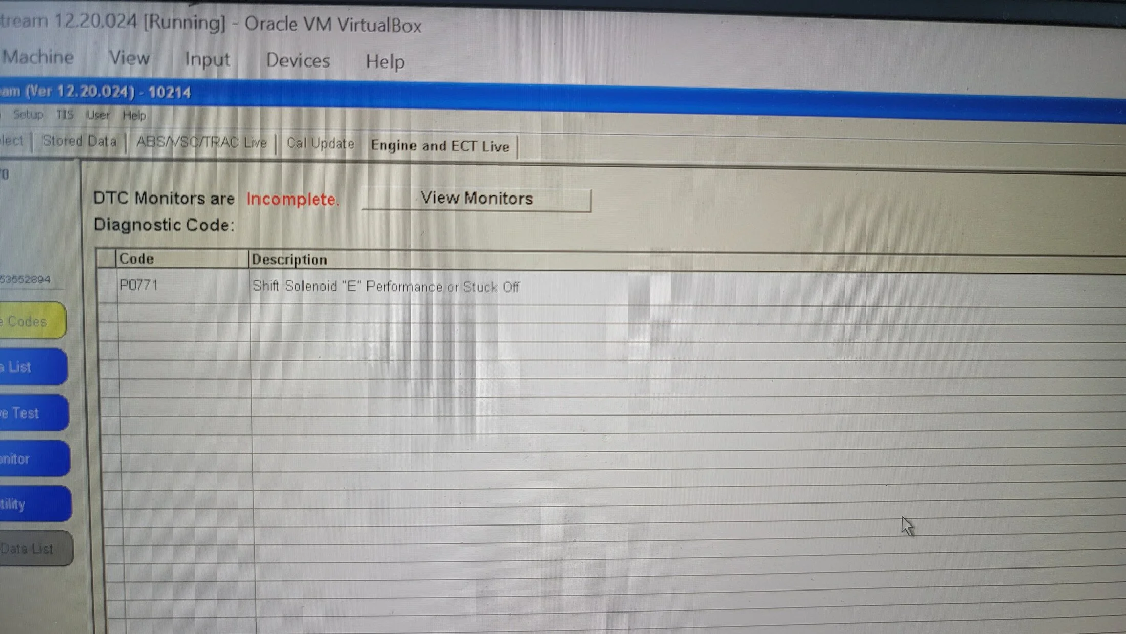

The only codes I've been aware of (recently) were the P0771 and the DTC codes I requoted just a few posts above. Note: I never threw any readable codes on my ScanGauge, and I had the ABS/VSC/BRAKE lights on the dash when this first arose. The lights and no-5th-shift started at the exact same time as far as I could tell.
Idiot lights went off and stayed off the rest of the day after clearing, only returning after the truck got cold again. Say, first start up of the day they'd present.
It wasn't until I hooked up TS to the truck that I was able to read any codes at all. And, when driving the truck home from the trans shop, it threw idiot lights for ABS/VSC/Engine (not BRAKE any longer). None of these lights have returned since my drive home from the shop.
Yes, brake lights work properly. Idiot lights on the dash when I first put the key in, then they disappear when I turn the engine over.

I'd suggest maybe a little more investigation first in order to more accurately aim that parts cannon? Seems like you could run some electrical resistance check on those wheel speed sensors?
There's a resistance test for the input sensor in the FSM. I'd start with a visual unplug/plug back in check. Physical connection could be loose, not fully engaged.
I found it on the 2nd page after. Looks like an easy enough test.
