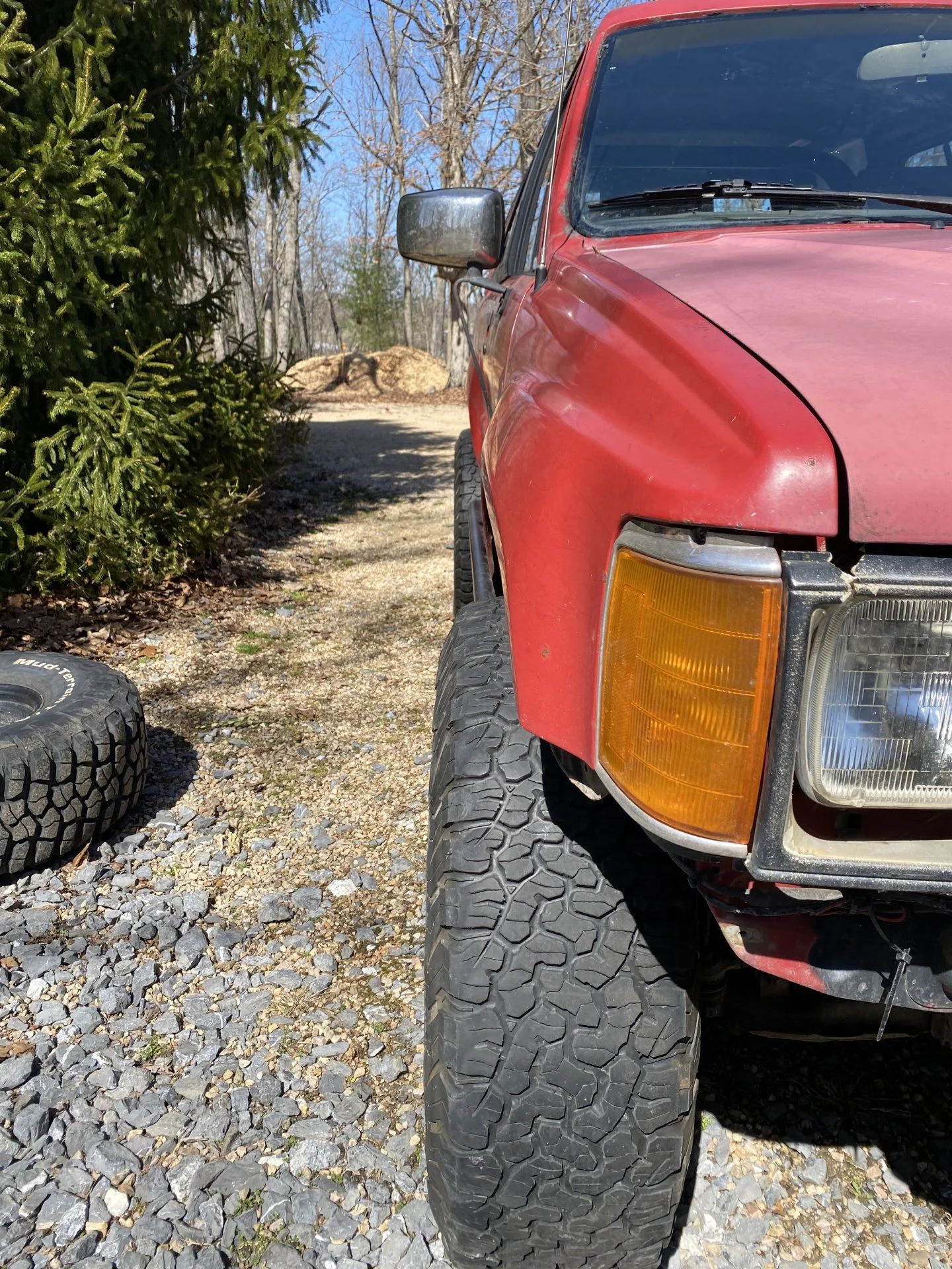

Passenger side firewall trimming. The 35 will probably juuuuust rub at full stuff full lock. I couldn’t achieve full stuff so I got it as close as I could without moving the computer in the kick panel. I plated the body mount bud it’s not there in these pictures.

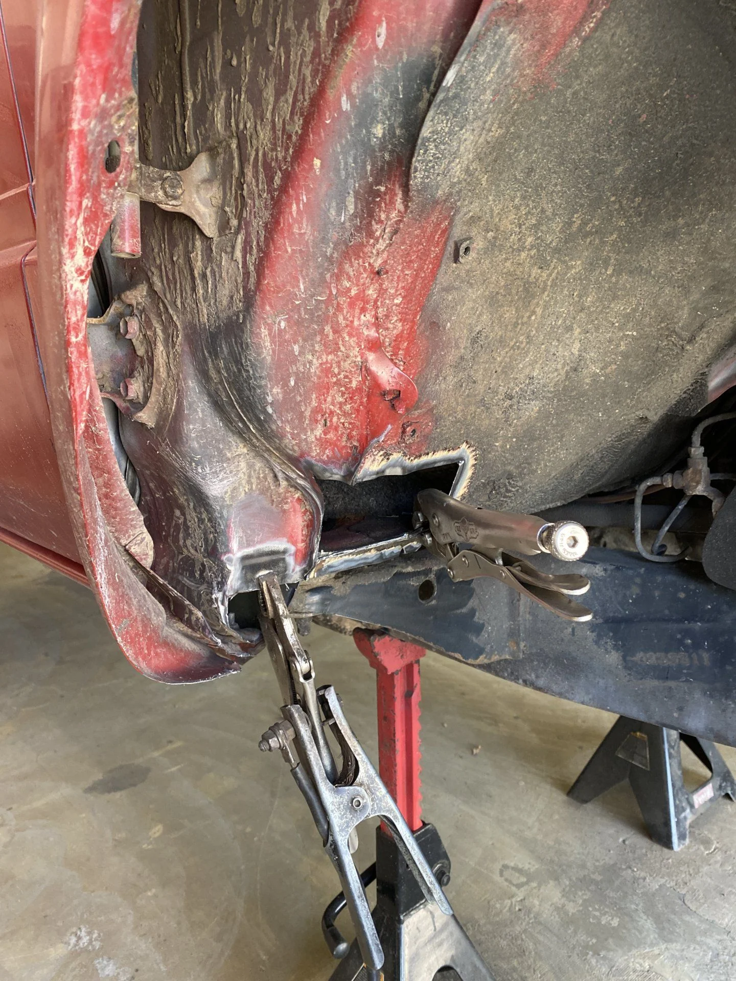

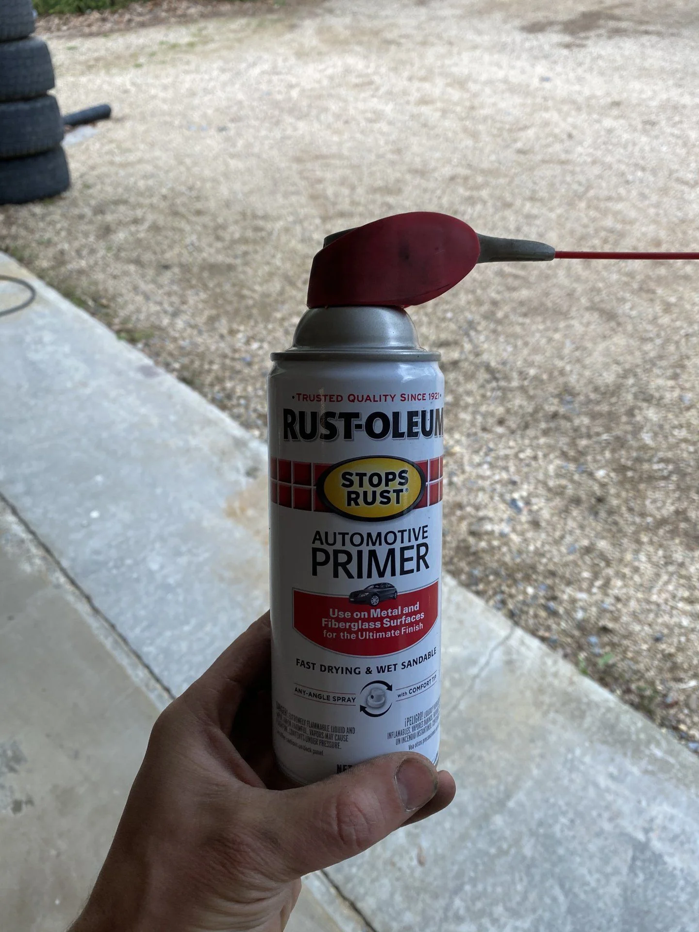

I was able to get inside the rockers where I patched some rusty spots and spray the backside of my welds. Obviously weld-thru primer would have been a better option but I didn’t know that was a thing until it was too late.
I've tried the weld-thru primer. Didn't like it. I couldn't get a good weld with gas.
Uhh.... I would be also getting some paint on top of that. Primer is porous, and holds moisture. That could go the wrong way.
But I like the nozzle. Where'd you steal that one from? I think I have a WD-40 can like that.
Yup. Wd40 can. They also have WD40 cans with metal flexible nozzles.
Im going to paint, of course, but I’m not to that step yet.

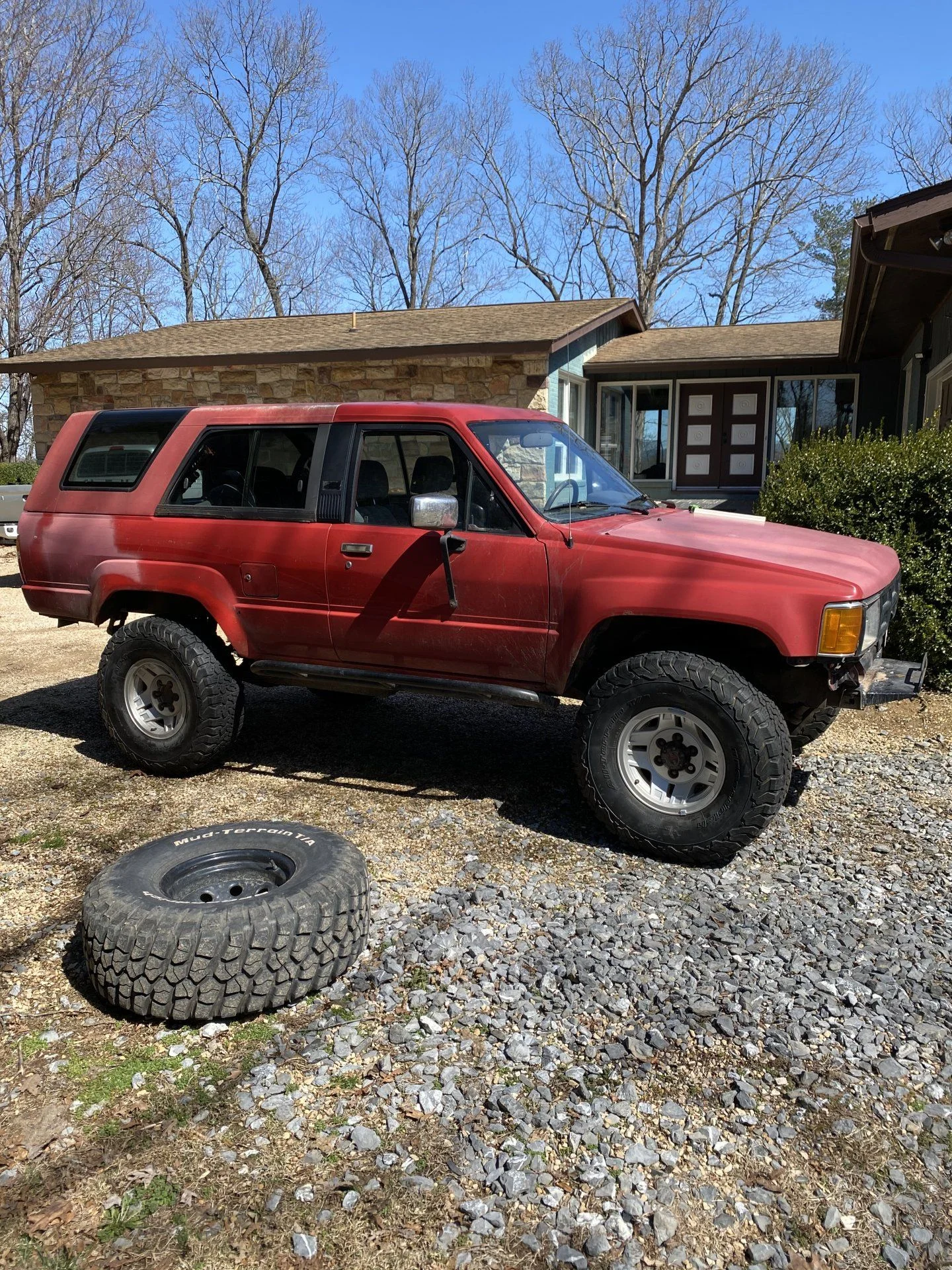

35s, sliders, soft top, half doors
Airing up after a wheeling trip
The tires rub the fender lip in the rear, but nothing too serious. The biggest hindrance to wheeling hard trails is being open/open, zero articulation, and the 4.7 case. Crawling is impossible - it’s third gear and momentum over every obstacle.

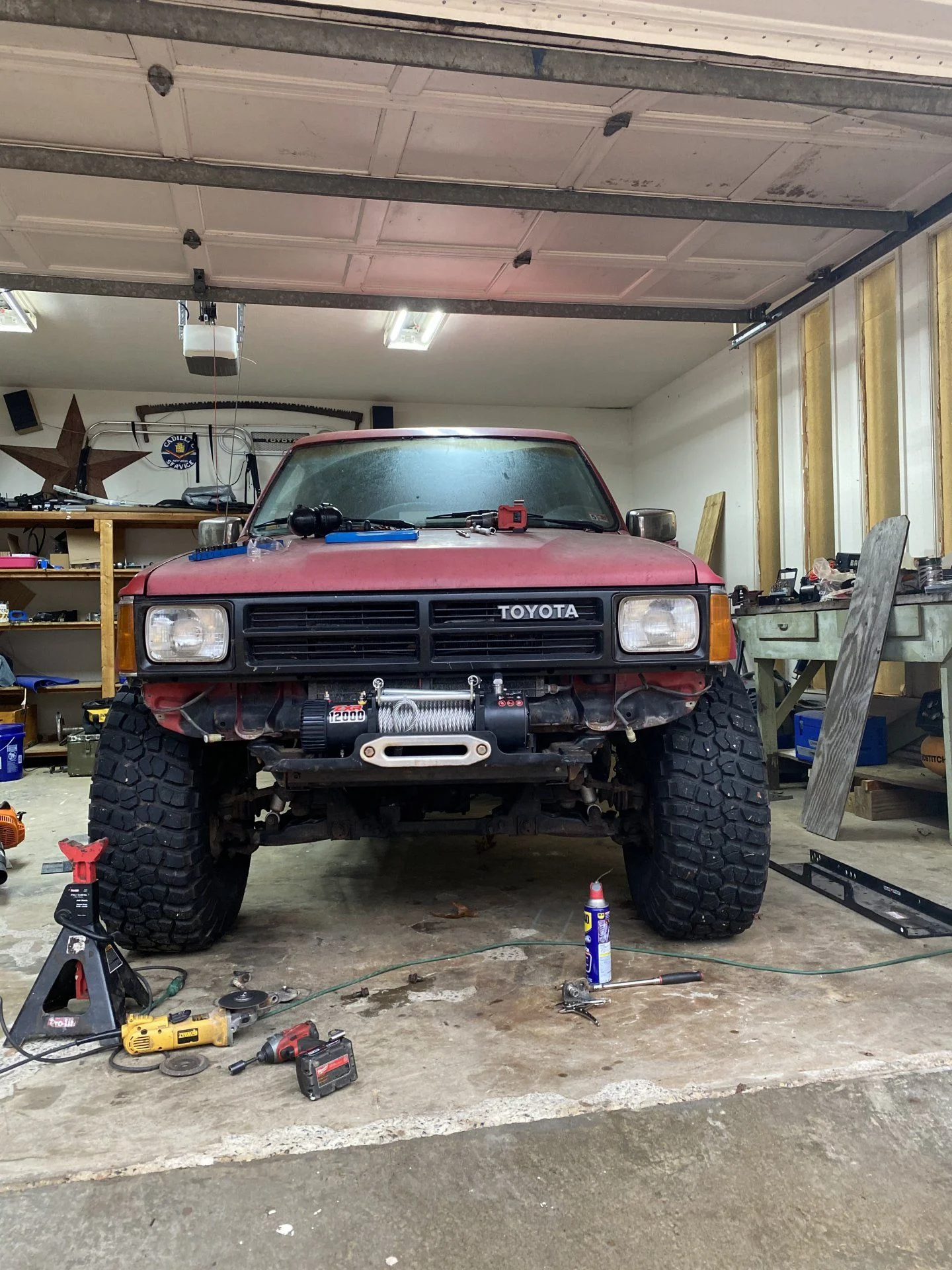

I’ve started on a winch plate so I can keep up with my buddies LS powered CJ on tons.... at least I can use my $300 (how is that possible?) Chinese winch to drag me through obstacles.
that front cross member took a substantial amount of reinforcement. I’m aware that I need a roller style fair lead for that cable.

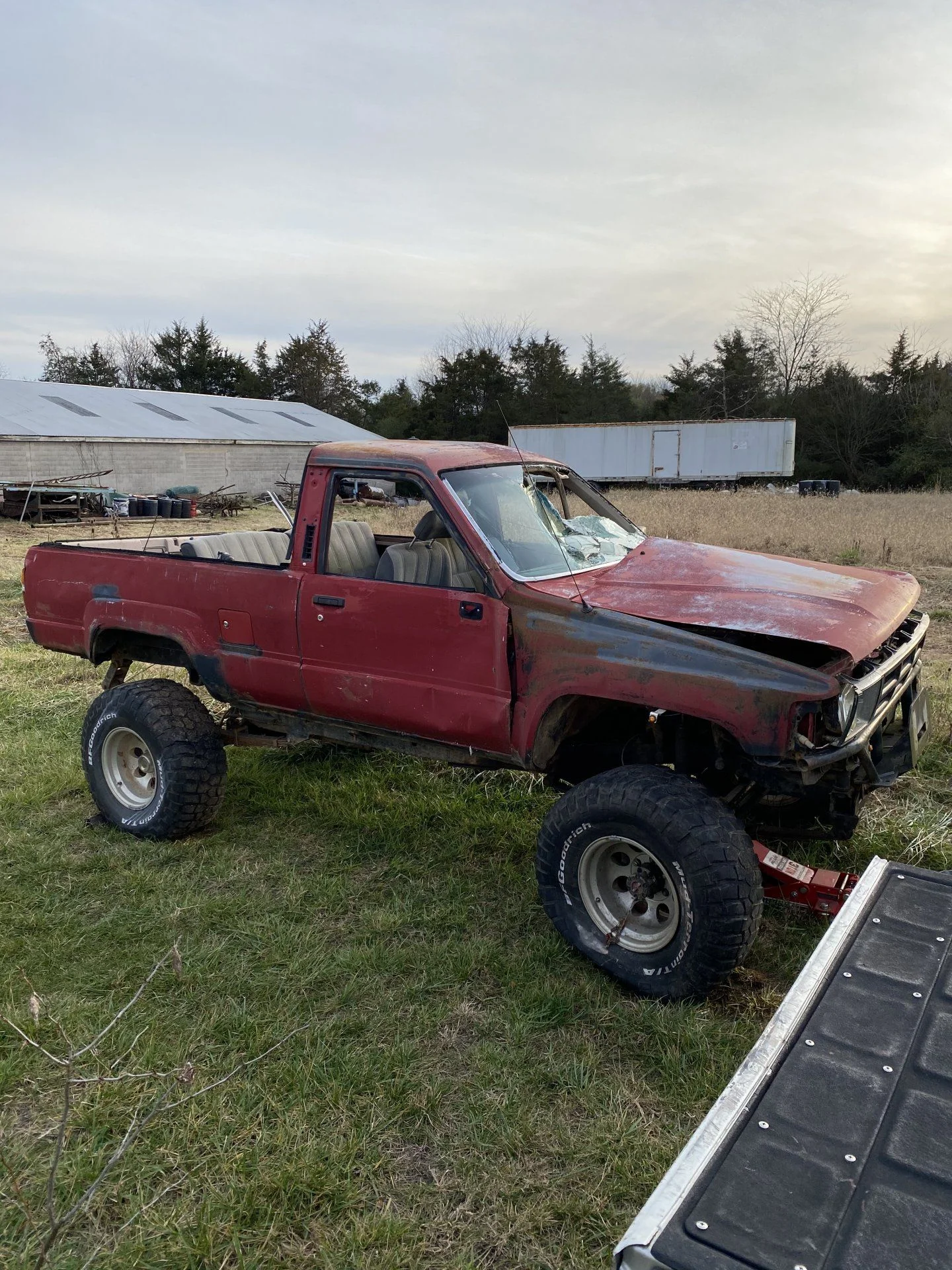

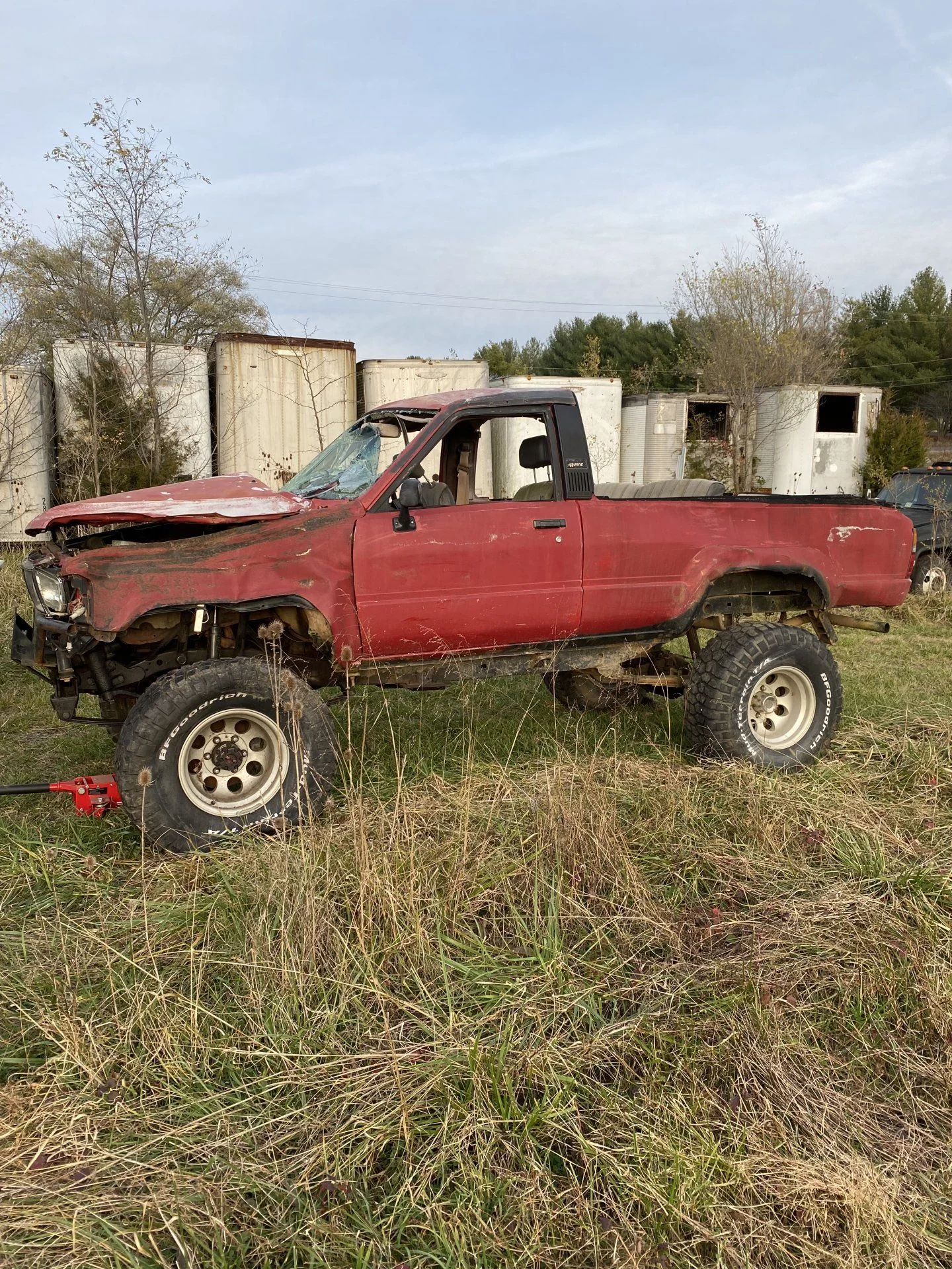

Obviously the body is toast, but the ‘85 frame appears to be in great shape. I’m really only interested in the axles and stuff. Hopefully the items I want are usable and I can part out the rest of the vehicle. Plan is to get it running and driving around the yard and then pull parts. Woohoo!

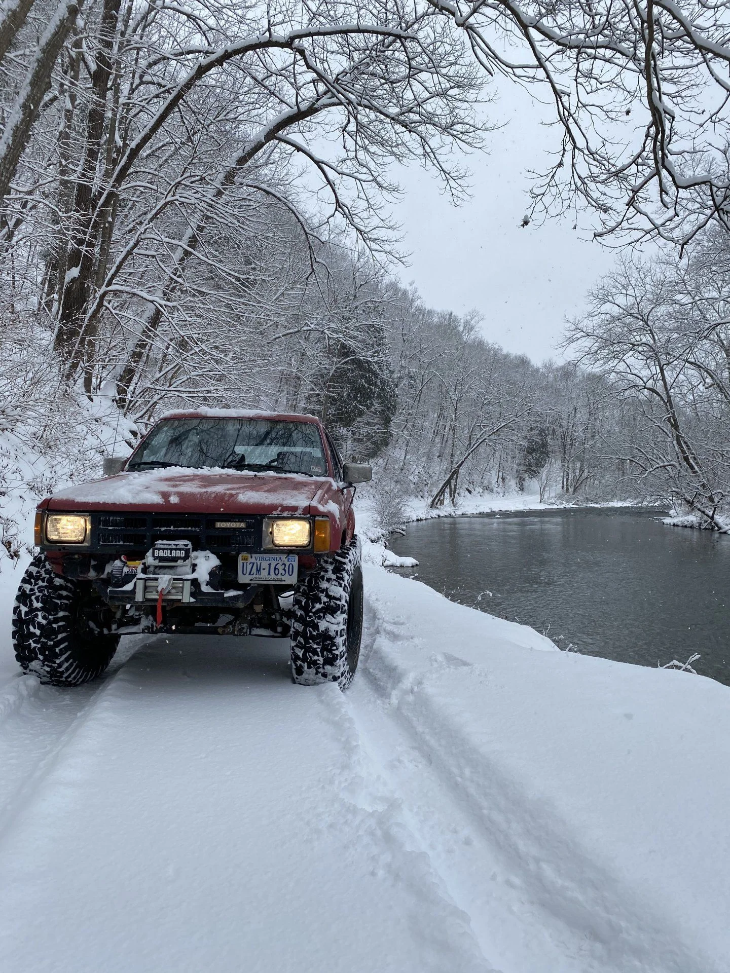

We got some snow!! This is the first time over ever had the 4runner in the snow. It worked very well.

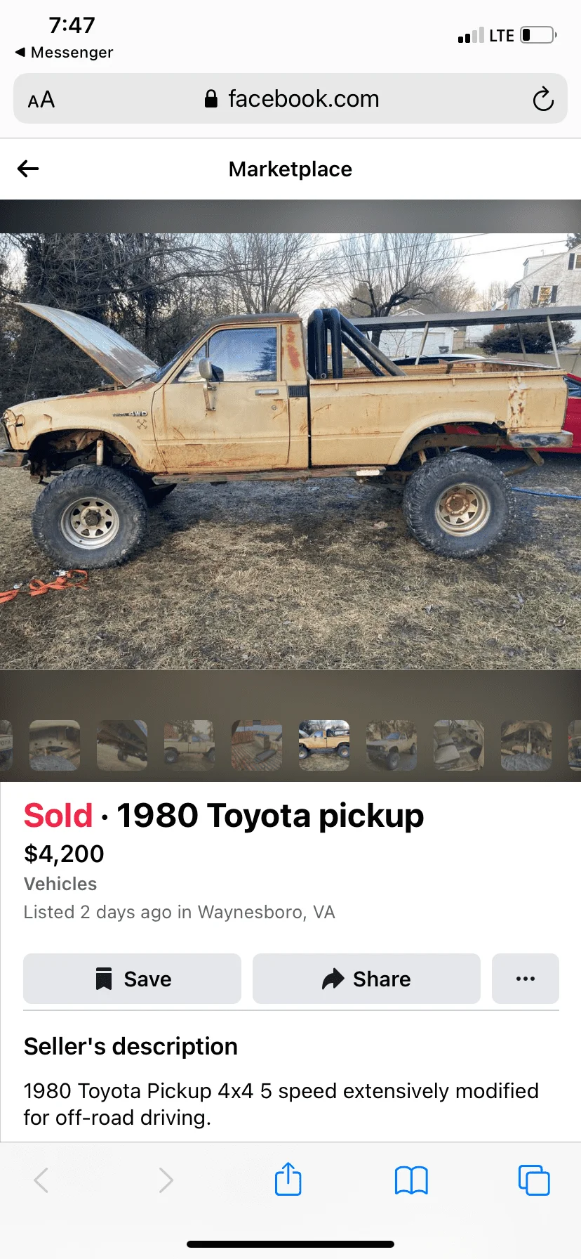

I also bought this truck that has been around the forum for a while. I was going to sas the 4runner but now I think I might put that on hold. The 4runner works amazingly as it is. Easy to drive. Needs nothing etc.
I have been in love with this truck since @yotadude520 was selling it in AZ. Turned up on marketplace 8 miles from my house in VA. I’ll start a “build” thread when I get it home. It’s in rough shape, but fingers crossed, the bones are good. Goals are to freshen up the interior, go through mechanicals, and save the patina if possible.

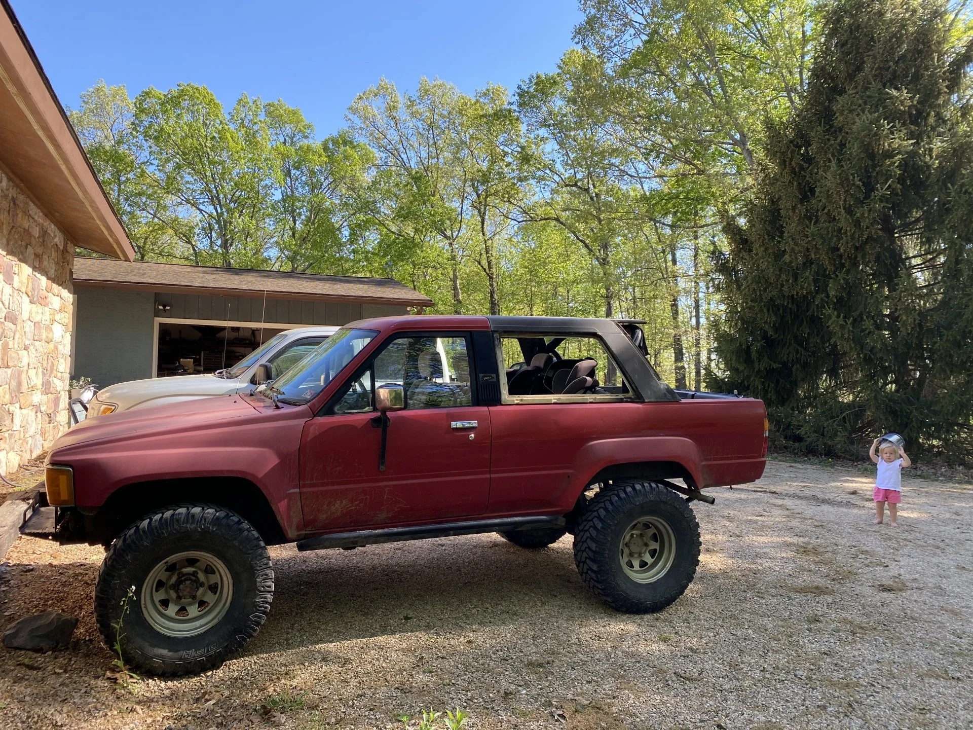

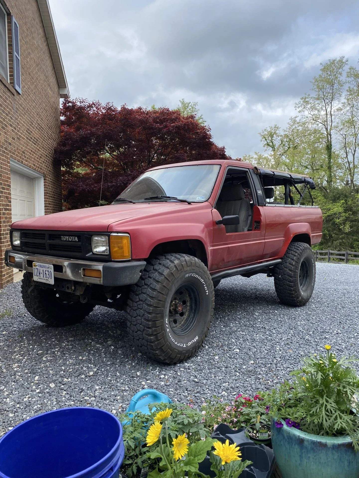

Got a hardtop from a buddy and “built” a half top. It’s a lot of fun. Keeps the sun off the kids, but still gives the topless feel. Needs paint and some finishing, but I’ll get to that in 2 or 3 years.
Great looking 1/2 Top! Any chance you still have the L molding that you took off from the windows? Mine have a bunch of rust pinholes in them
