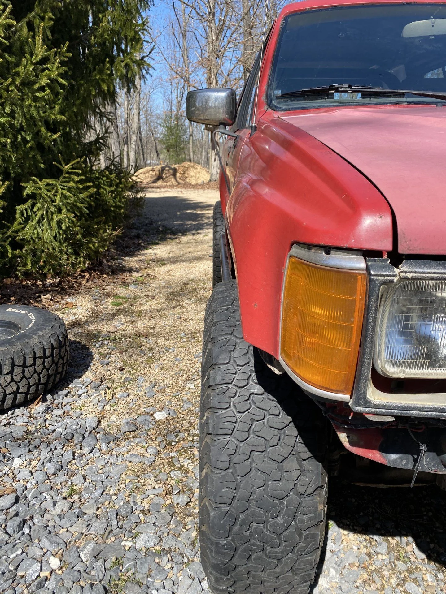

Rubbing what? I have done some pretty extensive cutting on the front and rear of the 4runner since I was running 35s for a while. Now on 33x10.50s I get zero rubbing. Didn’t have any rubbingby in the front ever with 35s, 305s, or 33s. It was always out back.

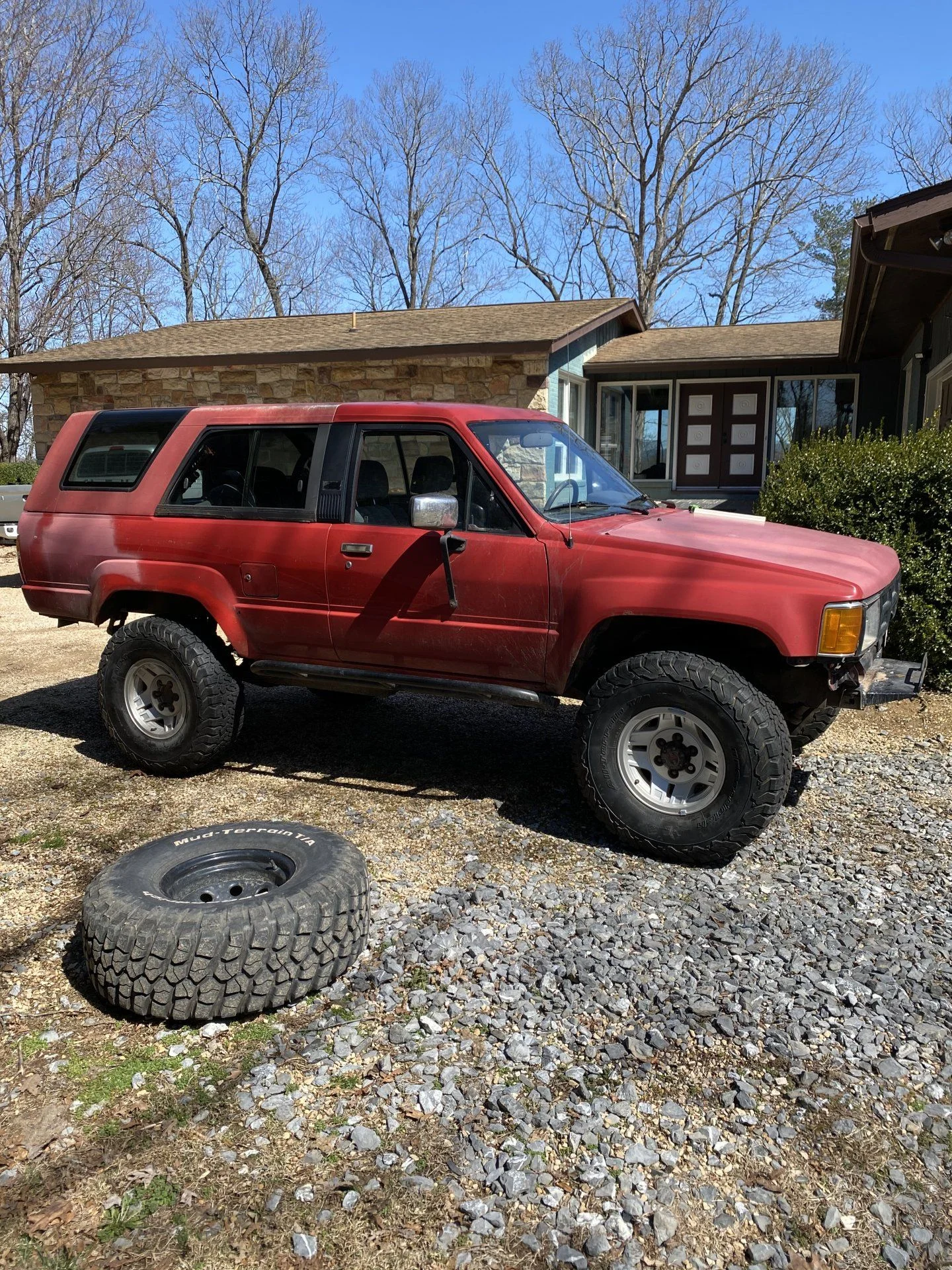

I may have just found the best (in my opinion) Toyota wheels for these first gen 4runners.
They’re off some 70 series. Look just like OEM wheels but they have a -20 offset. Back space is 3.5”. Here they are with 33x10.50s. I’m in love. Tiny bit of poke with the OEM look and no spacers.

None at all. Bolted on with no spacers and clear everything with room to spare. A 10.50 tire is perfect on these with IFS.

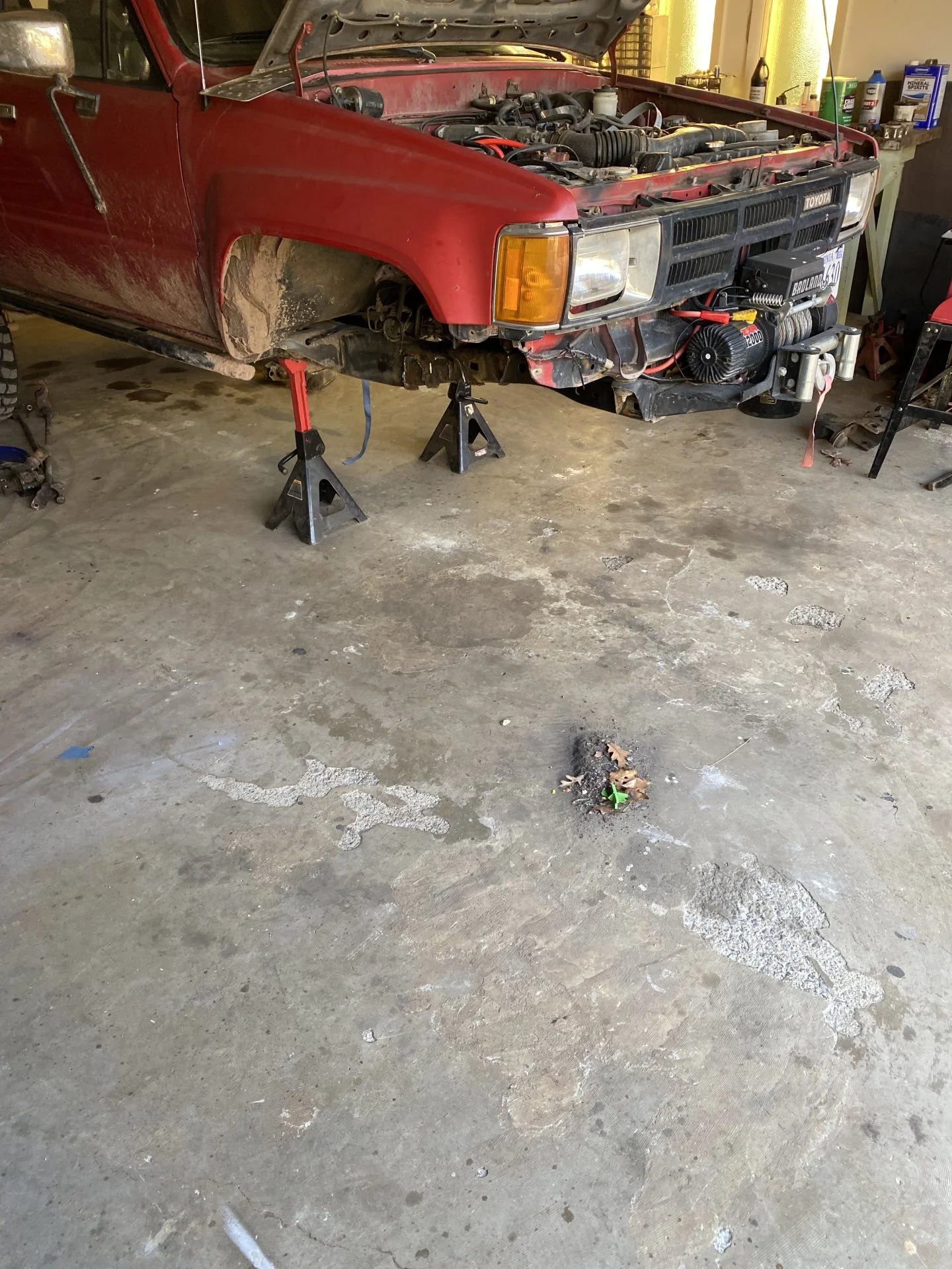

I unbolted everything before I started cutting. I’m about 33% done with the grinding/cleanup. I figure I’ve been at it for about 9.5 hours, but I’ve been moving slow and taking my time making sure I didn’t set anything on fire.
Hats off to the guys who do this with a grinder and a sawzall. I borrowed a plasma - the last thing I needed was a grinder injury before Christmas.
Update. Finished grinding. If that wasn’t the worst part of the SAS I’m not finishing.
I’m now figuring out spring hanger and shackle placement and how I’m going to drill those frame holes. Not a lot of room to work with in there. I think it’d be too sloppy if I used the plasma.

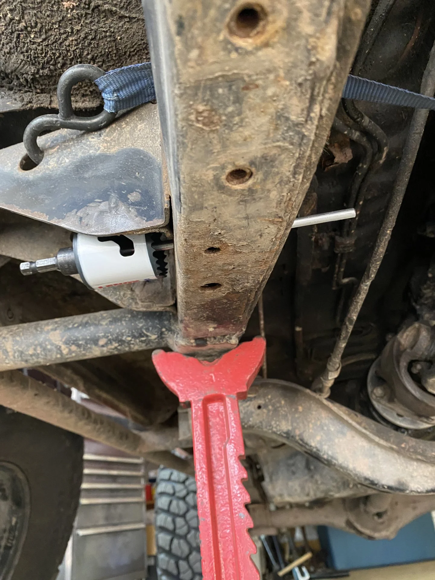

Drilling the shackle tubes isn’t hard, but space is tight if all you have is a regular drill AND sliders. I’m still trying to figure out how to do the driver side without moving the exhaust, but it might not be possible.

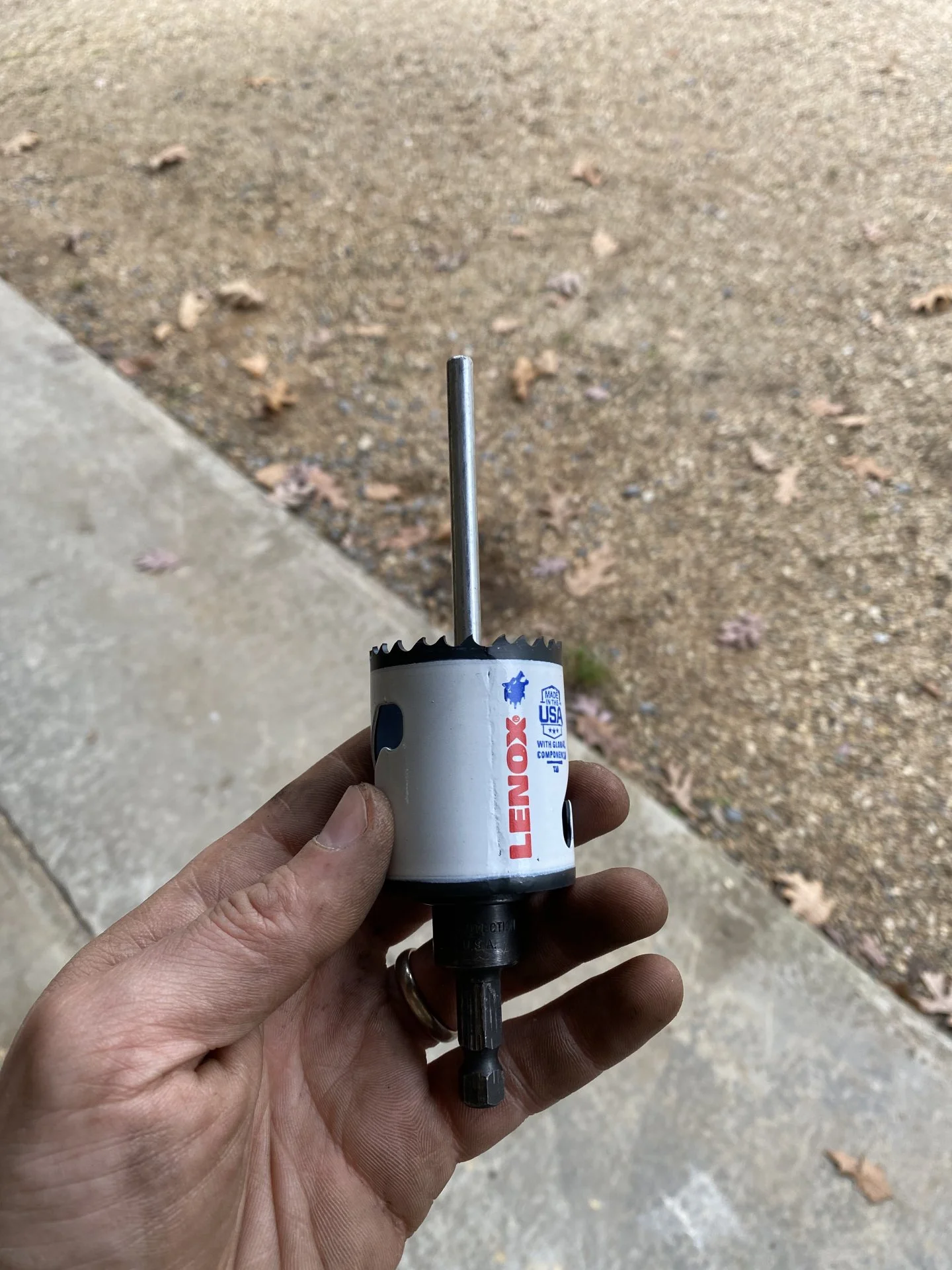

Using the templates and the 1/4” rod in the hole saw arbor trick makes it easy to get your holes where you want them. Go slow. Use lube.
