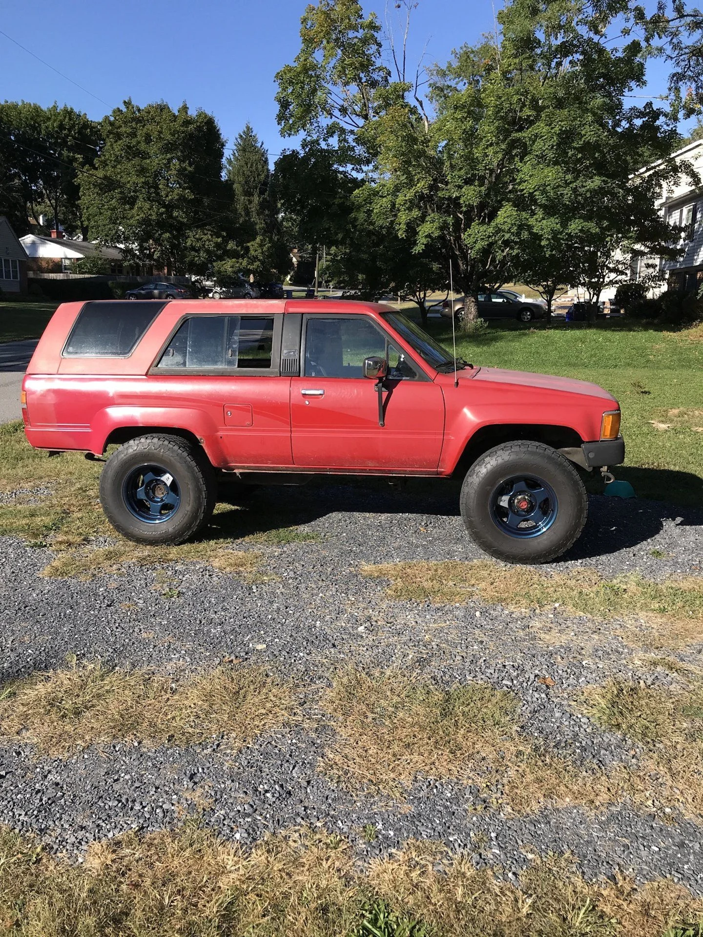

Small update. I bought a Tacoma that came with some SCS F5 wheels and 295s. Not sure if I like them on the 4Runner but they definitely weren’t staying on the Tacoma.

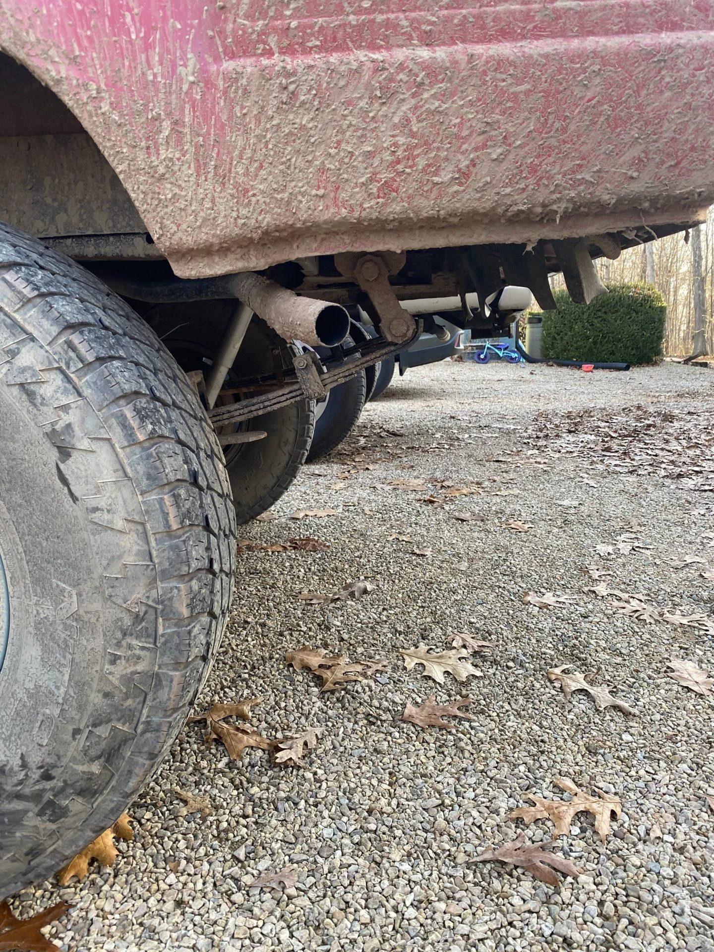

I’ve ordered some OME CS009r springs to get the rear up a bit. I’ll probably mix ‘n’ match with my stock leaves to get about a 1.5” lift in the back.
Otherwise I’ve been driving this thing and it’s great. On cold mornings the 22RE sounds like it’s going to explode, but it hasn’t yet so I’m just going to drive it until it does.

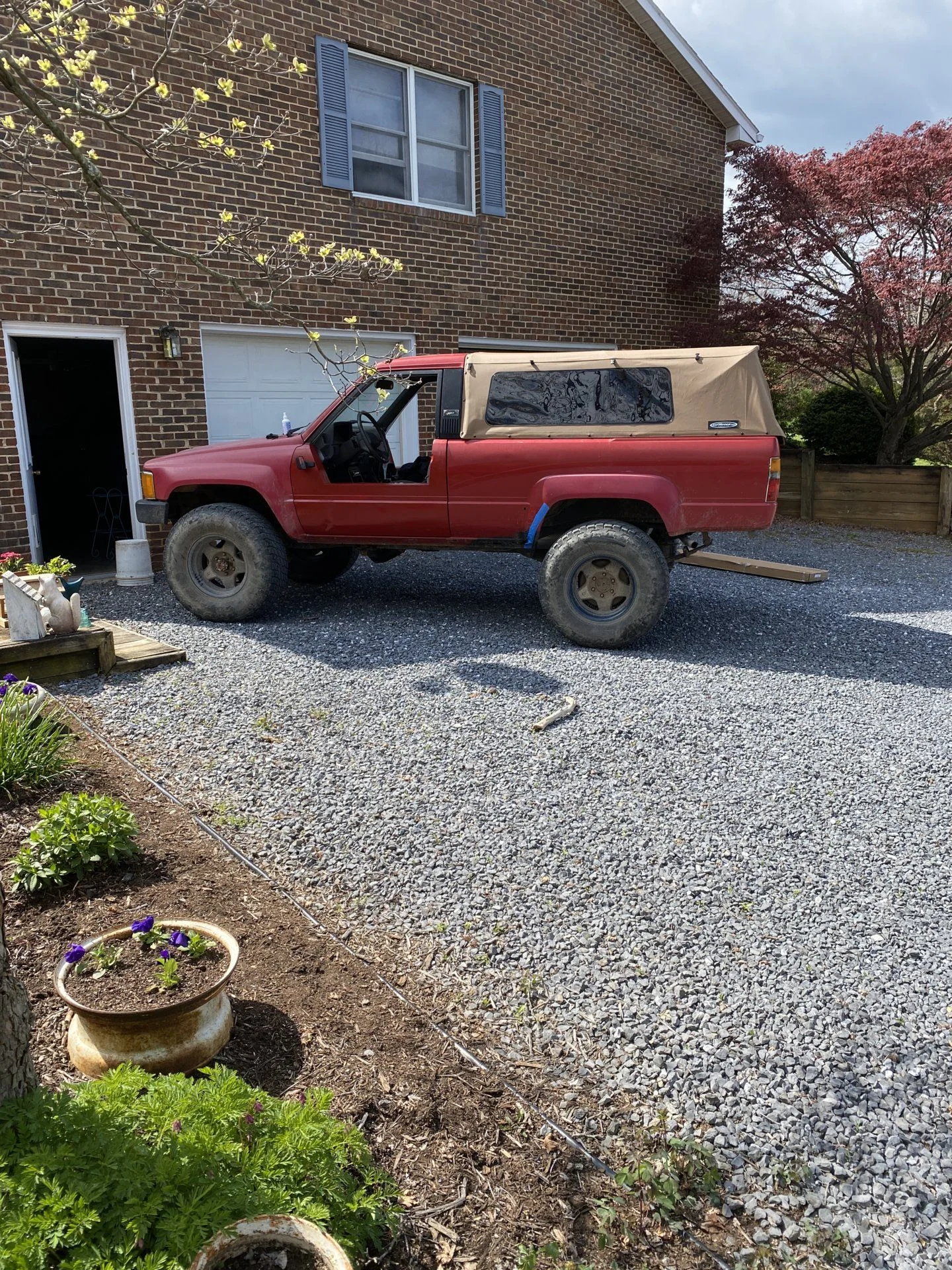

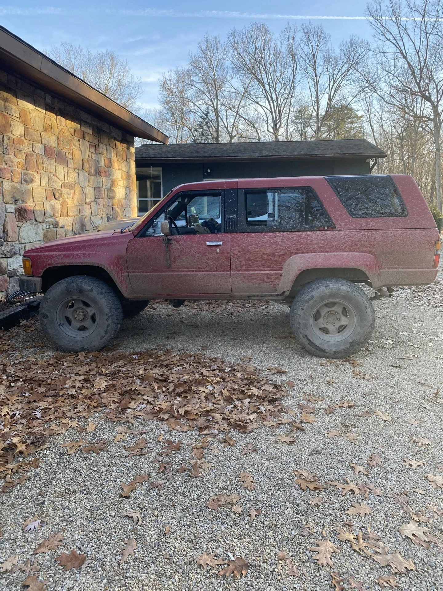

Shackle angle looks perfect from my livingroom!

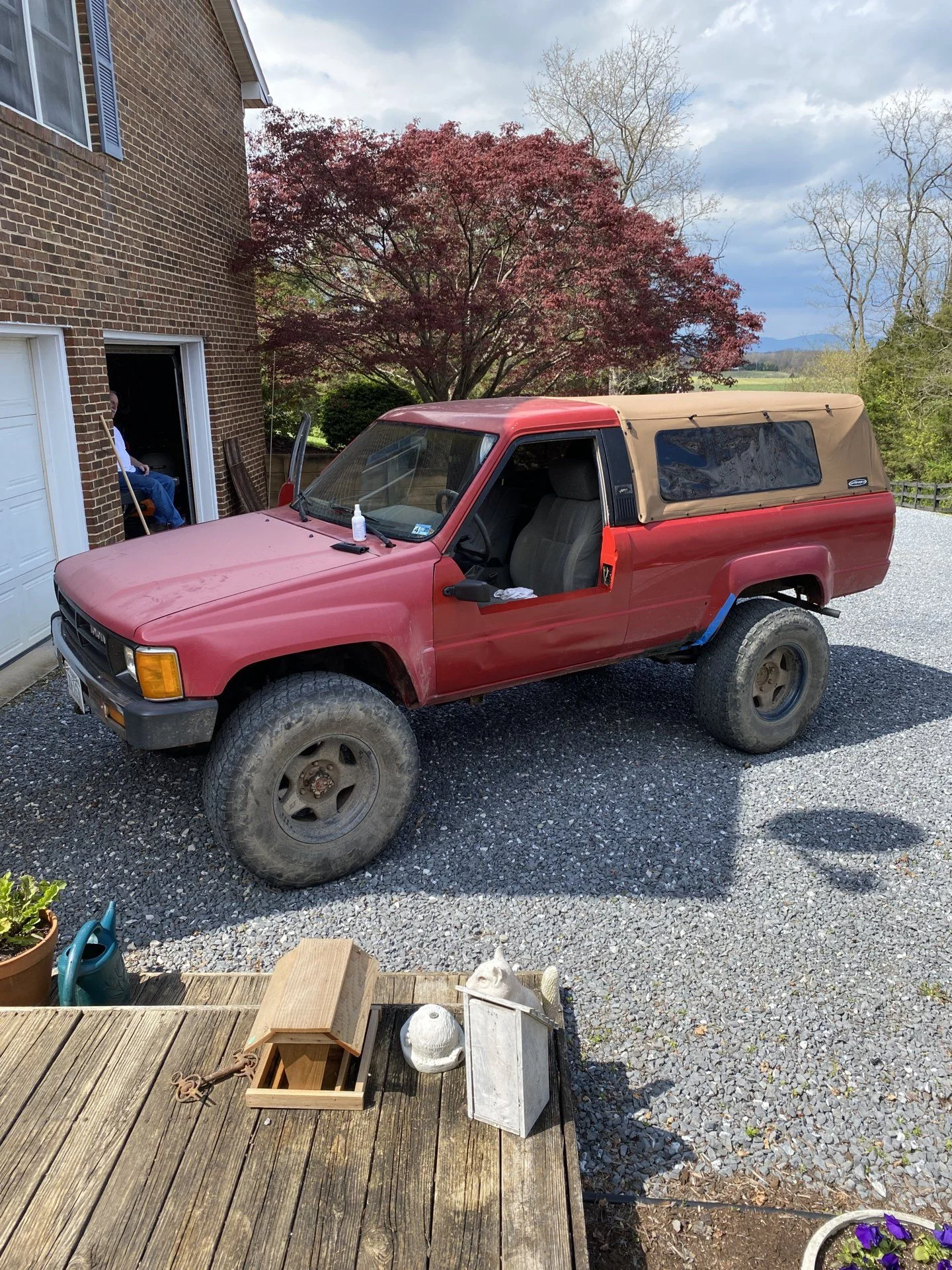

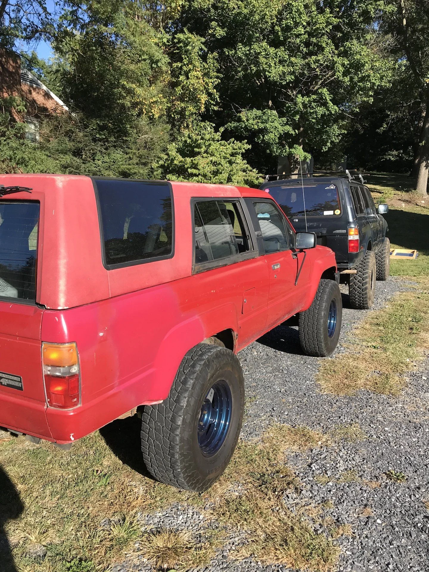

Softopper. It’s so rad. I hated the back glass. Now I’m thinking of doing the tailgate swap and cutting the rear quarters. This thing is a little rusty, it was headed to the scrapyard when I bought it, and I already trimmed the front and rear fenders to remove rust and eventually accommodate 35s - I’ve passed the point of no return.
My only complaint with the softopper is the snaps are a tiny bit off. I can’t slide the rail back anymore because the rear snap is REALLY tight but it leaves a bulge at the front where the side rail meets the top rail - you can see it in the pictures. I’m thinking of cutting down the side rail a tiny bit or remounting the snap on the side rail.
My Softopper is awesome. My only critique is the straps that hold the sides up when rolled. I don’t take mine off ever, as it’s shade for my dog, and the lack of a strap at the back is an oversight. The last 16” or so unravels when it gets hot (the only time it’s rolled up). I added another strap about 3” from the back. Now it’s perfect!

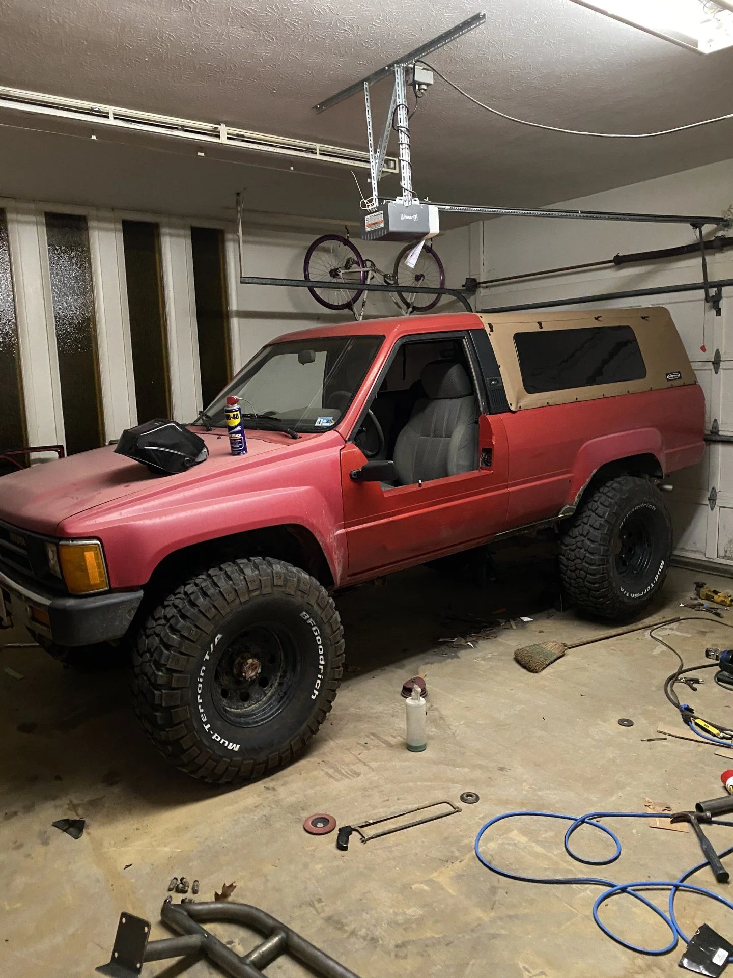

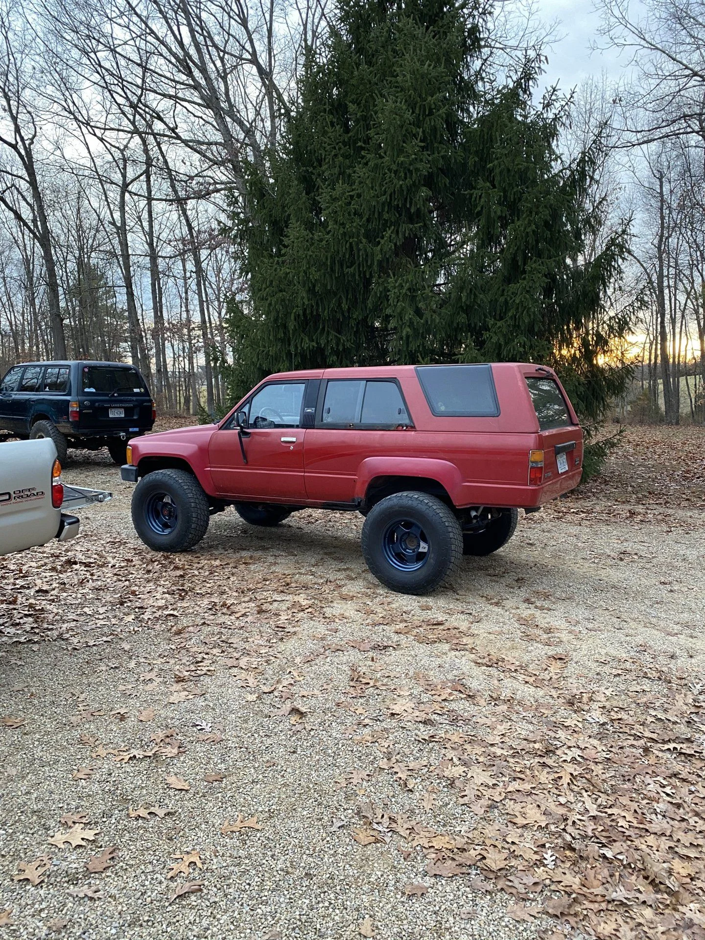

Welp the boredom of social distancing finally made me buy something. Found a set of almost new 35” KM2s on steel wheels for $600. I couldn’t pass them up.
Compared to the ratty old 295 nittos:
And shoehorned on the 4Runner:
its actually not going to take as much trimming as I thought. I had already trimmed some in the rear to eliminate some rust. The front will take some work but they are close.

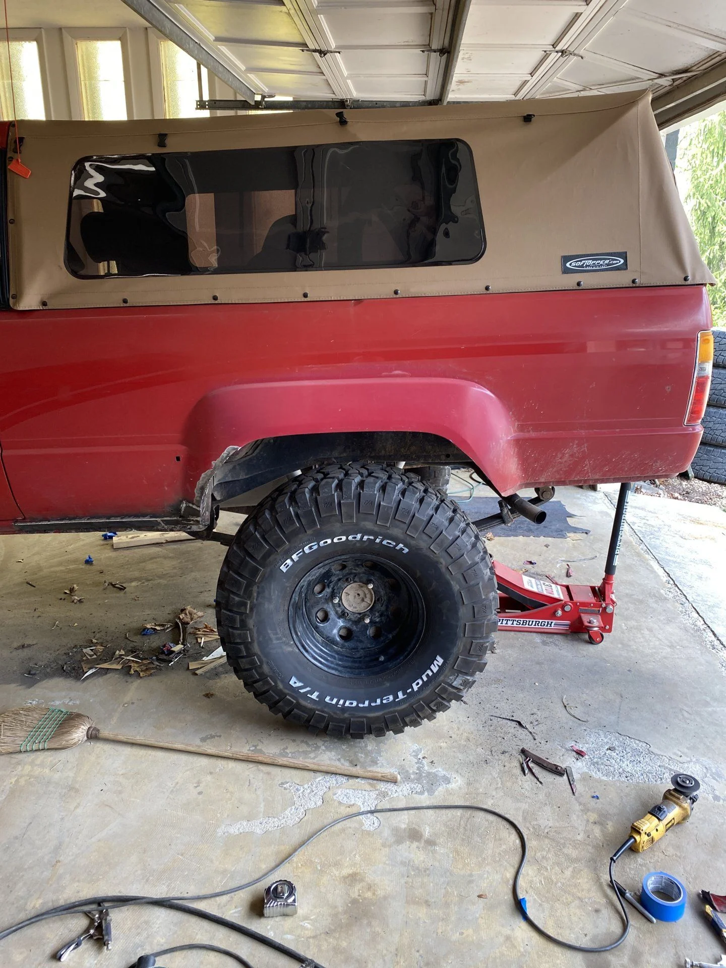

Got the rear trimmed. Probably went a little wide but there was some rust that I wanted to get rid of.
Front just needs a little trimming behind the tire. Then I get to weld (booger) in sheet metal - my favorite.
What is the best way to clean body sheet metal for welding?. I usually wire wheel, then sanding wheel, then wire until it’s shiny clean, but I can’t get decent welds. Seems there is always a little bubble that pops out when stictching panels together.
