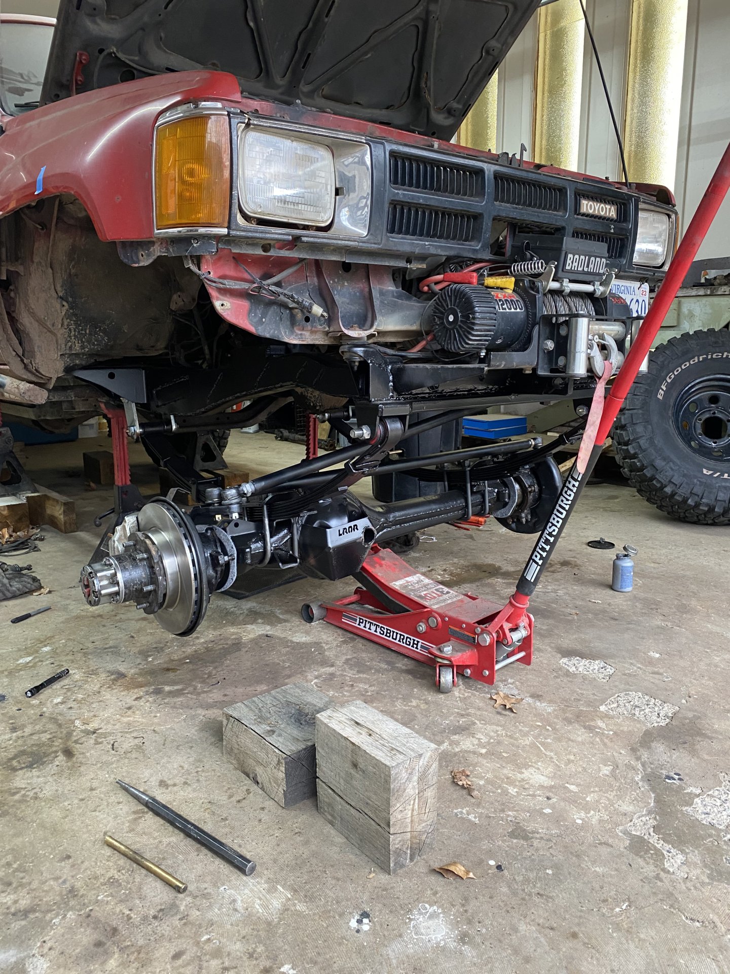

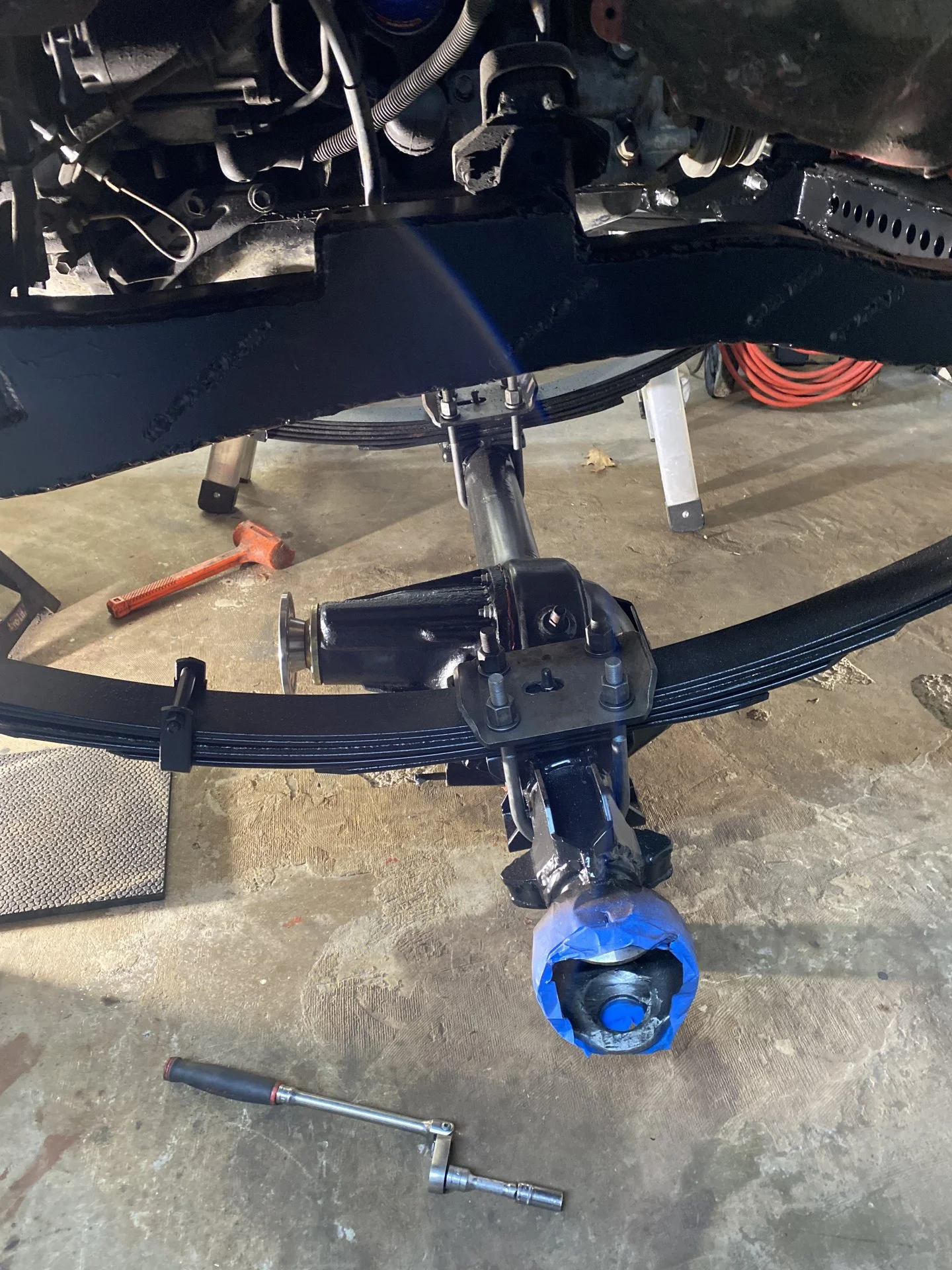

Finally making some progress putting things back together.

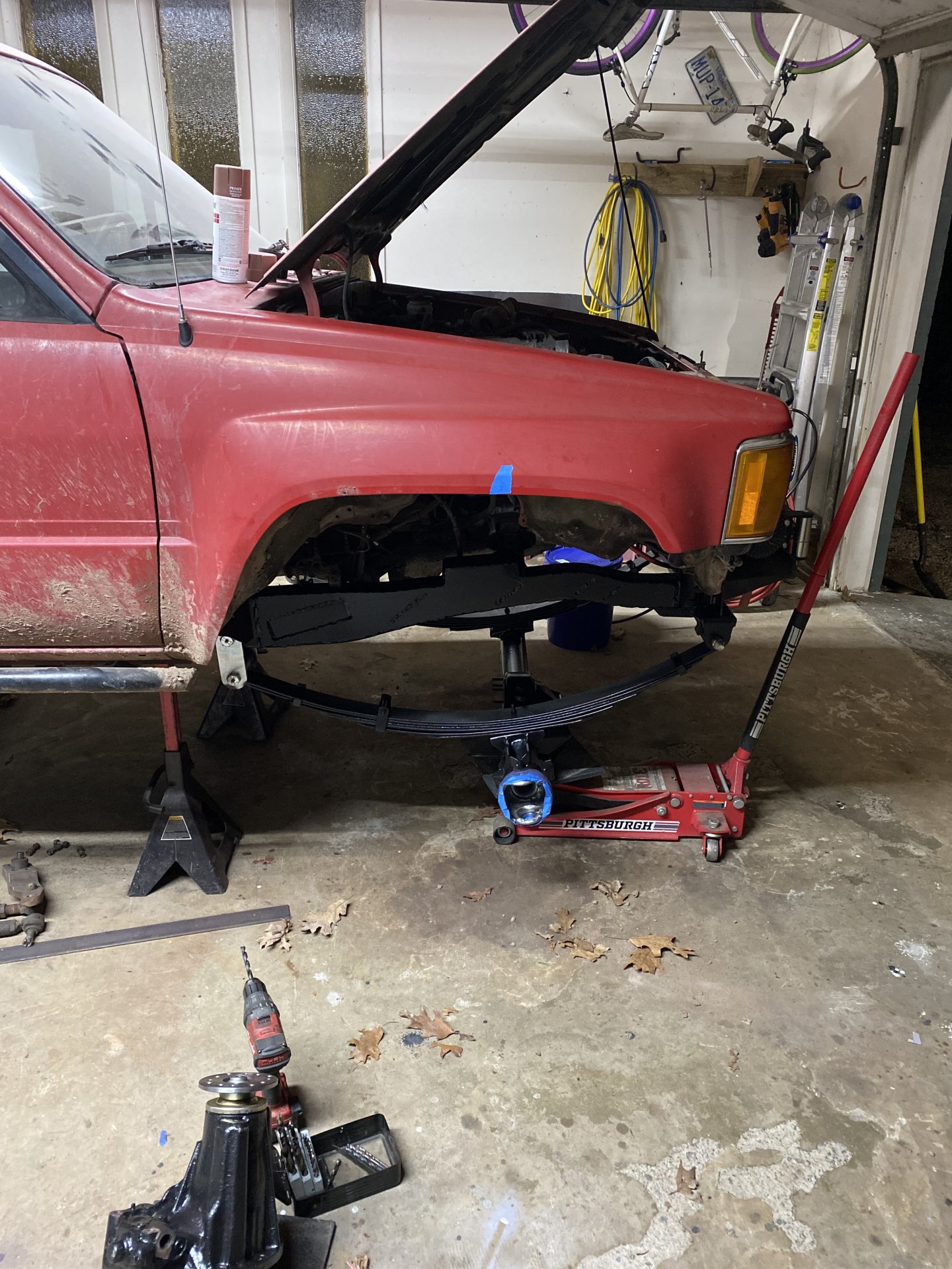

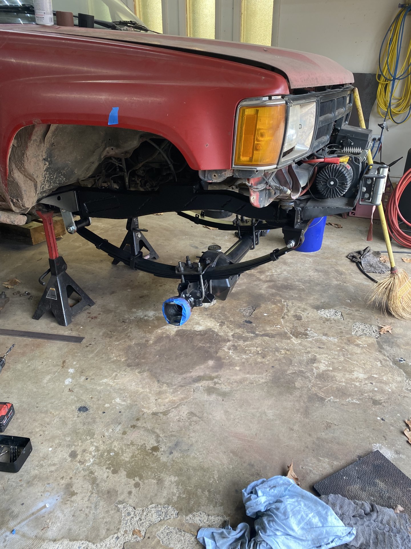

Steering box and axle are bolted in place.
The blue tape is about where the axle centerline is when springs are at ride height. Seems really far forward, but I think having a tire in there will change the perspective.
Now to shoehorn the Elocker in there. It’s going to be a tight fit.
with the shackles at the REAR (correct location for shackles)......

Got the high pinion elocker in. It’s a tight squeeze! Had to countersink a bolt, but everything else juuuust cleared. We’ll see what else needs to be clearances to get the motor on.
Preliminary measurements indicate that I MIGHT be able to use a factory Dcab tundra driveshaft for the front as long as I have a single case. Measurements are VERY close.

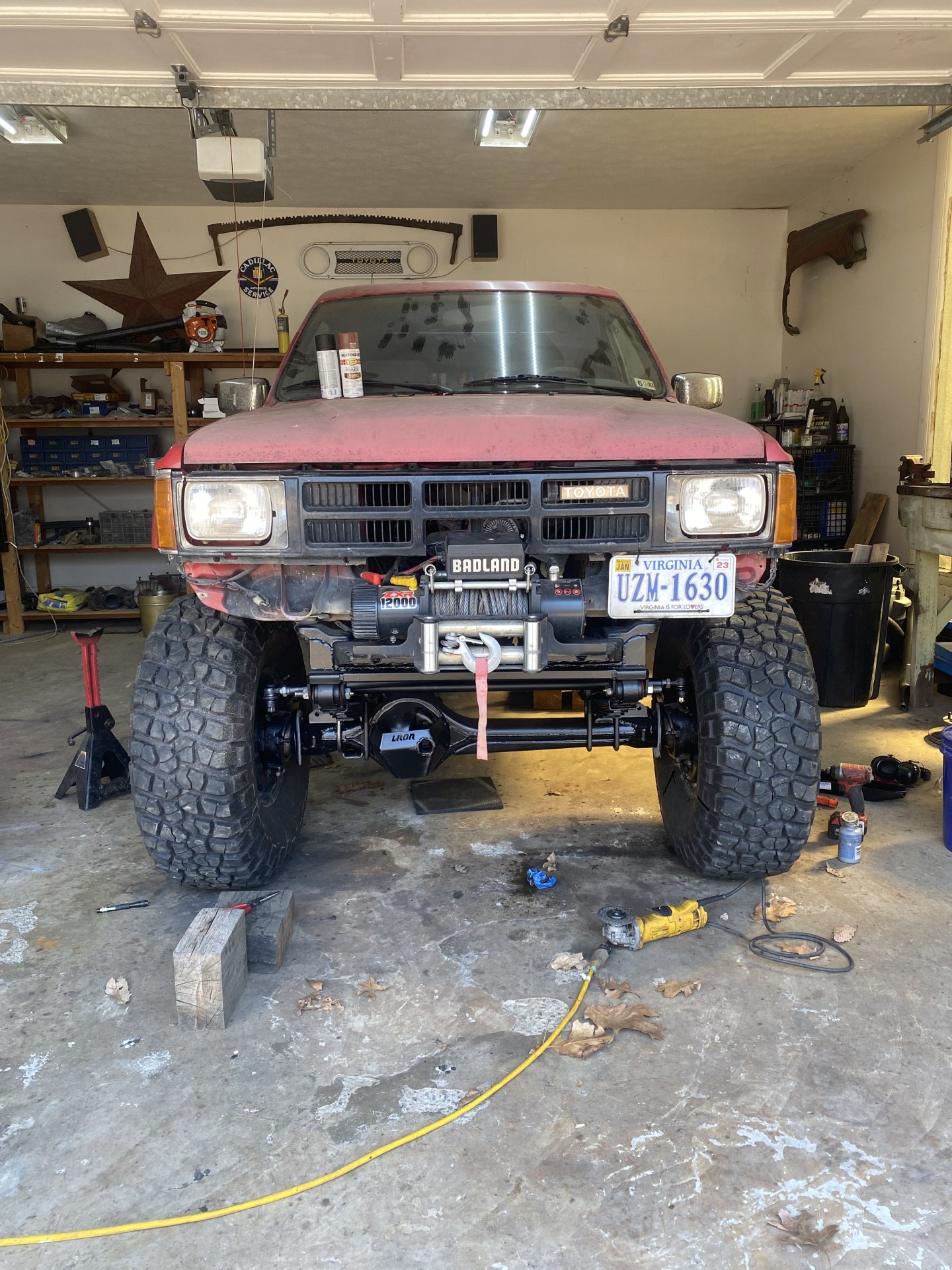

Well @davidp14 I slapped some wheels on it. I’m waiting on spacers to widen the front out a bit. Front axle rebuild went great. I still need to attach brake lines, shock towers, wire the Elocker, and do bumpstops.
Height turned out great. Back end is sitting on stands about where I want it and it’s at about 24.75” to the frame under the doors.

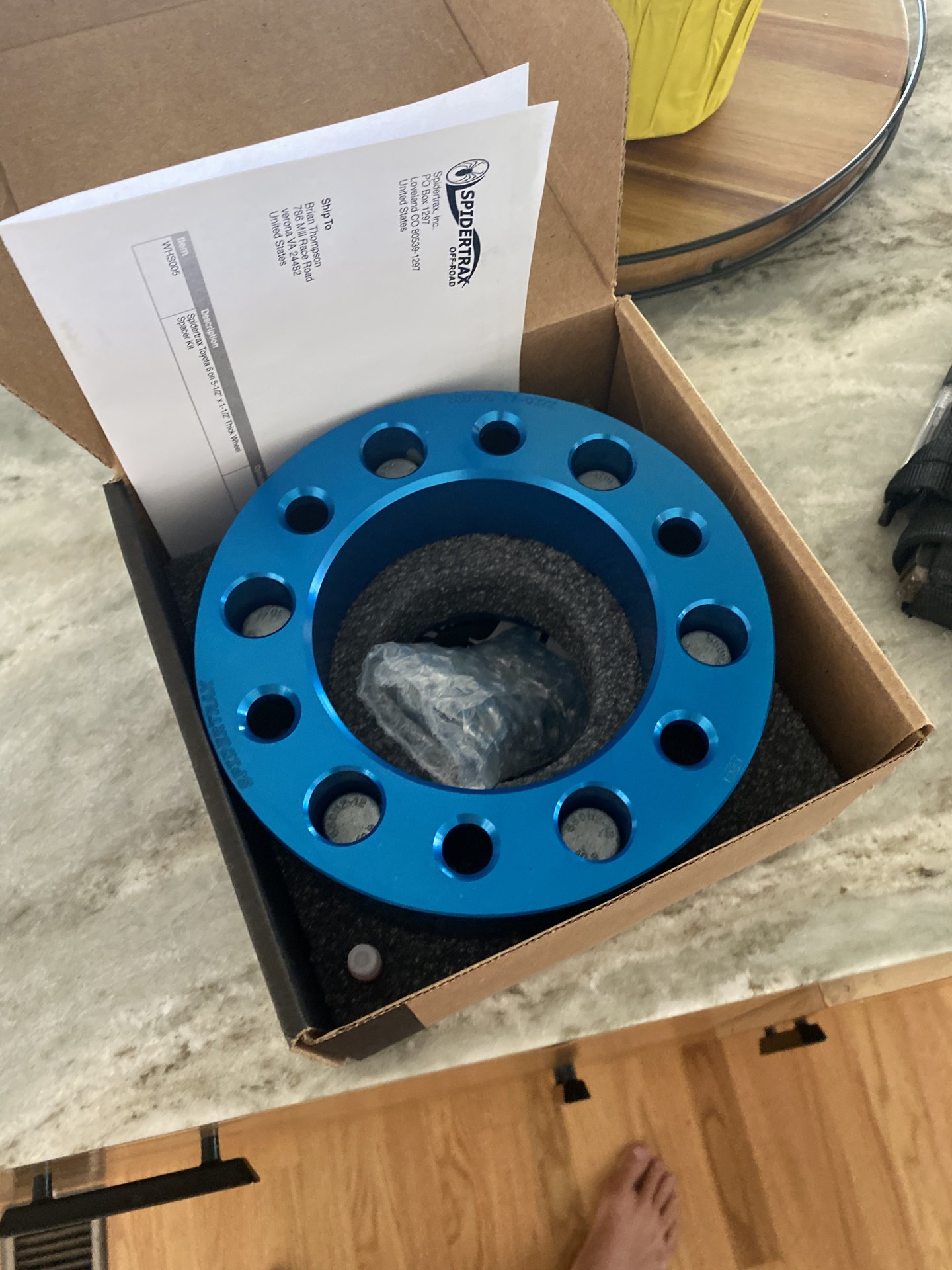

Got these fancy wheel spacers. Normally I would have used eBay spacers a la Whistlin’ Diesel but i just couldn’t do it.

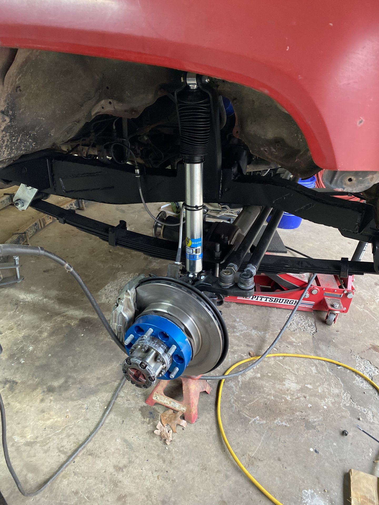

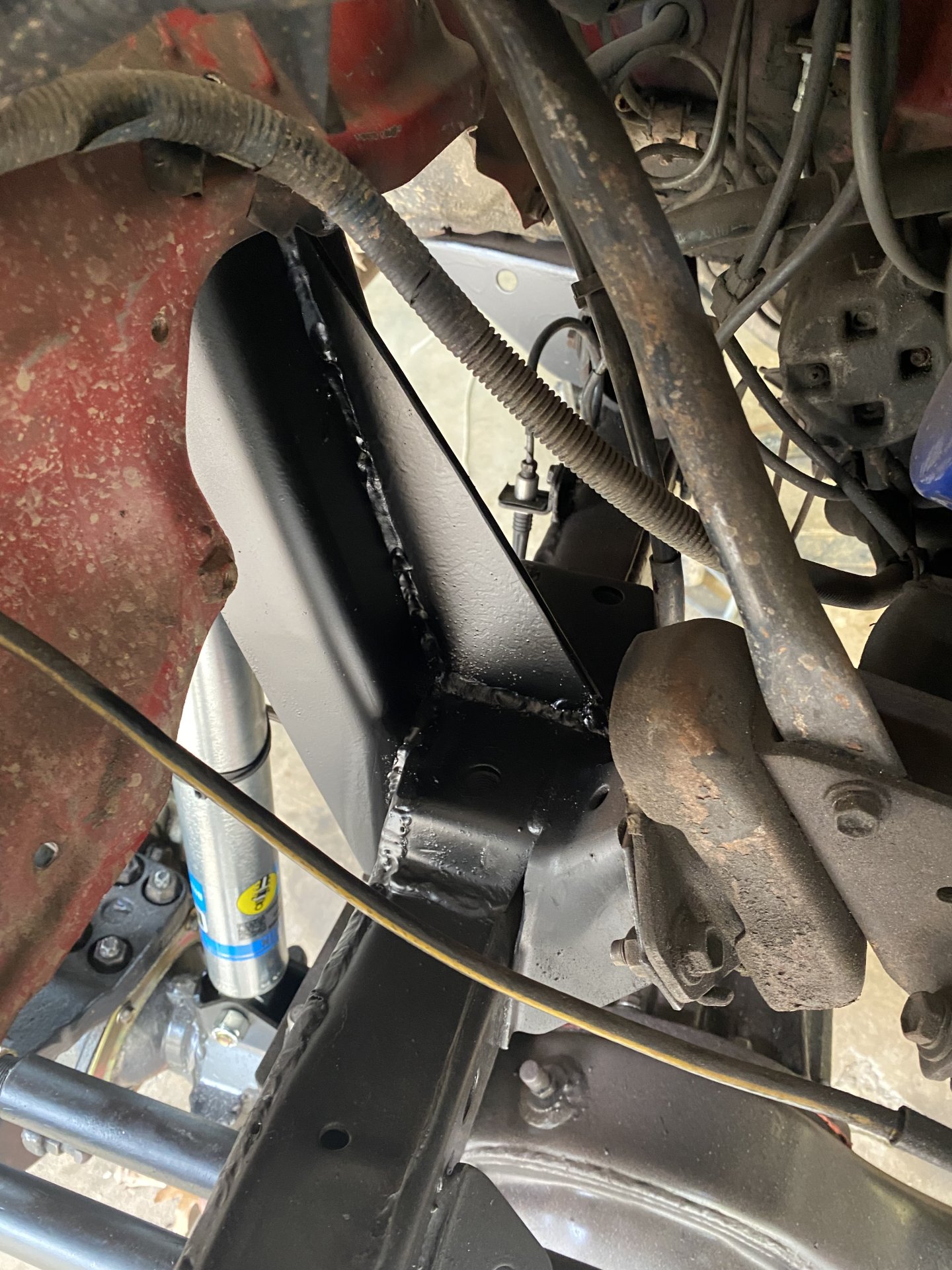

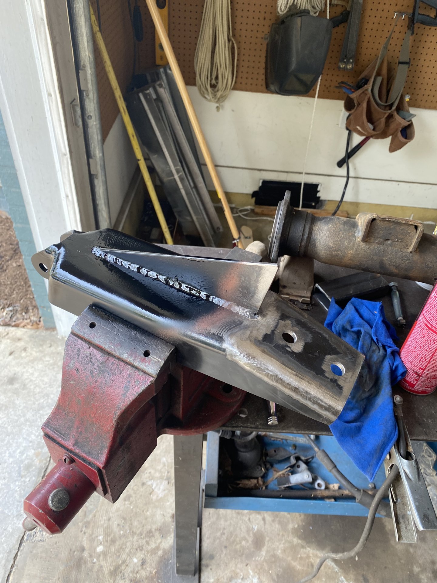

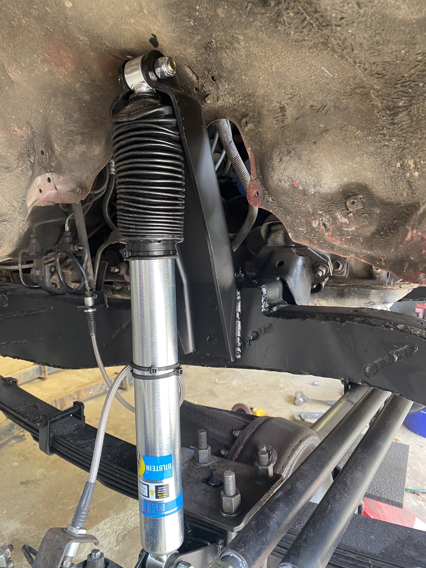

Ordered some 12” travel Bilsteins for the front and started prepping the Ford shock towers. I have hoops that I cut off a parts rig, but I like how compact the ford towers are. I’ll put a giant gusset on the backside and they will be welded to the Ruffstuff frame plates. I think they’ll be fine.
Pretty sure bils go cans up.
Plus ive had hysteer arms contact shock cans mounted down.
I was wondering that as I was bolting them in and I meant to ask. The writing on the can is oriented to suggest I have them upside down. In my head, the shaft just belongs at the top - that’s what I get for trusting my brain.
Thanks for pointing that out.

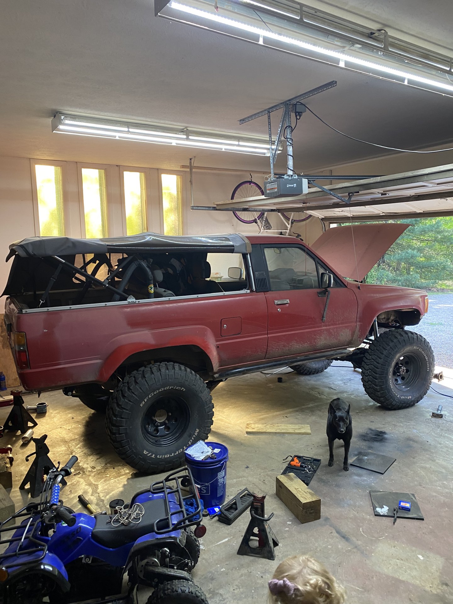

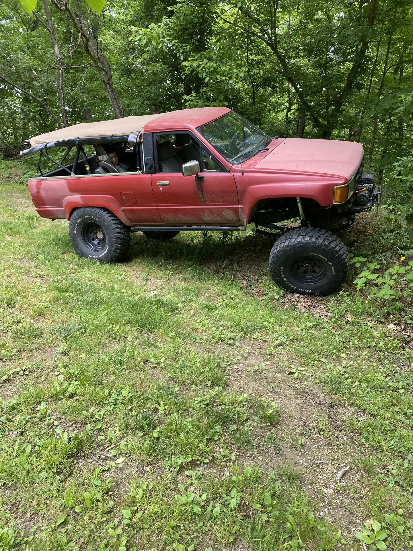

We’re sitting on all fours. Still lots of work to be done. Came out to a 3.75” lift over stock. I’m pretty pleased. Things may need to be tweaked after it settles. We’ll see. It looks like it’s squatted but it’s really not.

She lives! I put about 45 miles on it so far breaking in the gears. Drives really well. I outdid my expectations.
There’s the obligatory flex shot. It had more to go but I ran out of dirt pile.
Still a bunch of loose ends to tie up, but it’s safe and drivable. Going wheeling tomorrow. Wish me luck!

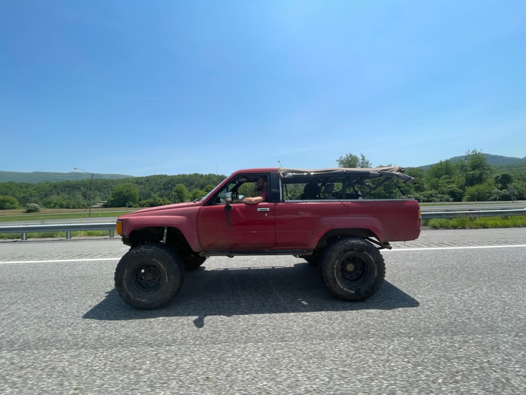

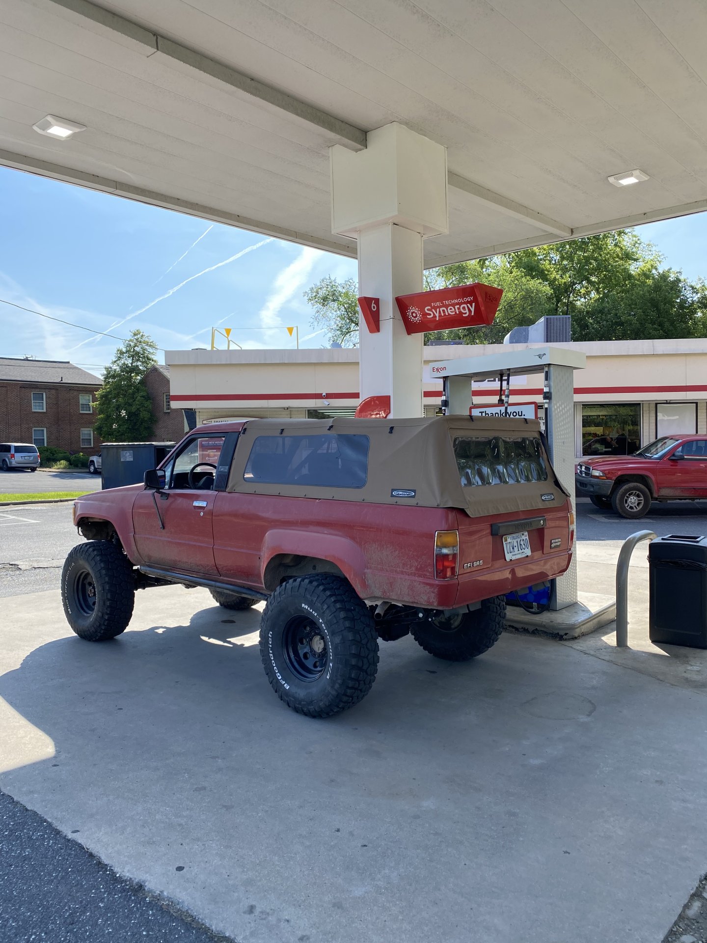

I thought I’d go wheeling and my front springs would settle. Instead the rears did, and now she squats pretty hard. Otherwise everything worked perfectly.
Single picture from the trail and the highway to prove I did both. I got denied on that obstacle. I’ve gotta get the lockers working.
It definitely drove better with IFS, but it is still very respectable now and the off-road ability was drastically increased.
