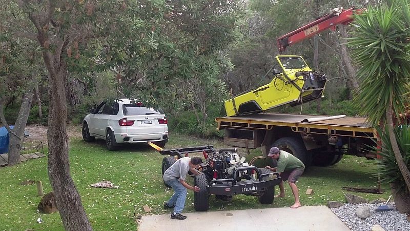

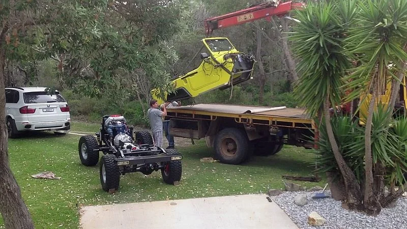

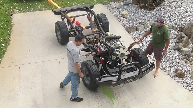

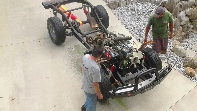

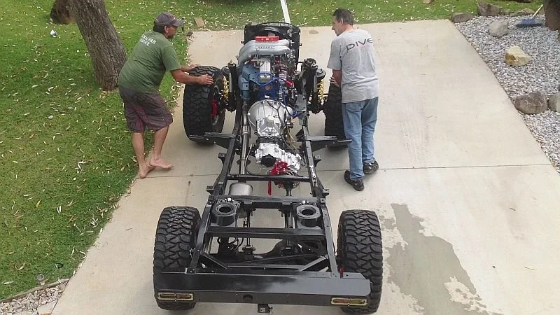

Here is the change over of the tub off the old chassis.
Pushing the old chassis back into the garage.

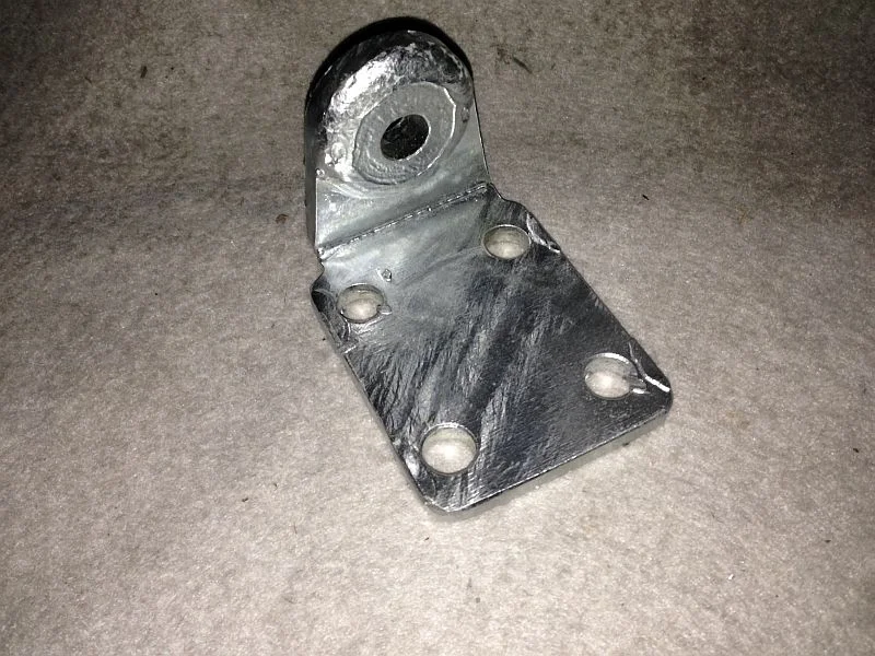

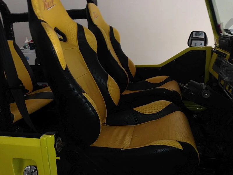

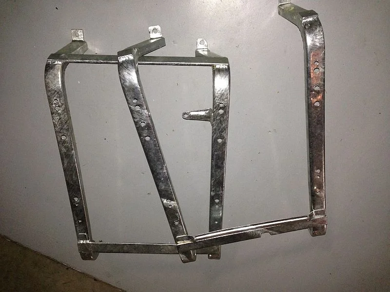

I dropped my two front sport seat brackets off at the galvanisers along with the steering dampener bracket, 24 hour turn around, ready in the morning for pickup.

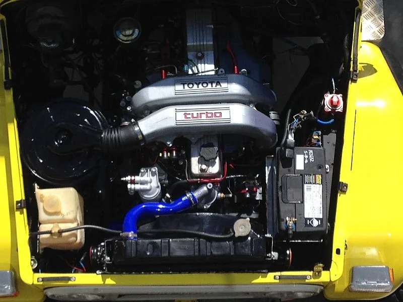

Will strip down the guards, bib & bezel on Saturday and repaint the inner sections and refit. The battery tray is finished and I bought a battery isolation switch also to install.

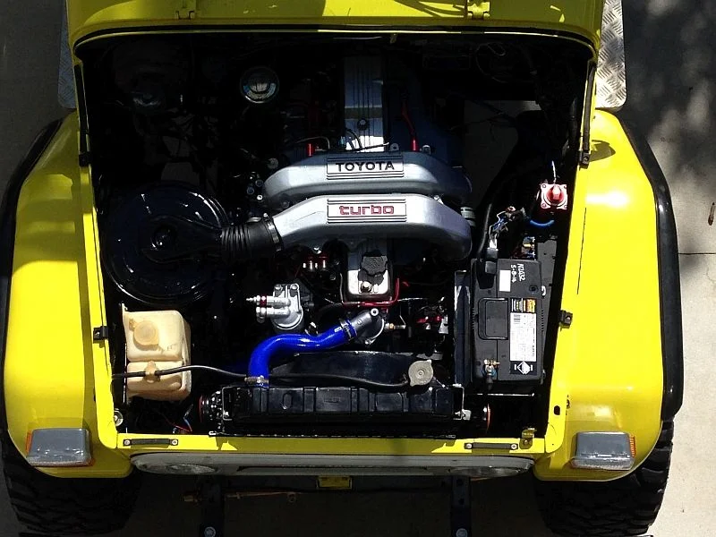

The battery tray is alloy and supported by the radiator surround bracket and the other end by the shock tower.

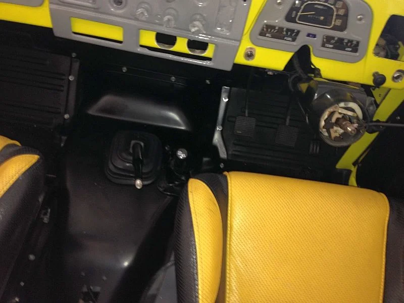

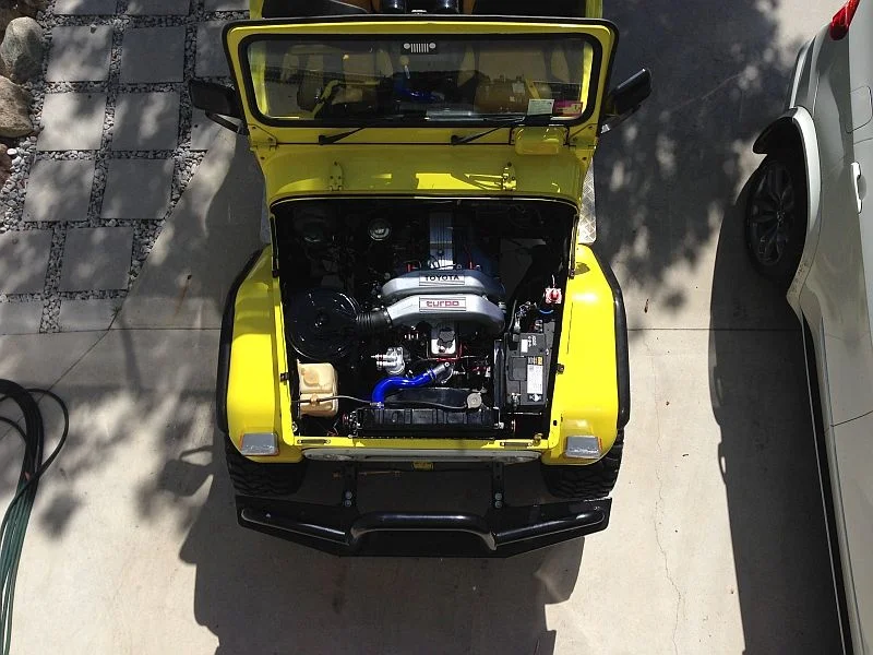

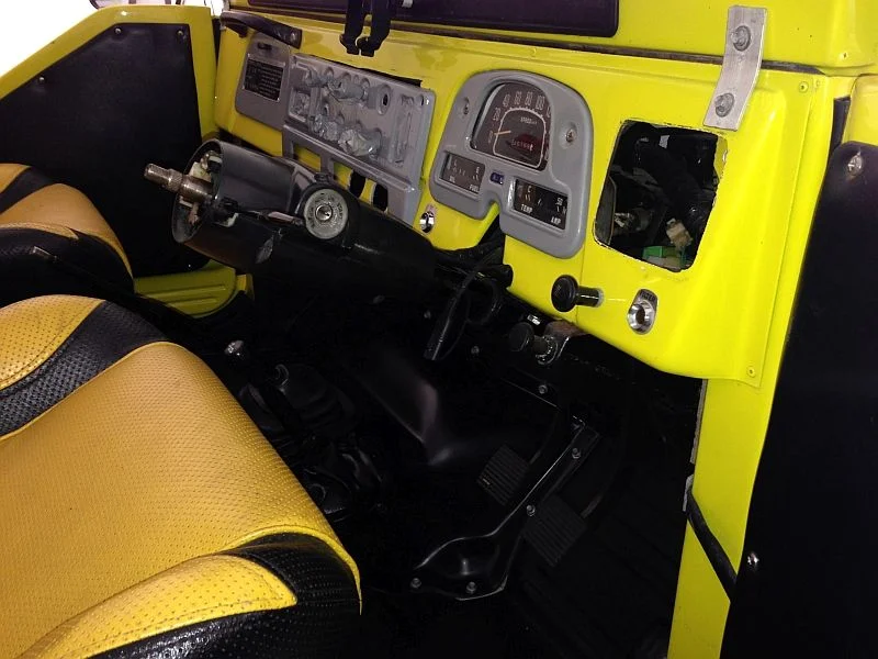

Got about 95% of the job list done, took a few photos, building the throttle dampener bracket took me all Saturday morning, lost fair bit of time. Re-fitted the guards and apron & bezel, installed the transmission hump after cutting out the areas for the gear & t-case sticks, fitted the long range fuel tank, fitted seats & seat brackets.

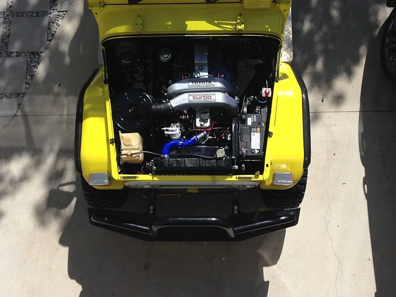

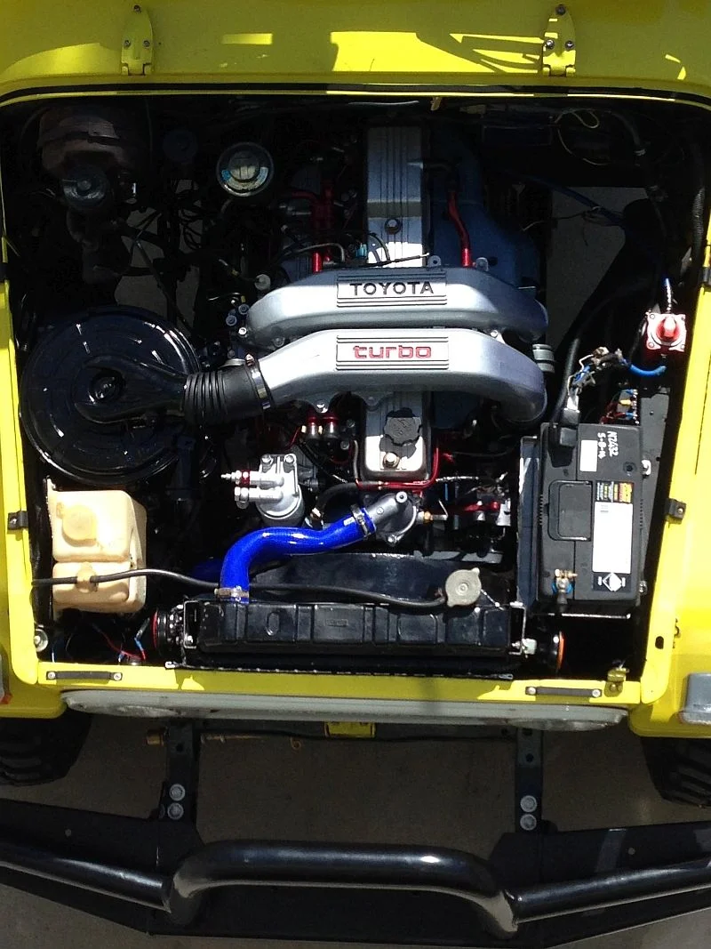

Installed the battery cradle & battery and finished off the wiring, checked circuits of glow relays & fuel relays, also installed fuel return line.
So I still have the bulbar to install & bonnet, wire rear lights & towbar, fit steering wheel, fit pyro & boost gauges, fit tacho and hook up the red & green boost lights and lastly install the air cleaner. Then there is probably a good afternoons work just cleaning up the 40 after it has been sitting for the last 6 months.
Well that was an interest Saturday, bleeding the 12ht was a 2 hour job, bleed the brakes & clutch and then re-tested the electrical circuits, fired the 12ht up and rev'd to 1400rmp and watched the oil pressure gauge.........................................................we have pressure, thank god.

As you can see I finally found a steel Toyota air cleaner that fits with 12Ht in a 40, the 2H version and the 12HT 60 series versions are to tall and are not level (to high) with the 12ht engine. A Hilux LN 106 fits perfectly.

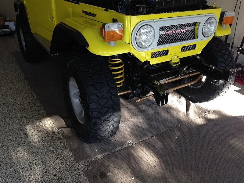

Suspension, its like slalom skiing, at 70kph you can throw the steering wheel from left to right & back as if going around witches hats, running 22lbs in the front tyres and 19lb in the rears. Swing the steering wheel right, the left front corner dips, left wheel bits and instant turn right, feel back wheels then bit, throw back to the left..
Now I have had leaf suspension 40's before, but coils all round its just so much of a different 40 to drive, I mean its still a short wheel base at 93" but where you hit a 2" set of deep ruts before you would brace yourself because you knew it would chatter up thru the seats, now its absorbed in the suspension, whereas the leafs would let it travel up thru who ever was sitting in the seats.
I have another set of coils springs which I am going to test next week, they are around another 15mm in lift and just a little stiffer, the one thing about the coils are you just jack up one corner , pull the coil and pop the new one in, 5 mins.

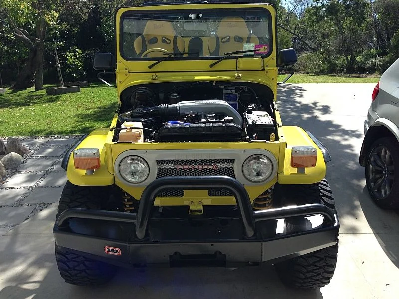

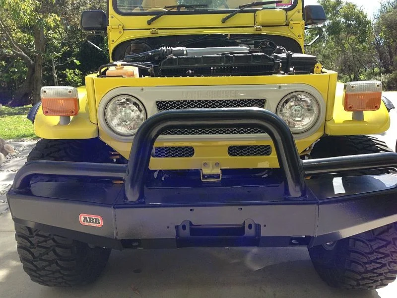

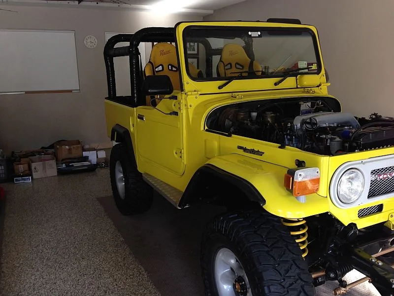

This is after bulbar, battery, front seats
Will take finished photos next week, but after adding bulbar, bonnet, driving lights, square flood lights where the yellow circles are, 60 litres of fuel, couple gauges & wiring, plus a driver & passenger sitting in the front seats, the front suspension has dropped down around 15mm. Which when the front drops the back rises a little, so that why I am going to test the other set on springs I have on standby and lift the front up 15mm which will drop the rear around 8mm.
It was always going to be a hit miss affair with the front spring levels because there is no standard to work from, and its not matter of using 80 series 2" lift springs as the chassis is built with a inbuilt 2" lift. The 80 series springs I am using are standard height oem springs but just ones from a petrol 80 series which are in it now, the other set are from a later model 80 series diesel.
The other trick with 80 series springs is that the left hand spring is always longer than the right hand spring by around 10-15mm, which on the 80 series levelled the vehicle, as I don't have that level problem, my choice of spring heights are numerous, currently using 2 higher left petrol coils on each side, I can use 2 right low diesel coils (which are higher than the height of the petrol left coils but stiffer that I am using now) or I could use the higher 2 left diesel 80 series coils all round.
Because the coils are easy to get out its a pretty quick change over, the rear is fine with the coils being from a petrol 80 series which did not have rear 3rd seats.
