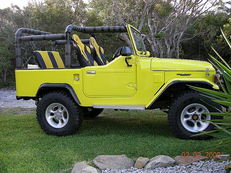

I am nearly ready to start another build, again a 12Ht, 5 speed, 43 series fibreglass tub, galvanised chassis with coils all round. But have found this, has a 91" wheel base and all the chassis coil stuff is already done this time.
Picked it up last week.
I actually printed out that picture and am using it for reference for the 3 and 4 link suspension I'm doing to mine. I like coil-overs, but coil springs and shocks are a lot cheaper than coil-overs - plus, most manufacturers spent a lot of time making this stuff right and it's pretty arrogant to think I can do it better in my shop (okay, there are exceptions... but still, it gives me such a great starting point that it'd be foolish for me to ignore it).
No, another beach version, will install 80 series coils and Fox shocks, plate up the coil hats a little for strength, galvanise everything, install another 12HT with 5 speed, running alloy's with 32" tyres and a 43 series fibreglass sports tub, Lokka rear diff & e-locker front, ratio is 4:55. Sports tub being built but won't be ready until Feb 2015 so I am busy buying & scrounging parts, have 90% so far.
All I need now is a long range fuel tank, two front sports racing seats (have the rear bench seat), build a steel roll cage and get another ARB bulbar and rebuild a 5 speed gearbox and another 300 hours and it should be finished.

Well the truck arrived with a lift crane and 2 hours later the fibreglass body was on the new chassis, re-installed the finished roll cage, connected brakes & clutch.
I am pretty happy with the overall height, a good 2" lift, there is probably another 200kgs plus of weight still to go back in, 110ltr fuel tank under front seats, bucket seats, battery cradle & battery, steering wheel & column plus shafts, air cleaner, twin horns, front guards & supports, bonnet, bib, bulbar with driving lights and final the rear bumperettes.
The body centred well as you can see the rear wheels are pretty close to centre of the rear wheel arch, the overall wheel base is 92.6"
Got a little bit more done over the weekend, bolted on and aligned the front guards & apron. Also did some wiring as the battery will now be on the left hand side and the air cleaner will be on the right.
Things left to do are, repaint the 110ltr fuel tank, I have removed the front seat frames and having them galvanised this week, also have to finish off the alloy battery cradle. Also changing the front lights to halogen and getting rid of the old sealed beams.
I will pull the apron & guards back off to repaint the internal side on them with a matt black paint, then re-attached the guards & apron along with bonnet and the ARB galvanised bulbar, extra driving lights and led flood lights in the base of the bulbar.
