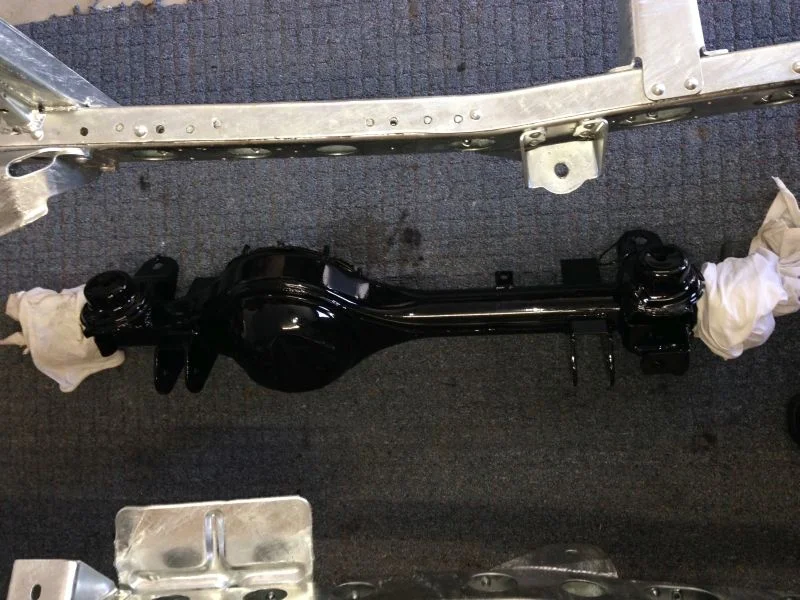

Here my finished 40 series chassis just back from being hot dipped in gal, plus my finished front & rear axles now painted.
that's one way to make it rust proof! looks cool too.
Acid cleaned to remove paint and surface rust then hot dipped in gal, $425.00. This chassis was already hot dipped 3 years ago just before we started to put on all the 80 series stuff, the second hot dip was really to protect that.
is that front axle 40 series width? OR? I am about to do this to my 55...coarse, mine won't be half as pretty...
