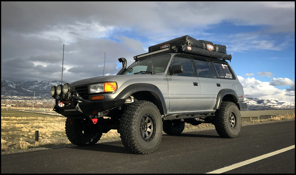

Here's a pic of my FJ80 with 33s with stock suspension at the time with stock 4.10 gearing.
Nice setup! What wheels do you have there? My stock rims are starting to look pretty bad and powder coating it costs as much as a new wheel set :(.
I am running 315s on an OME 2.5 lift. Stock gears. I live in the rockies in CO. ts not fast up hills but it does just fine. Considering the "pwr" button hack the guys mentioned earlier in the thread. See what happens there.
