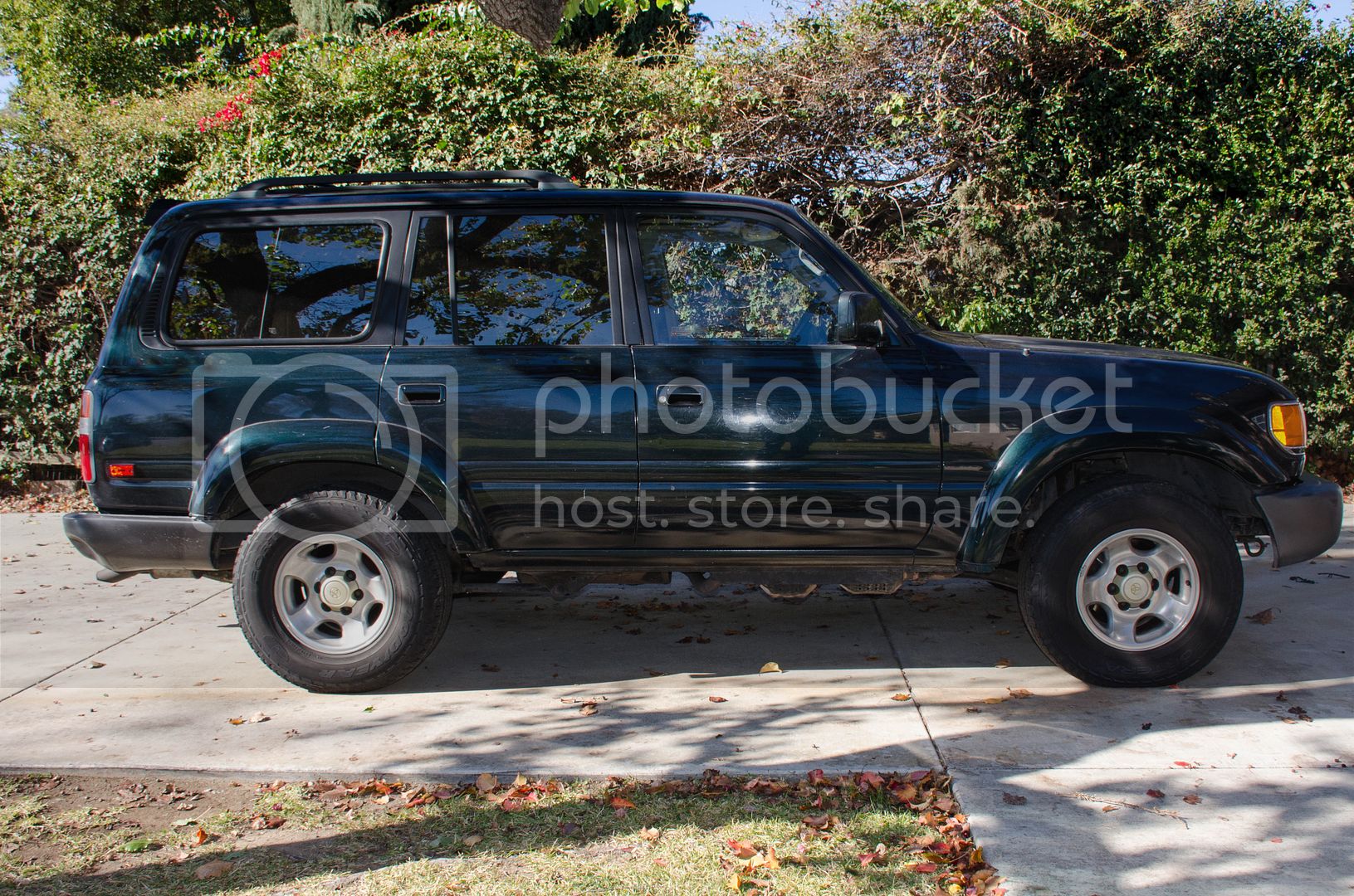

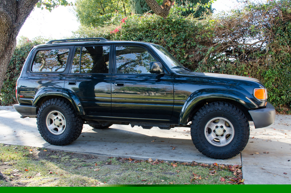

I decided to go with the 315 75 16 Toyo open country MTs. So far I am very pleased. The power loss was not as much as anticipated and I don't expect it to be too slow on grade. With stock suspension it doesn't rub at all but I am definitely going to put a lift on before I do any wheeling. The Toyo's are a little noisy on the highway but quiet around town above 5mph. The noise on the highway and slight decrease in power is well worth the looks in my opinion. Around town my MPG was 13 with the stock tires. I'm averaging 11 MPG around town on the new 35s.
Before
275/70/16
After
315/75/16 Toyo Open Country MT
dont forget to adjust 11% i believe for tire size in your MPG calculations..... seems it should still do better than 11.
but regardless looks great! wise choice
315 on a stock rig looks great! Wow. Makes me want to lower my rear 2"
