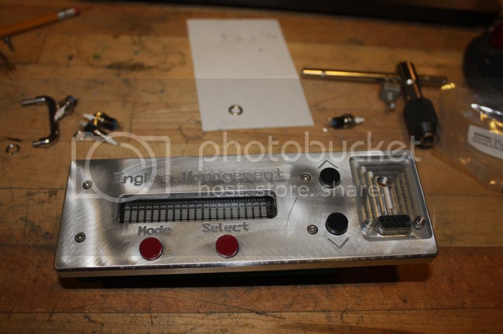

Really interested in the Megasquirt. You're going to have to elaborate more on your EFI setup. I've been working on an OBDII system for our motors but the megasquirt system has always intrigued me.
How are you going to do OBDII? There's some neat new instrumentation out there that relies on post 95 OBDII protocol, never thought it would be an option on an F engine.
