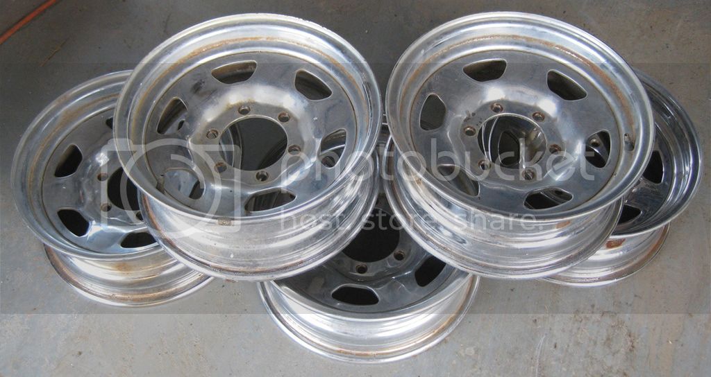

The rims are factory Toyota chrome rims. The rims measure 7" and I was wondering if 12.5's would seat? As for the gearbox, it won't bolt up to the auto tranny will it? This might change things if it won't.
Those look to be the land cruiser rims. I wouldn't run 12.5 tires on them.

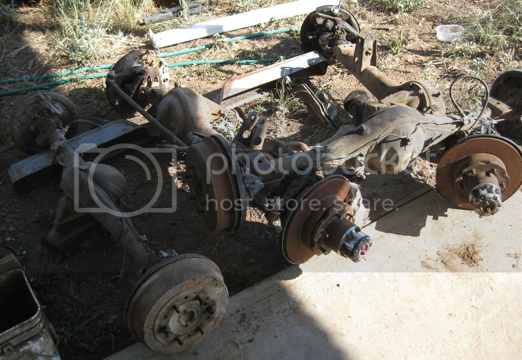

Todays update. The spare differential sets showed up today. Also scored a 4 spd tranny thrown in on the deal. Don't plan to use it but nice to have spare parts.
I see that one of the front diff's is trussed all the way to the end. The other only half way. I pulled the newer one out of the pile along with one of the rears and steam cleaned them both. They came out nice.

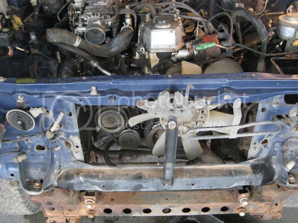

Also this morning I put a fresh battery and fuel in the 86 carb'd truck and she fired up real nicely. This engine sounds better than the EFI one. No ticking at all. Just a smooth smokeless engine. The carb needs rebuilt. The float was sticking and fuel was overflowing but other than that I think it will be a great spare. So now I guess it comes down to the final decision. I think I'll build up the 85 EFI truck and use the 86 one for parts.

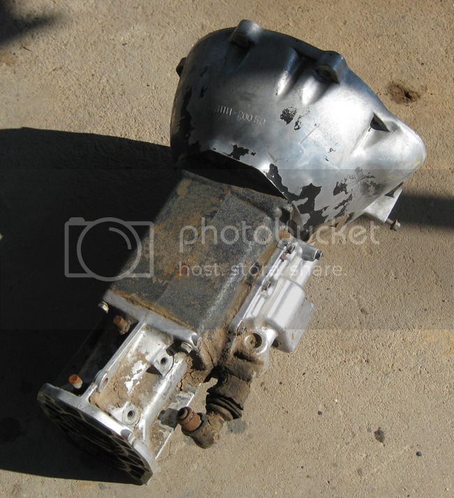

While I had it on the lift I noticed that it does have a 5 speed transmission, but kind of looks like the bell housing is a one piece unit. If so, is this a good tranny I should swap in place of the auto tranny behind the EFI motor? I haven't figured out yet how to identify the tranny's.
I hope it is not too difficult to do an auto to manual swap.
Ordered some tube today so I can start bending a flat bed. Going to get the 85 truck running as well as possible and then get it inspected so I can get some plates and drive it before tearing into it.
Yea, put the manual tranny in place of the auto. You have an entire donor vehicle. Take the hydraulics, and pedal assembly along with the tranny...that all that is needed.

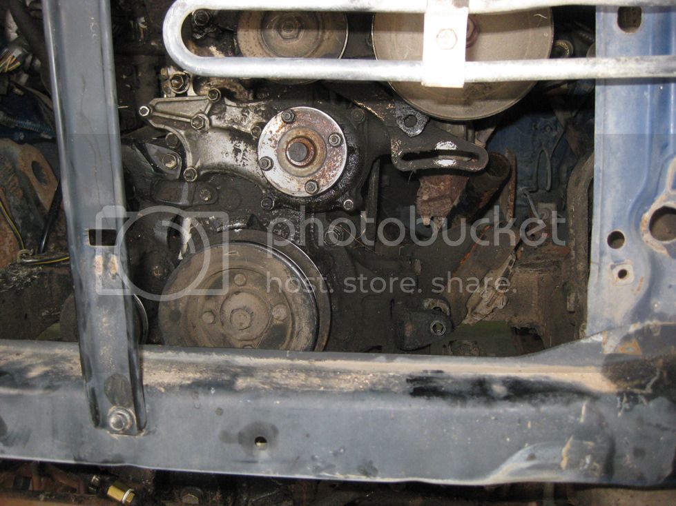

Took the skid plate off so I could pressure wash the oily mess from a front seal leak.

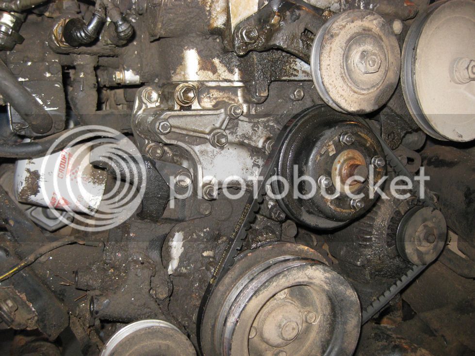

A case of the MAW's got to me and I started disassembling for a new seal and chain along with any other parts while I'm in there.
Even took off the alternator for a cleaning. Removed the A/C parts because I won't need them anymore.
