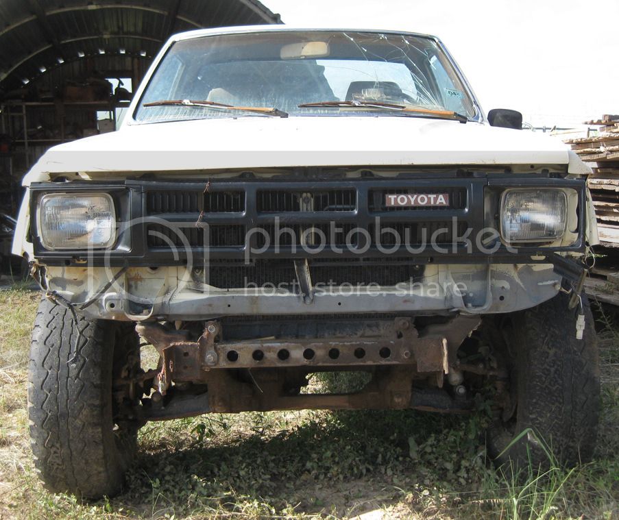

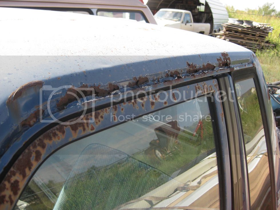

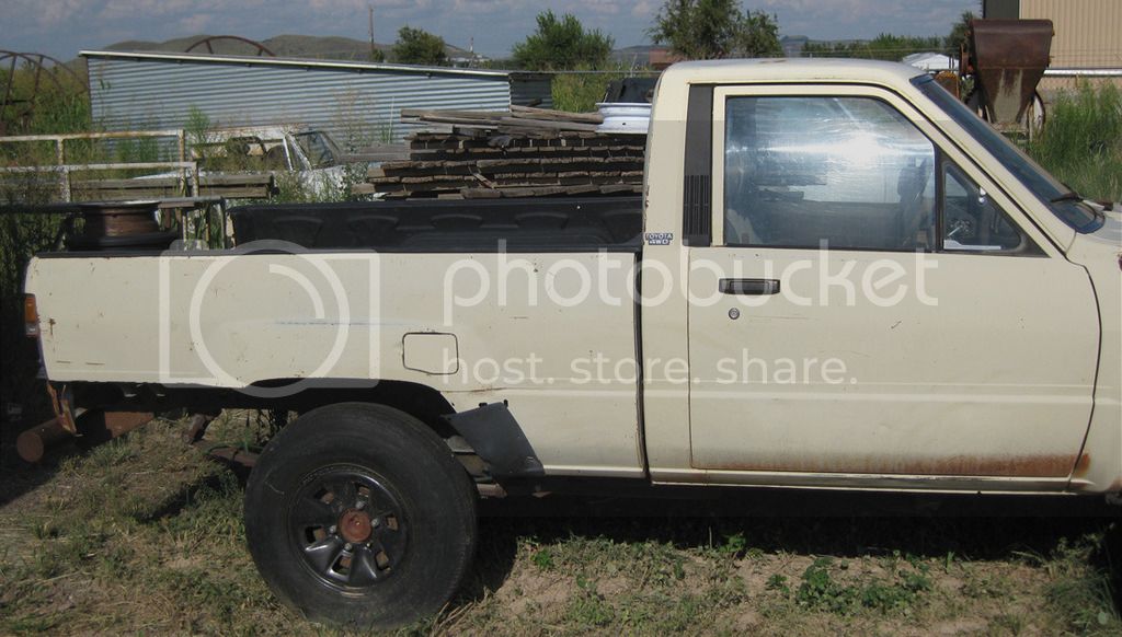

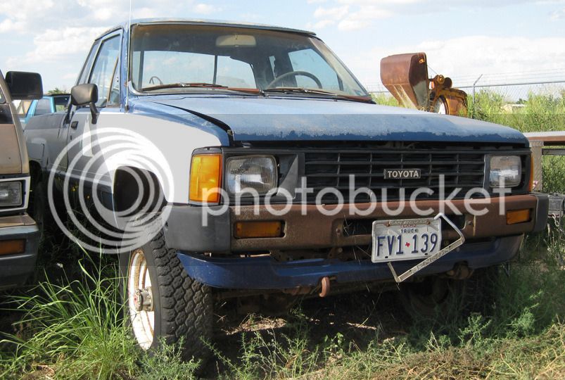

Update: I now own both trucks. Got a sweet deal IMO. I had the two mixed up though. The Solid axle truck is the extended cab model which has the good title. I finally got some pictures. Here is the IFS truck:
Here is the straight axle truck:

Both of those trucks look pretty rough...

Those trucks are pretty rough. That roof is gonna be hard to fix, at least it would be for me.
Rag top!

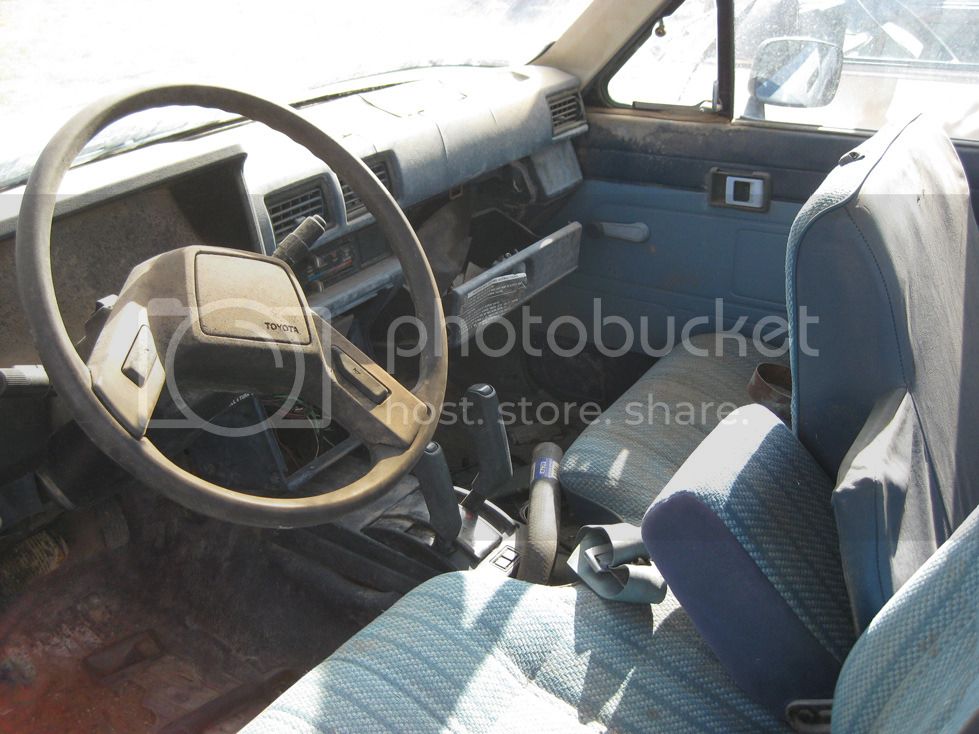

Advice noted and I'm in agreement. Both trucks are home now and I'm able to access any damage better. Spent a while cleaning out deer pellets a packrat had stashed everywhere on the 86 truck. It looks to be very complete and in pretty good shape except where someone took the lower cover off the steering column. Something going on with something electrical under there no doubt. Going to clean out the gas tank and blow out the lines soon. Might as well see if she's a runner.

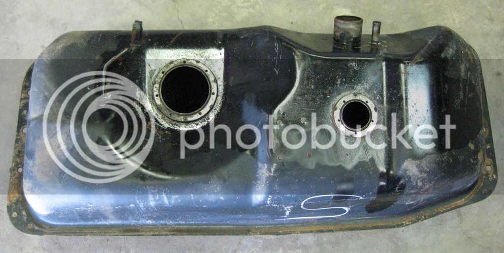

I gave the engine a good cleaning with my hot water pressure washer and some degreaser. Keeping in mind this truck last ran in 92, I put it on the lift to see about removing the gas tank for cleaning. I was pleasantly surprised to see a drain plug, so decided to start with removing it. Turned out the tank was empty so I flushed it out with fresh gas. Not perfect, but perhaps enough to get running or at least cough.

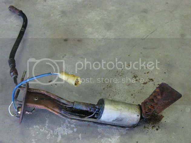

A fresh battery later, and I had the engine cranking. I could not hear the fuel pump at all, even with my ear to the tank. A tiny squirt of starting fluid had the engine firing and trying to run, so I am of the opinion the fuel pump is out. Next step is to remove the fuel filter and then jumper the fuel pump check connector and verify fuel flow. If none, then I will order a couple of new filters and a Denso pump with strainer.

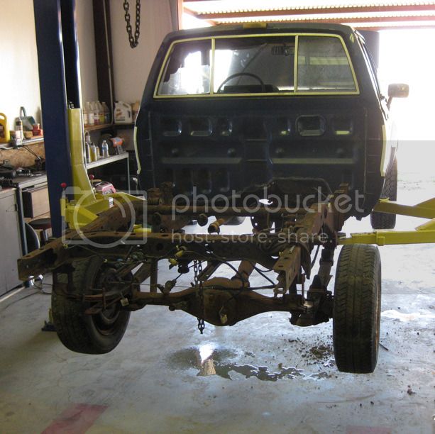

Had a chance today to work on my junk. Removed the bed, removed the fuel tank and took out the fuel pump. I plan to clean the tank and replace the pump and filters as well as blow out the lines. This should insure a fresh supply of clean fuel. here are some shots of the progress:
