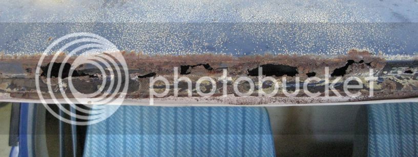

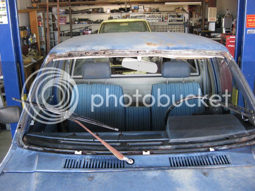

Started in on some of the rust repair. Figured I hadn't posted up any pictures in a while so here ya go:
Glass removed and all the rubber molding removed.

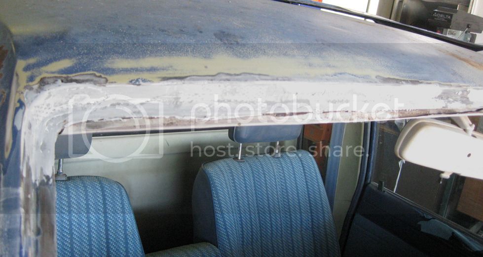

First coat of All-metal on top of an aluminum mesh for strength. I figure this repair as opposed to welding in new metal, will outlast me. If you have never used All-Metal or even Bondo brands equivalent of it, I highly recommend it. Cost about 1 1/2 times more than a polyester bondo, but worth every penny for rust repairs. I prefer it to fiber hair bondo also BTW.

Still working on the rust repairs, will get some pictures posted up soon.

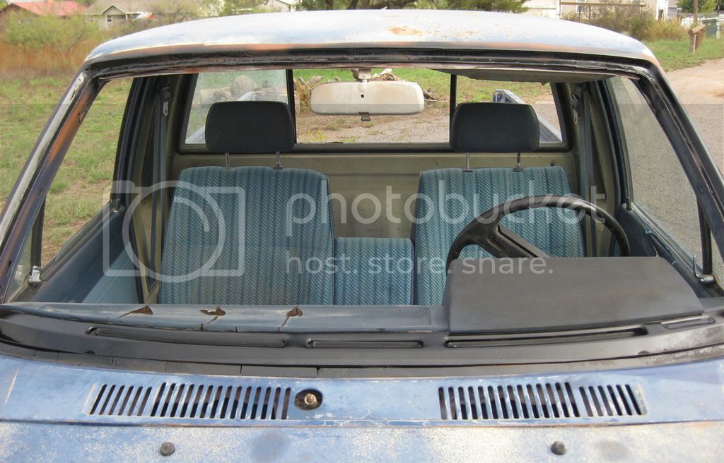

Pictures as promised. All I lack to get it inspected is to install the windshield. I put on a new muffler today.
Went out to the shop to contemplate my next move and was pissed to see a large puddle of oil underneath the engine. I put the truck up on the lift to check her out and was happy to see it was just the steering damper seals that let loose. I have a spare ready to bolt on so no big deal. There was also a small puddle of anti-freeze but I think it is coming from the top radiator hose clamp. it is still the original style one that is most likely worn out. I'll address that also. Tomorrow I intend to install the windshield. Then off to get an inspection.
Well, today I set the windshield in place. A dry fit with the universal rubber molding proved to not be what I wanted, so I simply bedded it in with the black butyl caulking that is routinely used on glass. Once it cures, I will tape off the edges and put on a nice final "pretty" coat. It looks pretty good and shouldn't leak, so I'm happy with it. Hopefully the truck will now pass inspection and become drivable.
