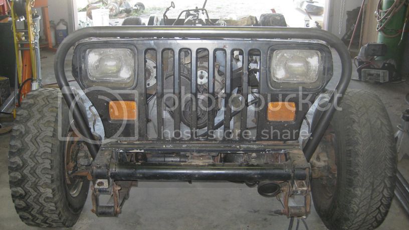

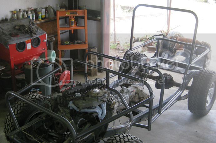

Here is my first attempt at building a tube cage on a YJ frame. Too many rookie mistakes.
