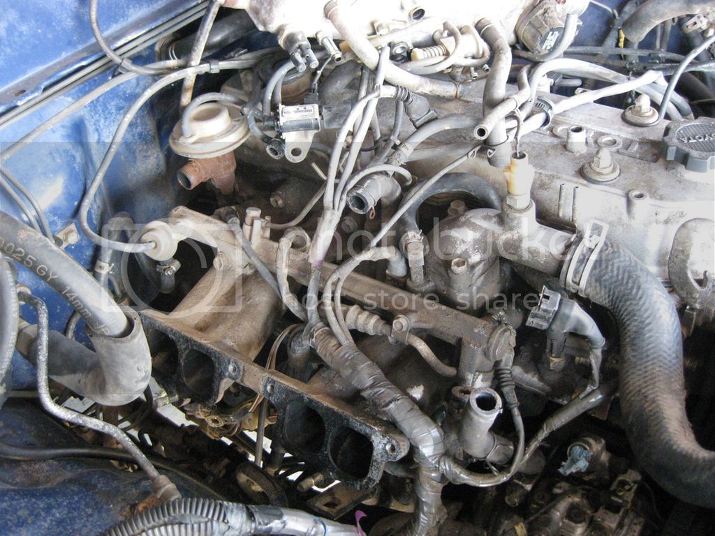

Sundays update. Woke up early eager to troubleshoot the ECU. I went through all the checks per the FSM and to my surprise everything checked out. This is good news because it leaves me with the only logical conclusion that it is the injectors themselves. During all this testing and cranking, i'm getting the feeling that the engine is running for a very tiny bit longer and longer as the days go on. This also reinforces the notion that the injectors are frozen from years of sitting.
I decide to bite the bullet and I remove the upper manifold so I can take a peek at the injectors. I took one out that looked the driest and sprayed some cleaner in it an let it sit for ten minutes. Blew it out with the air hose and then cycled it with battery voltage one just to hear it click. I reassembled the injector rail and upper manifold hoping to hear it run even longer, but to my surprise it caught on perhaps two cylinders which was enough to stay running and then a third caught and finally the fourth. After a minute or two the engine was purring with no smoke or vibrations. I'm not positive but think the problem was gummed injectors. I have no CEL and so I added water to the radiator which showed me a leak at the lower hose. I will fix that at a later time as I'm done in for the day.

Glad you don't need it. Also glad you have it running. Now for something in the tank to clean those injectors. In the nearly 400K miles I've put on mine I've only had to replace the ECU once. It's not a common problem with Toyota electronics ... though I do carry a spare.

Good to hear you got it running. I'd consider having injectors cleaned or use a set of flame throwers. Both are about the same cost.

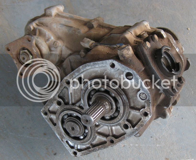

Picked up some parts from a friend today. Gearbox is set up with the Marlin crawler gears.
The rims are factory Toyota chrome rims. The rims measure 7" and I was wondering if 12.5's would seat? As for the gearbox, it won't bolt up to the auto tranny will it? This might change things if it won't.

It has a manual tranny so the Marlin gearbox will fit for sure. Hmmm lots of options ahead.
