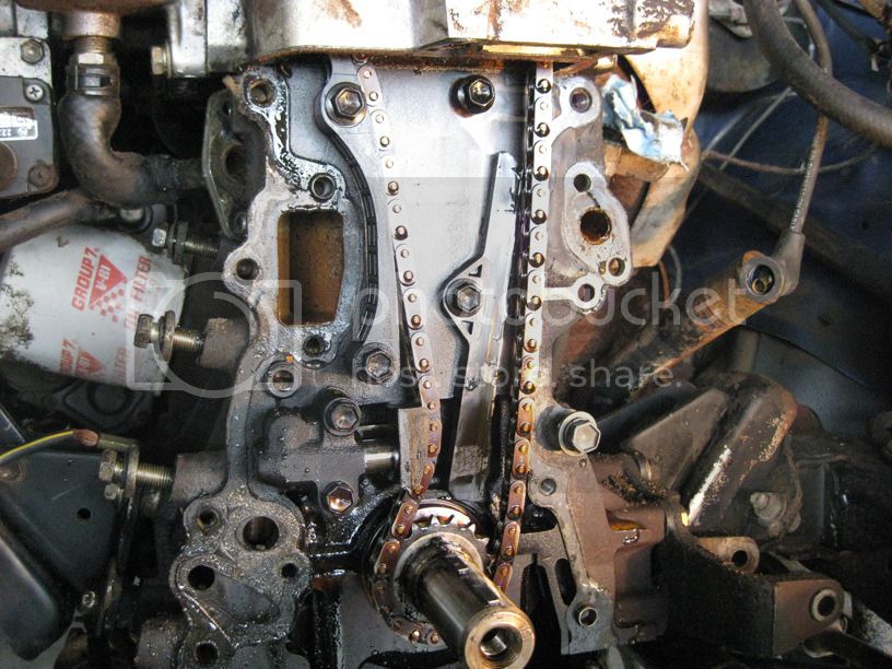

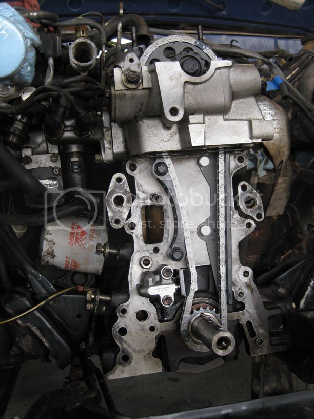

Here is a before and after shot of the timing chain replacement
I think the two darker colored links in the chain were supposed to go at the 12:00 and 6:00 positions, but it turned out two links away so shouldn't be a big deal. I still need to adjust the valve clearances.
