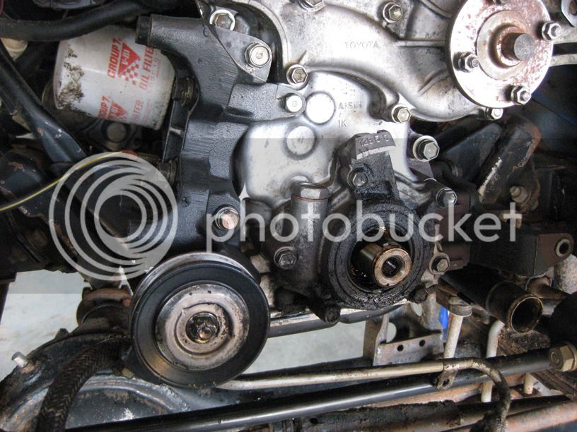

Removed the pan and balancer today. Didn't need the puller for the balancer. Is this normal?

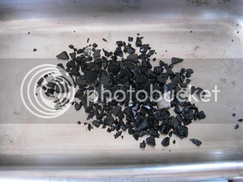

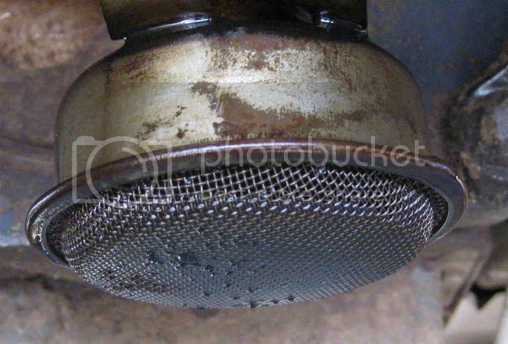

I'm sure some of the smaller particles made it past the screen, but in the last picture of the screen you can see some chunks that got stuck half way. Sure am glad I'm going to the trouble. Thanks to this site for the heads up.
I have never needed a puller the get the crank pulley off.
Ya, the balancer usually just pulls right off.
I would remove that oil pickup and squirt a bunch of brake cleaner spray down it to get all those chunks out of the screen.

Yup, already got the tube, pan and screen all cleaned up. Parts should arrive in a day or two.
