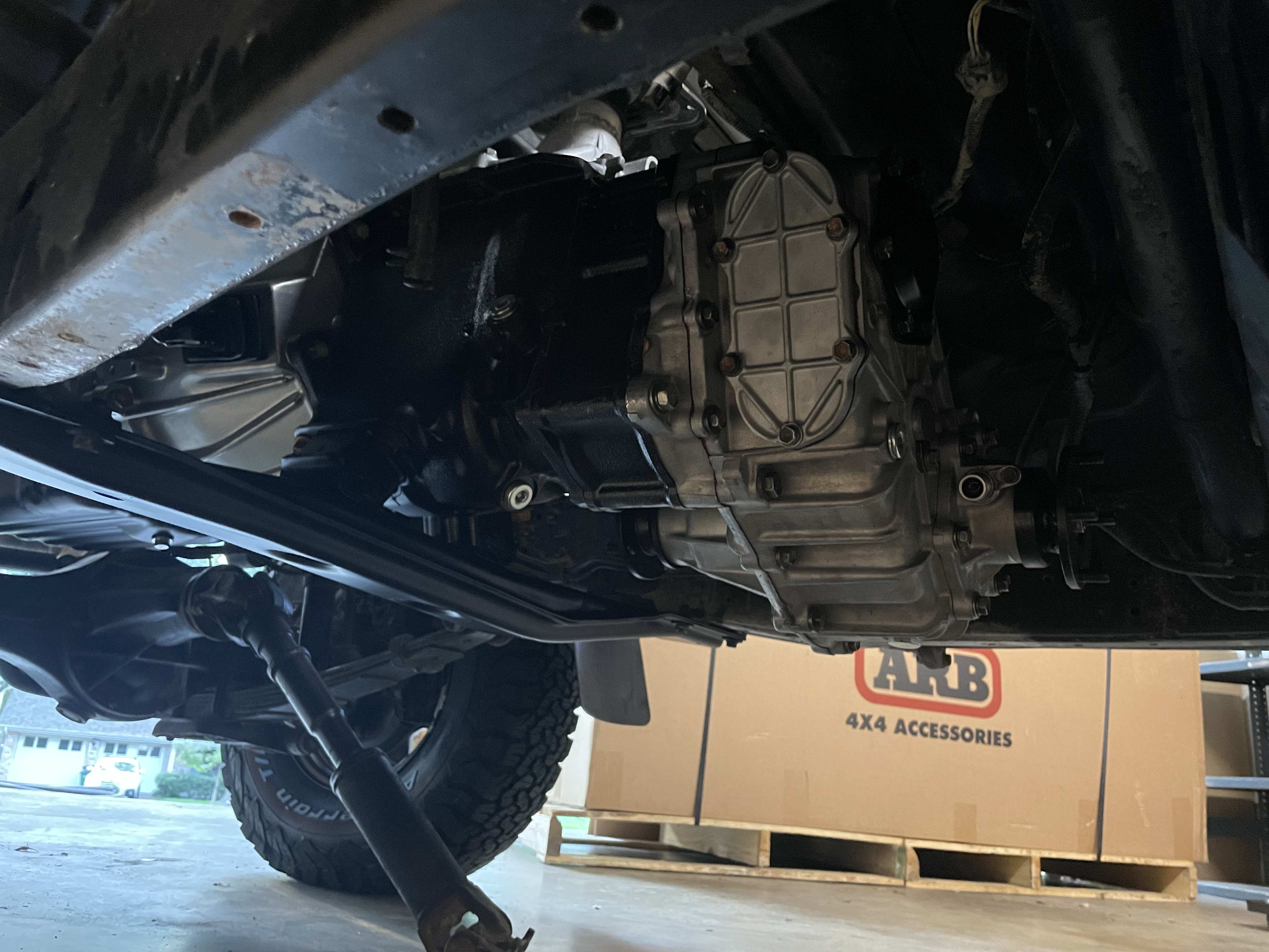

I finally received all of the parts necessary for clutch install. Hopefully stab the trans tomorrow.

Ran into another snag with the driveshaft and transfer case. The front t-case output flange was the wrong dimension for the front driveshaft flange. Georg is sending me the correct one. So I decided to work on other projects while I wait.

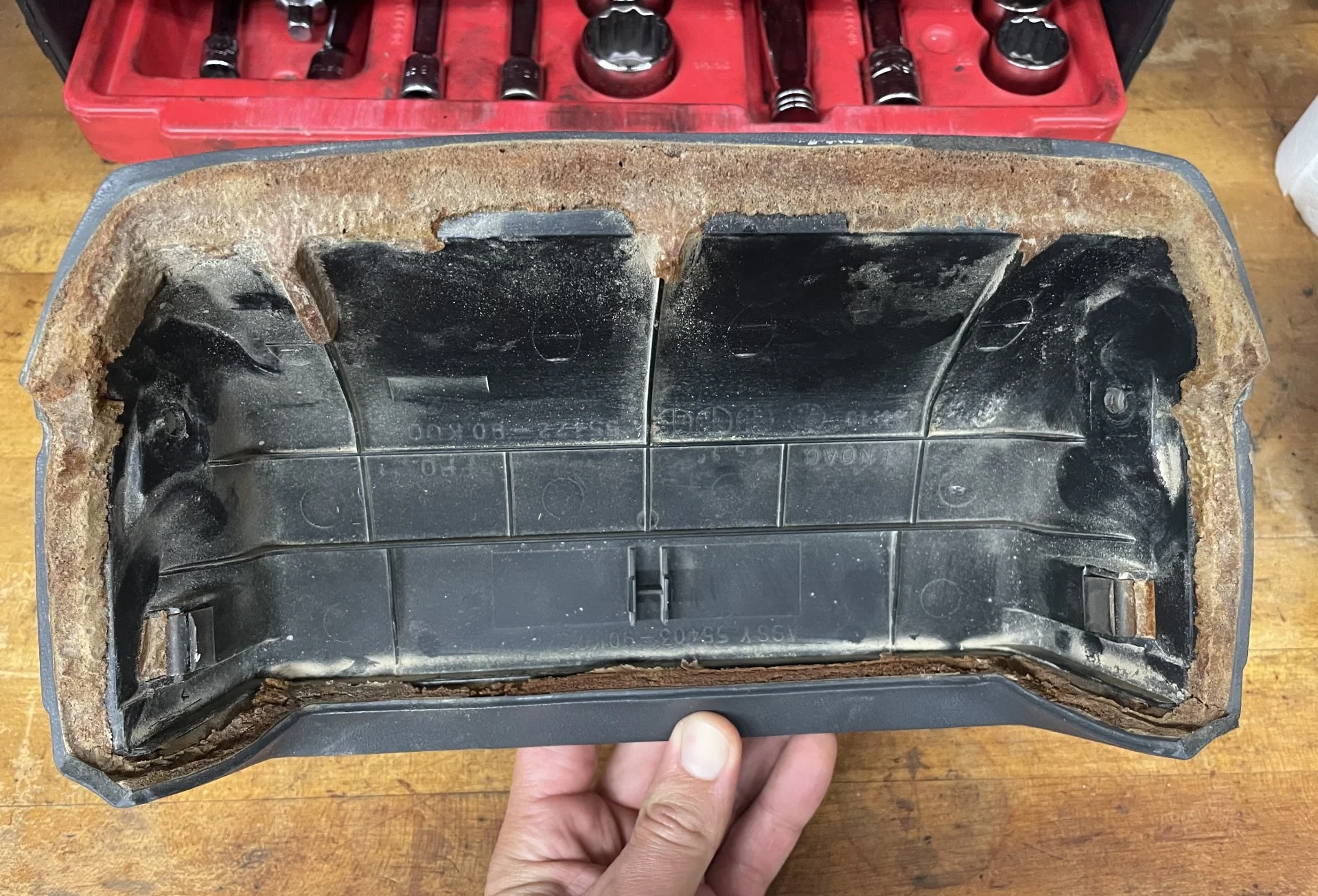

My brother bought me a replacement rear tank cluster for my birthday. The switching button on the original cluster was broken off, so you had to use a pen or knife to switch to the rear tank. I installed the new cluster and realized someone had installed this terrible expanding foam/glue all along the inside of the cover. Presumably because the pad was separating from the shell. It would flake off and make a huge mess every time I went to install. Tried to clean it up, but decided to just order a new one since they’re still available.
