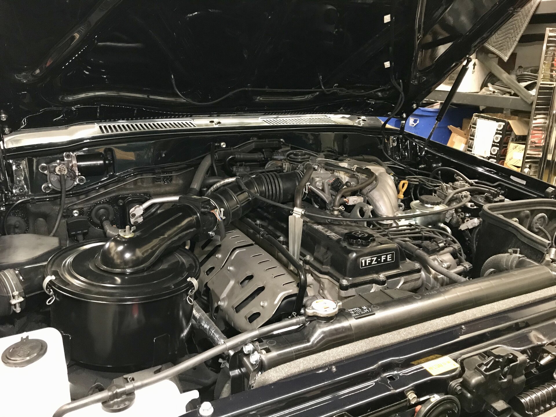

Been plugging away at some things. Recently got this new OEM MAF in, yes I know we still need a clamp on there.

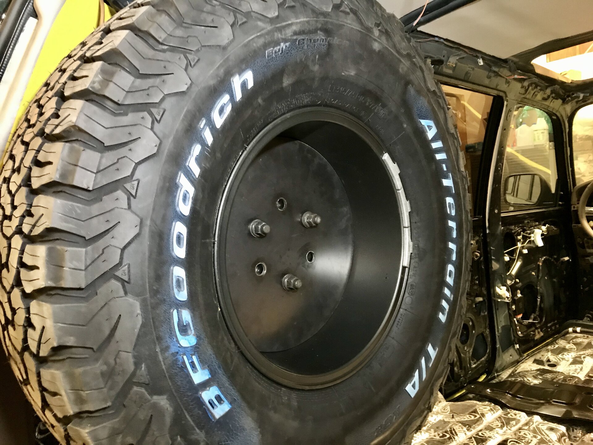

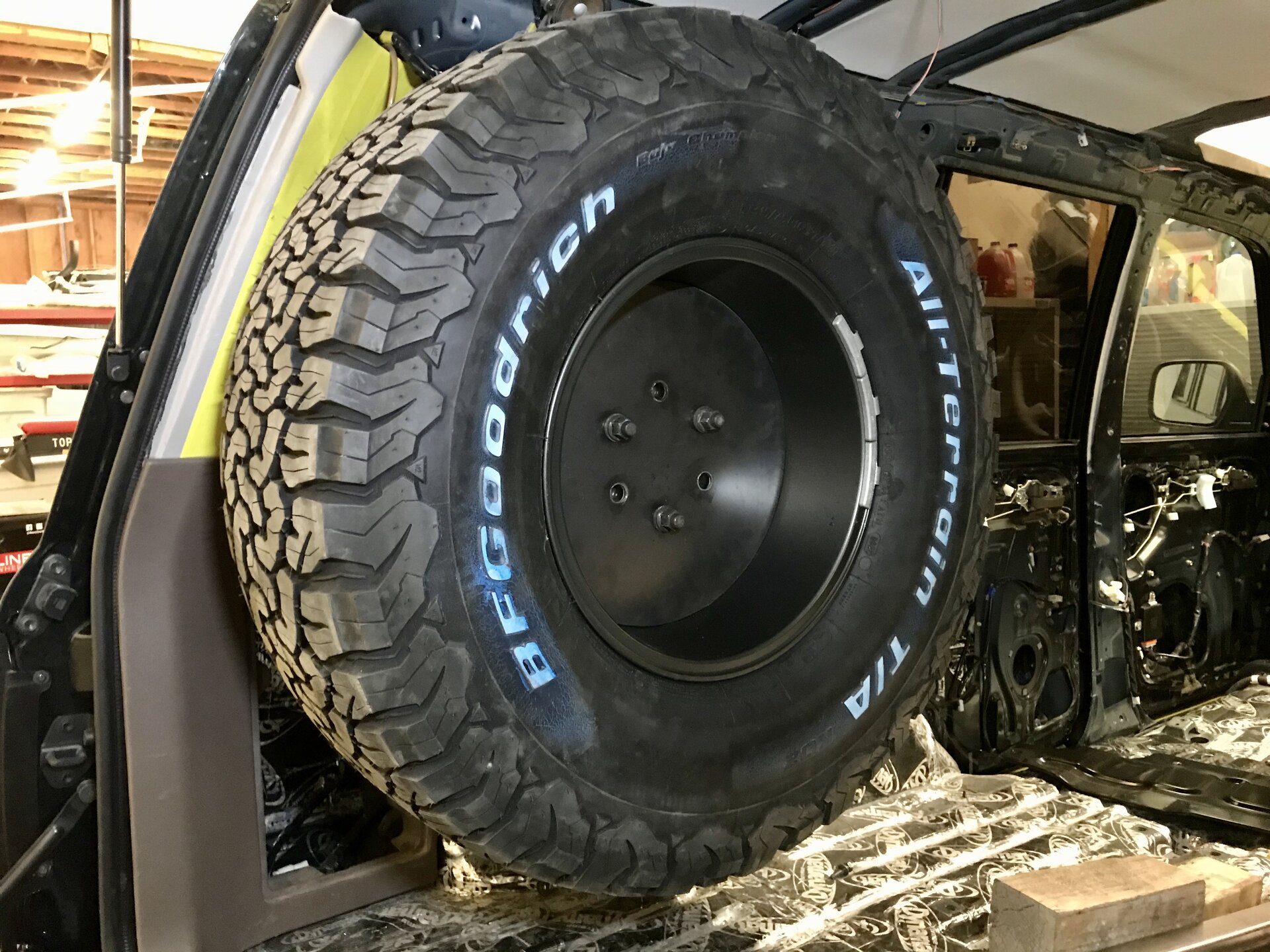

More on the tire carrier, more is in the works for this but it won’t be revealed until we are ready.

I don’t recall if I mentioned it but IAC and TPS are new OEM. We put some better OEM hardware on the IAC so stripped out screws is not an issue in the future.

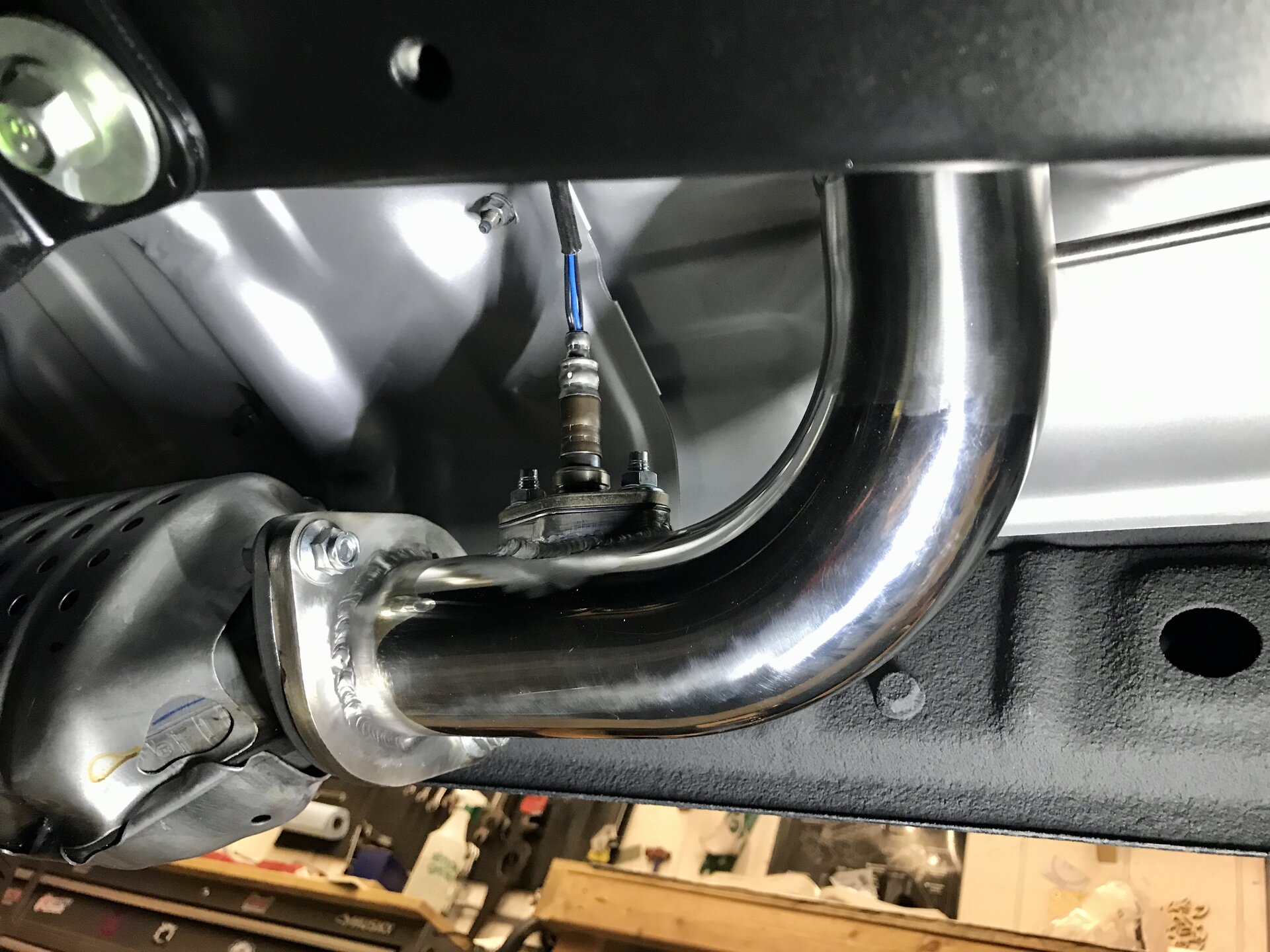

Exhaust finished for now. The down pipe and #1 cat are OEM Toyota. Uses all OEM isolators and frame mounts.
We fitted the #2 o2 bung to our cat back.
Compact muffler.

Muffler is nice and high.
Very nice work as usual !
Tucking the muffler nice and high like that leaves the drive shaft exposed to trail damage. The way the big OEM muffler hangs down it offers protection to the drive shaft and has help save the drive shaft on my trail Rig on many occasions ;)
Maybe that was Toyota's logic on hanging the cats so low.
The fewer parts hanging down the better, in my opinion.
Filled it with engine oil, Toyota Red, trans and p/s fluid, diffs and tcase today. 😋
