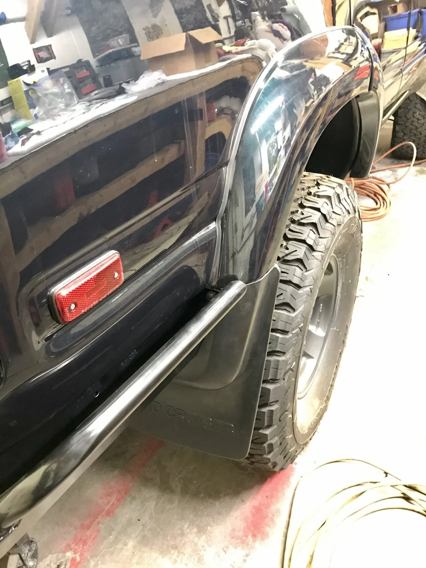

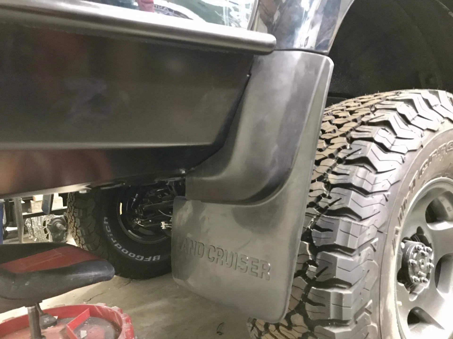

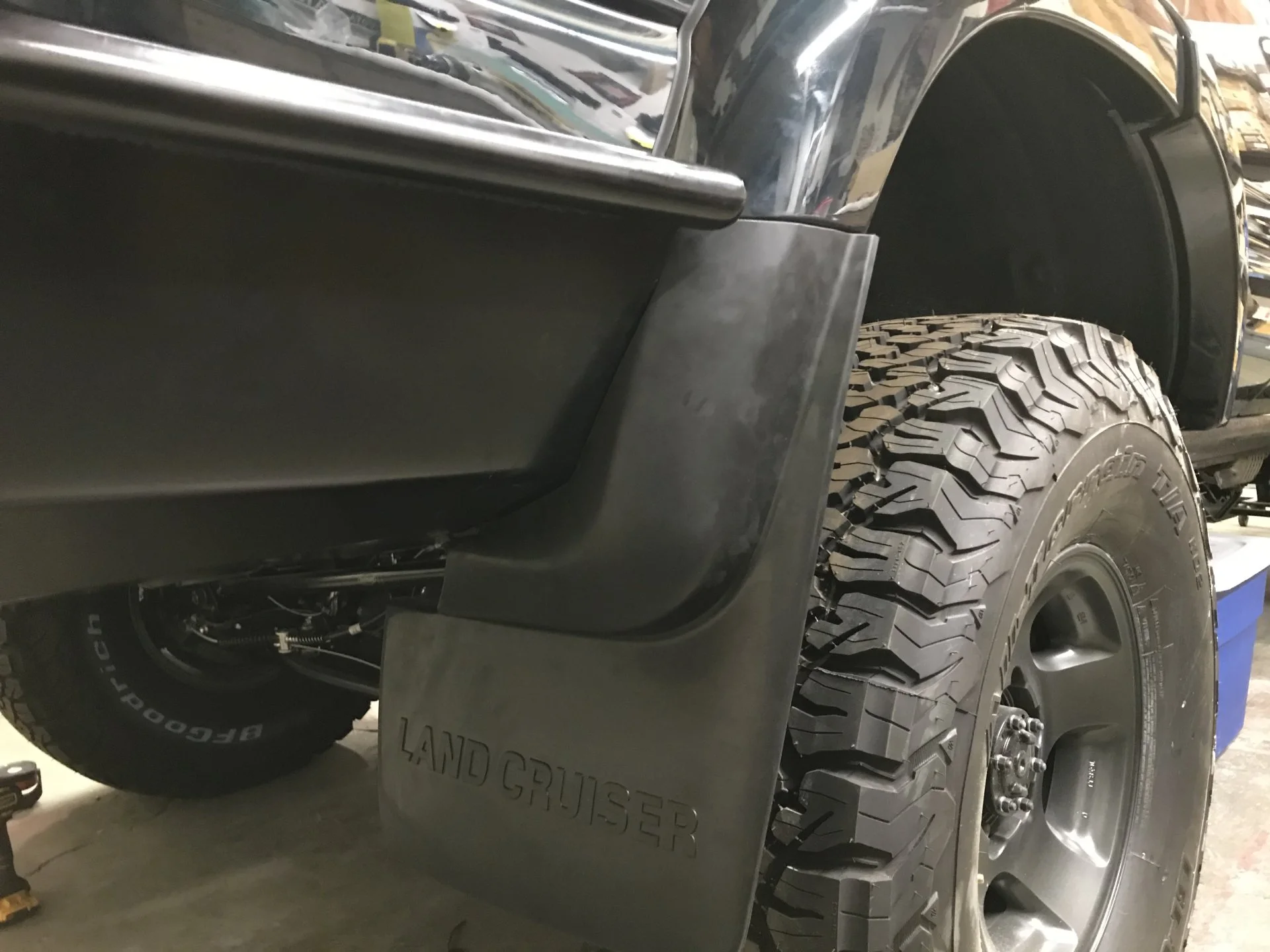

Customizing OEM rear mud flaps to work/fit well with the 4x4labs rear bumper.

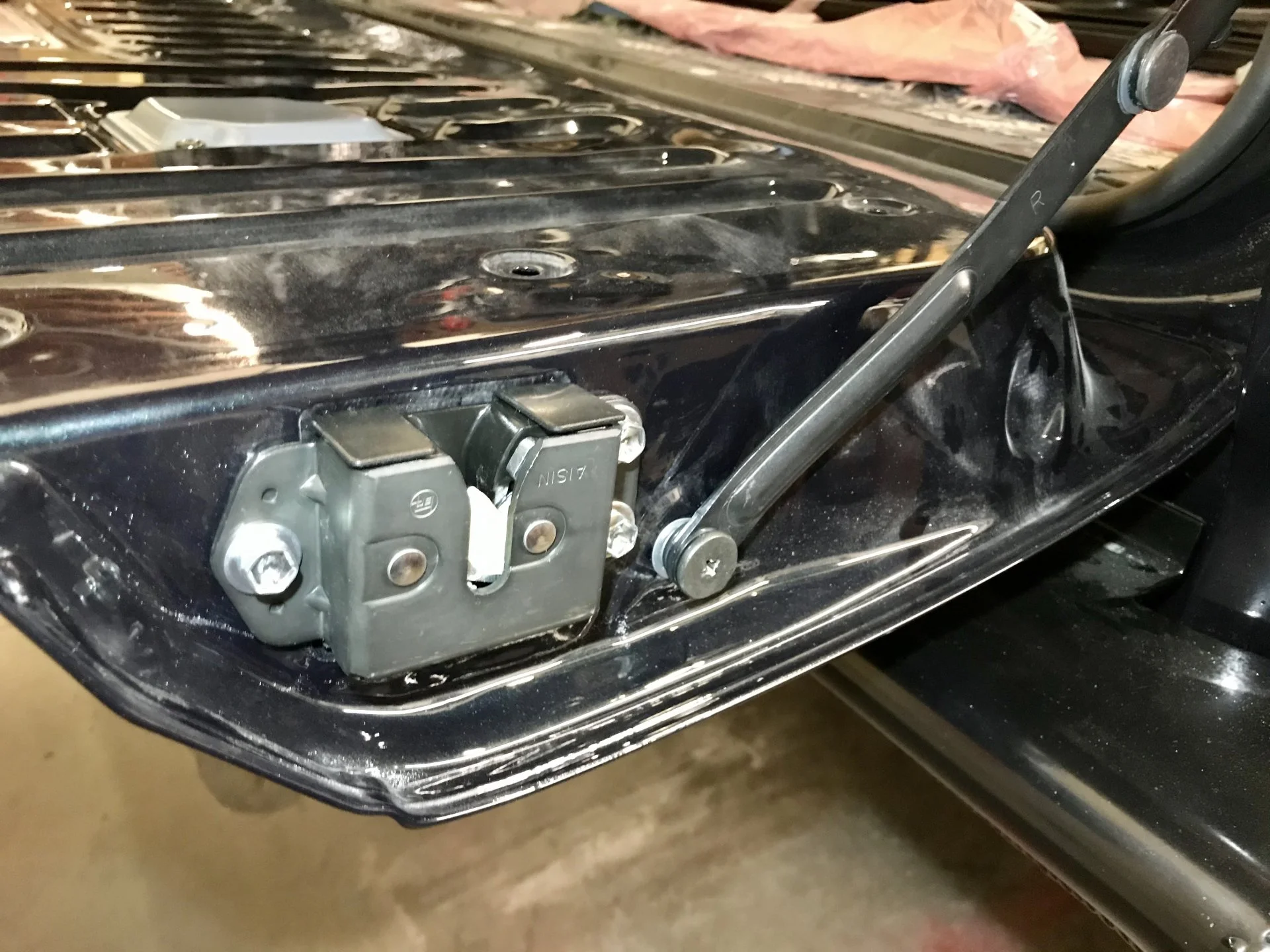

New rear lift gate parts.
New hardware throughout the rear lift gate and upper hatch.

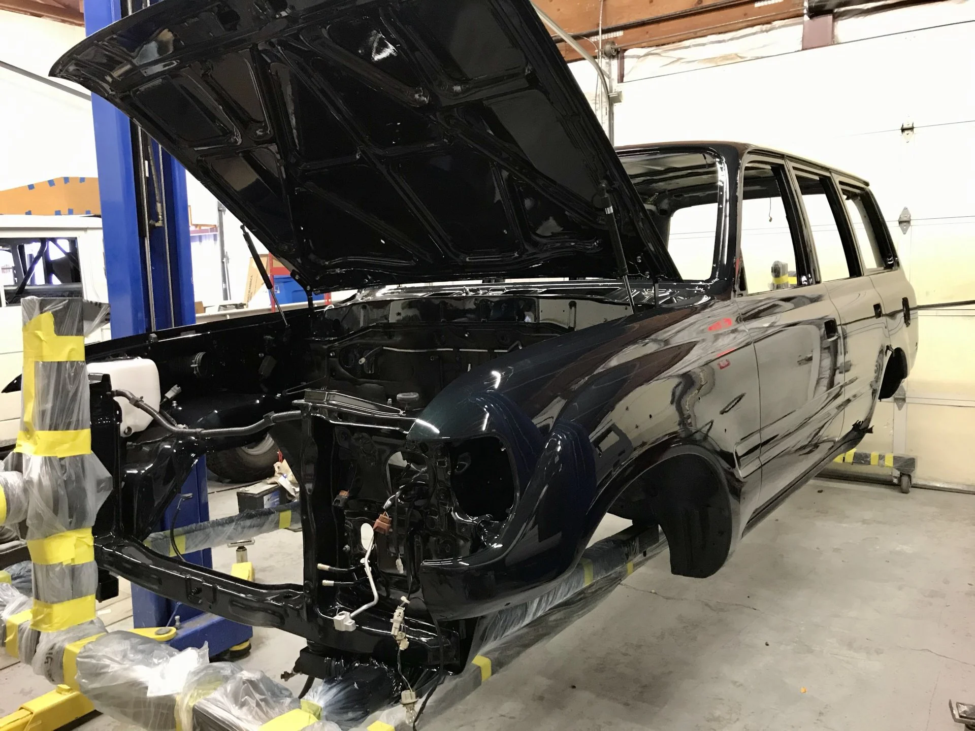

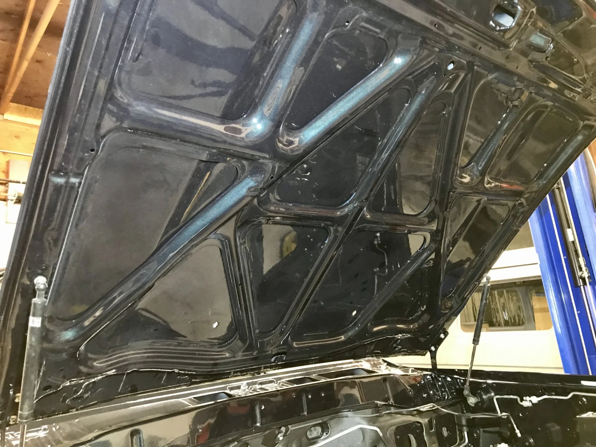

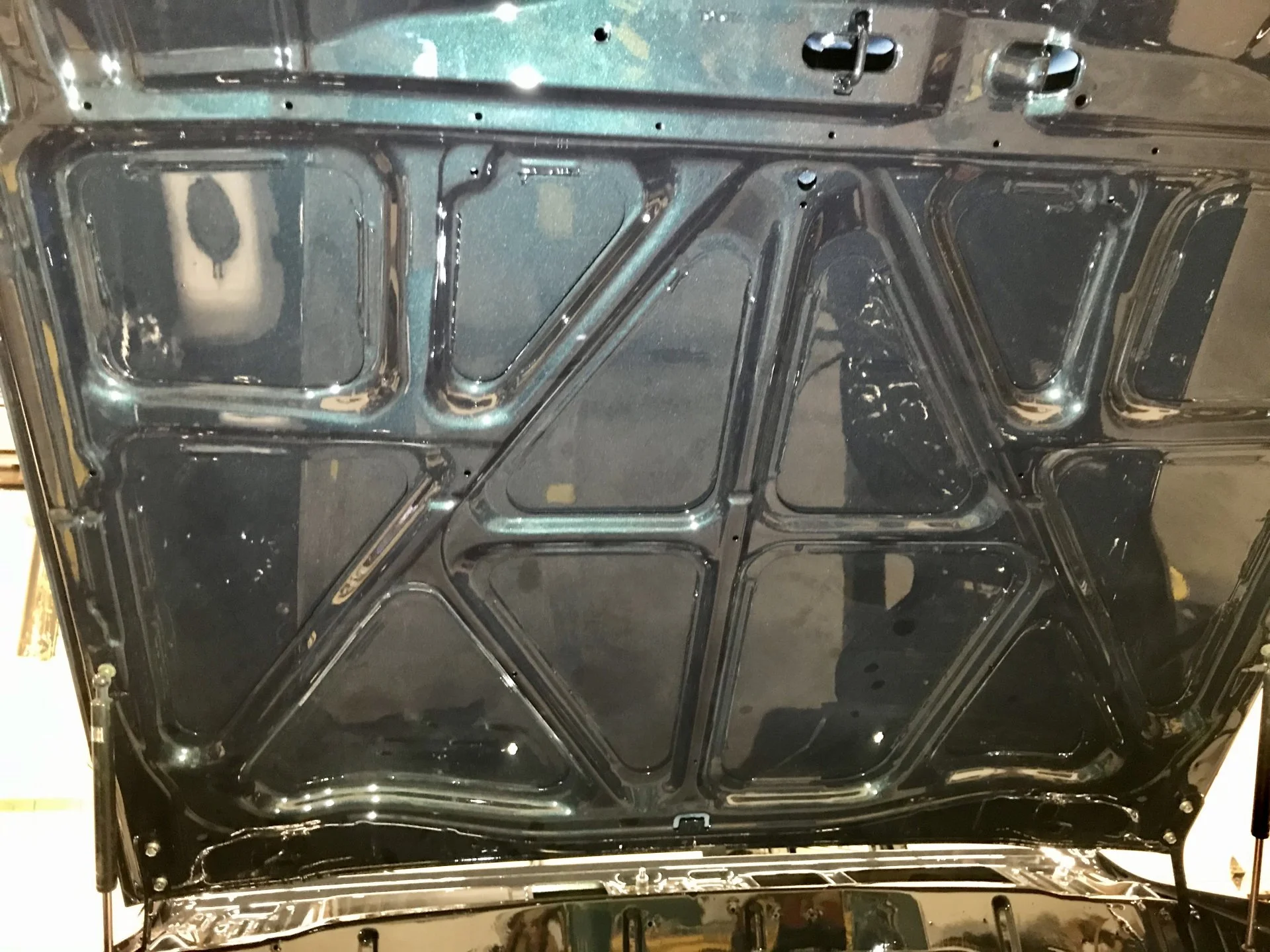

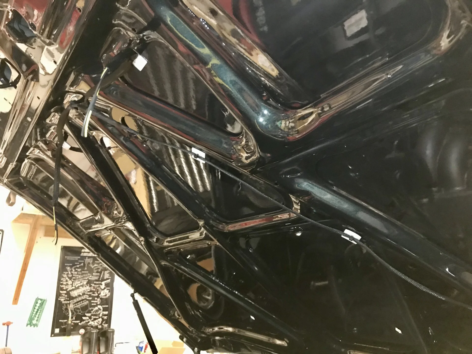

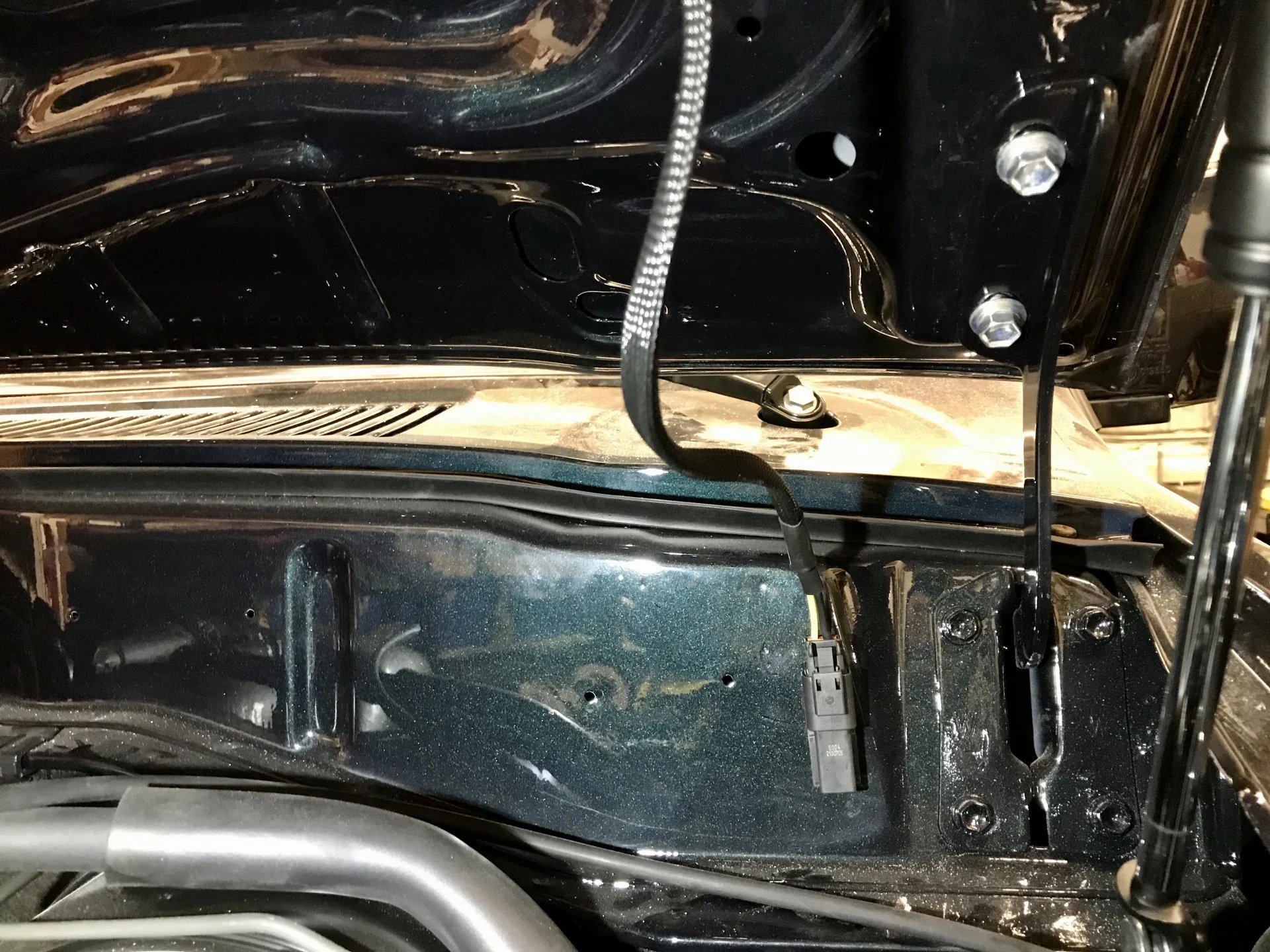

Under hood lights in the works.

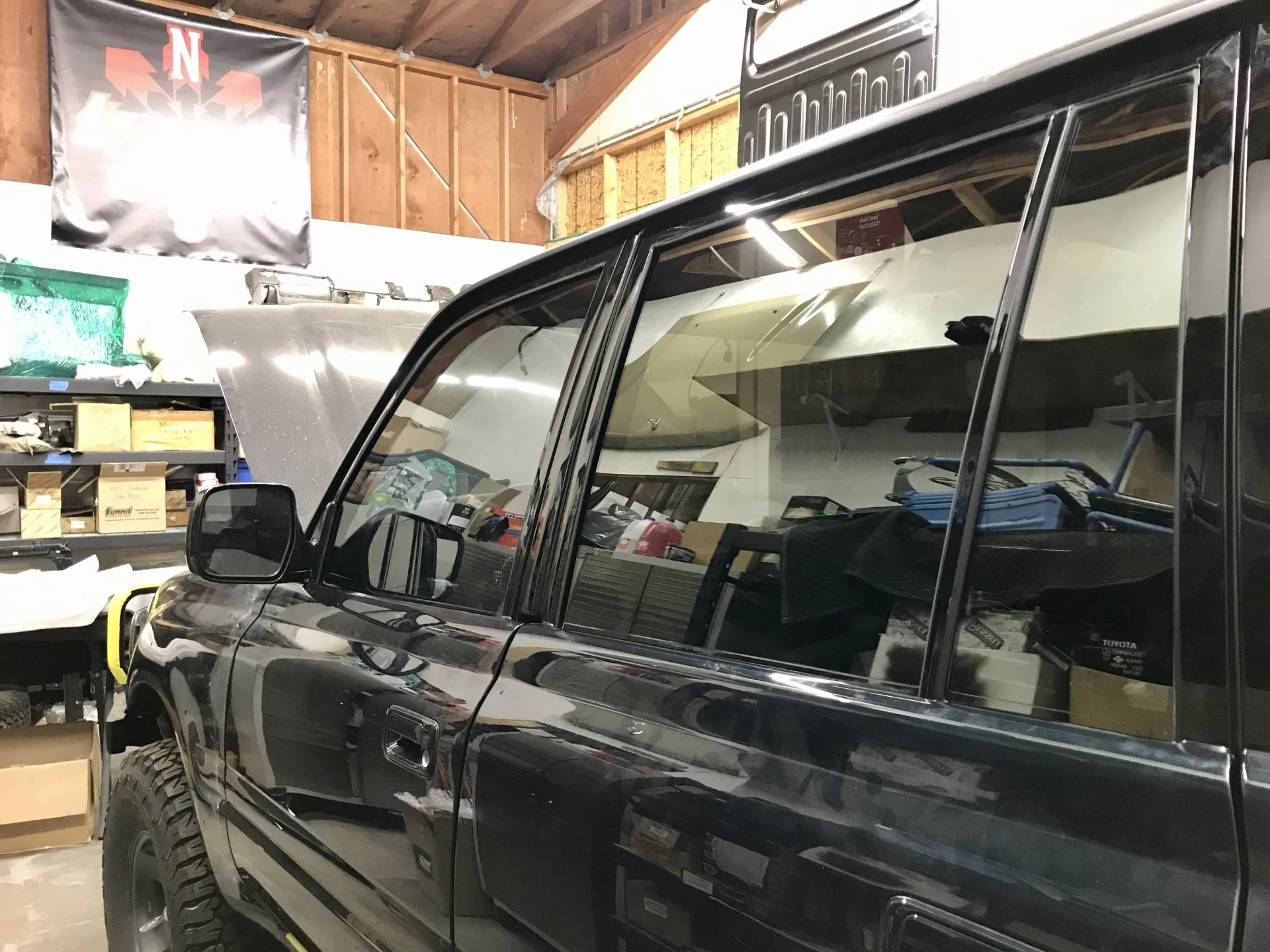

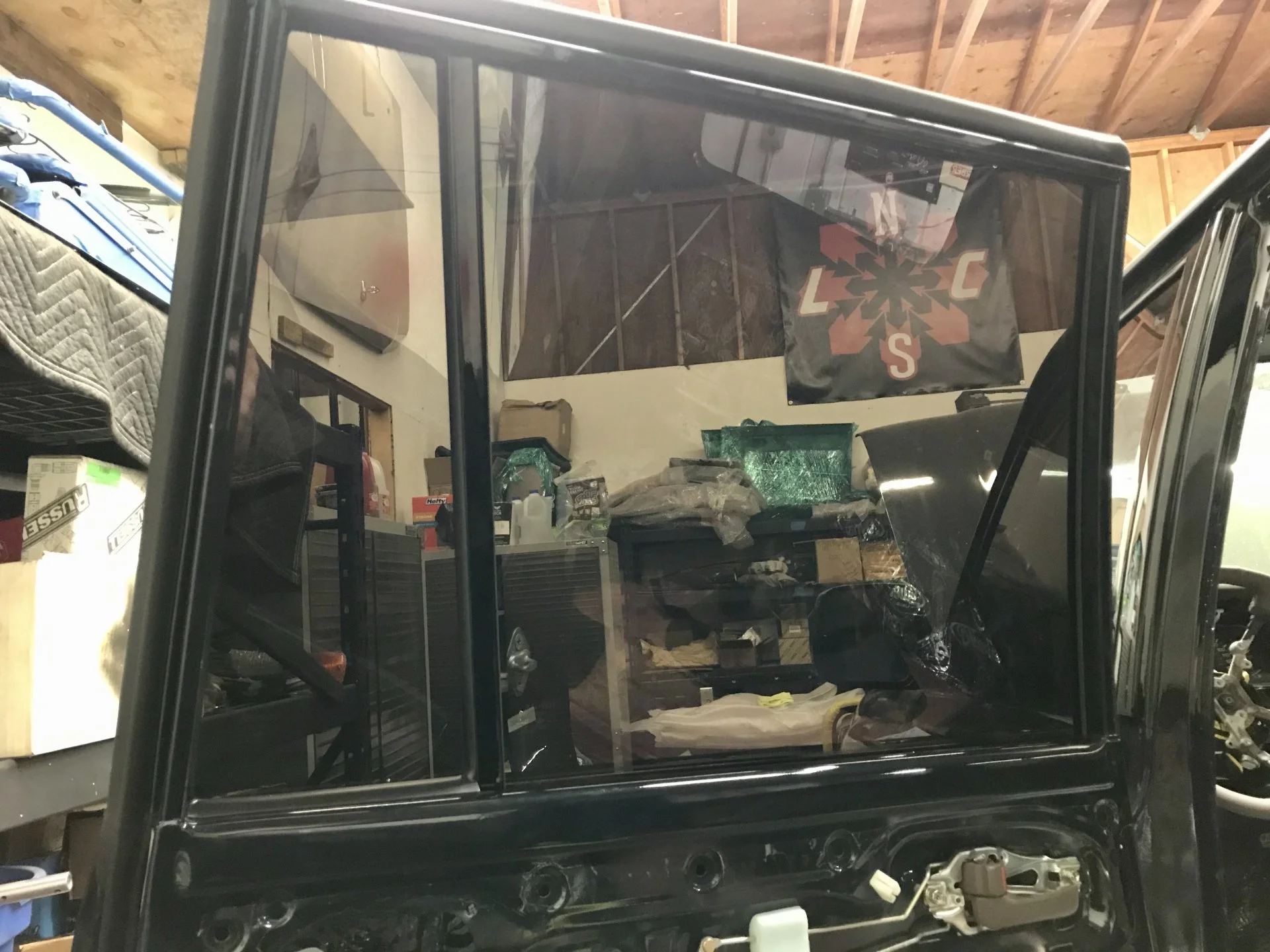

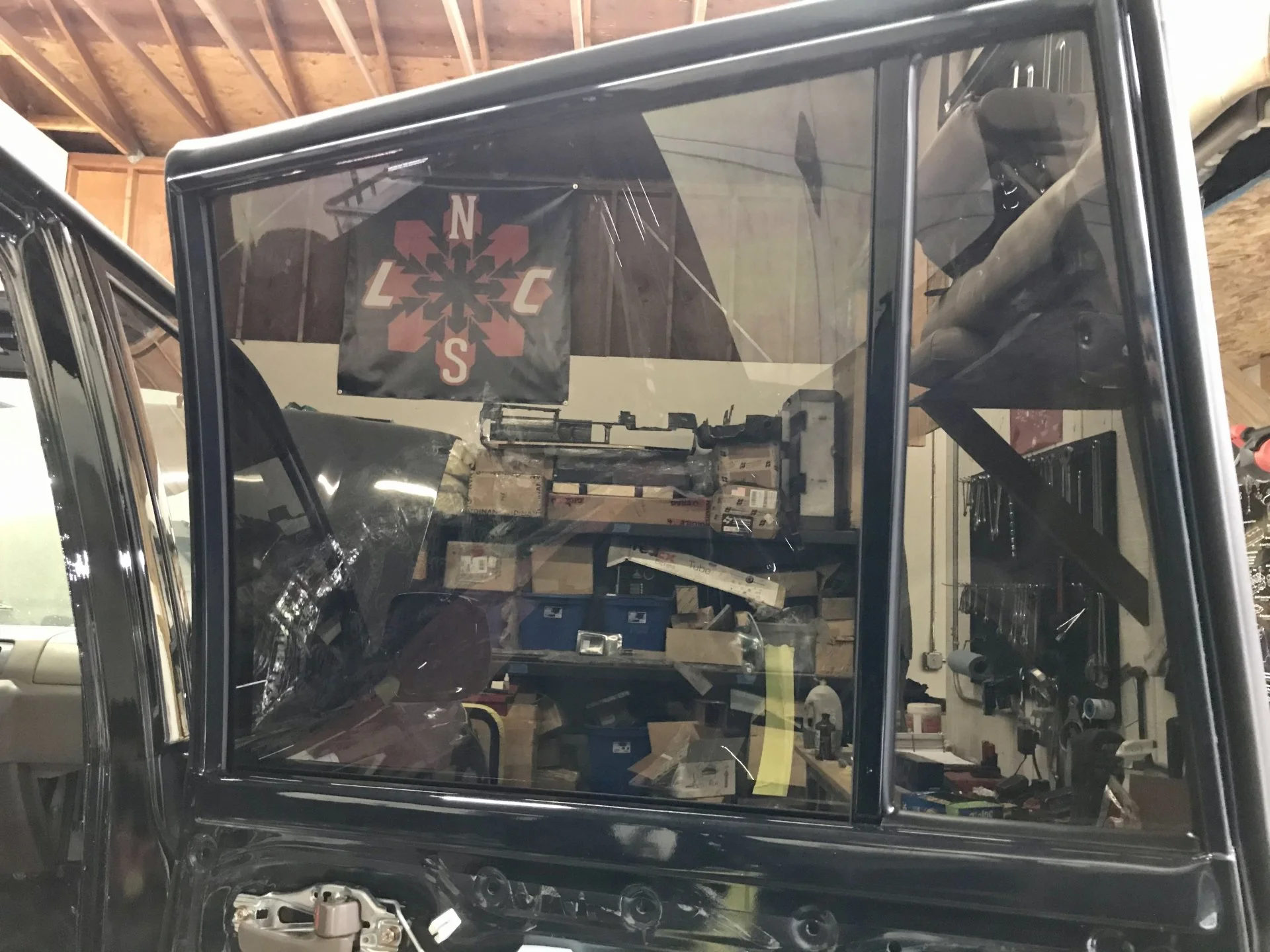

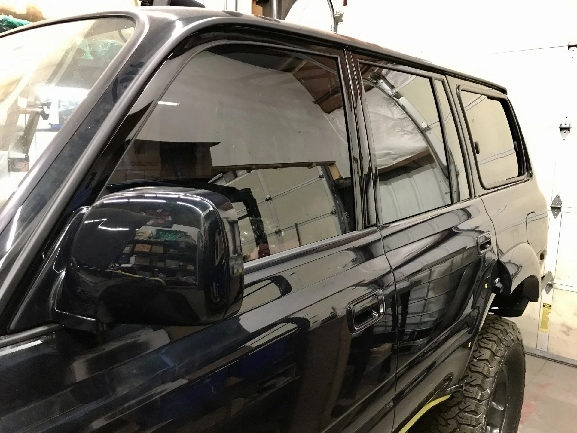

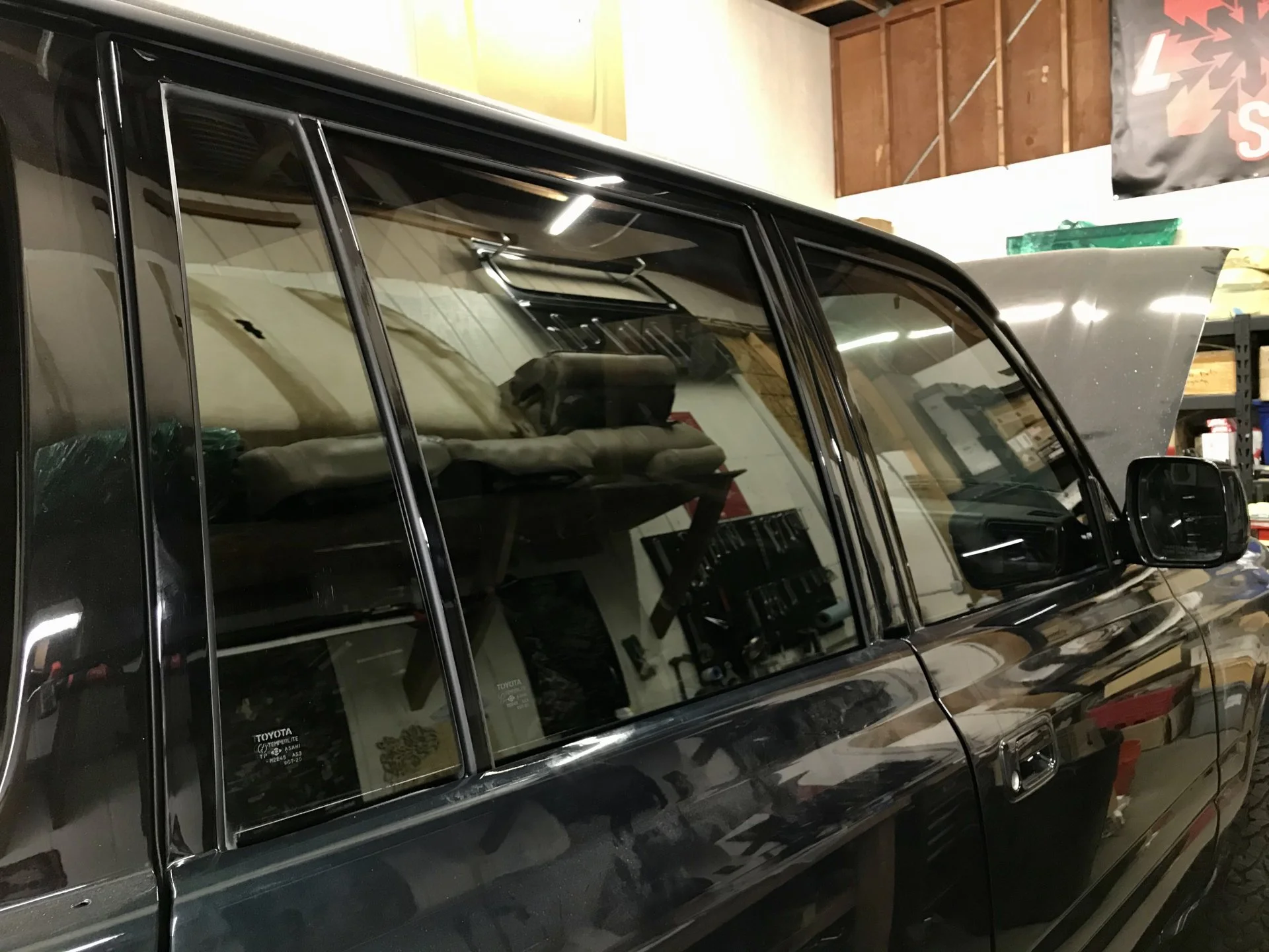

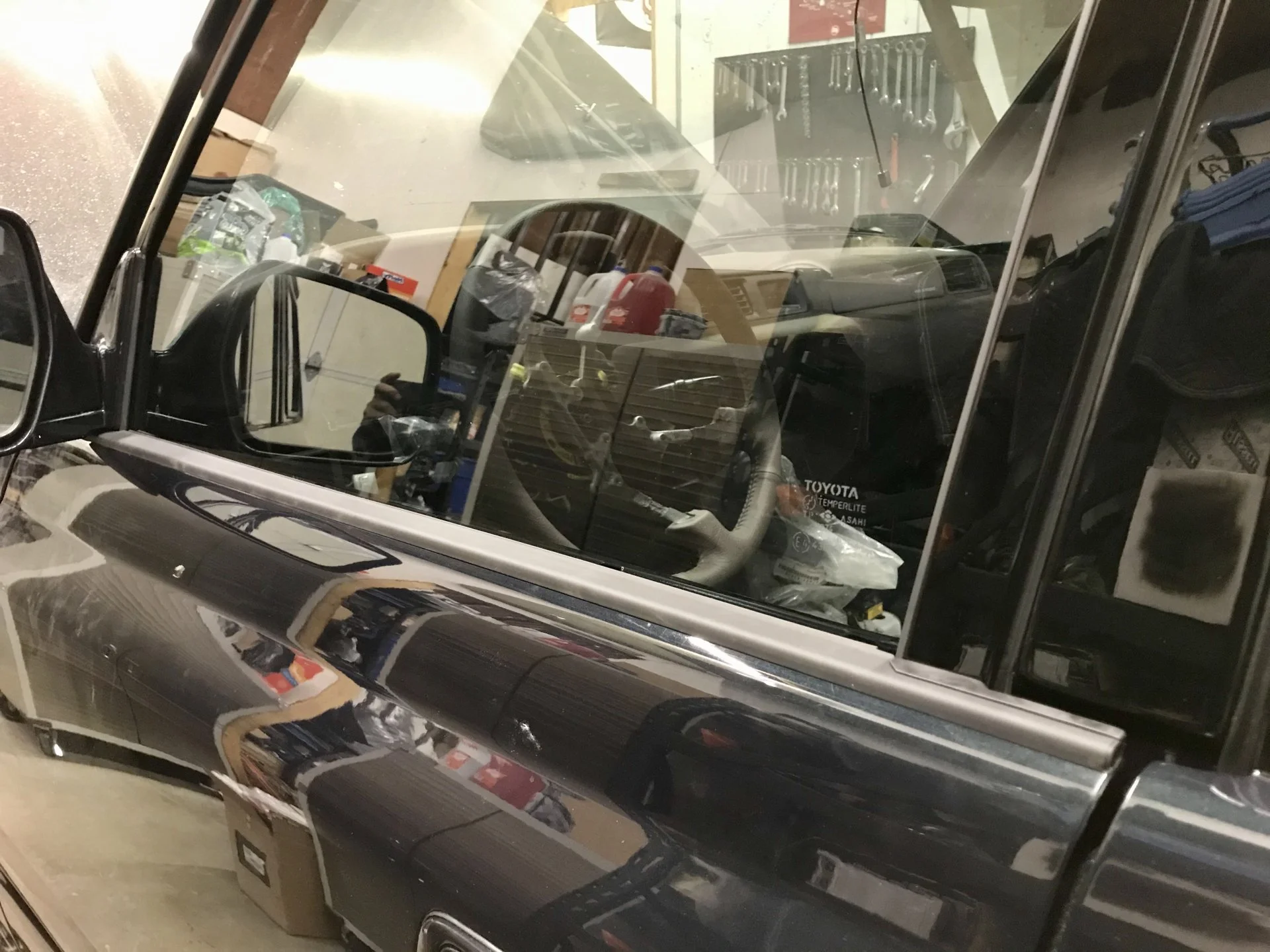

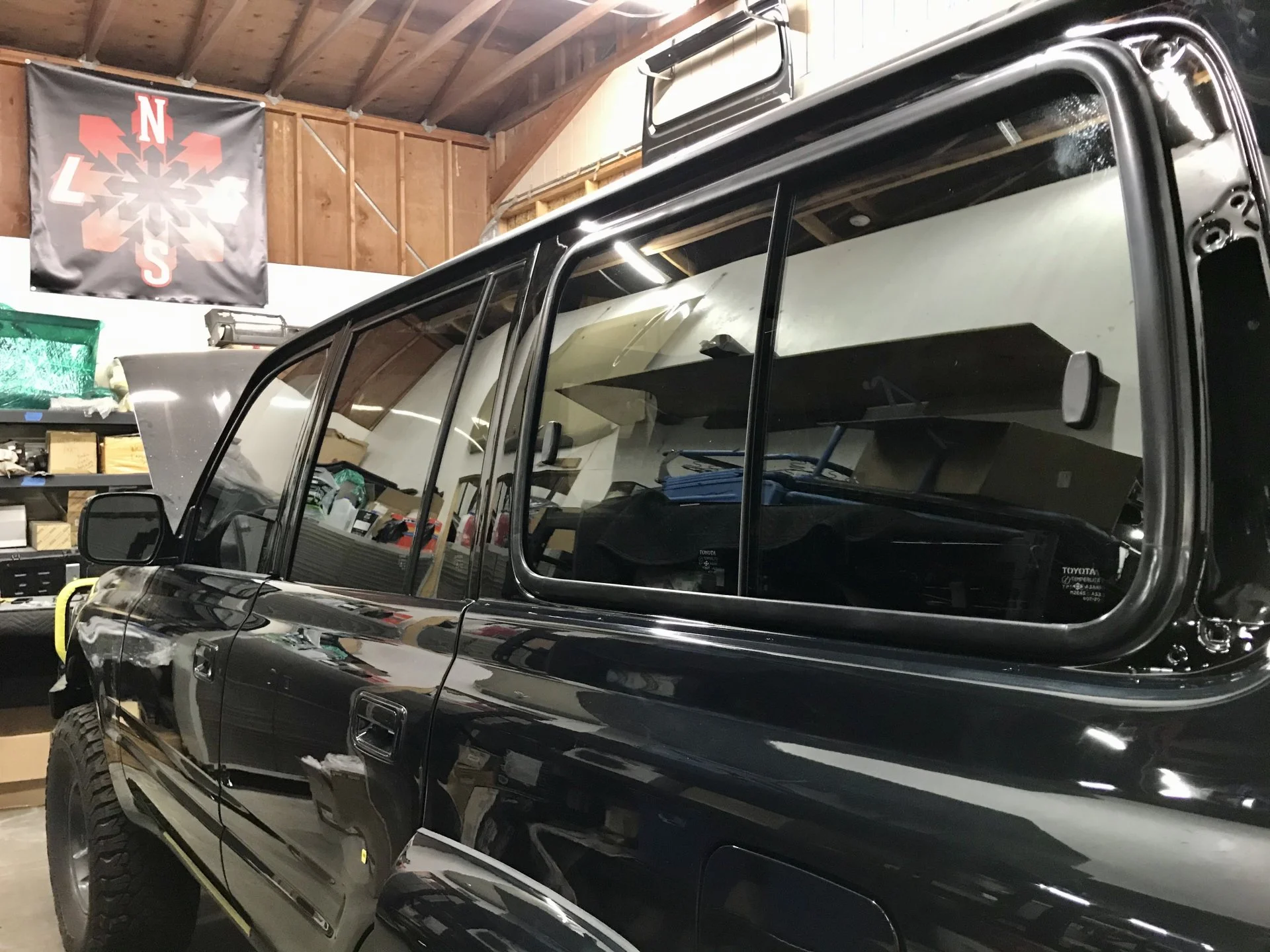

Had some glass tinted, got it back the other day so time to install the glass.
Cheers

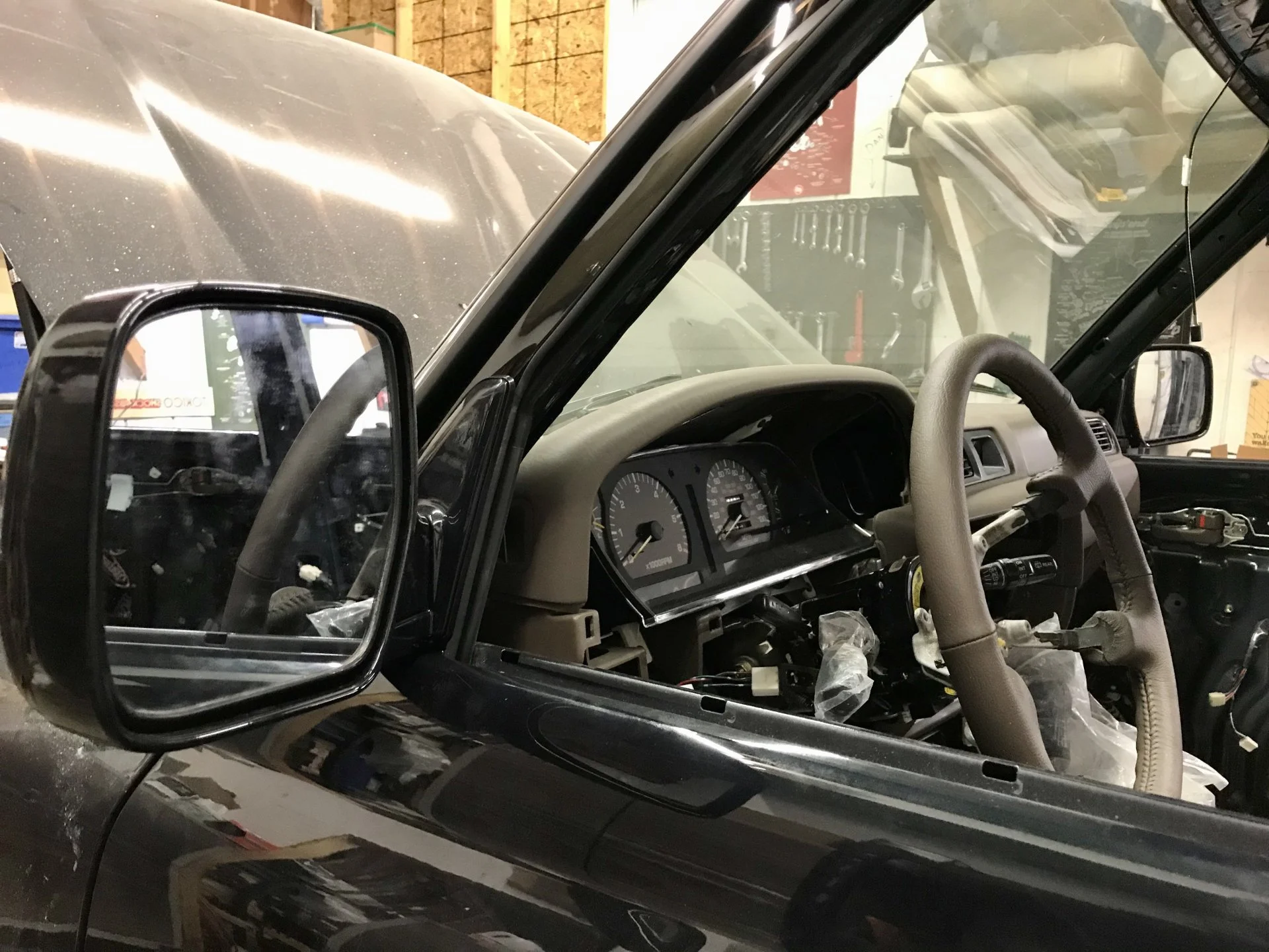

From Toyota.

For real? I had no idea you could buy a new oem dash.....

Not as a complete assembly. The pad is new, black trim pieces new, HVAC vents new, ect.

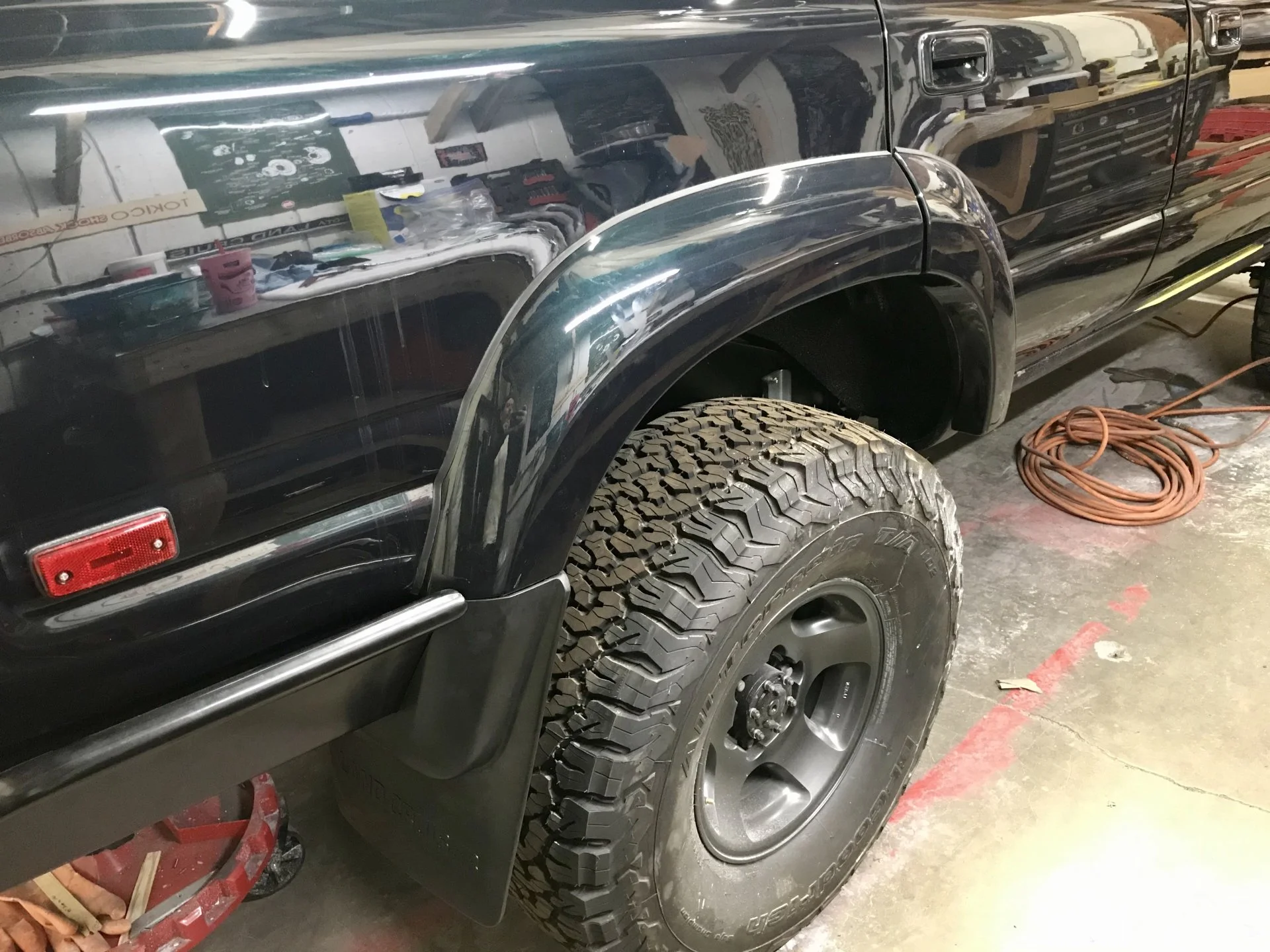

So mud flaps with 4x4labs rear bumper.
They just don’t work or look good in stock form. So we chopped about 3” off of them and then fitted them to work and look good with the 4x4labs rear bumper.

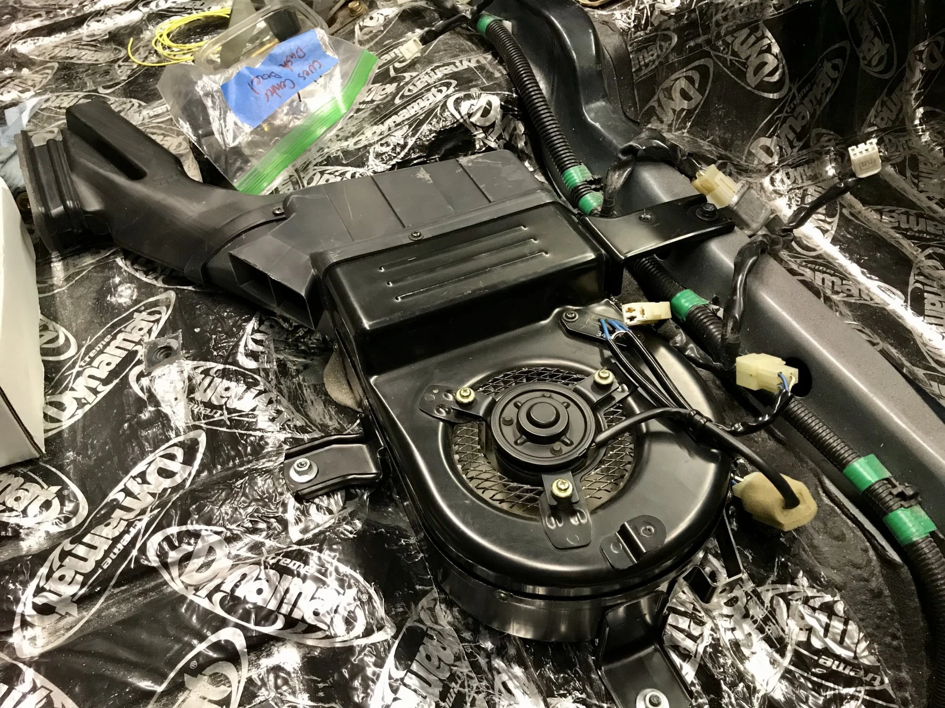

Rear heater fully rebuilt, refreshed and installed.

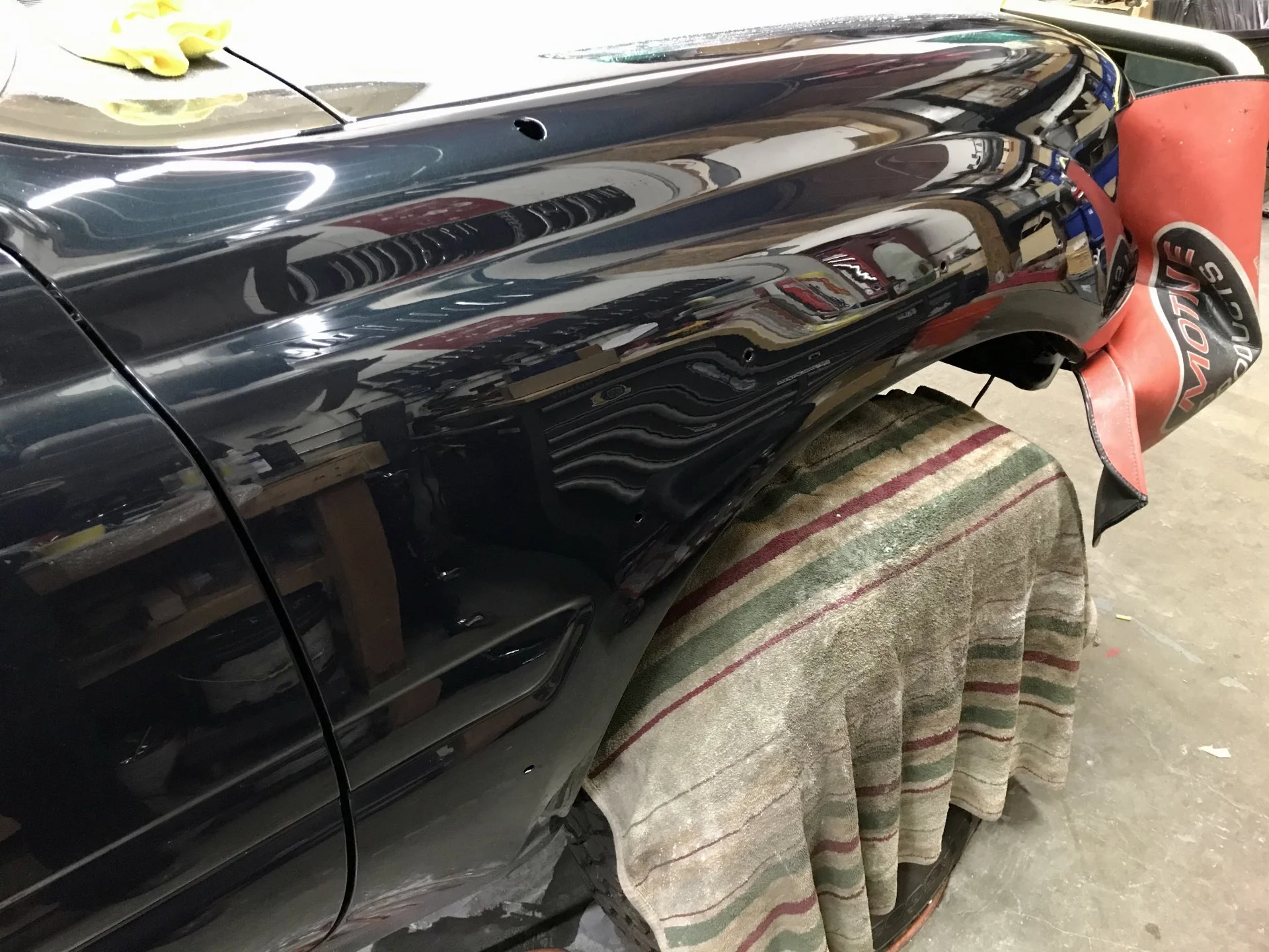

Polishing the front fenders so we can get the flares and mud flaps on the front.

I'd still love to know the tint you are using :) And the more I see of this, the more I know who I am calling when I'm ready to take the leap! Amazing work!
Did you cut the 3" off the top edge?
I cut most of the flap away on mine, but they still hang down too far for even average off-road use.
Yes off the top to make them shorter.
So it is ceramic, 20% on back windows, 35% on driver and passenger front windows, 70% on windshield. We did not remove the original tint which is a coating.
