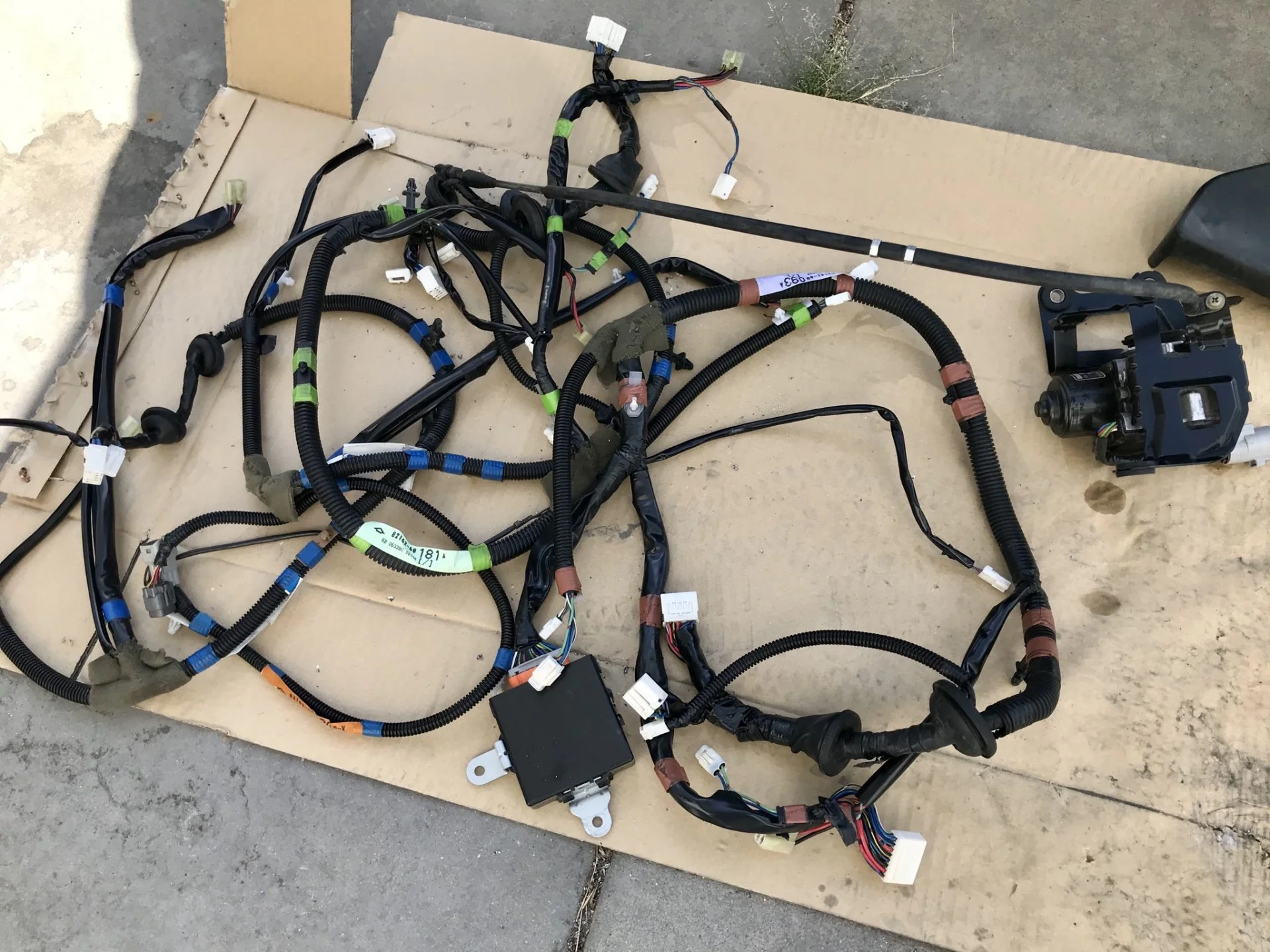

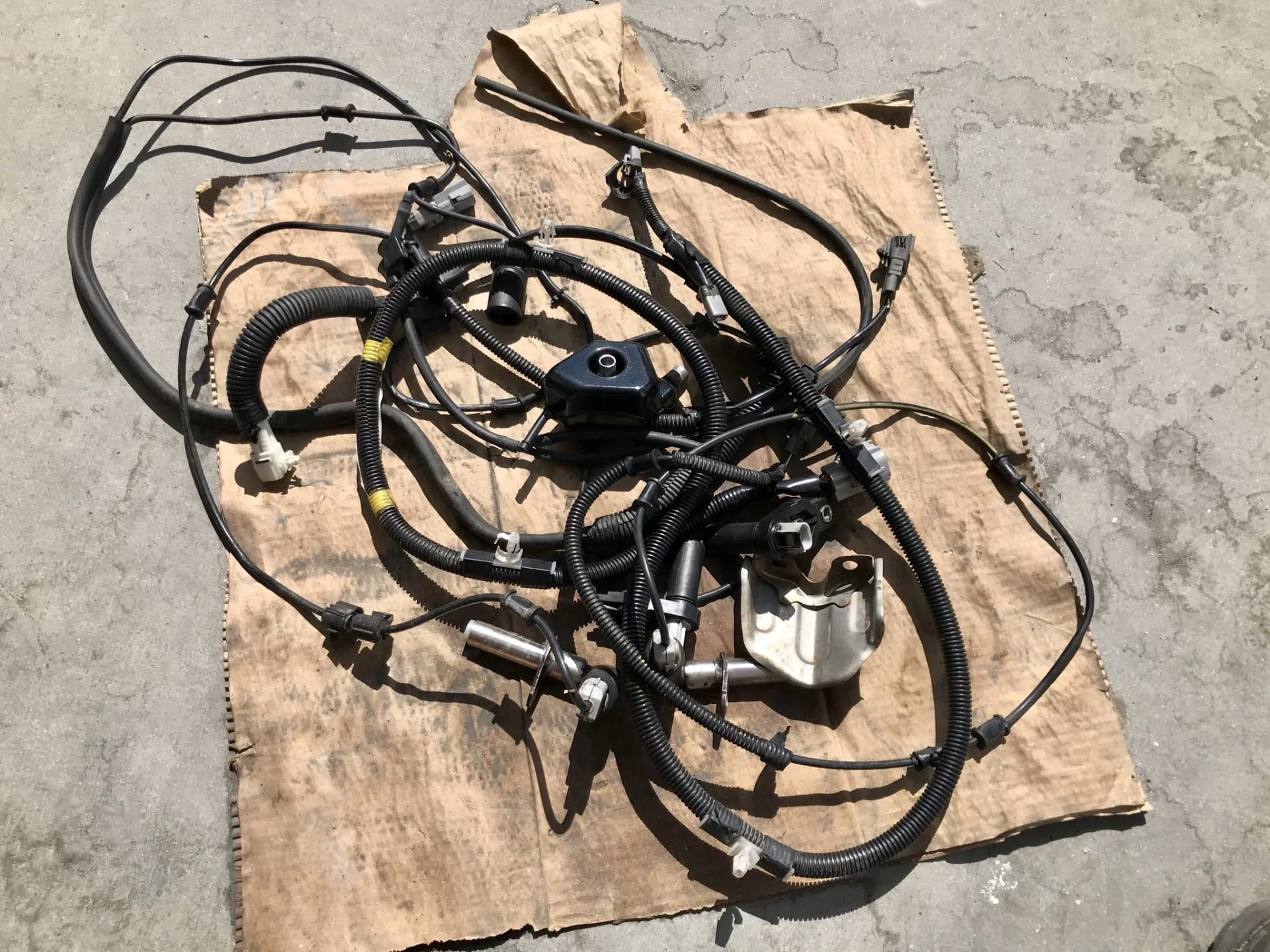

Today wiring harnesses got cleaned, any repairs needed made and fresh wrap where needed too.
Cheers

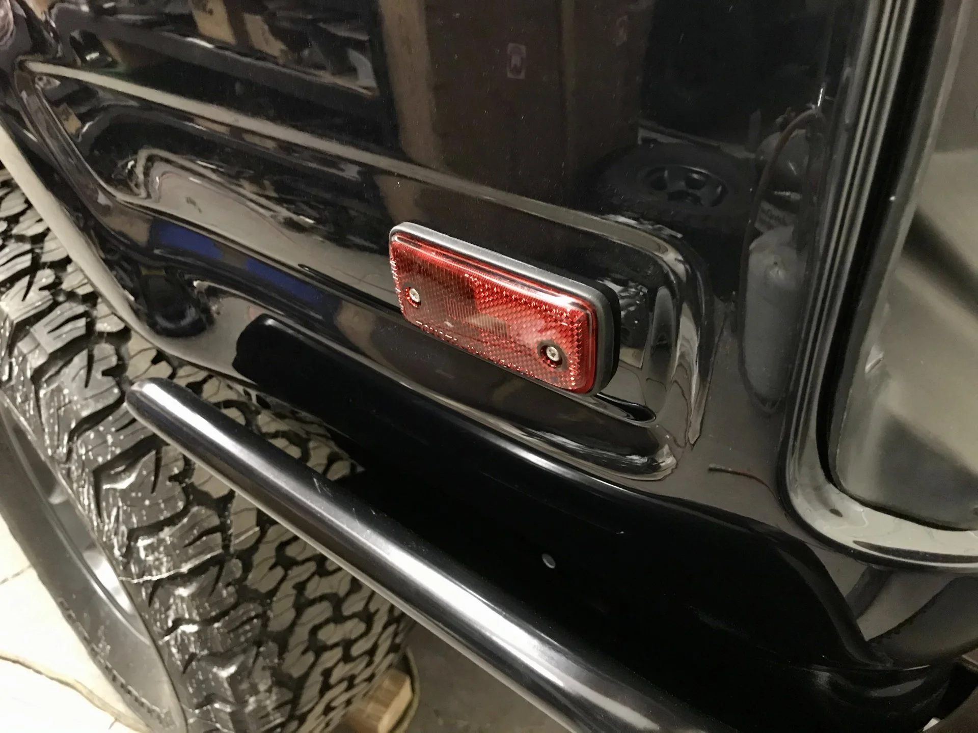

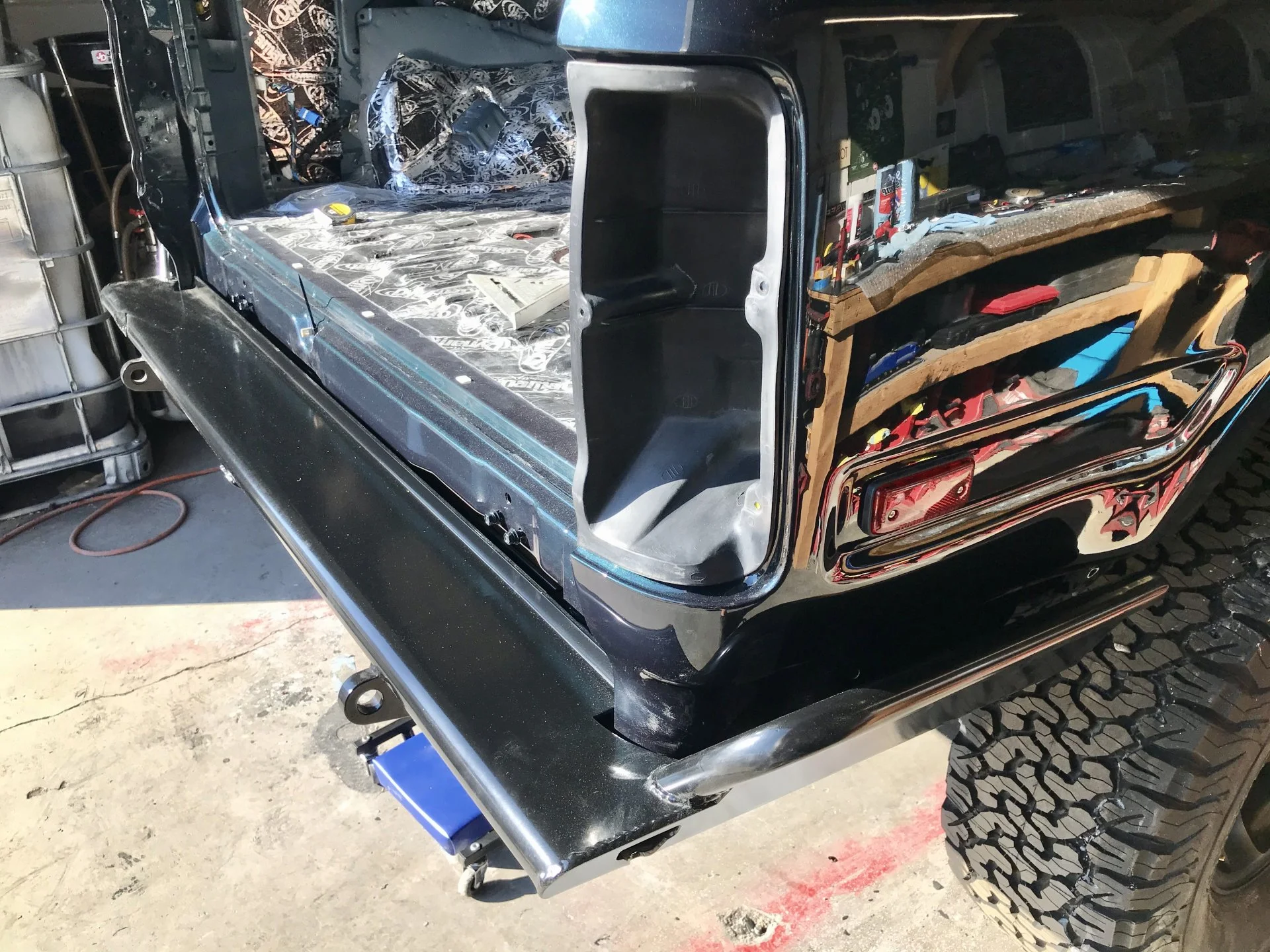

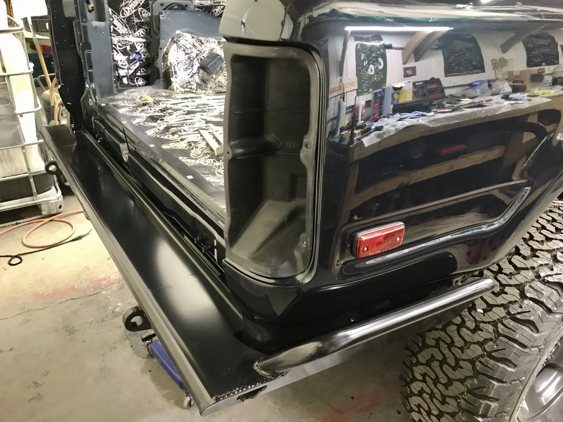

Rear 4x4Labs bumper installed.
New OEM parts.

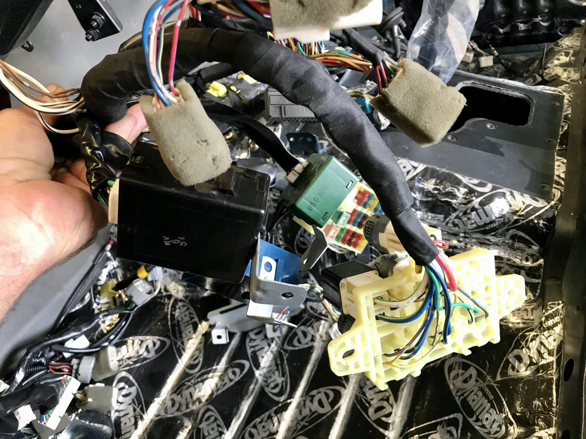

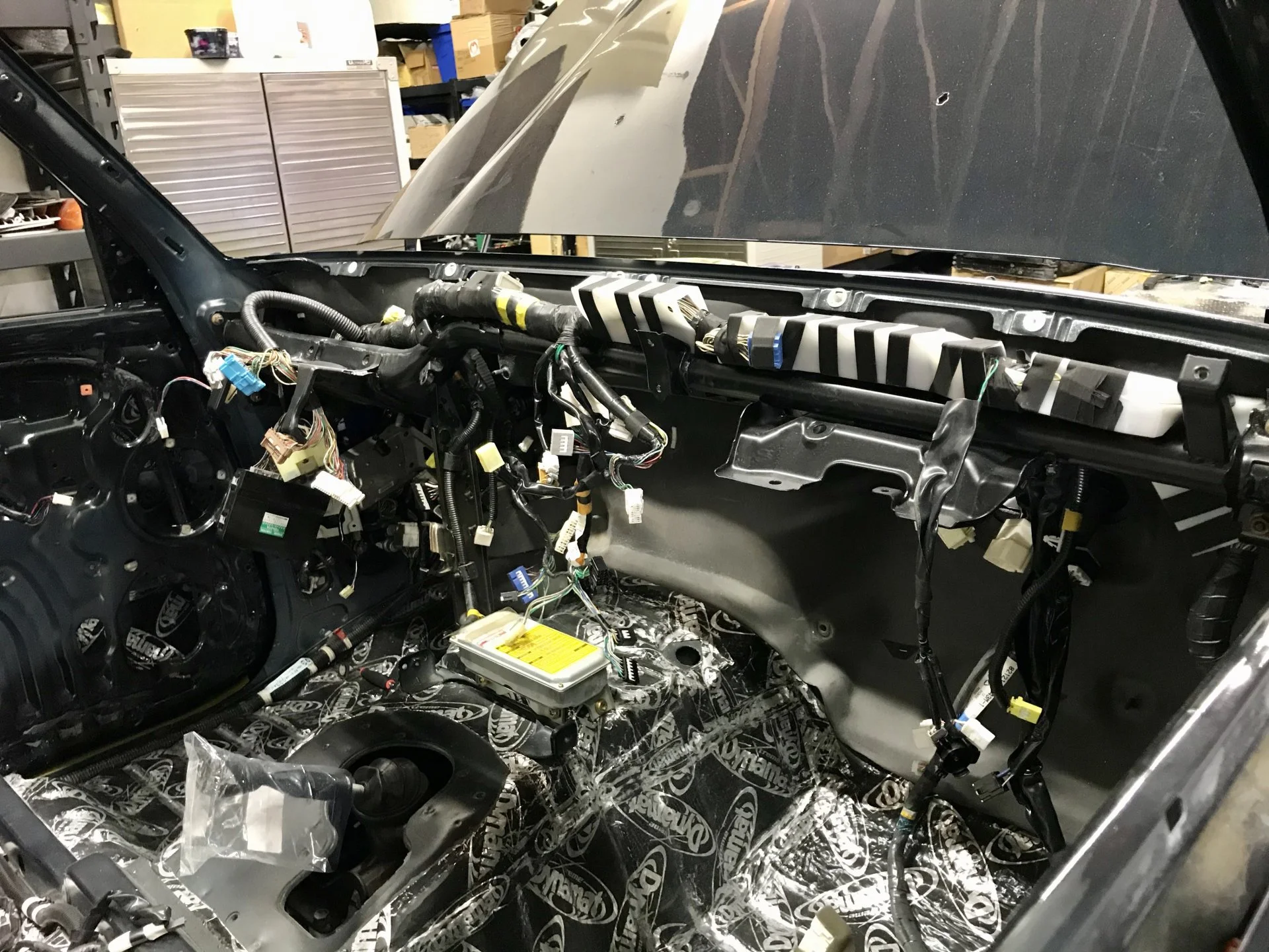

Dash harnesses installed after refresh.

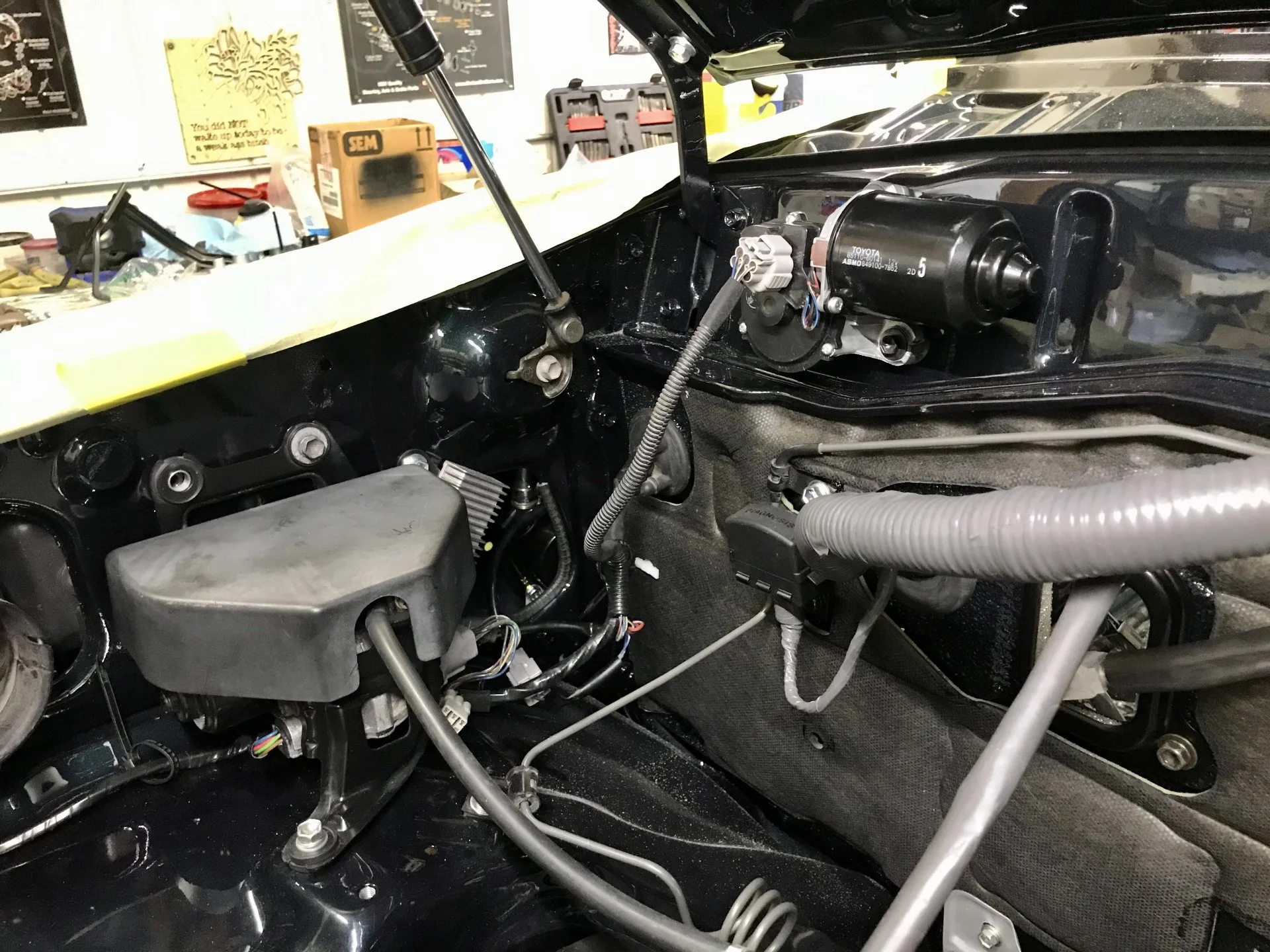

New OEM wiper motor (and linkage) and an original cleaned up CC module.

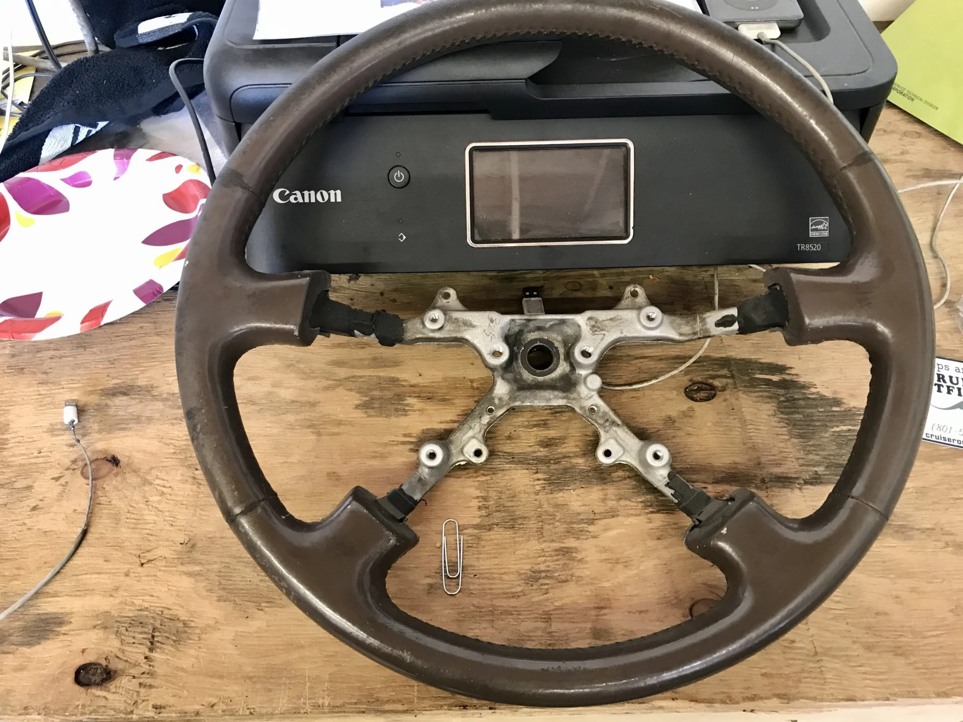

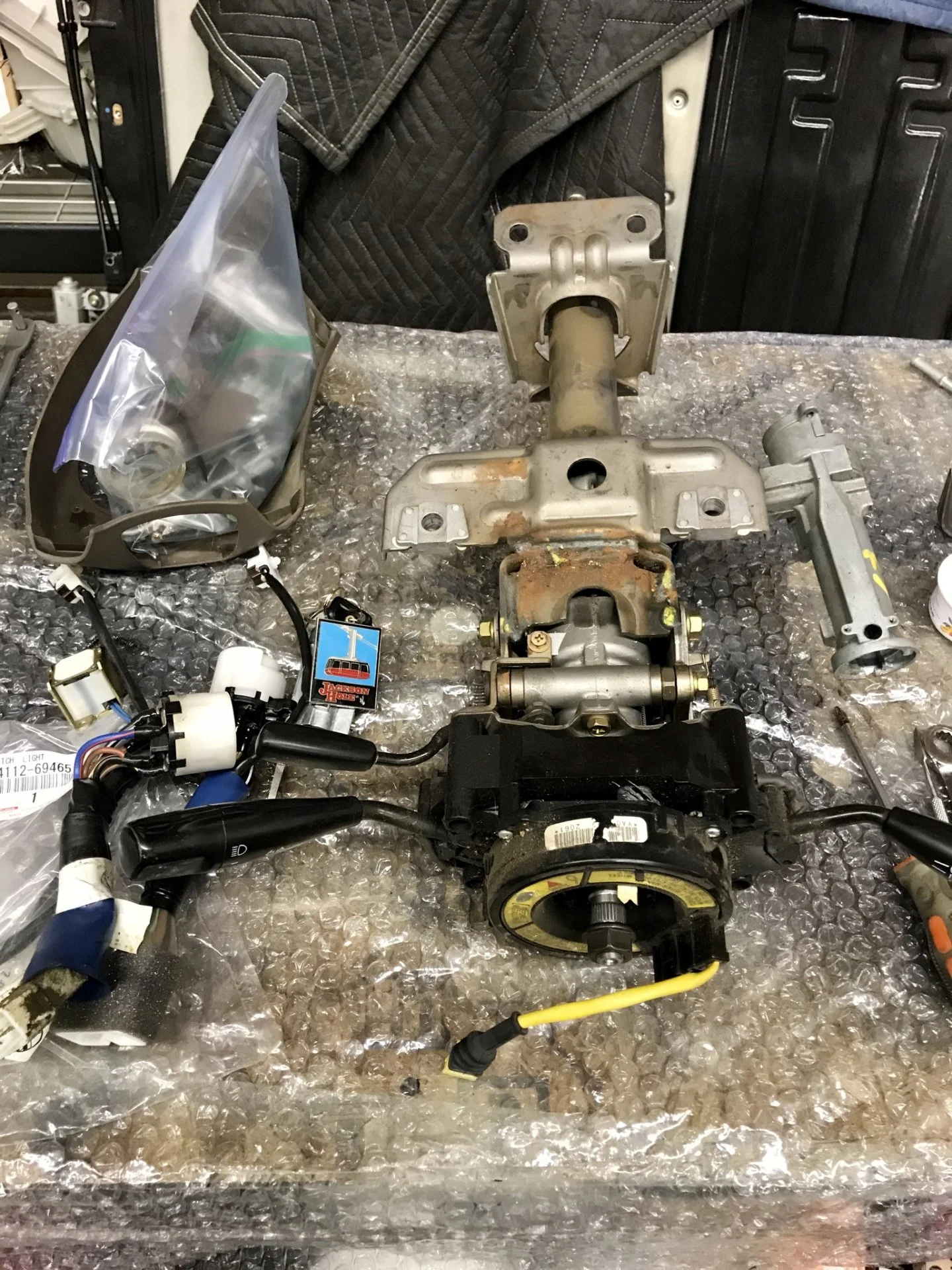

Steering wheel ready to go out for resto. Before pic! 😉

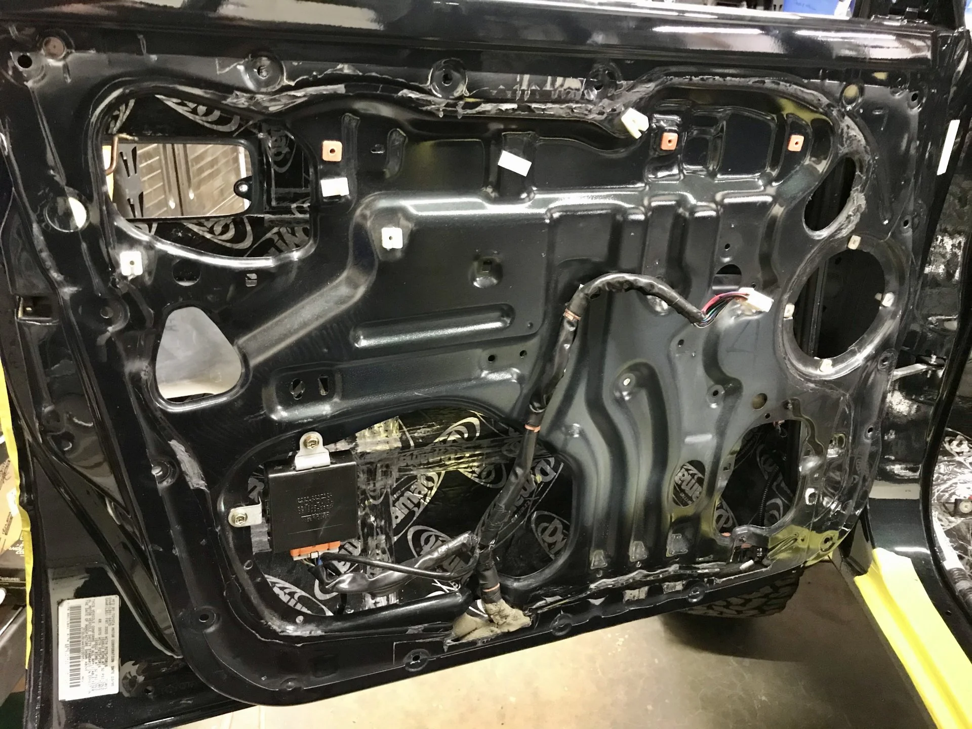

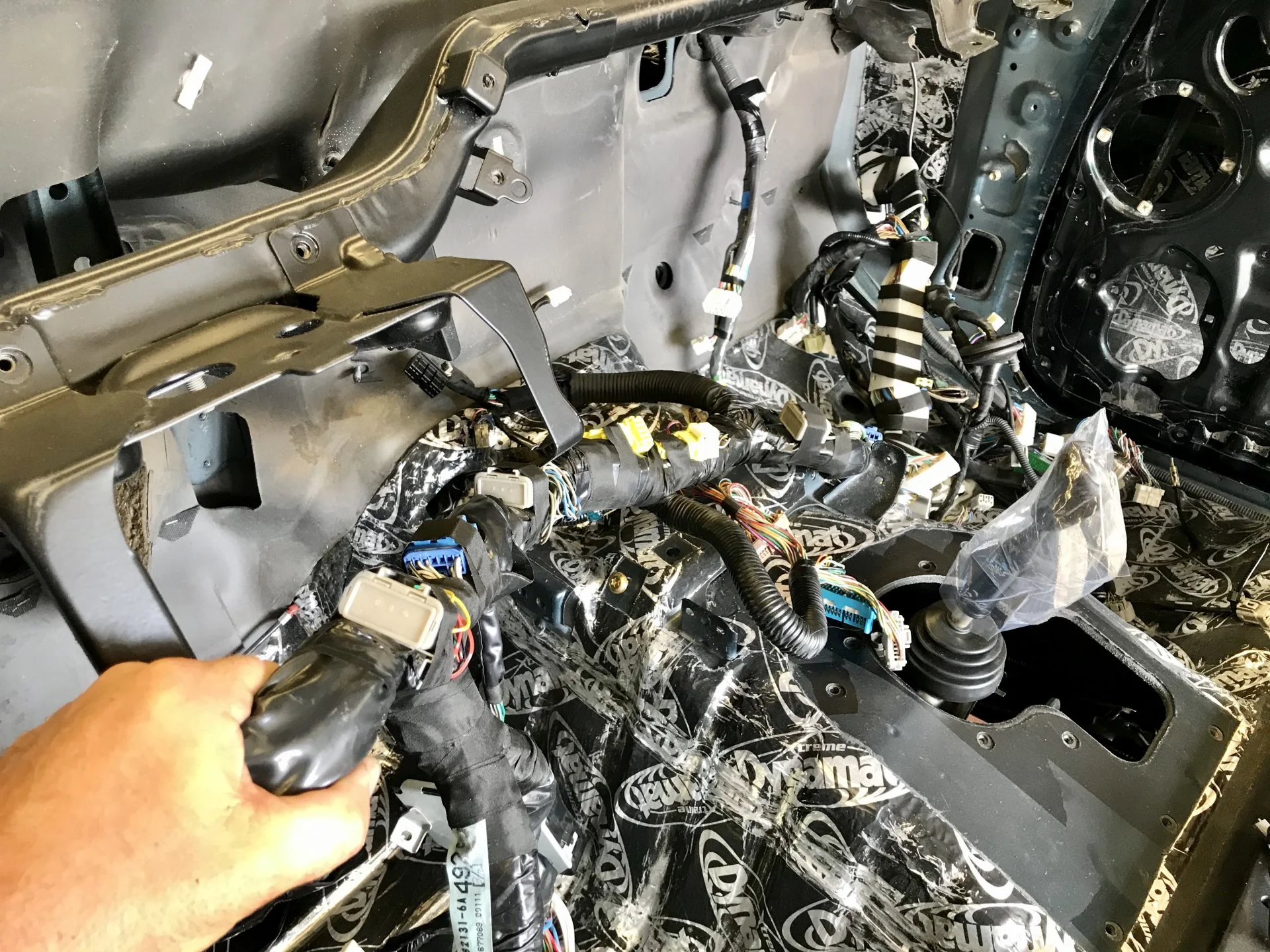

Door harnesses sorted and refreshed.

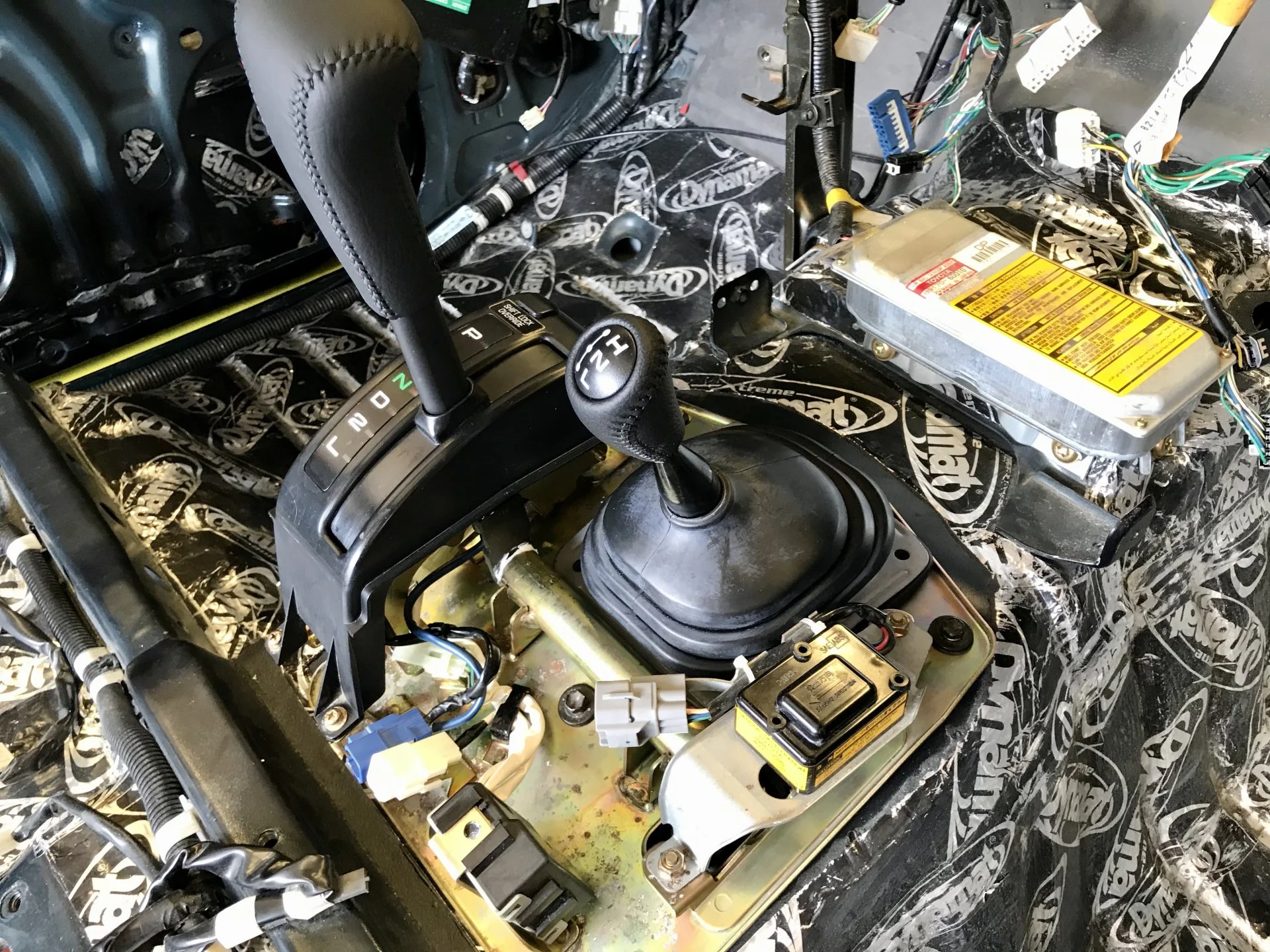

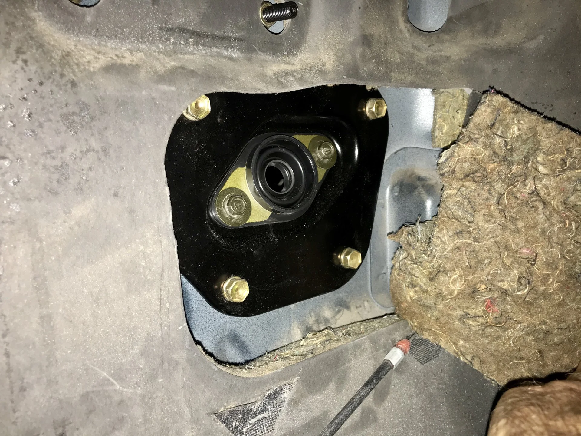

Column to firewall seal is new and plate is refreshed.

What is the insulator used ? And is if for sound or heat and sound ?

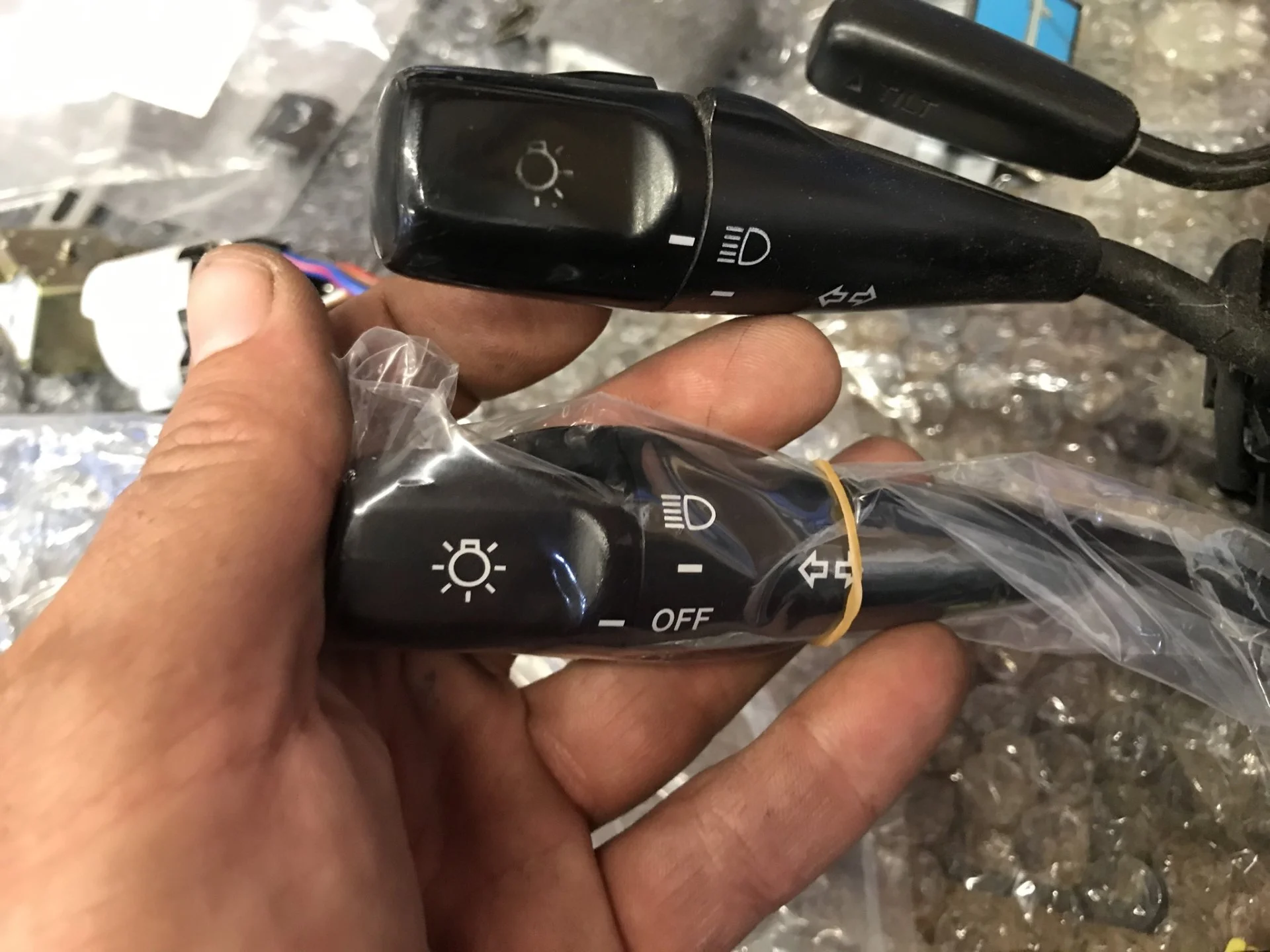

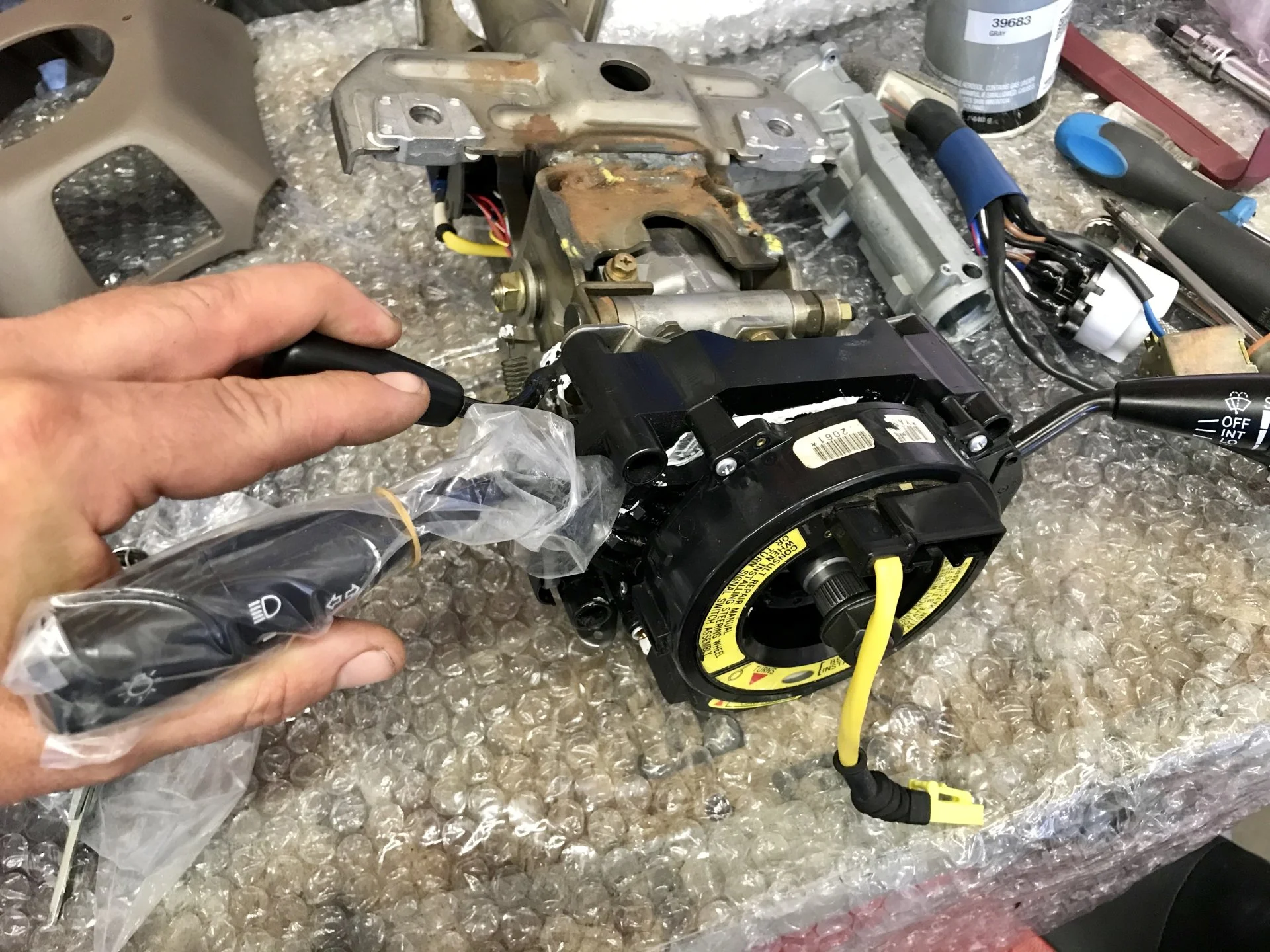

Head light switch replaced.
Torn apart, cleaned, greased and reassembled.

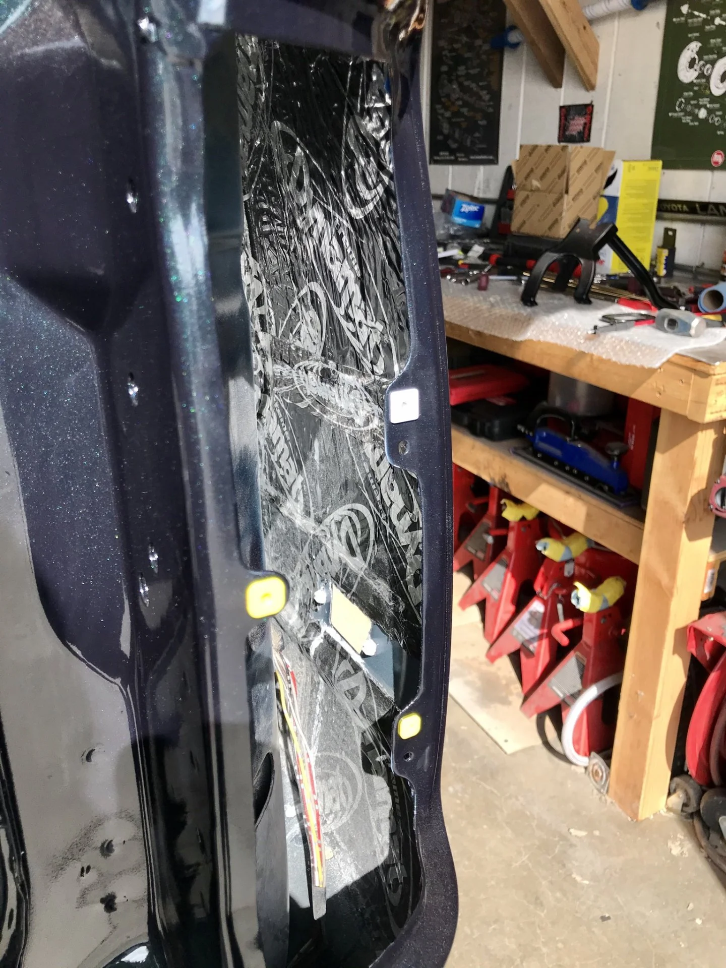

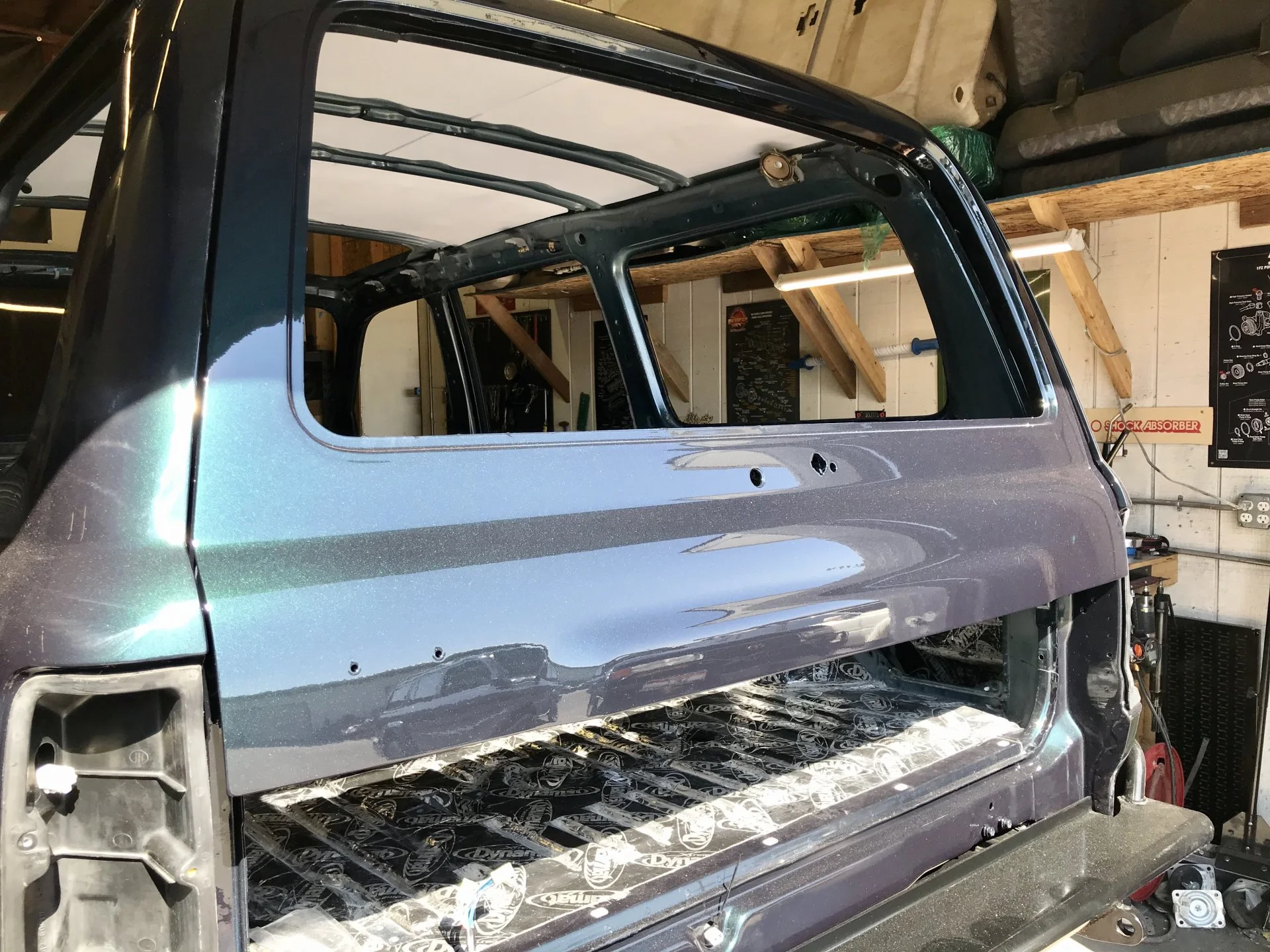

Roof got sound deadening, this is a Lizardskin product.

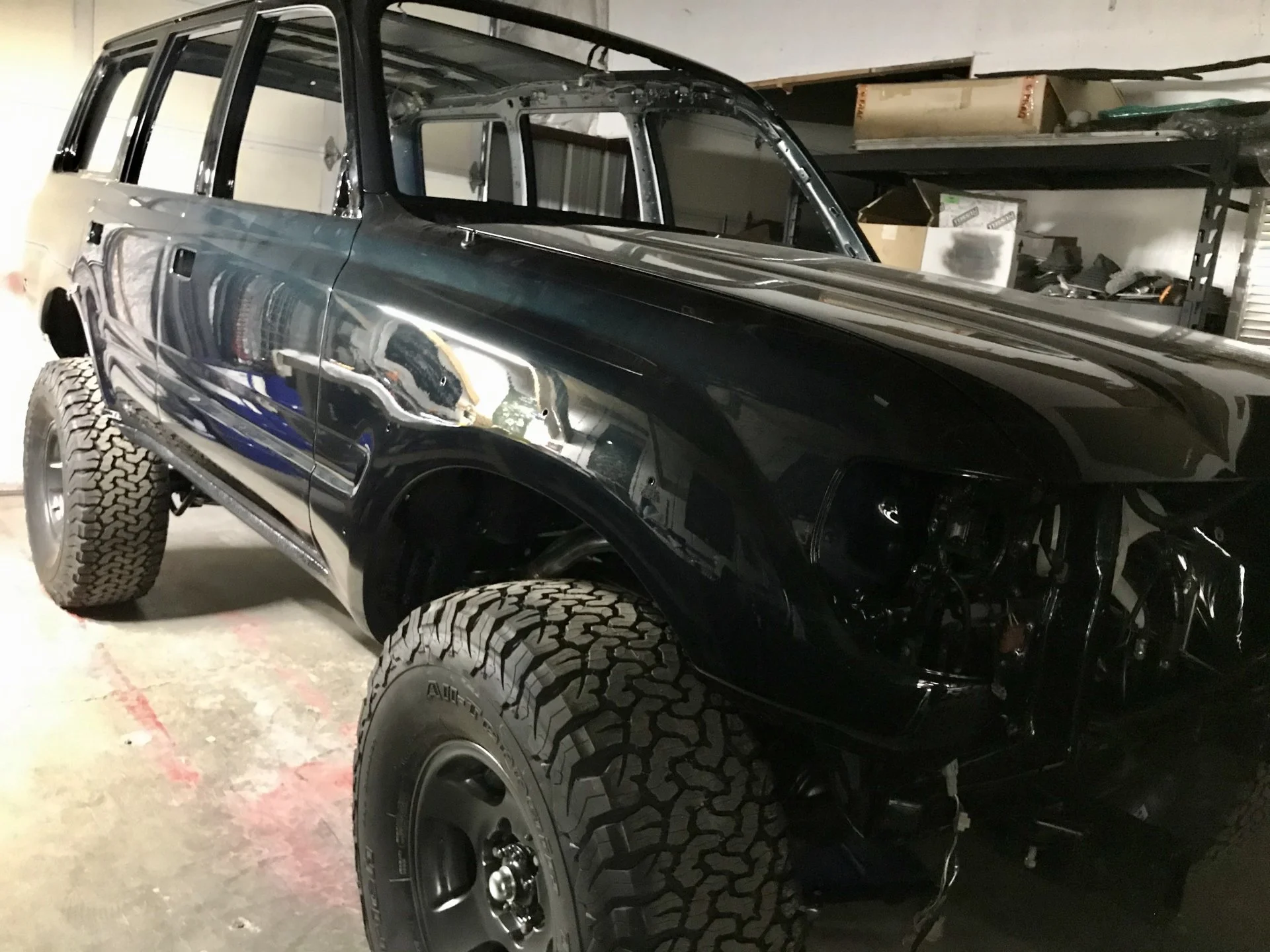

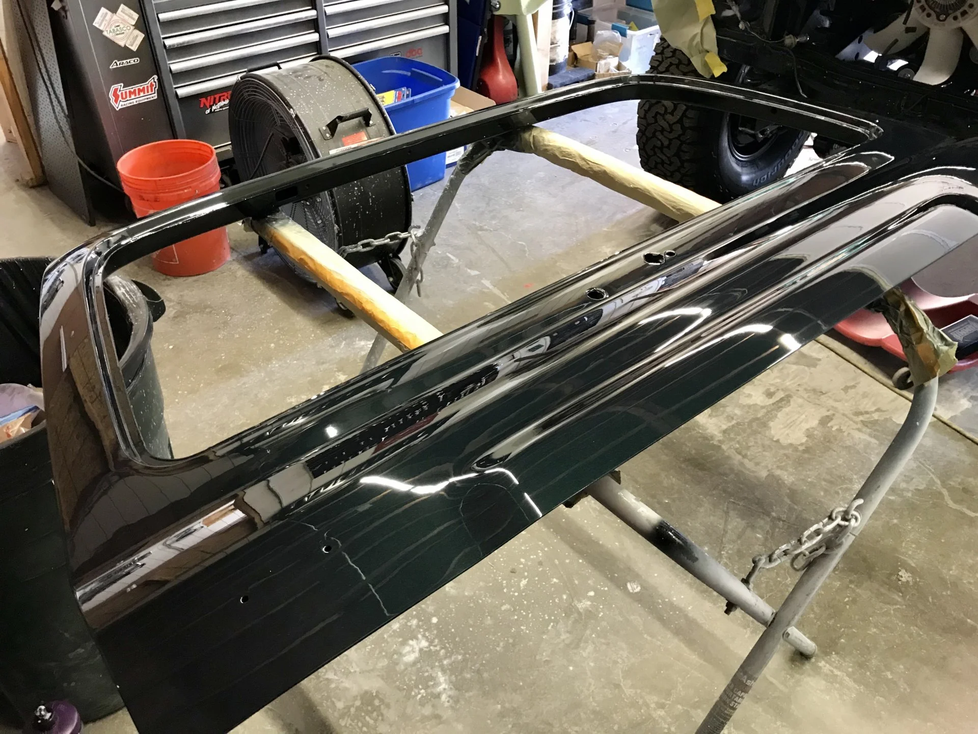

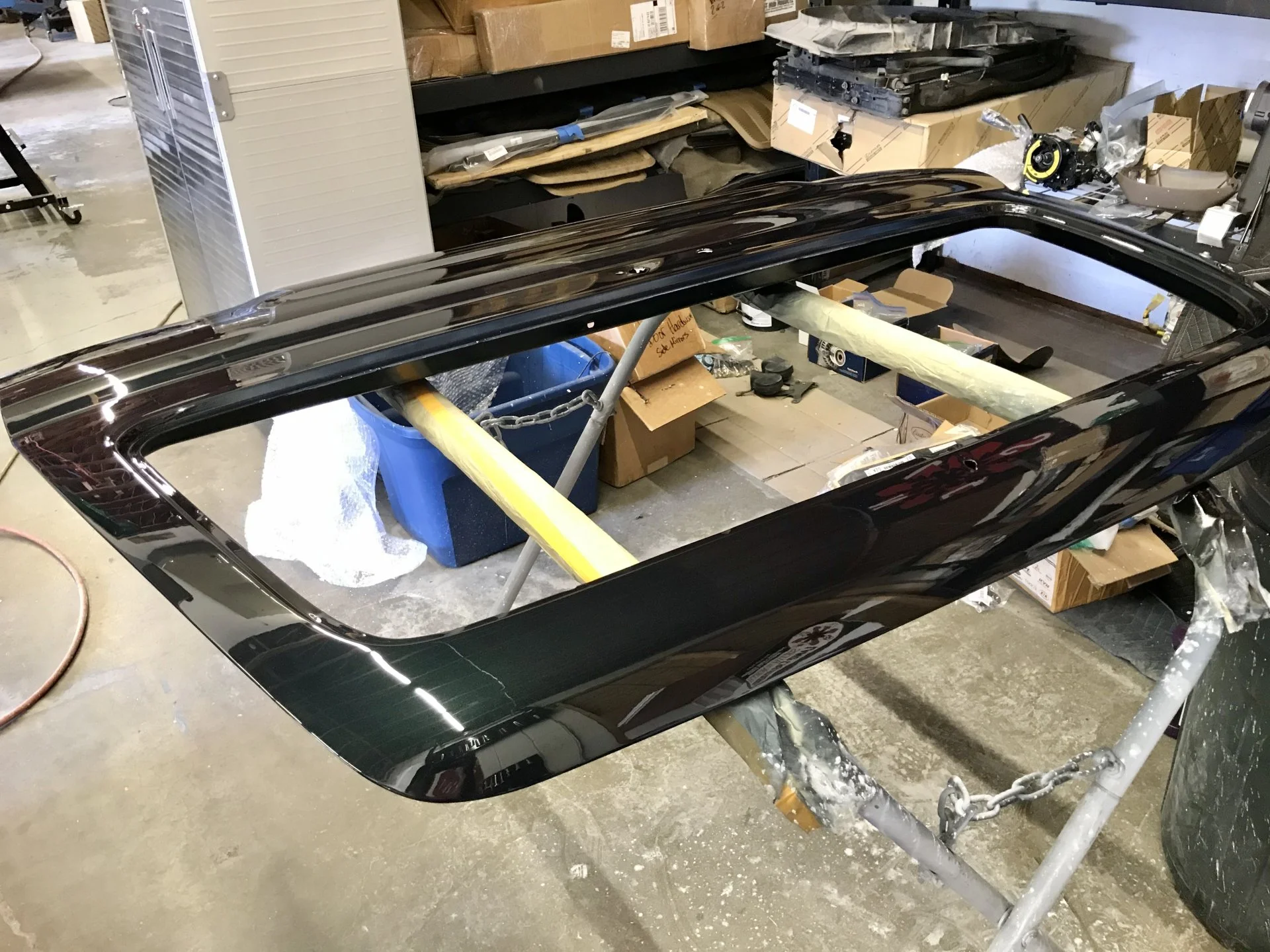

Hatch is painted along with flares.

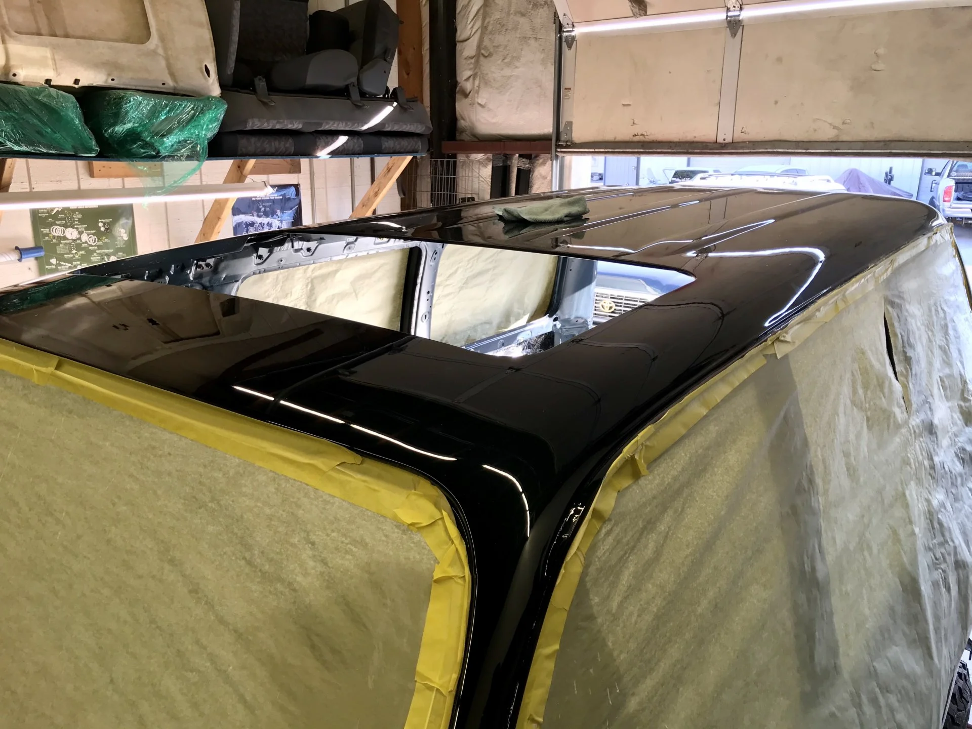

Rear hatch polished, glass going in it on Monday.
Needed to polish around the windshield frame since a windshield is also going in it on Monday. Just went ahead and polished the whole roof.

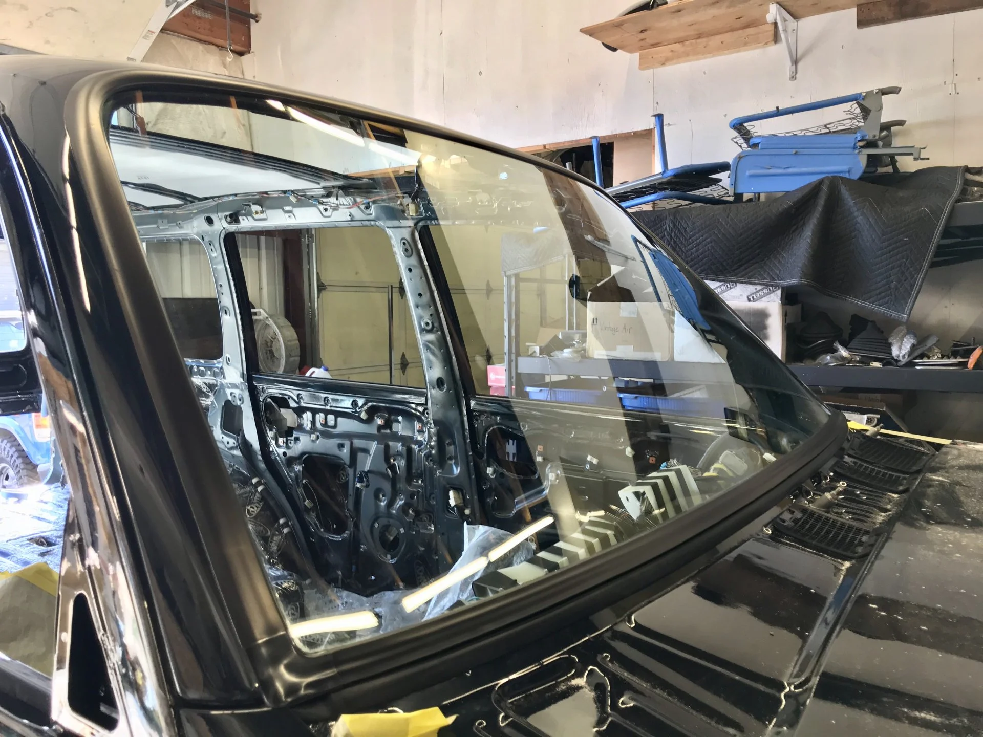

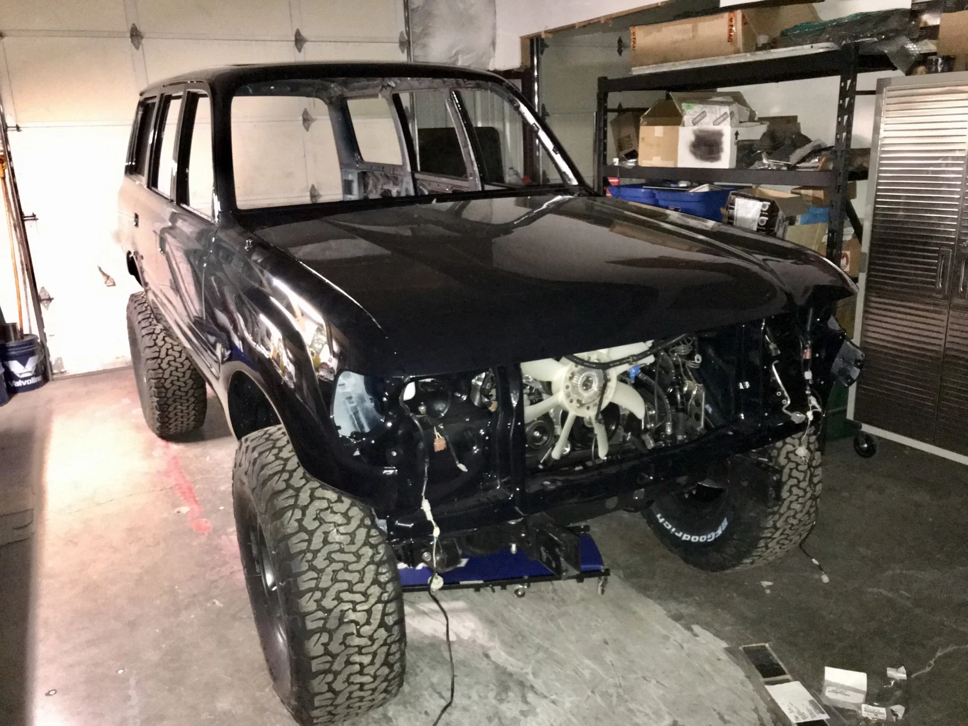

Rear hatch glass and new windshield went in today.

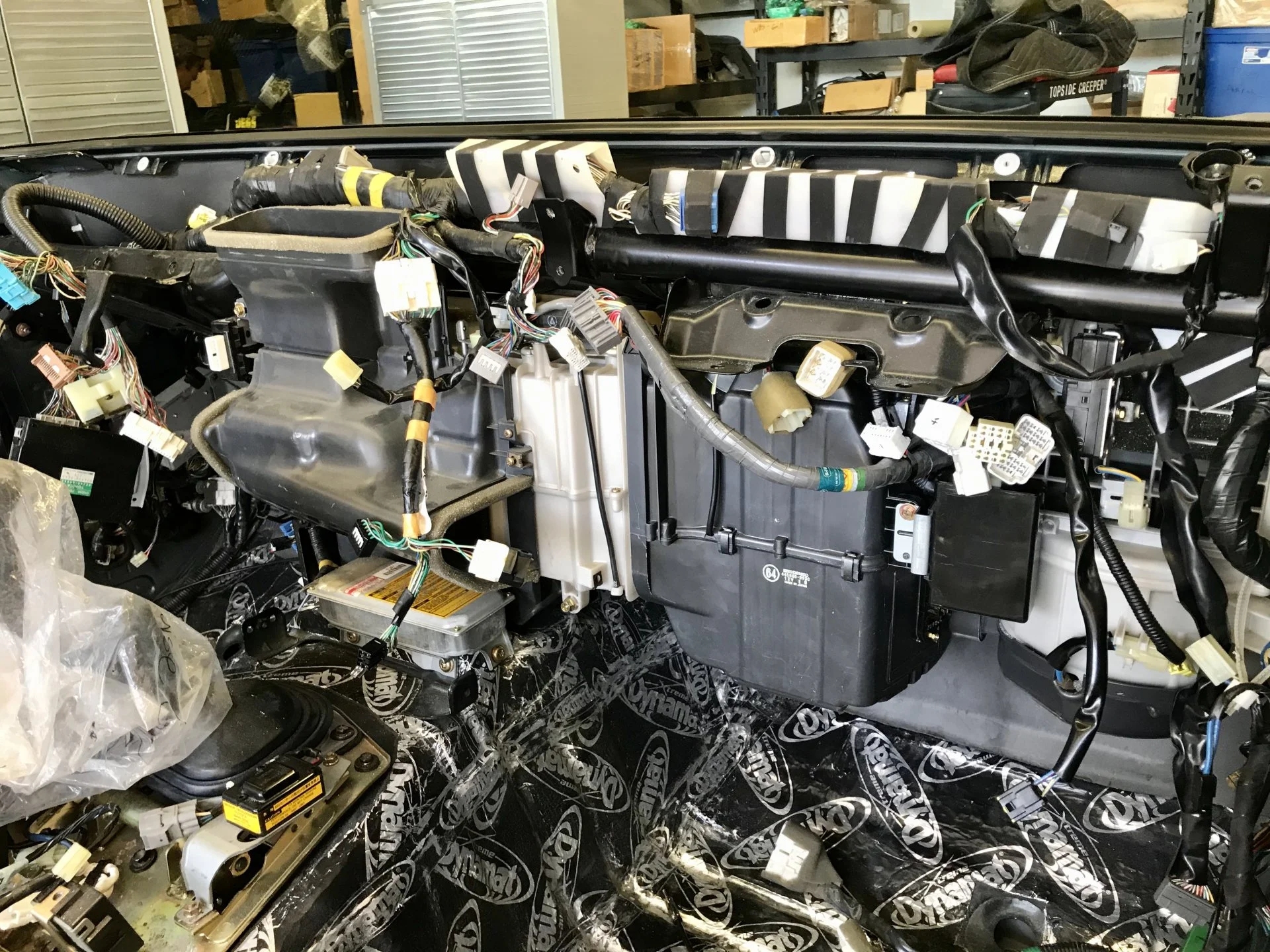

Started installing the HVAC system.
