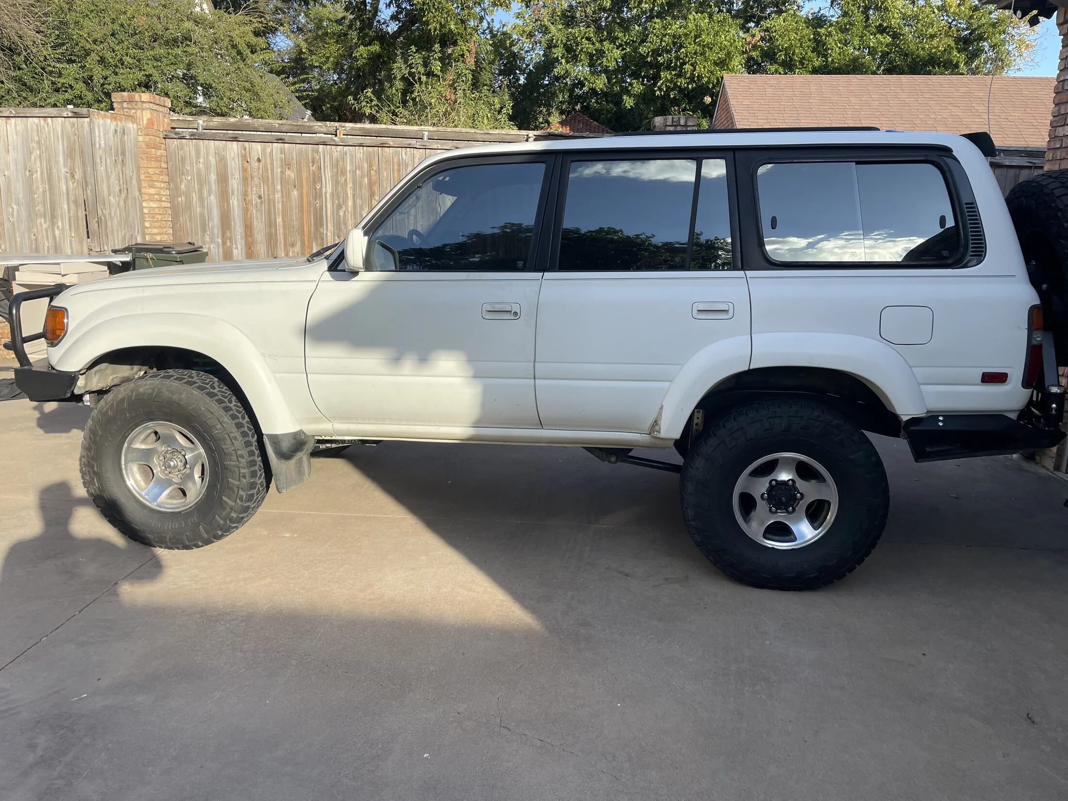

Well here she is. Her stance is a bit stink bug. More than I expected. Using Dobinson springs 185 in the rear and 176 in the front. Which is a 3” lift with 110 lbs added I. The front and 3” inch lift with 220 added in the rear. So I figured the delta bumper and equipment would’ve got it to sag some. I did take some measurements today. I think it went from 25” to 24” from bottom of fender to center of rear axle. Not exact measurements. Eyeballing it. It had a half a tank of gas , no third row seats, no gear, and nothing in the gas cans. I bet with gear and 40L of fuel it will settle in a lot more.

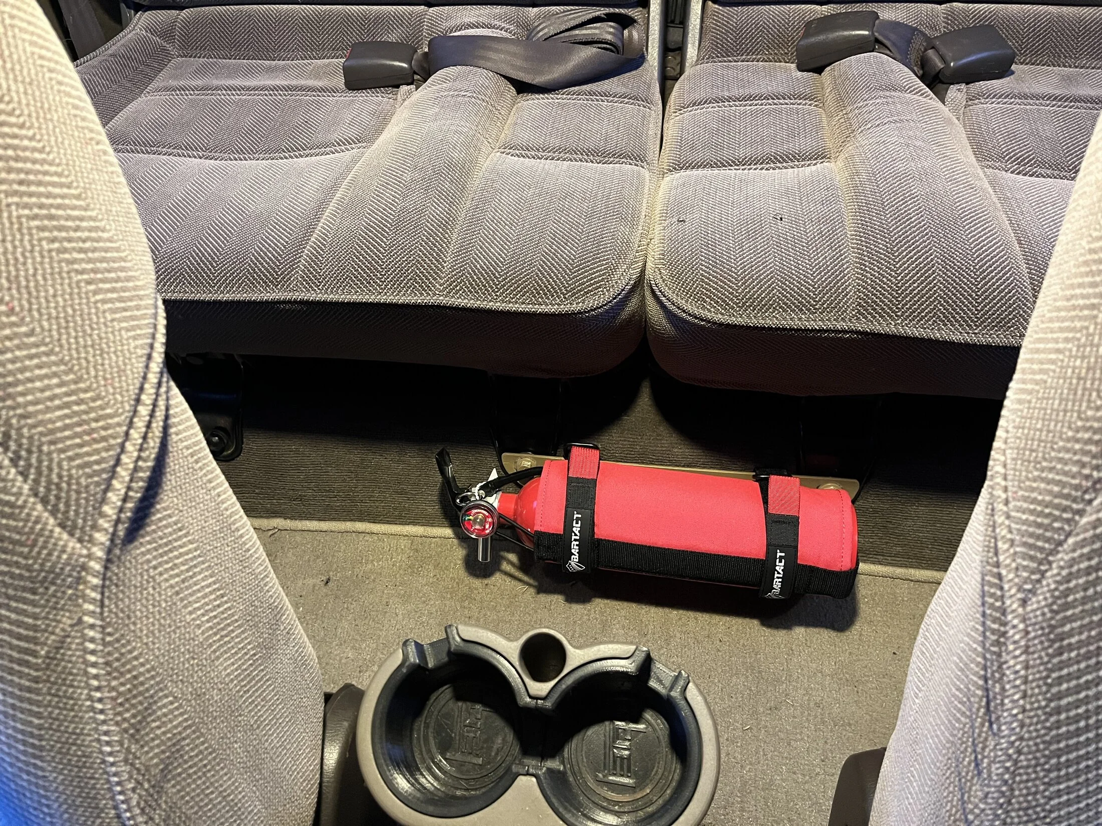

Two things I need help with, I really need a fire extinguisher mount. I’ve seen the stick style mounts, which those stick fire extinguishers may have a purpose. I think they maybe lacking for my comfort level as a primary. I wish I had gotten a wits end mount. Anyone know of those floating around? I’ve seen Deltas mount on the third row mount. I think that is kinda in the way for the way I pack my gear. Anyone have any suggestions?

This works great for me…….bought small piece of aluminum at hardware store.
For the fire extinguisher, just do like North did and get some aluminum and span between the two front seat mount locations and make a bracket for a standard fire extinguisher mount or if you want fancy get one of the quick release setups. This is similar to what Witt's End had and IIRC @Pascoscout used to have (I may be wrong as it has been years).
