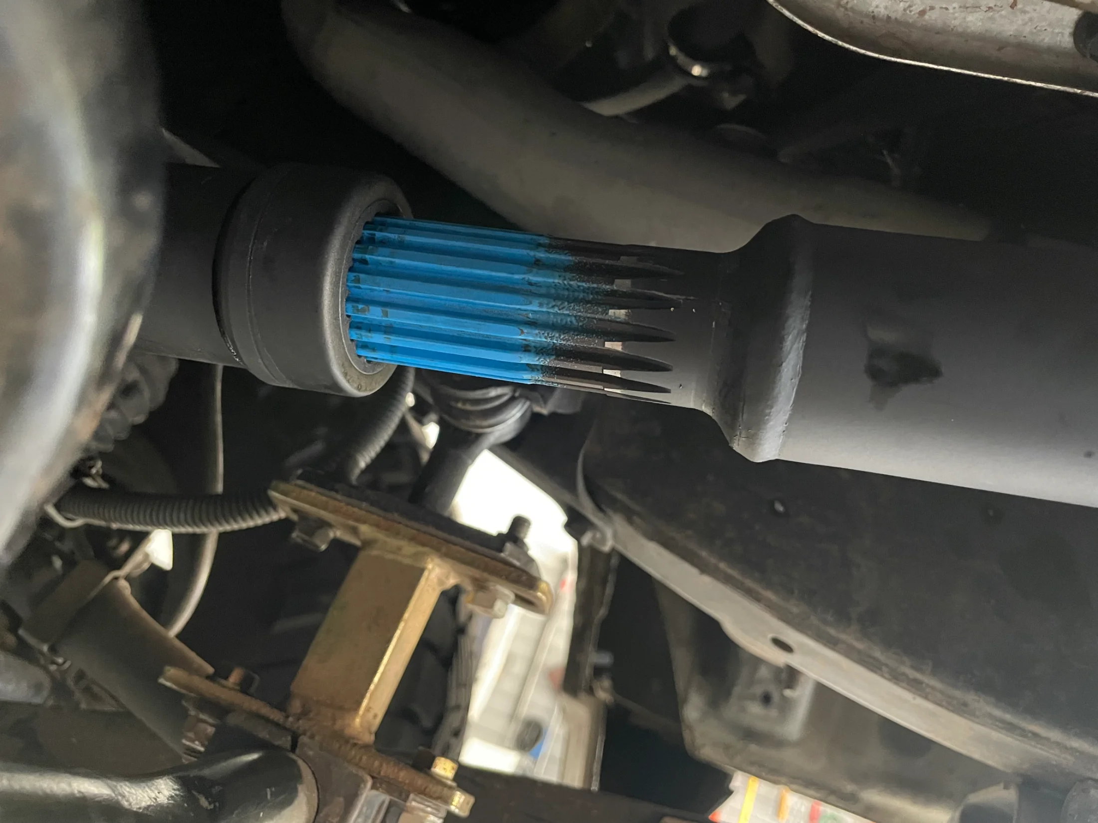

Installed the double cardan driveshaft. Seems to have fixed my issues. Now I’m concerned about a clearance issue on trans pan. Is it good it if doesn’t hit? How much clearance do you need on that side?
Did I measure incorrect?? Seems a lot of center spline showing at rest! I’ll call tom woods tech support Monday. 3 inches showing from tip of splines.
How much is inside the shaft? They can make it how you want. I was telling them I am moving my axle forward an inch for 37’s when they did my front shaft and they built it with that in mind for me

I drove it, and the gear noise is gone. So that’s good. Not sure moving my axle or tire size matters as the measurement I submitted was with it all installed. I’ll call Tom woods Monday. May have to make a mark and pull drive shaft off and see how much is still engaged. I’m sure it’s gtg. Just curious.

I called Tom Woods, about the length of my shaft (so to speak) and how much of the splines were showing. They have an entire FAQ section on it. Mine is gtg. I’m at the max end of 3 3/4 inches from center of weld to dust cap. That leaves me with 4 inches still inserted. Their goal is 3 1/4 inches showing. Just too many easy jokes with this. Enjoy!

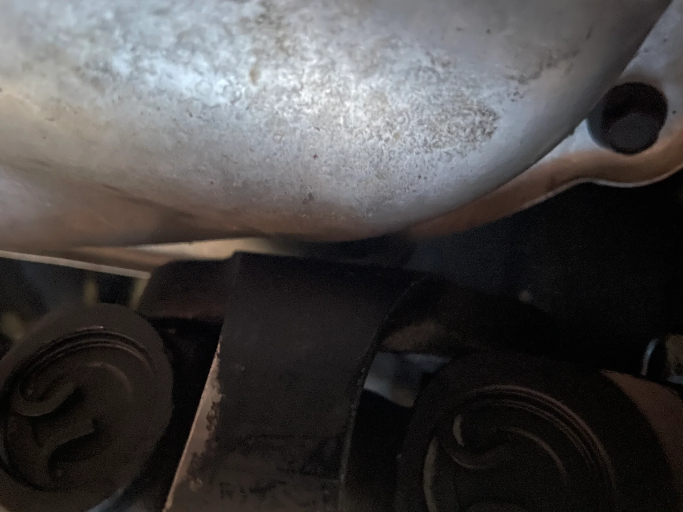

How tight can the DC joint be to the trans pan. I’ve got about 1/4 to the pan. Is that good enough. I’m not sure it flexes too much right there. Obviously I’d like to have more. Any opinions on this?
Here’s a picture. The metal showing on the drive shaft was from install. I’ll hit it with some paint to see if it rubs in the future
The picture is not clear enough to tell.
But I think 1/4” is to close the motor mounts can have that much movement.
At second look I can see it better.
IMO it’s to close.

Yikes well that sucks. I could try clearing the trans drain pain a bit. I could call land tank and ask what the circumference of his cardan joint is.
You may have to do both
For sure the @landtank DC is smaller 😉
Not much you can do, since the trans is mounted to marks adapter to center diff that relationship is pretty set. You could massage trans oil pan, not sure how much of a no/no it is to mount the driveshaft the other way?
