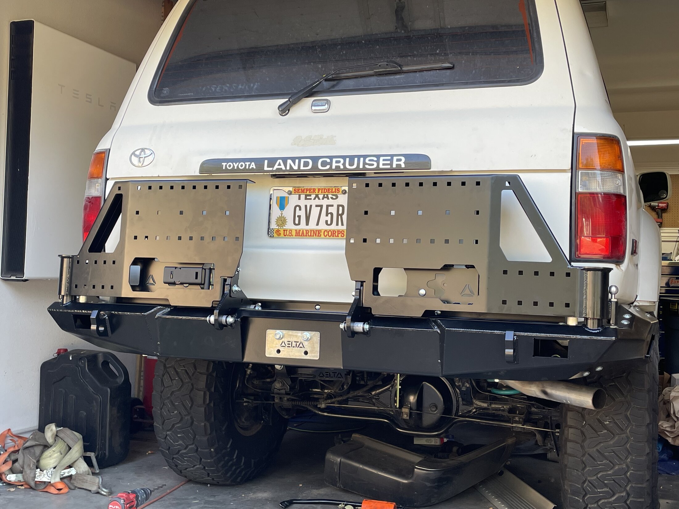

After nearly waiting 18 months she’s here and ready to install! @Delta VS

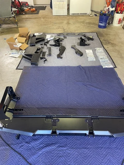

Back from the powder coat shop.
Well been messing with it all day, it is not a slap in on and go project. There are a lot of parts and steps. Easy now that I’ve done it. It is time consuming the first go. Got the bumper on, swing arms in, working on the latch mechanisms. Which is fairly involved.
@Delta VS
I wish they sold this in a weld yourself kit form.
I don’t know. It’s fairly intricate. Based on the shape and design, I dont think and avg diy welder could do it. I think you’d need some serious skills to get it accurate to be honest.
