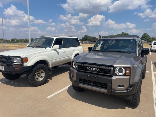

You show em what's up?
Funny it was my buddy’s wife. They just got it. I was a bit envious of the creature comforts for sure. They are real nice inside. I wish I had paid attention to noise reduction and heat control on the firewall and trans tunnel. Next time I guess. Imi e still has factory stereo in it, it’s so bad I don’t even turn it on.
