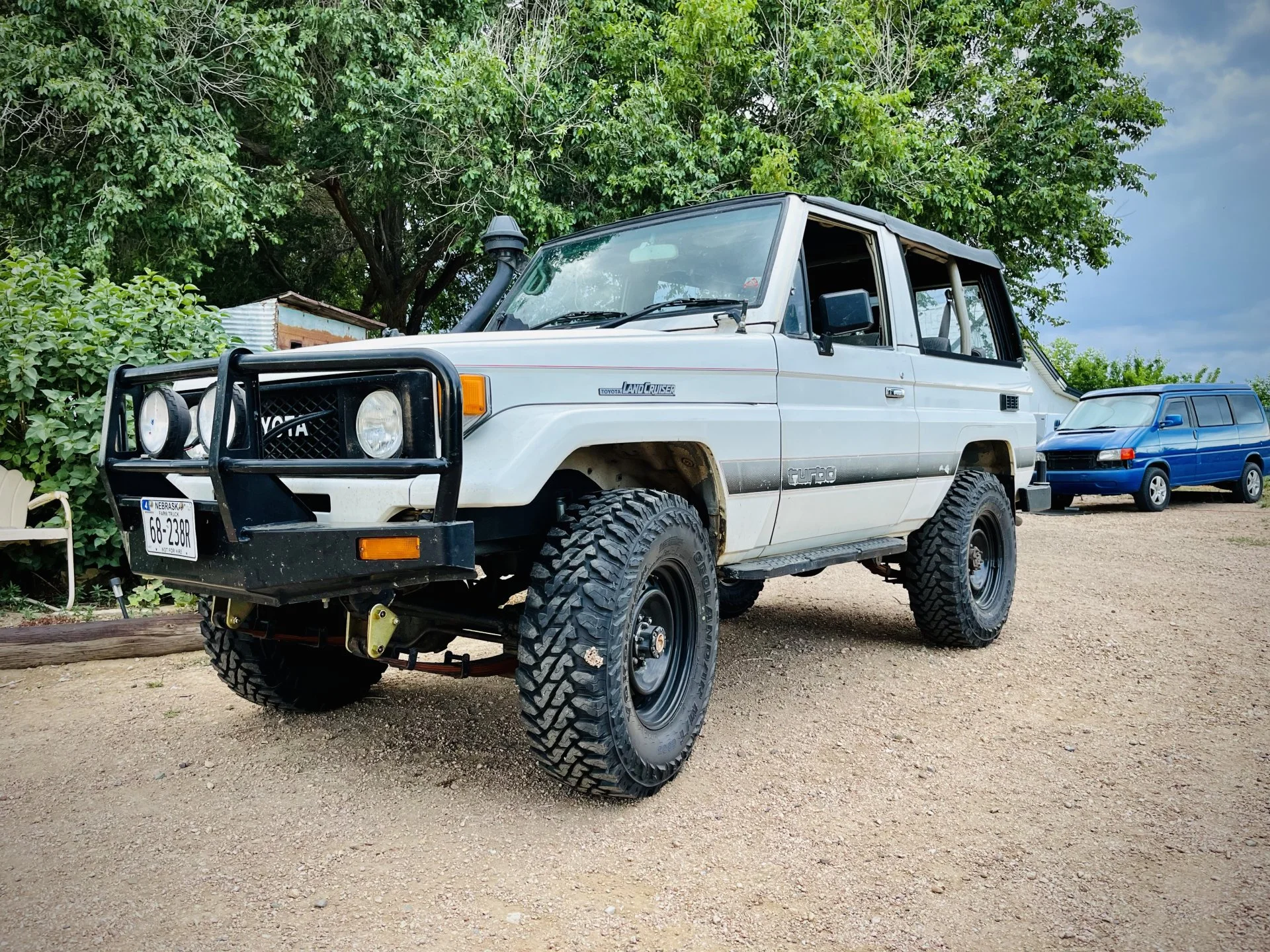

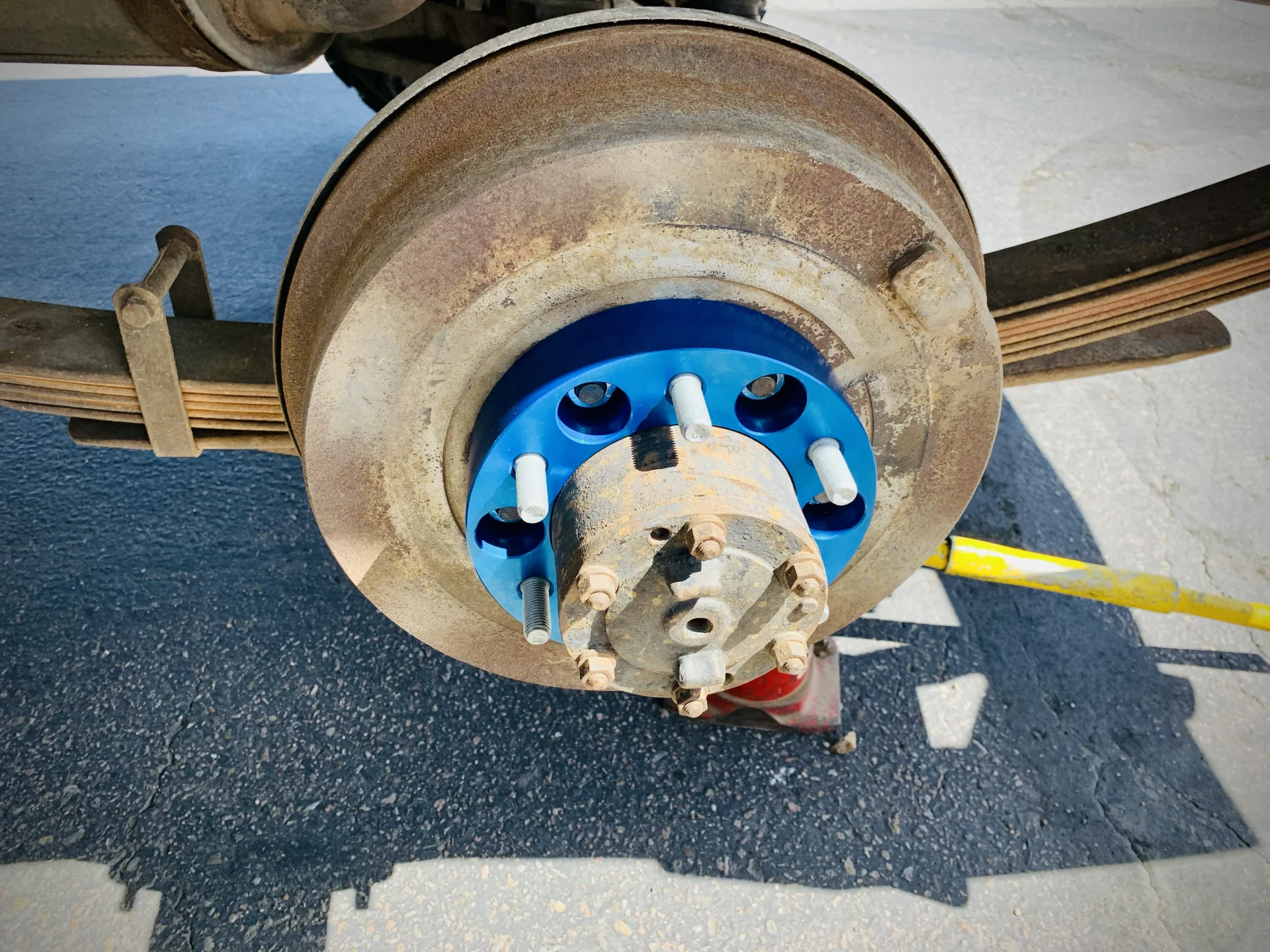

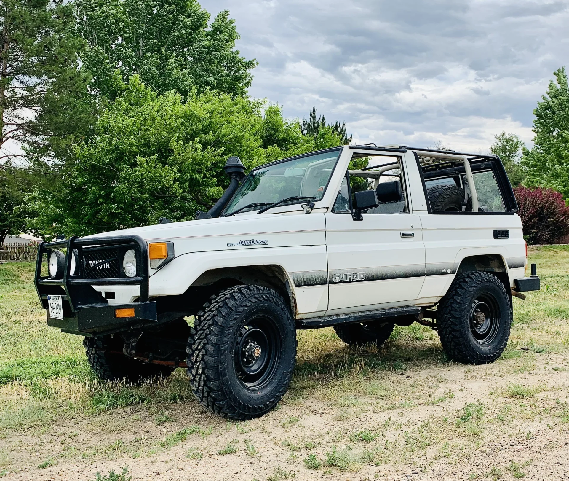

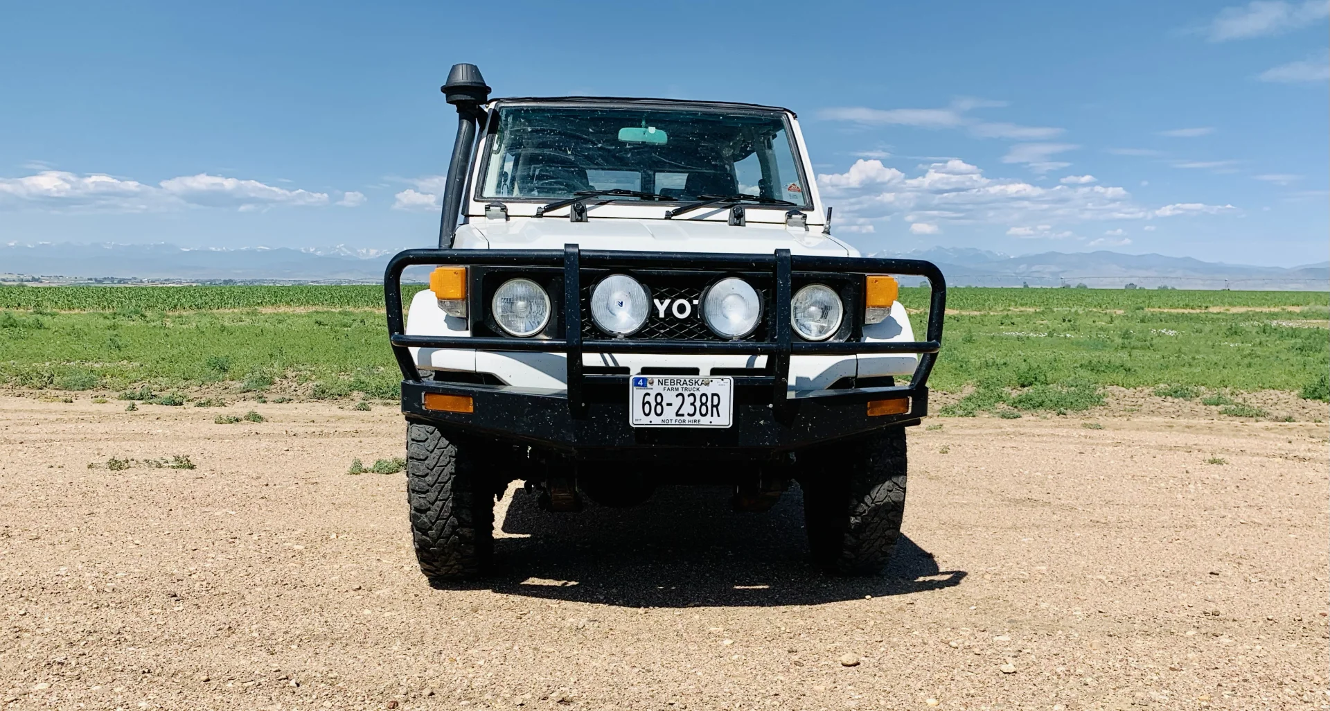

Just getting ready for the new rims/tires. Not my first choice and I didn't necessarily want spacers, but finding rims I like in correct backspacing that weren't $700 a rim.
Spidertrax
1.5" per side out
Could be placebo, but it felt less tippy going into dips/turns than before. In theory it should be more stable, but I wasn't sure how/if it would be noticeable.
Spidertrax
1.5" per side out
I went a little less spacing in the front, a little more in the back to even mine out, yet I definitely felt it less tipsy in the corners afterwards... so I don't think it was simply placebo that you were feeling. Looks good! :cheers:

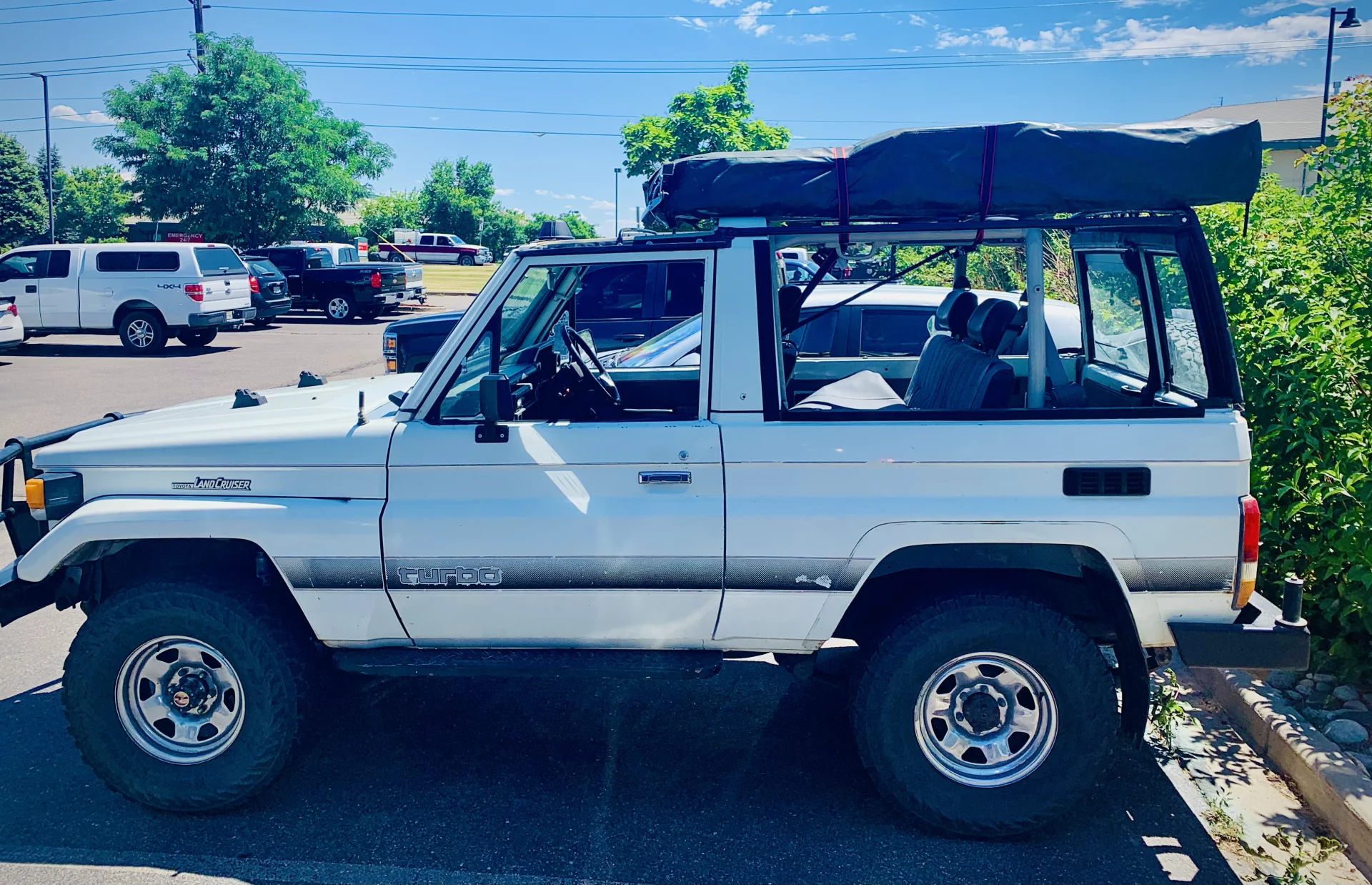

Because I don't have enough projects in life, I found this project on CL with a bargain price.
didn't have any roof rack so had to just take the soft top off and strap it on redneck style.

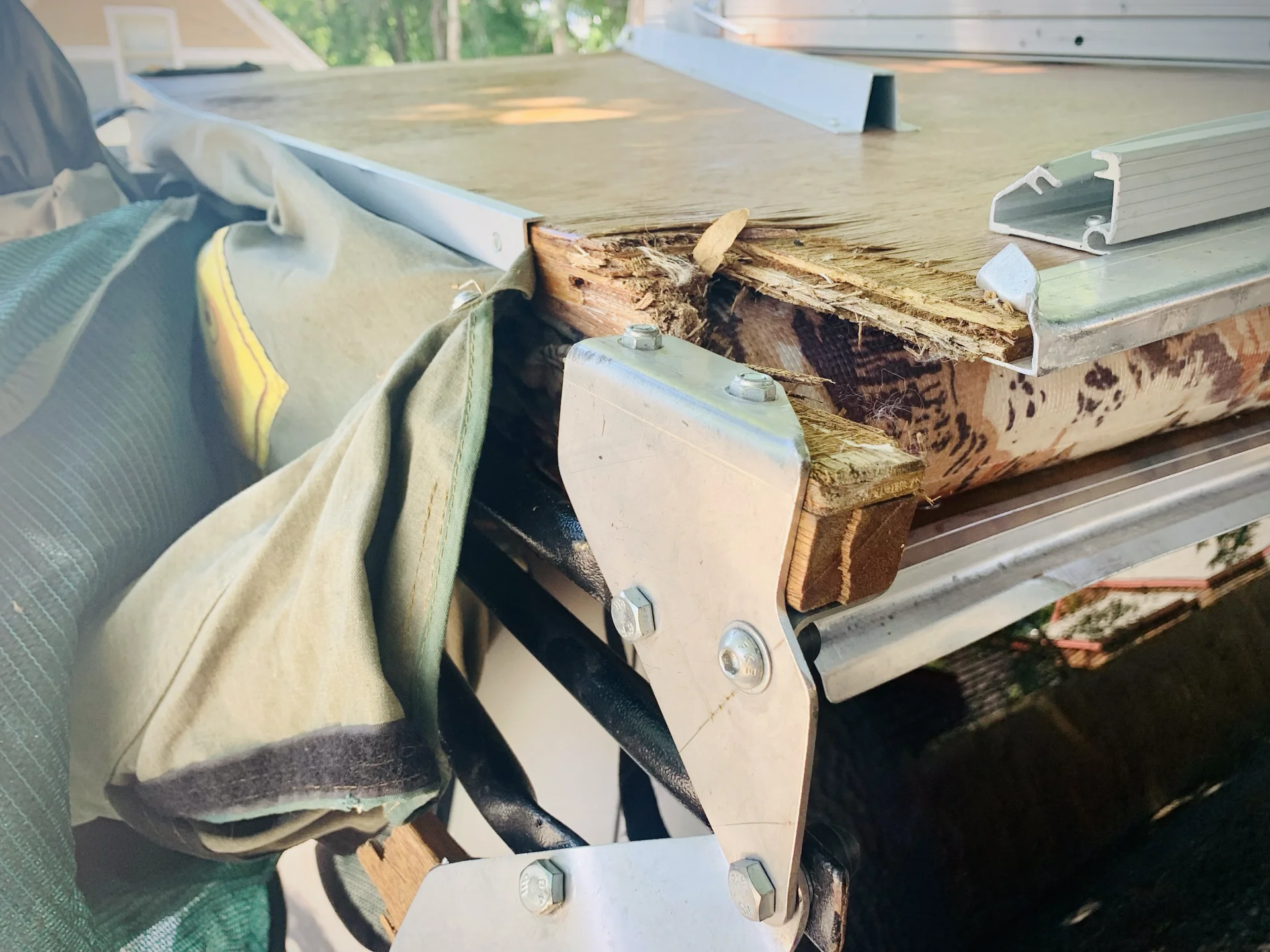

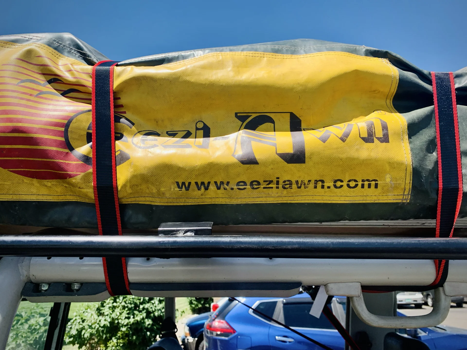

It's an EEZI-AWN Series III 1800T which is big. 172lbs :oops:
Why the stupid low price for a tent that looks barely used inside? Canvas looks new etc???
Well, someone in their Subaru/honda/micro-suv put it on their vehicle improperly and it fell off on a slow corner. o_O It was purchased at an auction, then another guy bought it to fix but has to move so he's selling it because he doesn't have time/money.
So for basically the price of a new EEZI-AWN ladder, I have a project tent.
He said he contacted EEZI-AWN and they said replacement parts would be $300ish but the time frame would be 6 months or more. There are a couple of options, but I think the best one would be to just replace both pieces of plywood and bend that bracket back straight.
there are a few pieces of aluminum that need straightened back into place, but other than that I should have a solid RTT on the cheap. That or fix/flip it for something smaller.

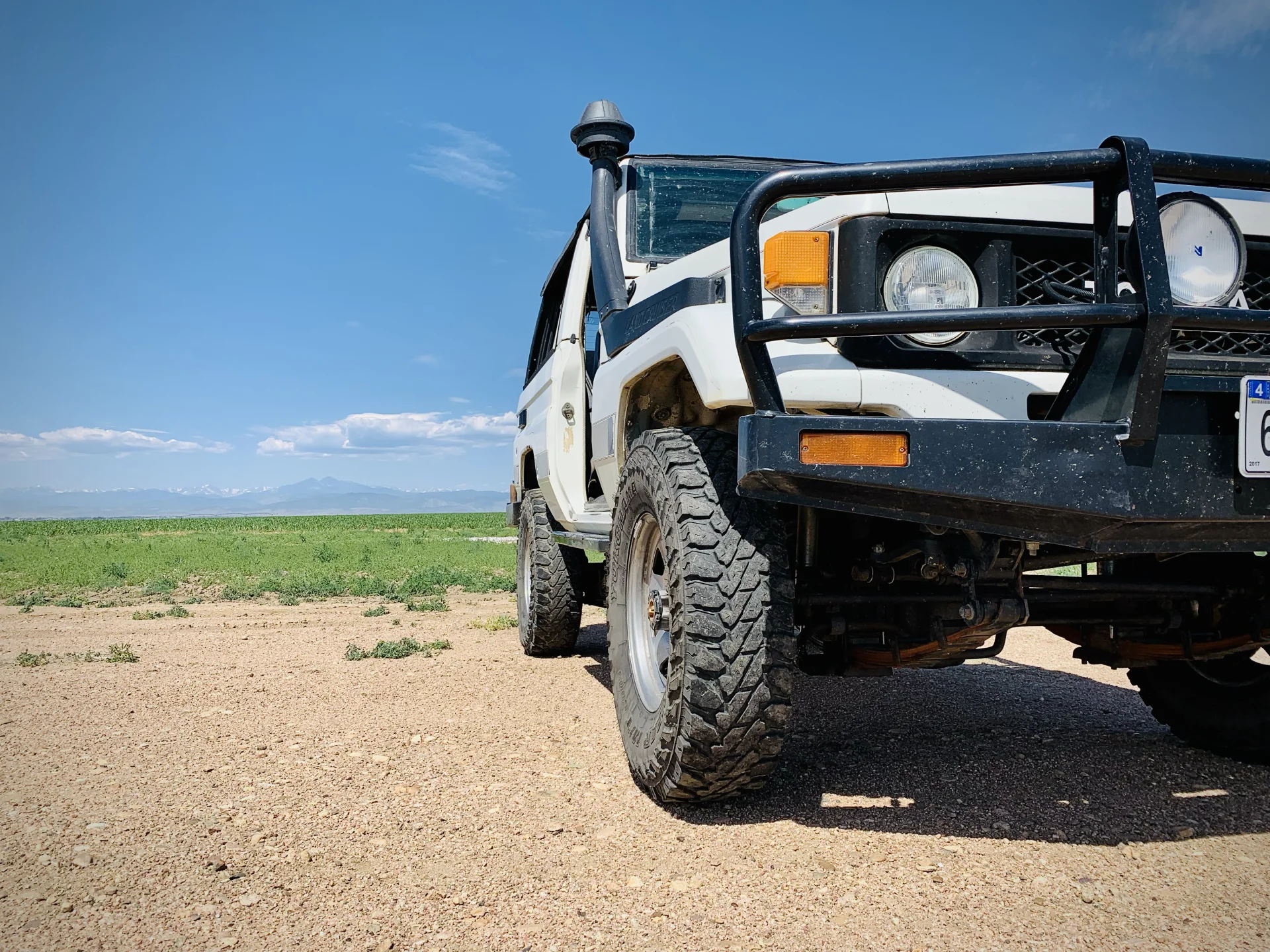

Then tires came in and it was time to replace them. I could have got another 5K-10K miles, which would have put me at 35k-40K miles, which is pretty good for dedicated mud tires, but I tend to like to replace before that. They would have been down to nothing at that point.
Yokohama 285/75r17 on FJ Cruiser/4 runner 17x7.5 rims with Spidertrax spacers
Man I forgot just how smooth and quiet new tires are. These are ion paper almost 1" taller and 1.25" wider. I'll have to get some actual measurements tonight.

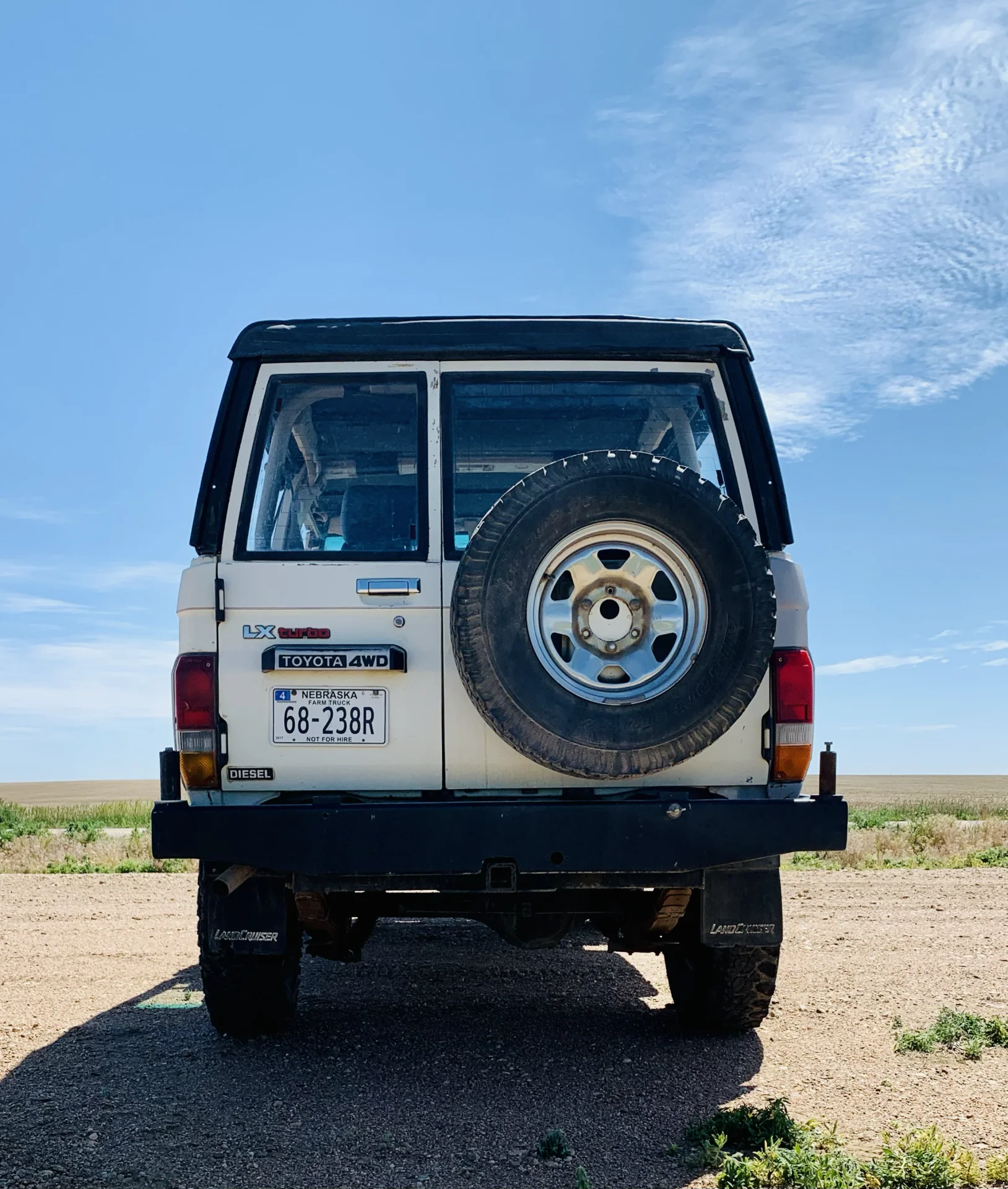

The black ties in pretty good overall. I will see how it looks with the top on.
Looks pretty good with the safari top.
Here's some size comparison. The fronts are at 29psi from the tire shop, I usually run higher so I need to check that.
The ground isn't level at all, different wear points and only one is weight mounted lol. So not a great comparison, but you get the idea.
285/75r17 G003 vs 255/85r16 G003 vs 235/85r16 BFG

These are new takeoffs from a 4Runner. 17x7.5 4.5” backspacing. You would need to run 1” spacers at least. I’m running 1.5” spider trax.
@FJ73Texas has the part number for the same overseas 17” with 3.5” backspace, but finding them was harder, and shipping was $$$.

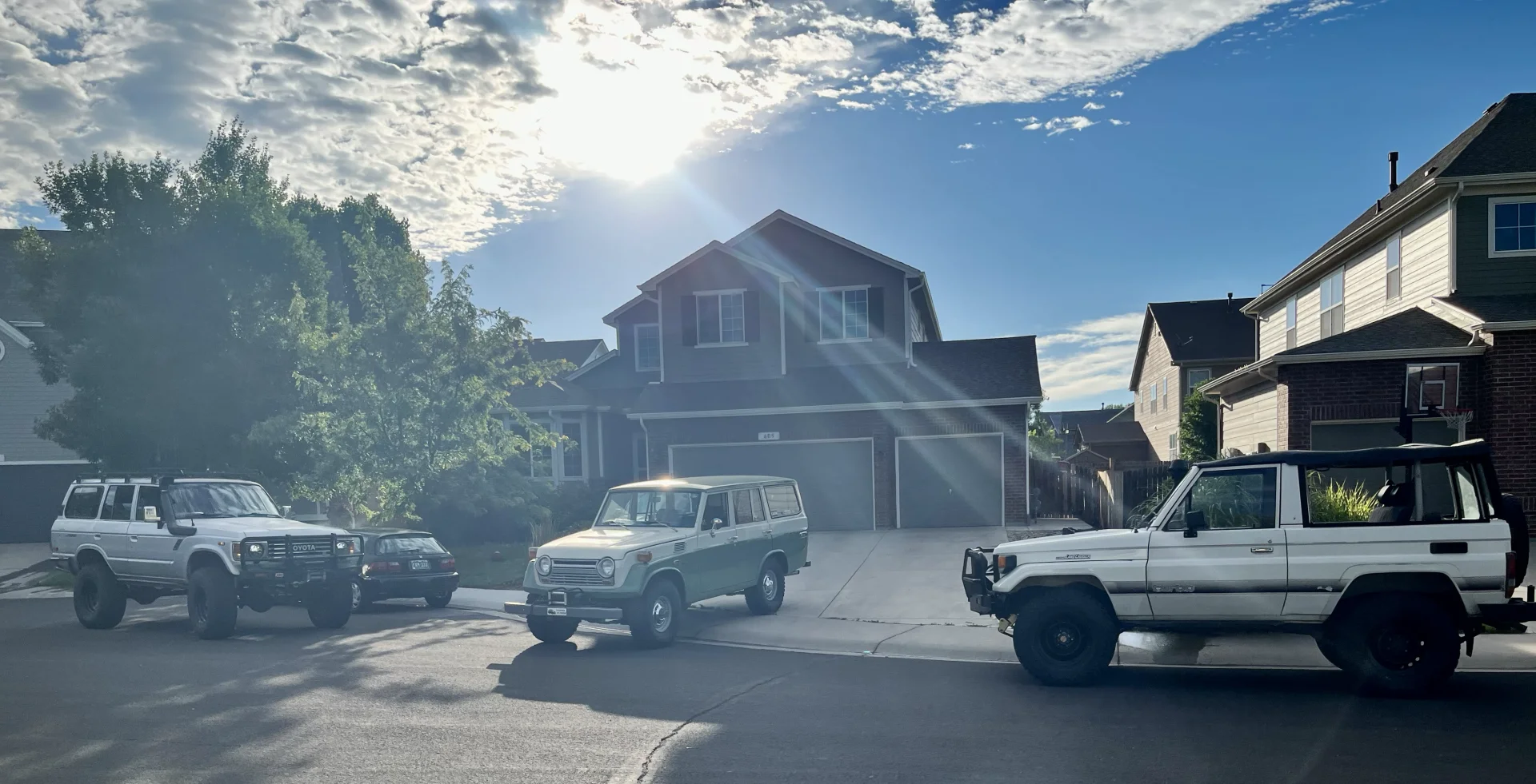

@PabloCruise @Laughingjackal and I did a small shakedown trip in the cruisers.
Apparently the cruiser gods are biased.
The Pig is cherry, plus it is running a 3FE/4spd combo. She scoots along quite well.
The 60 series has an Isuzu 4BD1T, intercooler SOA on 37's. a beast.
And of course, my BJ74 with a 13BT and holset. Hard to believe my 88 was the newest of the group.

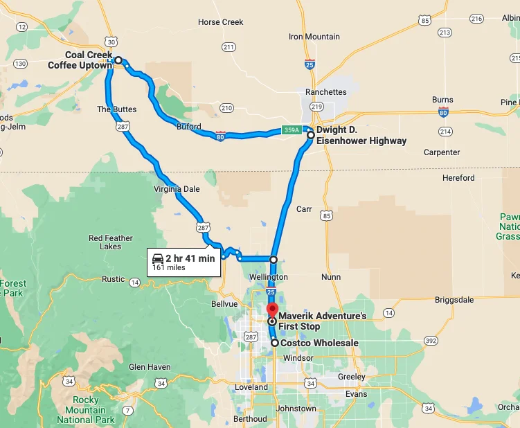

This was the route. Just a quick drive to pull some hills and see how the 60 series would do as they are taking it to Black Hills Cruiser classic.
Altitude ranges from 4800 to start up to 8600 at the highest.
