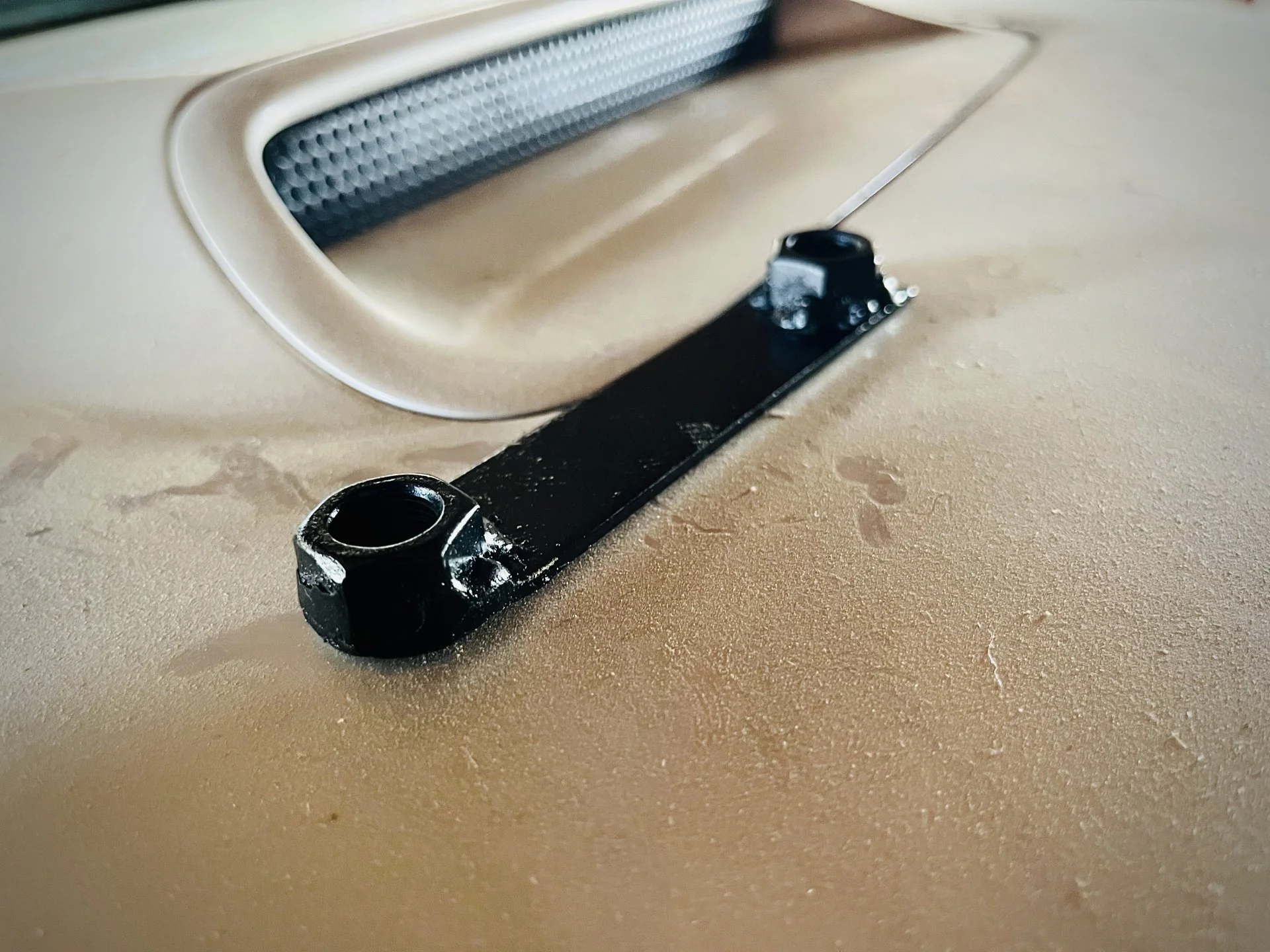

The bracket I made to hold the nuts on the bracket to tighten the steering rack.
