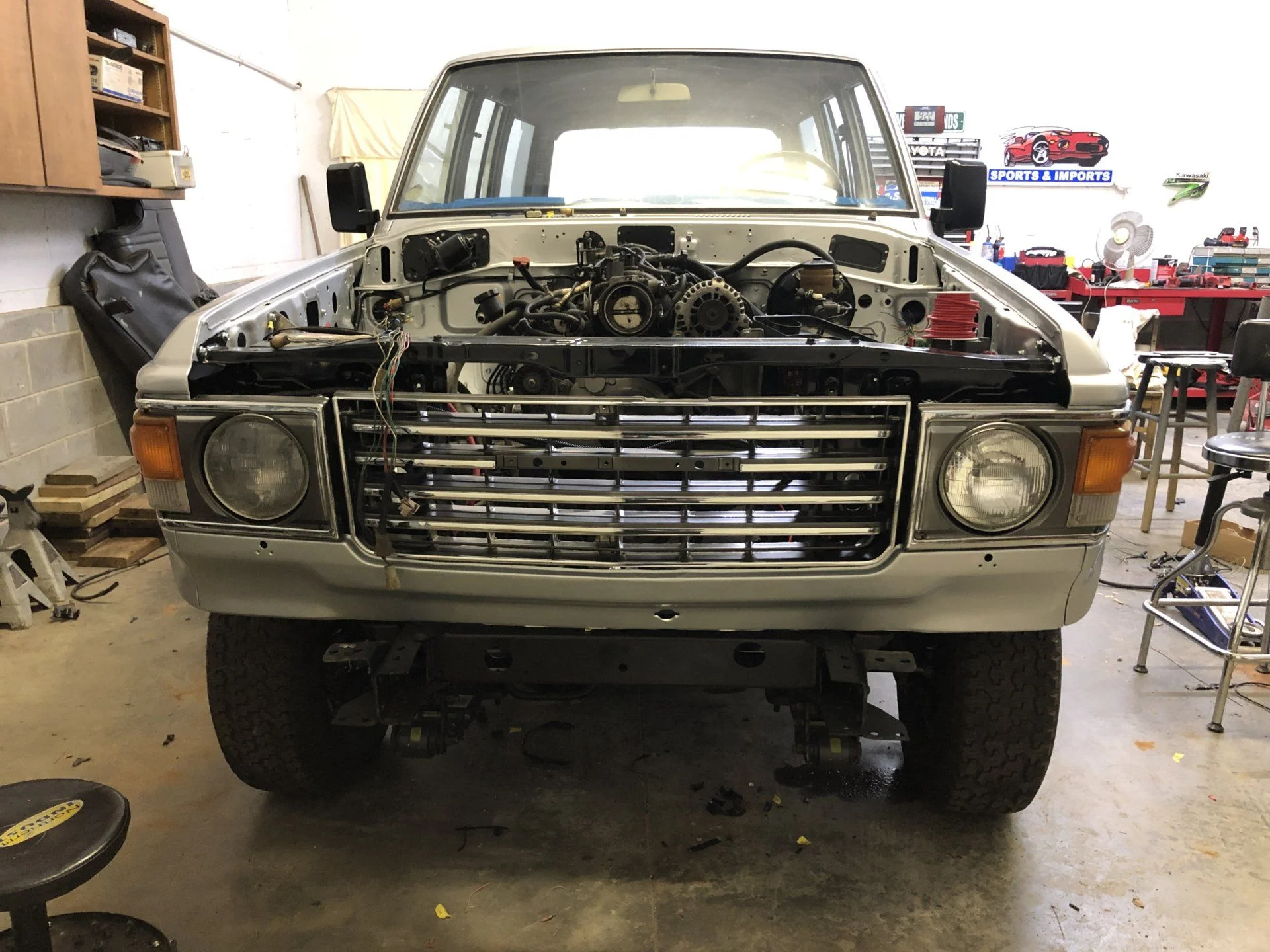

So a small update: I’m 90% done re-wiring the lights and such. Engine turns over but won’t run because I still need to remove VATS from the pcm which I’ll hopefully have a friend do within the week.

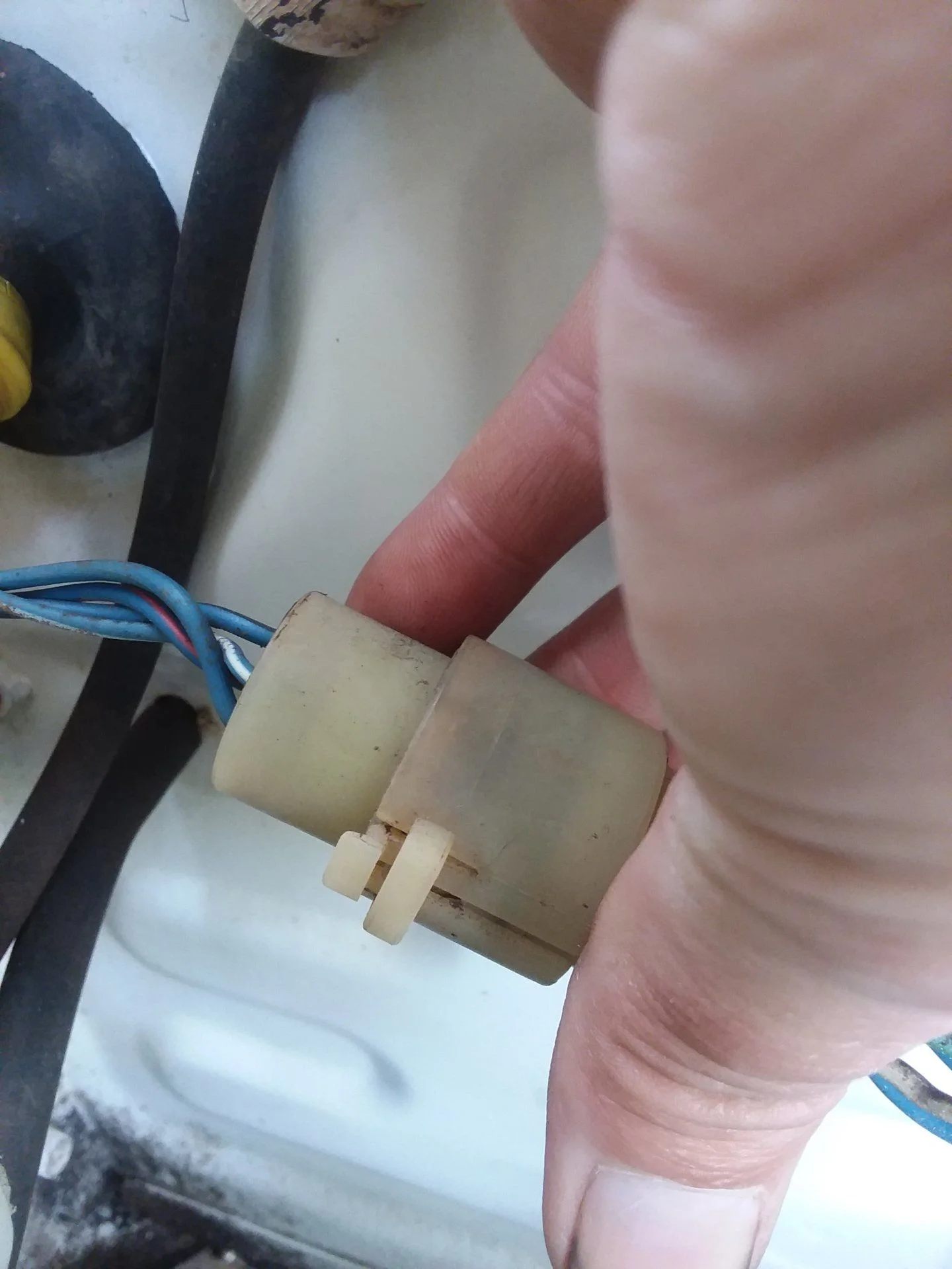

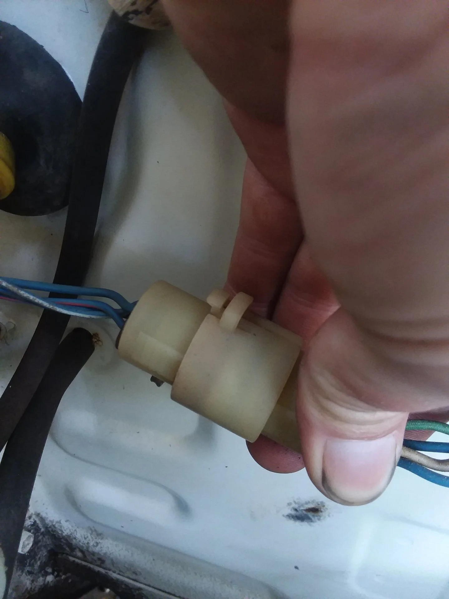

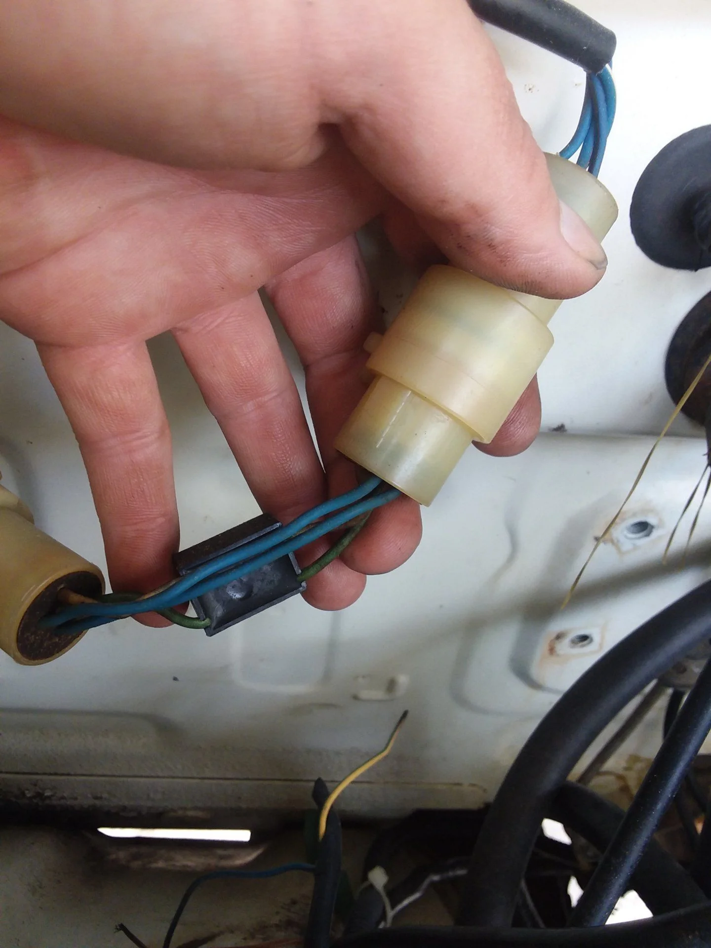

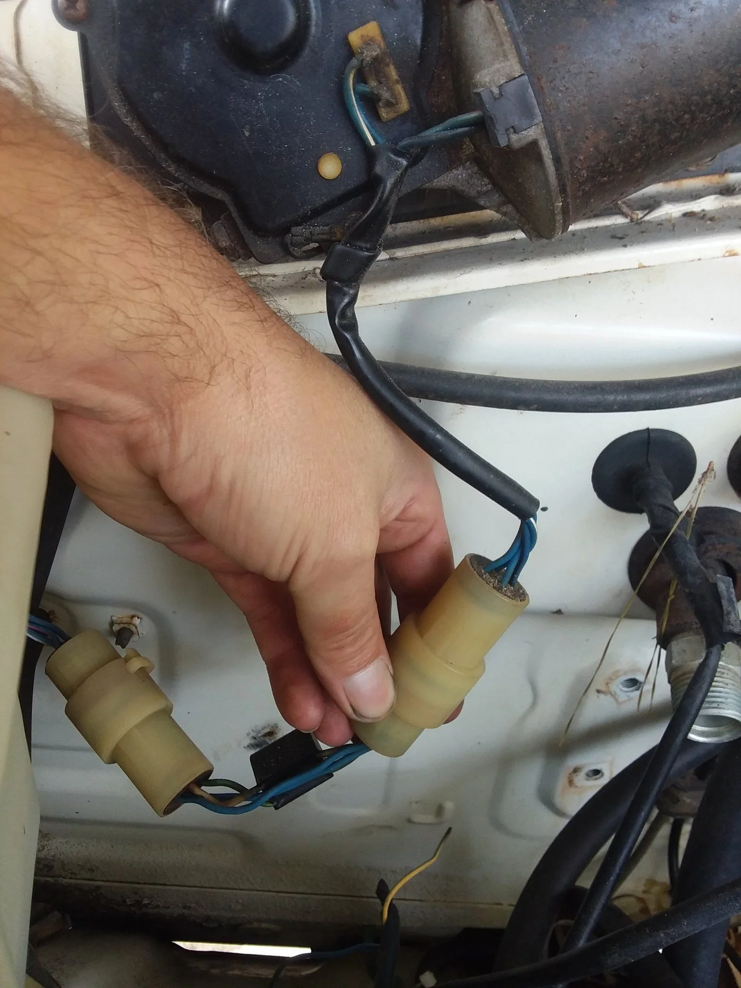

Does anyone have a photo of the wiring for the wiper motor? Iirc the loom came from the passenger side but I can’t get it to work. Perhaps my wiper motor is toast? Dunno. Also sorta put together the front end.

Did you have any clearance issues with the oil pan and front driveshaft? .

You can’t use the truck pan, but it’ll clear with a muscle car pan or even the camaro pan. The transmission pan is the actual obstacle. It needs to be clearanced and even then it’s a rather tight tolerance.
Can you post more pics of engine bay top and below when you get time? Id like to see pics of your oil and transmission pans..
