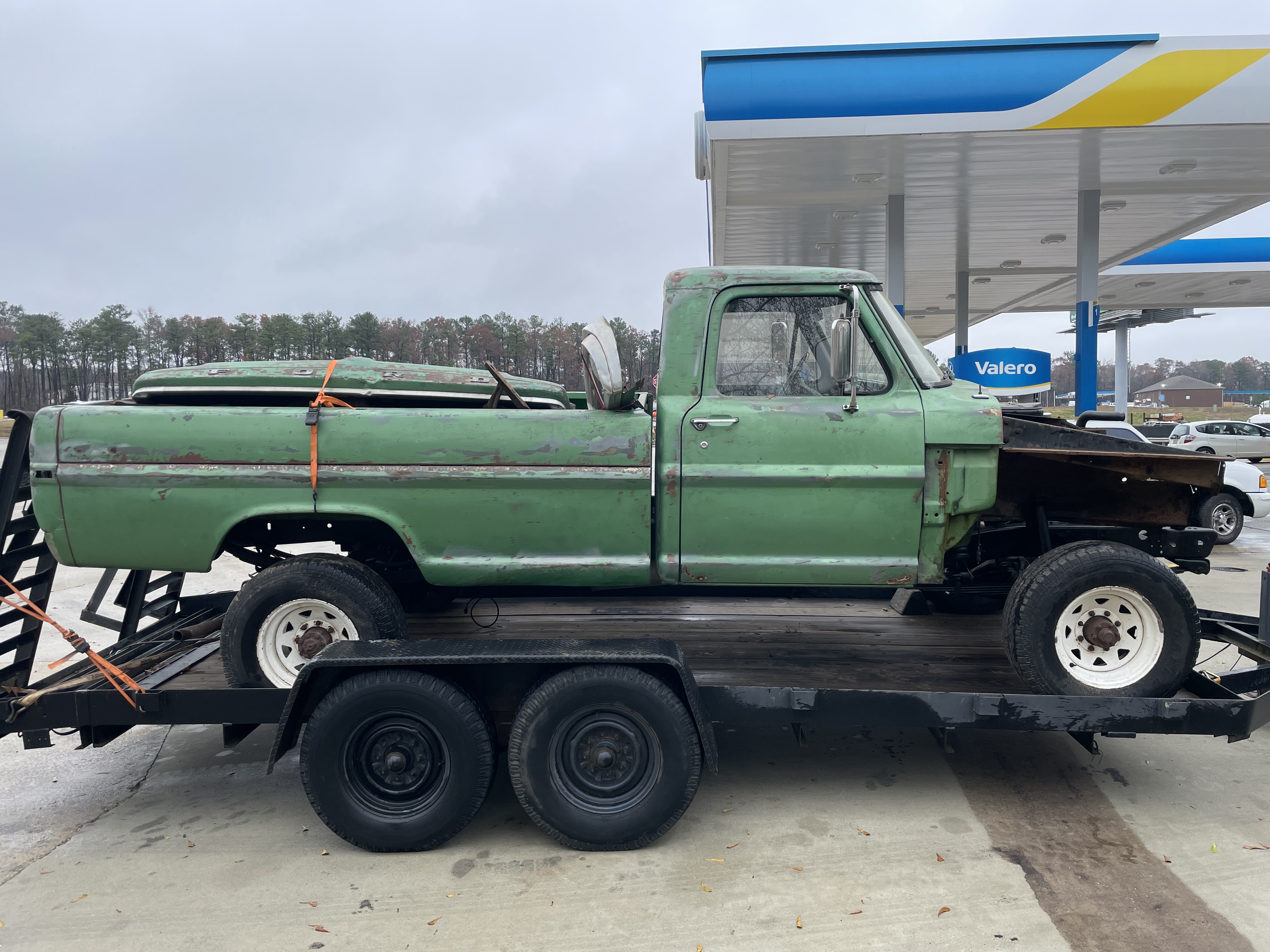

The other cool thing about buying a new frame is that it's not rusty, has very good axles front and rear (rear has a factory locker, who knew?) and a 7.3 gasoline engine *should* bolt right in with very few modifications. So I bought one. I also bought a 6r80. You'd think this is rich man's territory now but I found a basically new take-out engine that fell off of a forklift for a mega deal. Busted a valve cover, smashed a coil pack, and broke the throttle body but all of these were easily fixed.
full

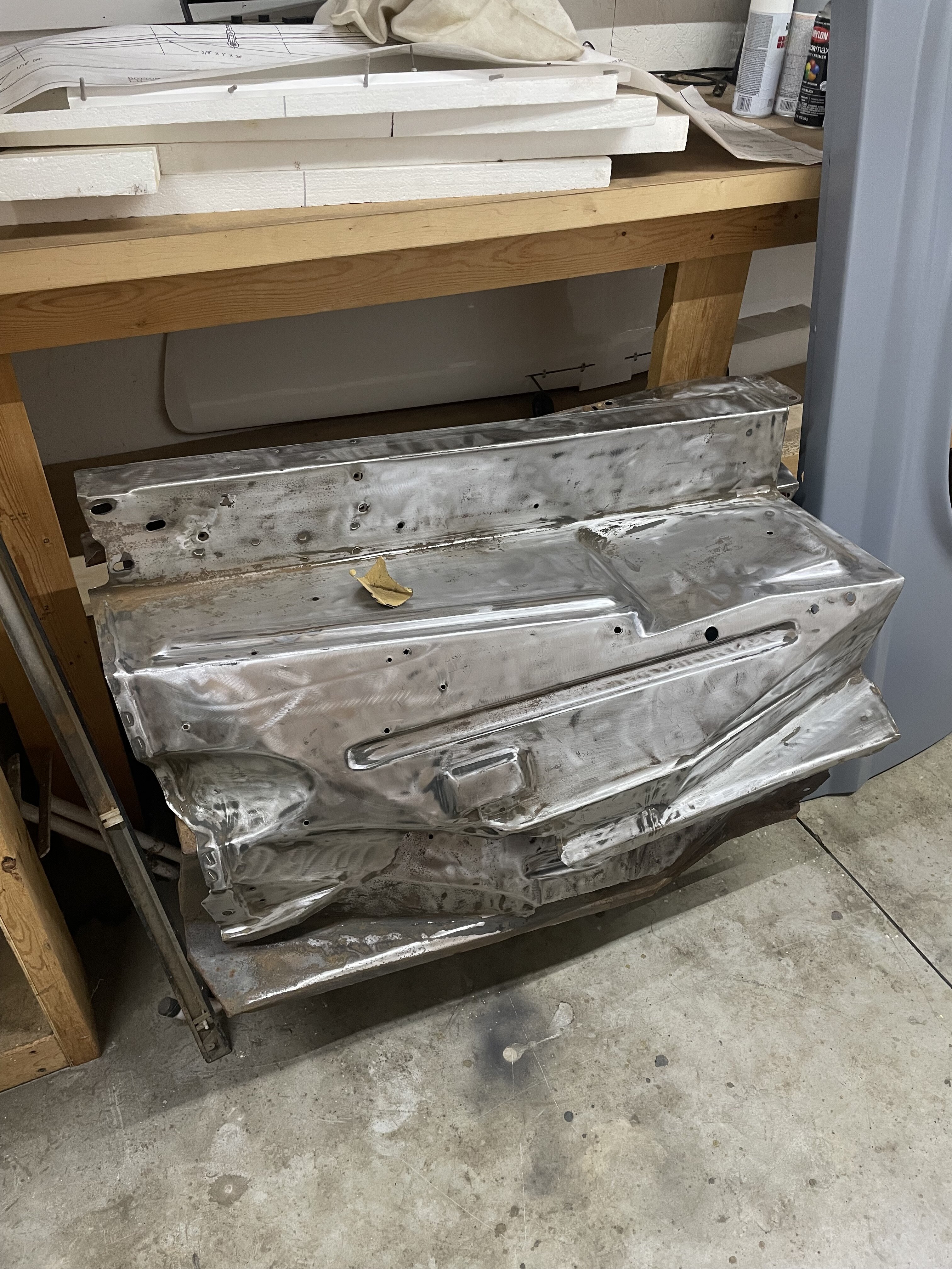

This has been kind of a longer term project considering I live in an apartment and my projects all happen on weekends at the family shop. Since I was already doing some fairly in-depth rust repair, something possessed me early on in the build to take every panel down to bare metal. This isn't going to be a perfect truck by any stretch but I would like to put my best foot forward. I purchased a sand blasting attachment for a pressure washer (not a bad deal at $30) and a box full of strip discs and set to work.

I ended up having to blast the cab in several stages given the time frames I have available to work on things. The cab crossmember was also packed full of mud and needed the ends cut out and replaced.
full
full
full
full
full
It's no wonder bumpsides are so hard to find rust-free. Not an ounce of seam sealer un the underside and would have originally been coated in red oxide primer. That's it! My plan is obviously to seal it all up with epoxy and then I think I will use a color-matched bed liner to do the bottom side.

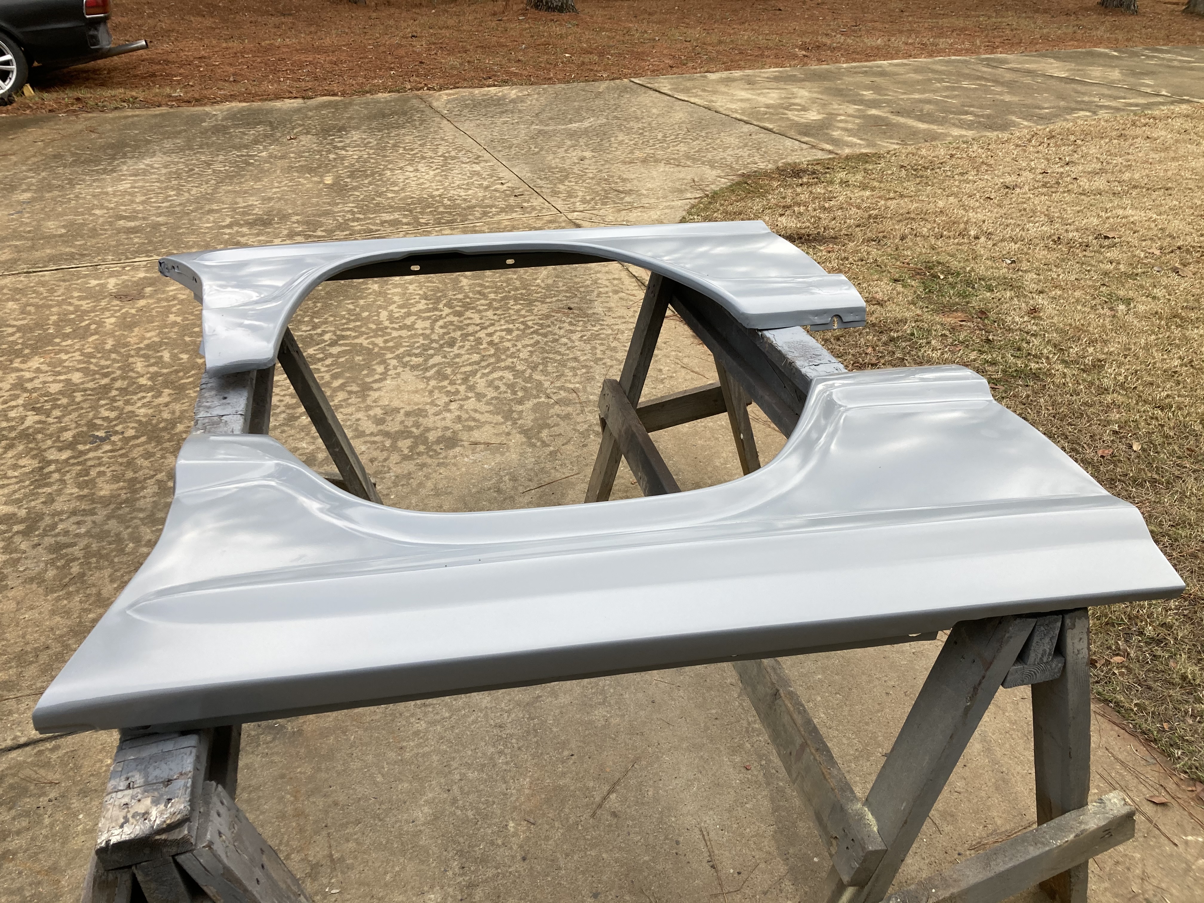

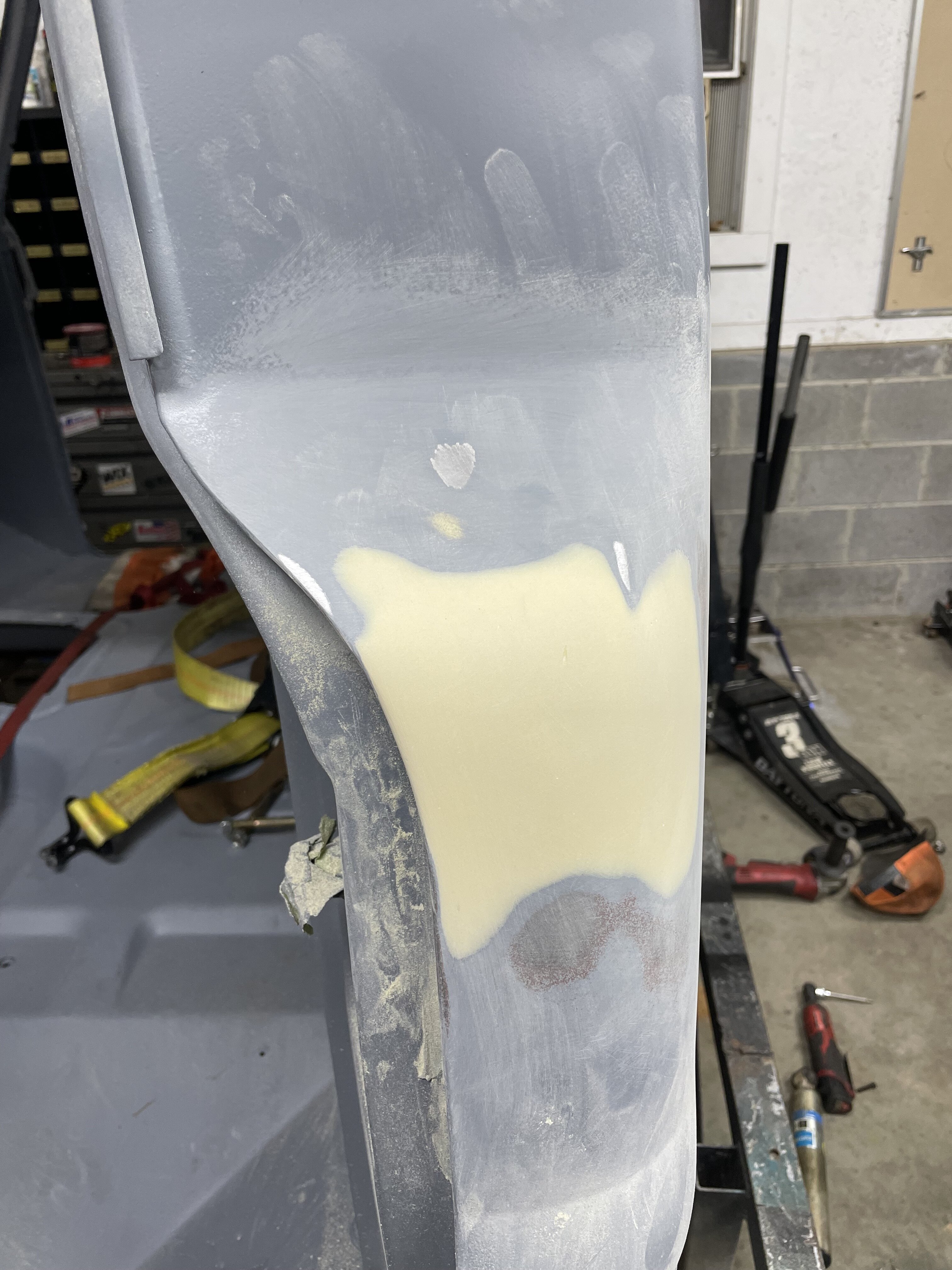

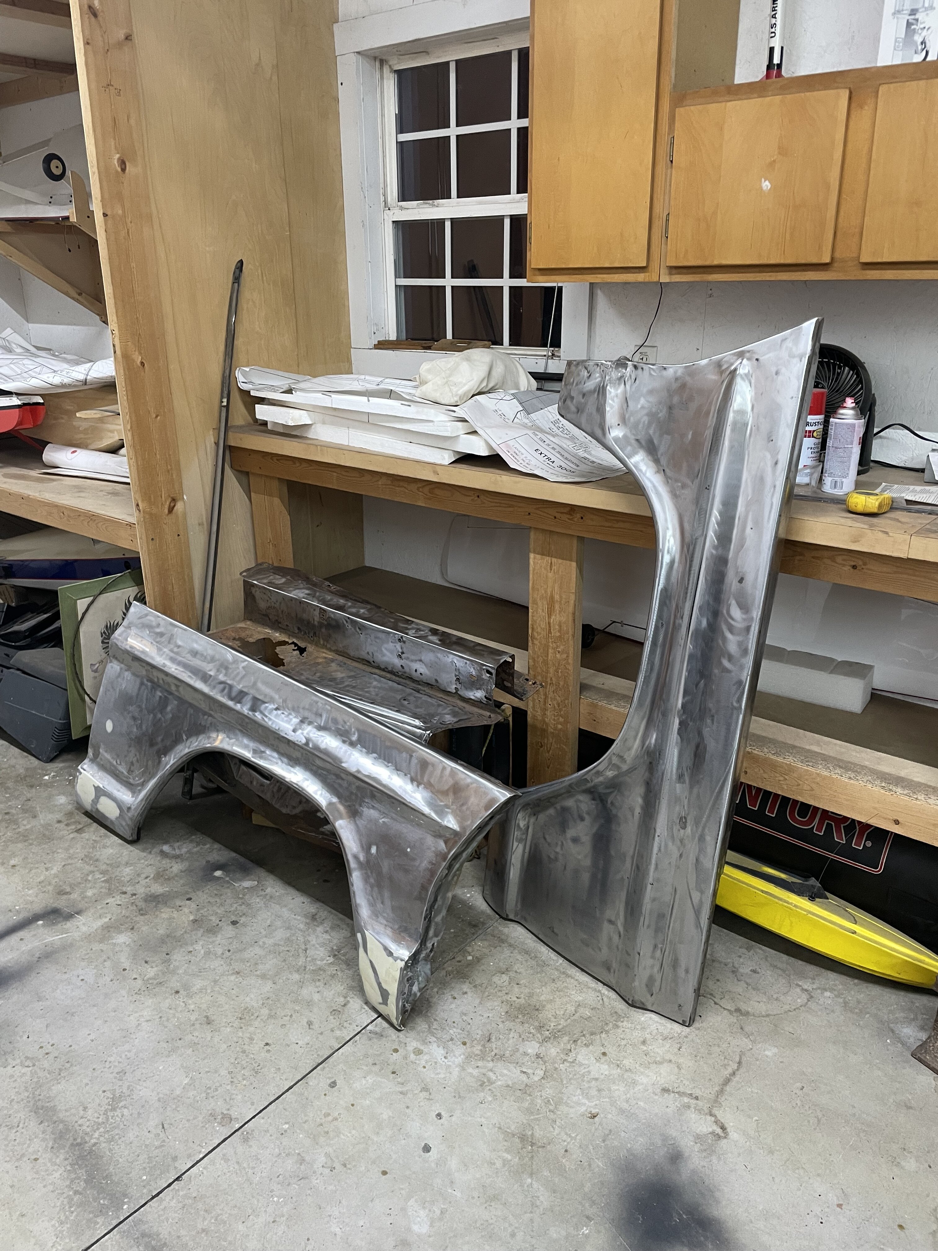

Lots of the stuff in this thread happened over a year ago but I'm trying to keep it chronological. Fenders had some rust in the lower portions to cut out and patch as well as a couple of dings to hammer out. They were taken down to bare metal as well as the inner fender for the driver side. The passenger side inner fender was beyond saving thanks to what I presume was years of battery acid so I just bought a new one (fairly cheap and fits as well as any of the other panels).
full
full
If ya look closely you can see where the inner fender was patched but it's really hard to clock.
Hood was also pretty banged up and had rust forming along the bottom edge which was cut out and replaced with new metal. This hood is almost a two-man job to move around.

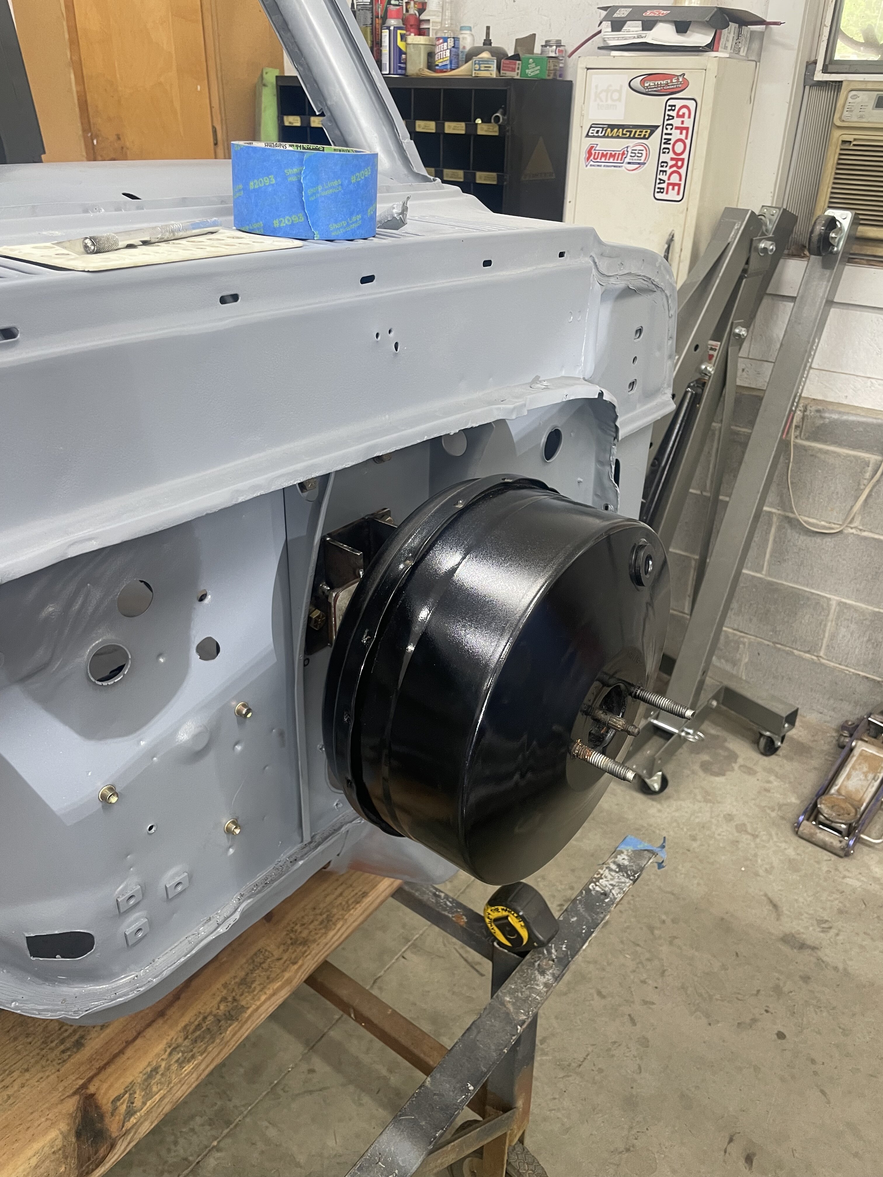

This truck had manual brakes from the factory. There is a kit out there that adapts to an 05-ish gasser vacuum booster that exists but is also mega overpriced. I built an adapter with some offcuts out of the scrap bin. Booster was like $40 from pull-a-part plus the rattle can rebuild. I will at least buy a new master cylinder.

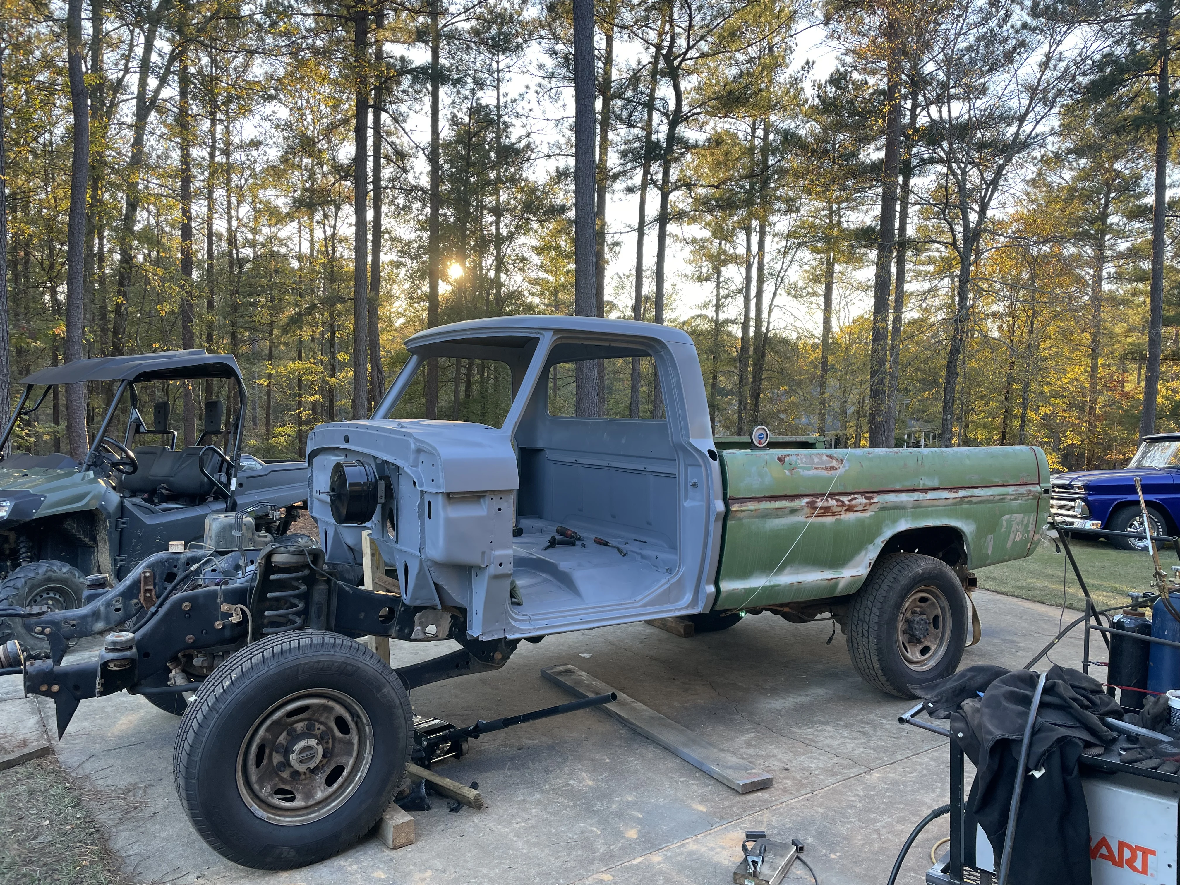

Body on the frame! I didn't show the process of putting the bed on the frame. Added some tabs to the frame rails to move the holes for the bed inward a bit as this frame is roughly 38" wide where the old Ford pickups are 34" at least for the 4x4s.
full
Ended up reusing the mount brackets and bushings I cut off of the frame as they were close to perfect dimensionally. Mocked up the rest of the front end:
full
full
Cab still needs adjusting as it is a little too close to the bed on the passenger side. There should be enough adjustment in the holes to get it looking right. I also need to cut the frame off right under the core support as the newer trucks have a much lower front bumper for crash safety and also aerodynamics? Don't need that where we're goin. Georgia is in false spring right now so it feels like it's warm enough to paint but who knows if it'll hold up until I have an opportunity.

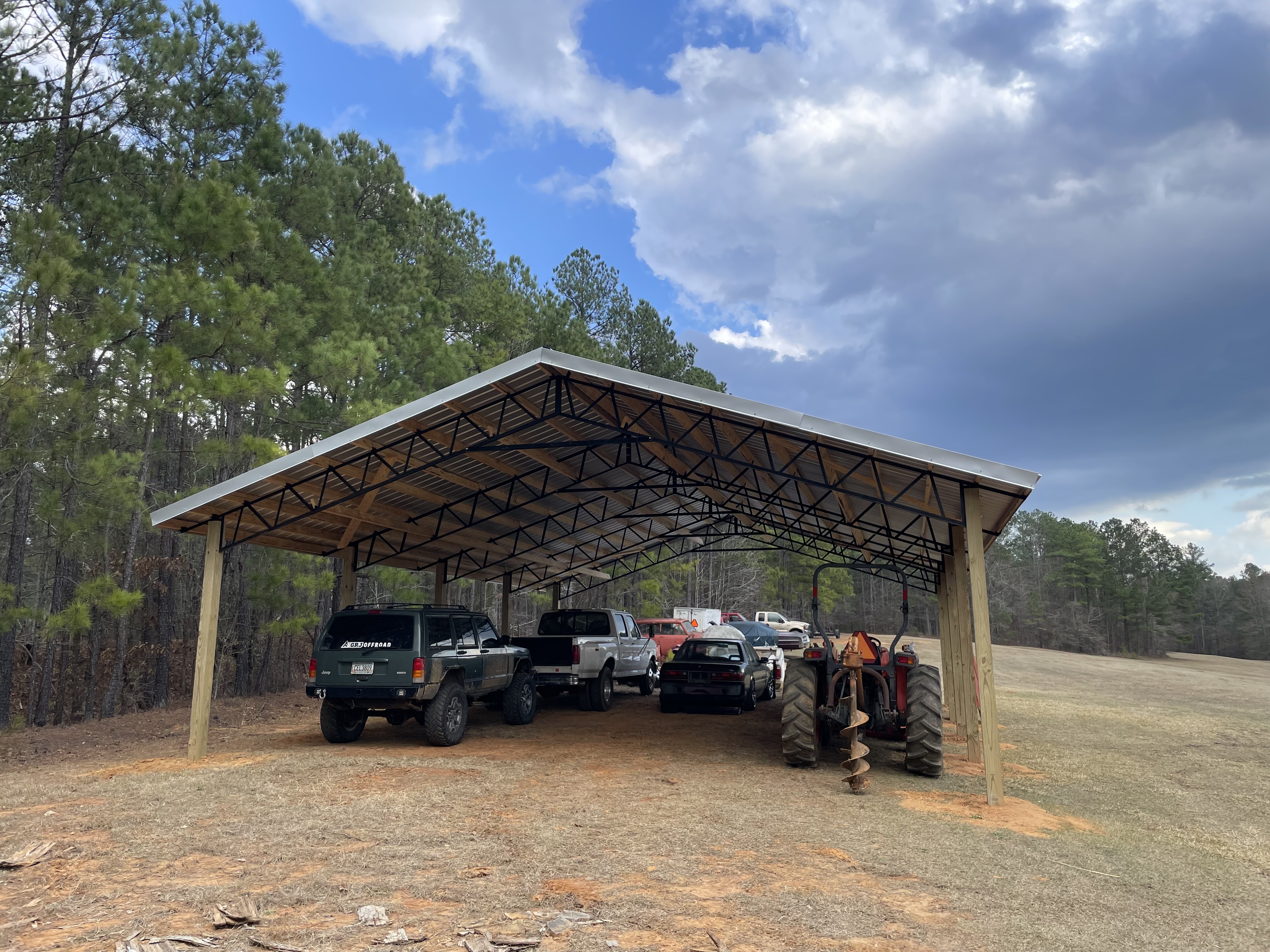

Not much progress this weekend because we were busy putting up this pole barn. My brother's OBS takes up almost a quarter of the available space under a 30x40' roof!

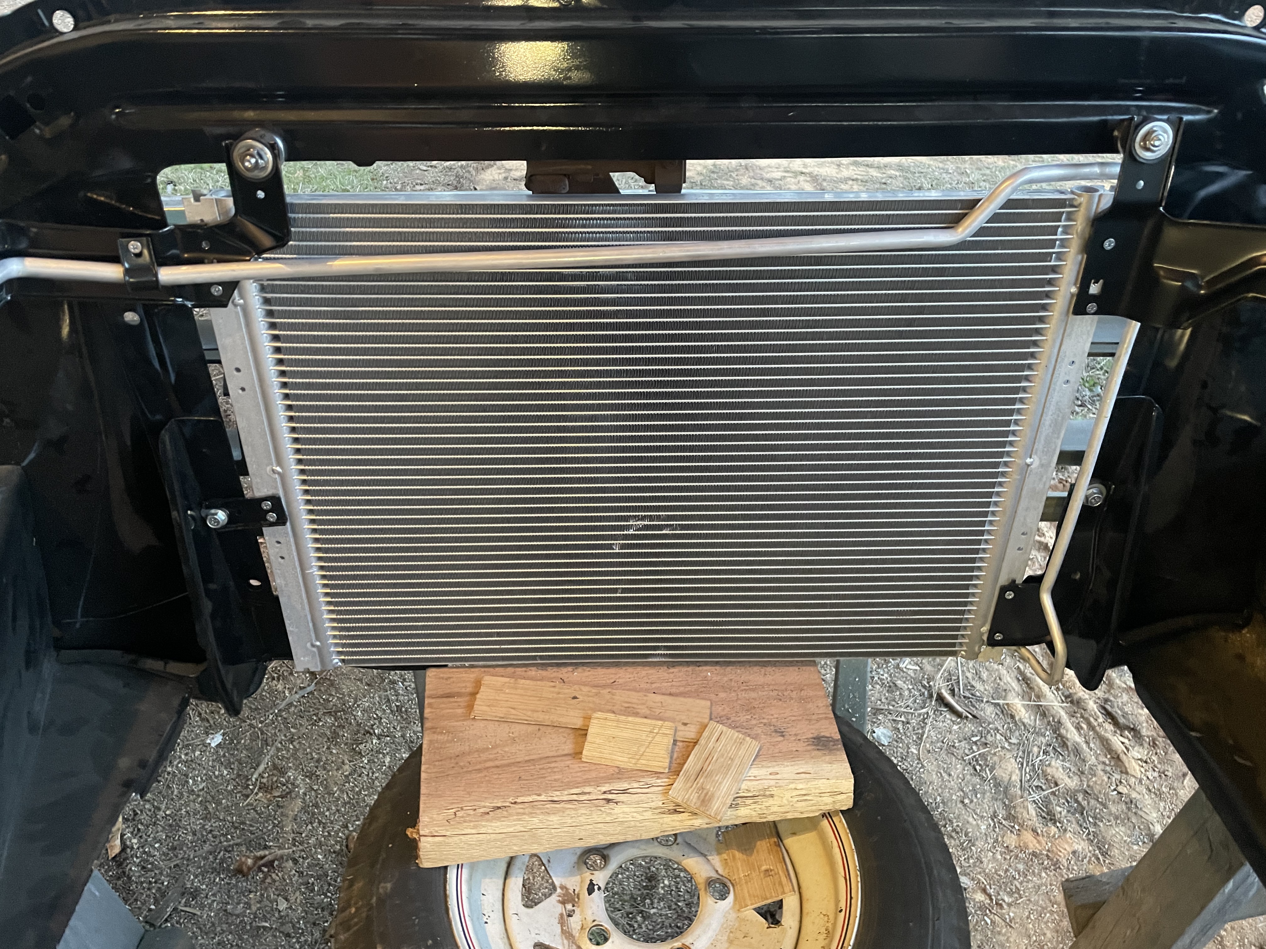

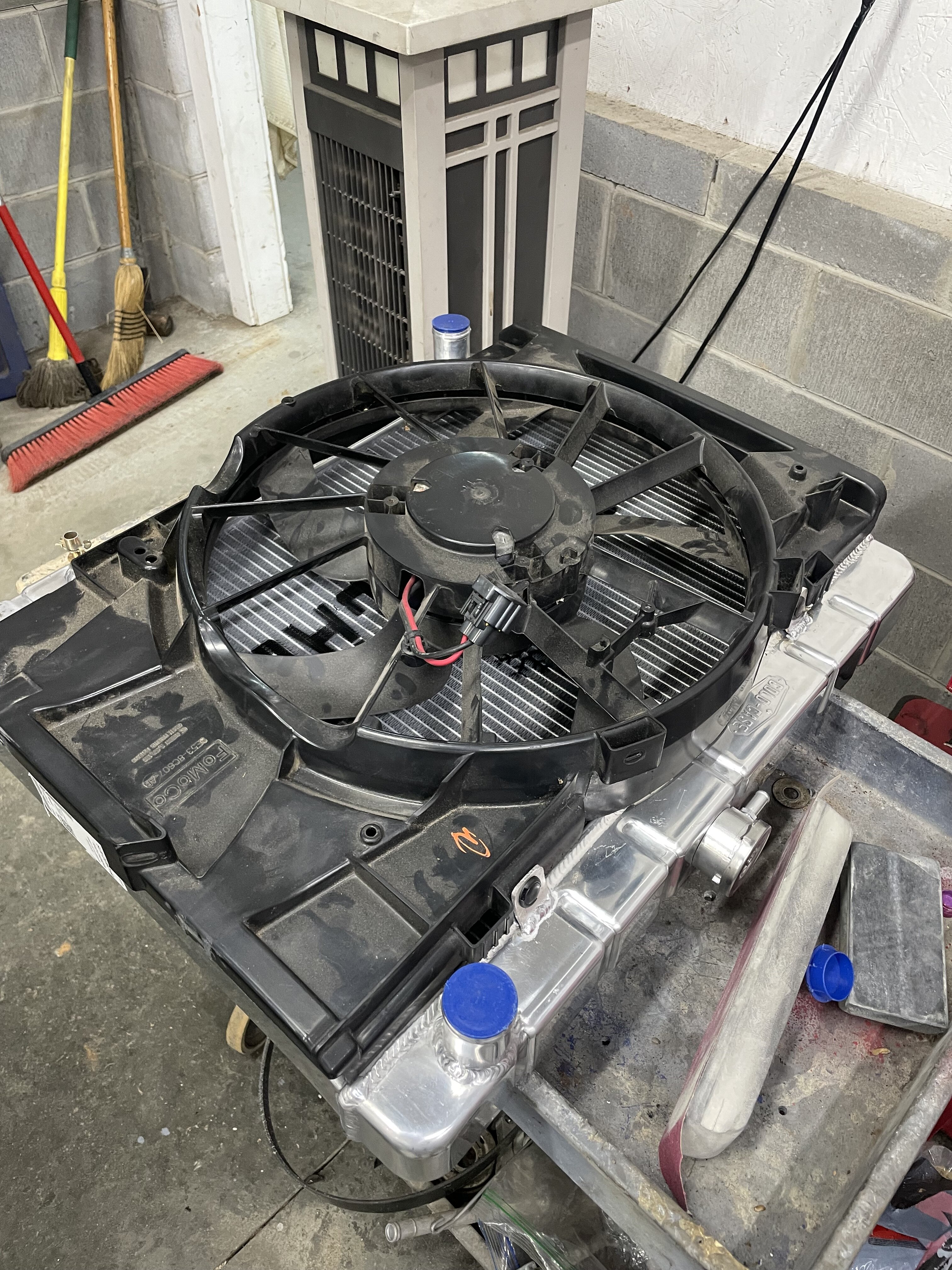

I did find this ColdCase radiator in the scratch n dent at Summit for very cheap and this Taurus fan I've been holding onto fits perfectly. Welded a couple of tabs and got it mounted. Also made brackets to mount the rad to the core support that still need to be welded to the rad (not pictured).

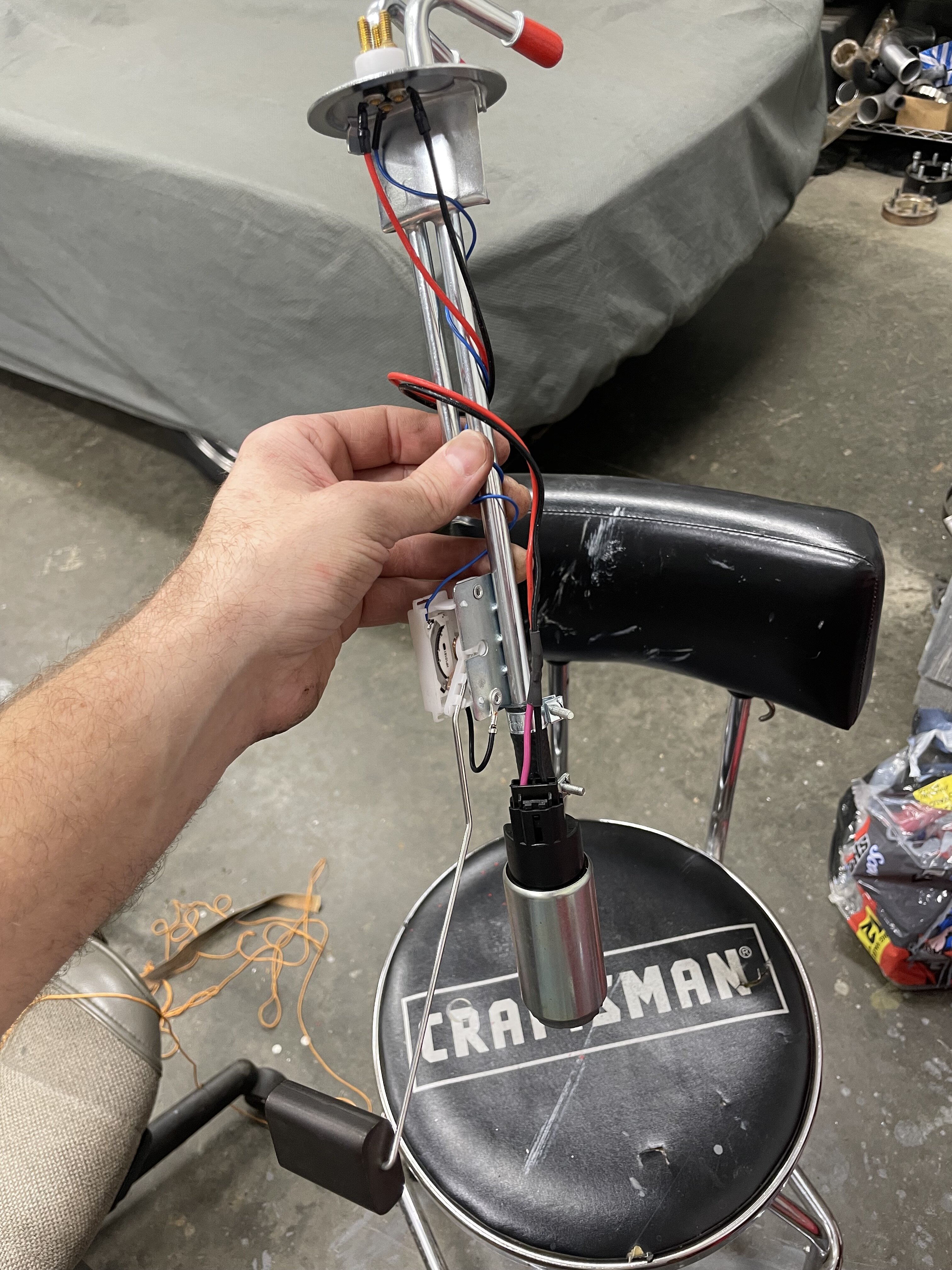

Also put together the fuel sender/pump but realized the tank I bought is the wrong one. Apparently bricknose Broncos have a large sender or a small sender and I didn't know any better. Pump is just your typical Walbro 255. Planning to pair with a C5 Corvette filter/regulator as the Godzilla needs 4 bar and is returnless, just like the LS1.
full
A 255 is about all I would dare run on this 14ga wire. Shouldn't be an issue though. Gonna be a couple of weeks before I'm back in the shop but maybe by then I'll be able to get some paint mixed and sprayed. The pole barn was really holding me up since we are completely out of shop space at the moment.

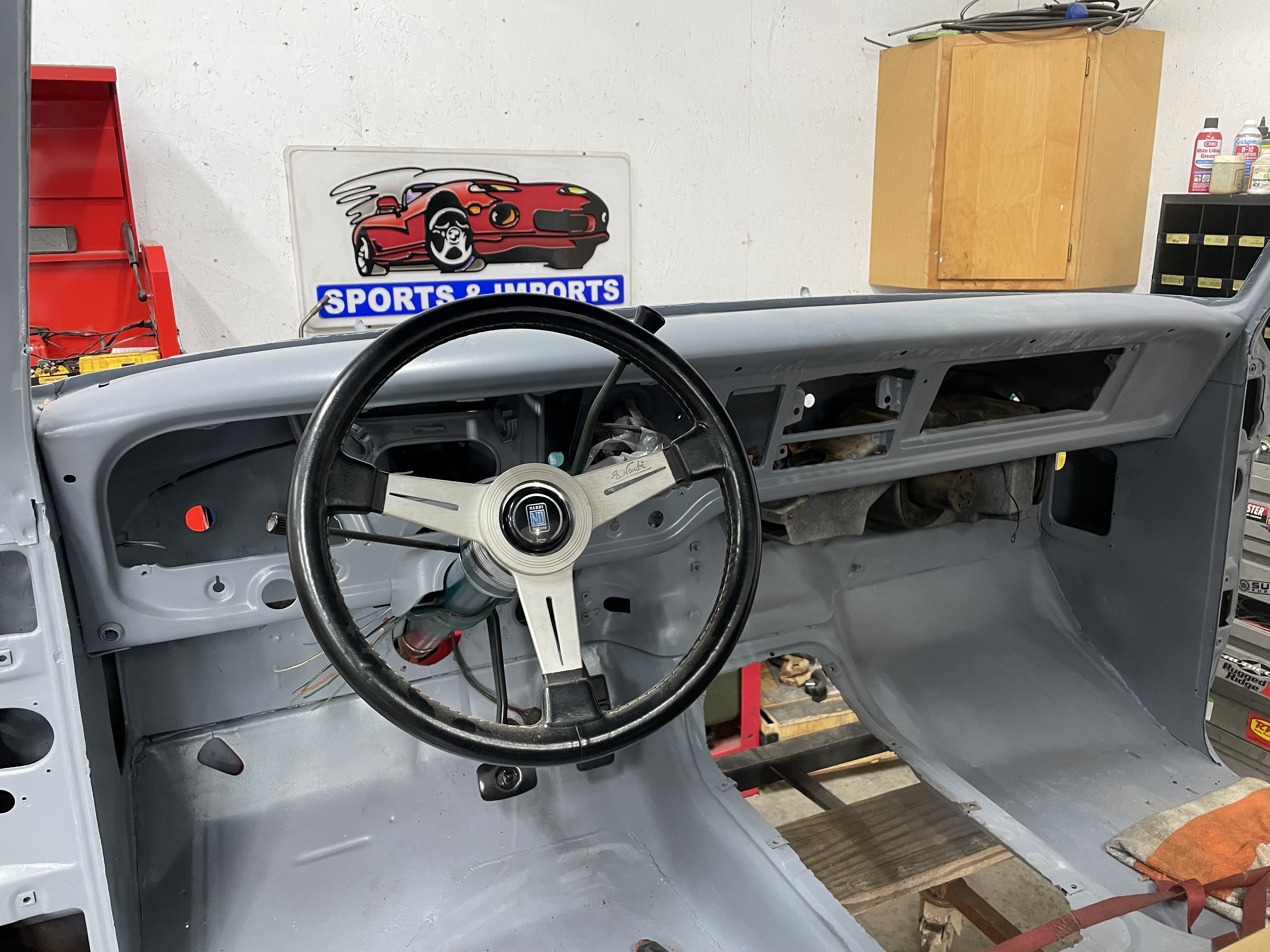

Very precise jig to hold everything level as I have been relegated to work in the outdoors. I also rebuilt and installed a steering column sans paint - still not sure on interior color, someone tell me what color to do. Test fit heater box too. I have a dealer add-on AC unit that isn't going to fit with this heater box but I have some questions out to friends more familiar with the platform. Mainly trying to avoid spending the money on a Vintage-Air system.
full
Also might be the only bumpside F250 with a Nardi classic around lol.

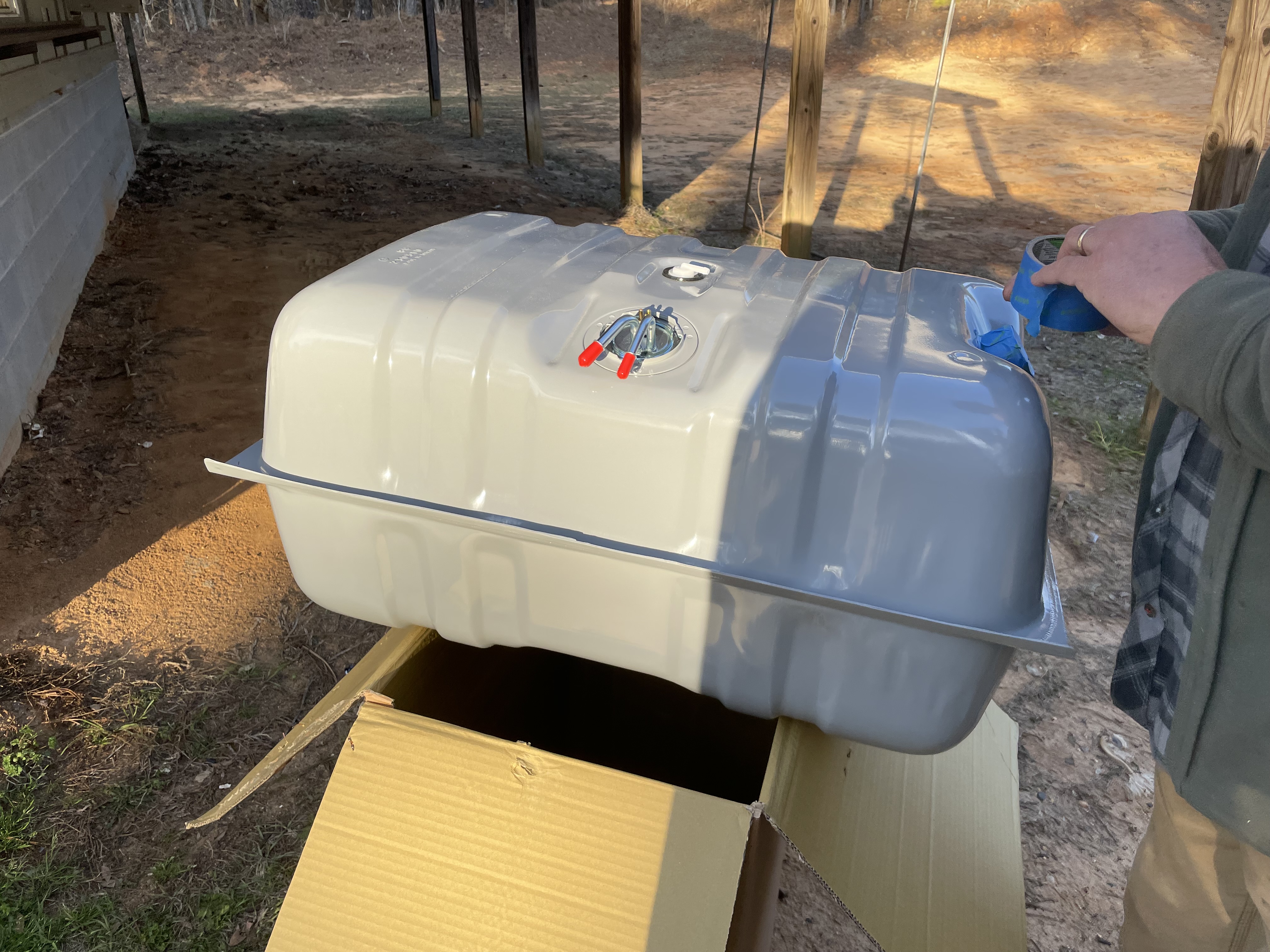

Also bought the correct fuel tank for the sender I have. This one even came painted instead of covered in grease. The newer frame I'm using has a super beefy crossmember in the rear that's meant to hold the spare tire in place under the bed. I'm going to have to take the bed off and remove the existing crossmember to mount this gigantic tank. Have a feeling the 7.3 will need all it can get though.

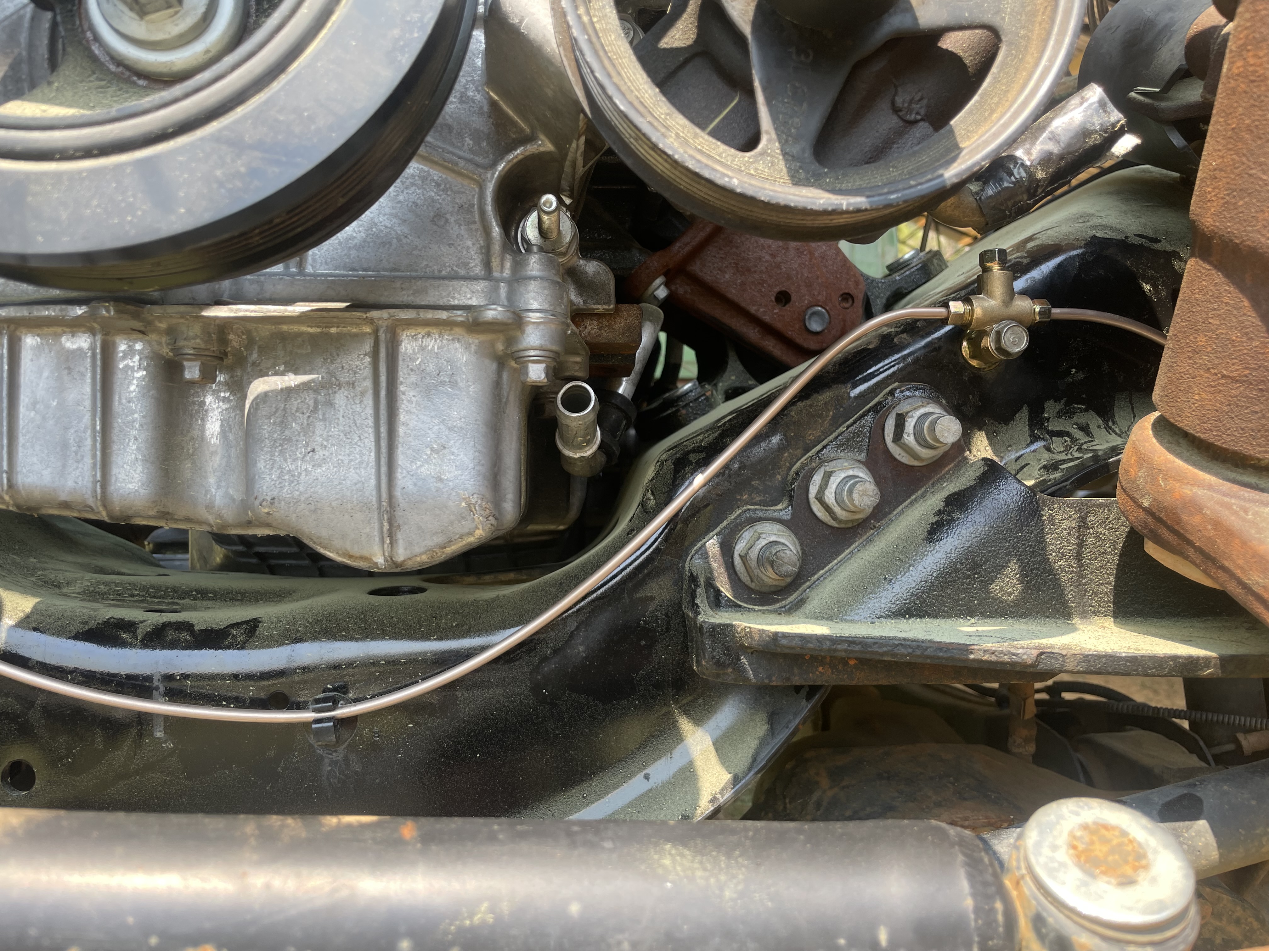

Not that much progress but made sure to take a bunch of pictures to make up for it. Also realizing I need to buy some ni-copp brake line and re-do the rear section since this frame had four wheel ABS which results in four separate brake lines needing a home where the ABS pump would go if I were keeping it. Thinking I will just tee the two rear calipers together like most older vehicles as trying to find tees for the metric Ford flare nuts is harder than you'd think. Also my flare tool refuses to make a nice inverted flare on these coated mild steel brake lines. Look at all this mess:
full
A couple of updates - hoping to keep these coming as the weather gets nicer. Got some NiCopp brake line and it's a dream. Bends and flares just like in the Youtube videos. Did the rear axle up into a tee and will be adapting to a braided stainless line since I had one left over from the Cressida's clutch deal.
full
full
Ran a line all the way up the frame as well but didn't take a photo. Was able to use all of the factory clips which is a big bonus. Also installed the fuel tank - it is gigantic but I don't think it looks too out of place. I've said it before but I think this engine will need every bit of a 33-gallon tank. Not the most elaborate setup but you're kinda limited by the bed.
full
In order to install the tank aft-axle, the spare tire mount/giant crossmember unholy amalgamation had to be removed via torch and a new piece of 1/4" plate welded in at the back to keep the frame rails square. You can't tell from the photos but the new rear crossmember-plate-thingy is beefed up with a tubing cross-section on the inside. Used factory straps, again, nothing too fancy here.
full
This side profile gives an idea how far down the tank hangs. Based on some not-so-exact measurements, it's actually higher off the ground than the spare would've been.

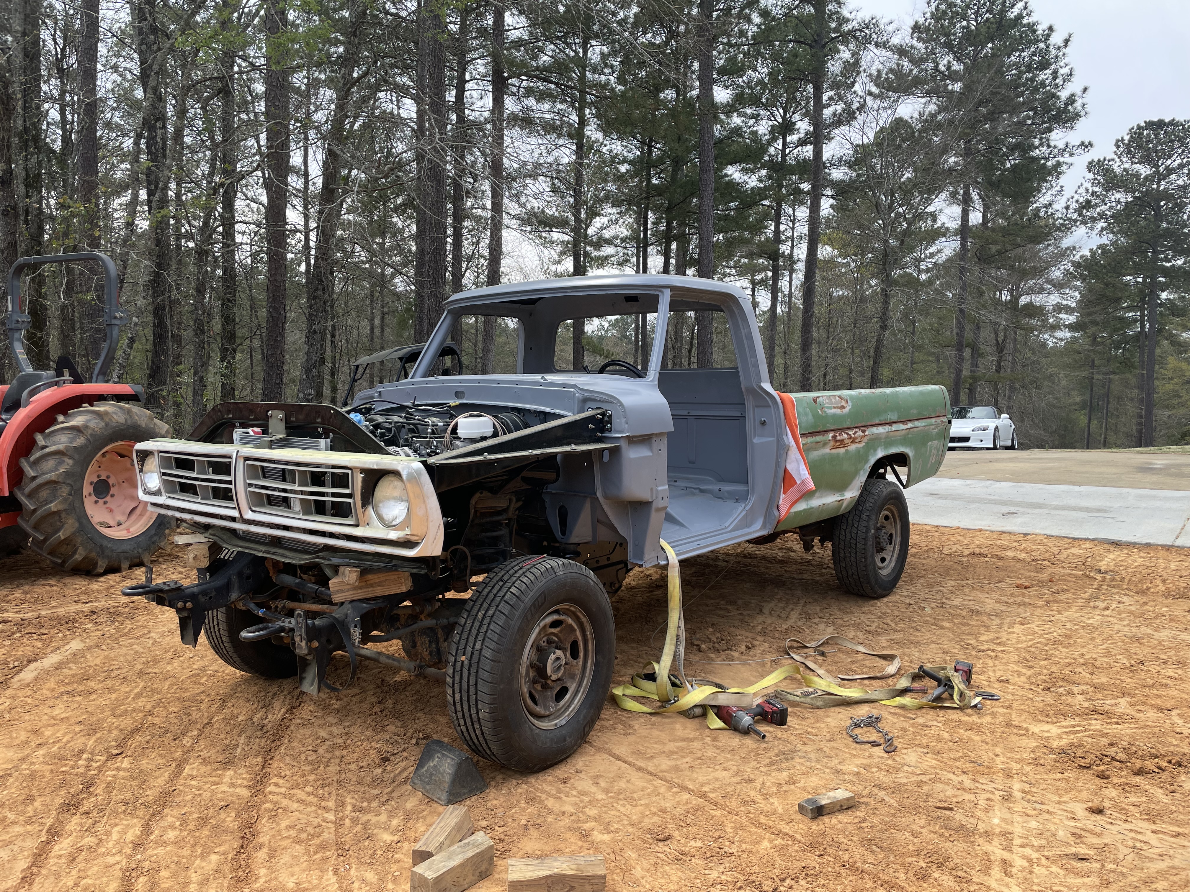

I didn't plumb to the master cylinder yet because after setting the cab on the frame with engine and trans/tcase I found a couple of issues:
1. Transfer case fouls on one of the cab braces
2. Steering shafts don't line up that great - I want to keep the factory late model lower shaft for both simplicity and safety (it's collapsable)
3. Vacuum booster is waaaay too close to the driver side valve cover
Super tech core support bushings
full
Since the engine's location is fully dictated by the existing engine crossmember (not willing to get into modifying that), my solution is to just do a 3/4" body lift. I can also take this opportunity to straighten up the passenger side as the "bump" on the bed side doesn't line up all that well with the cab. The small body lift should fix all three issues mentioned above too so I see no reason not to.

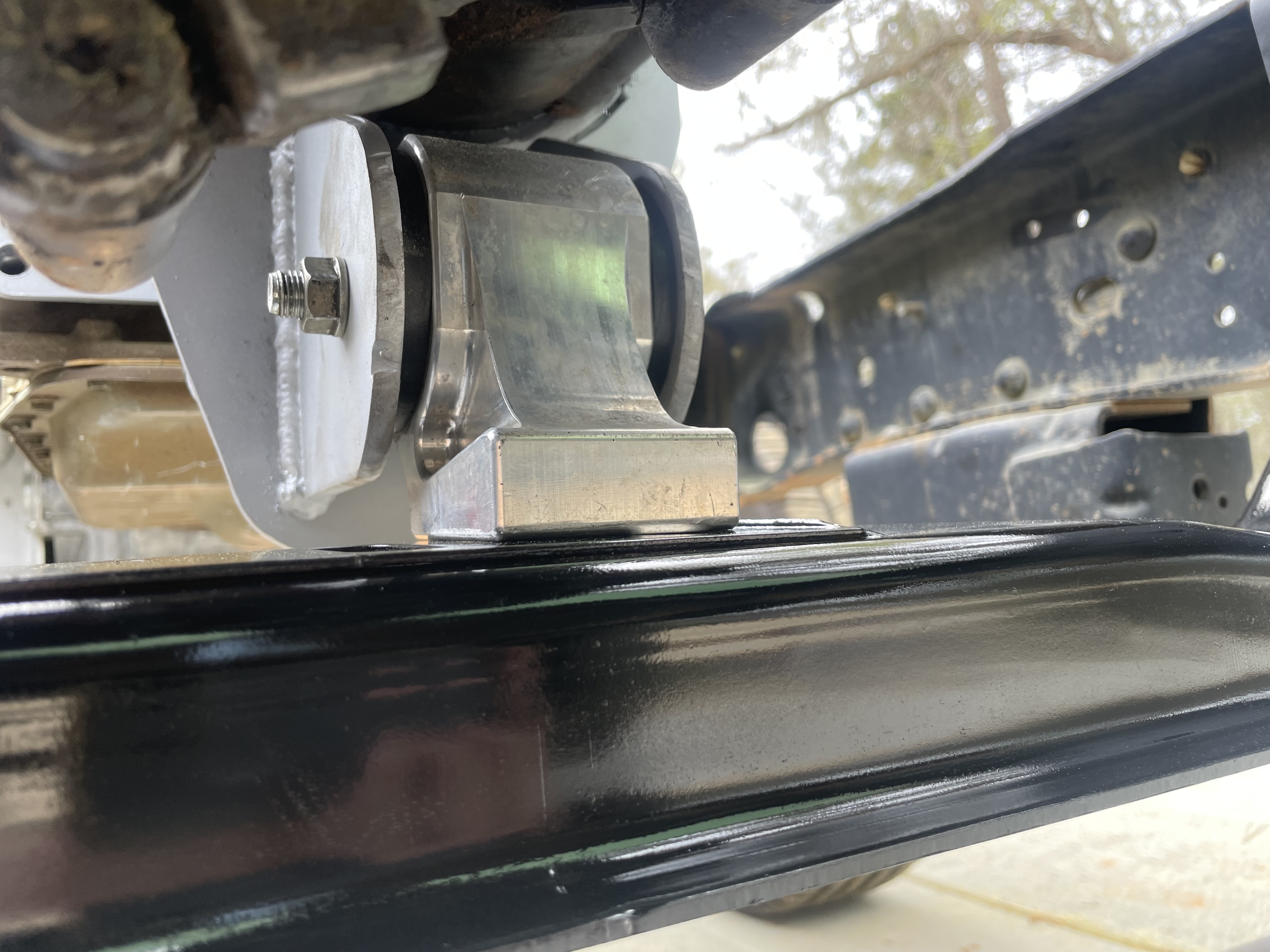

Also got a transmission mount fabbed up. Nothing too terribly fancy but I was able to use a billet engine mount left over from my S2000 swap project!
full
