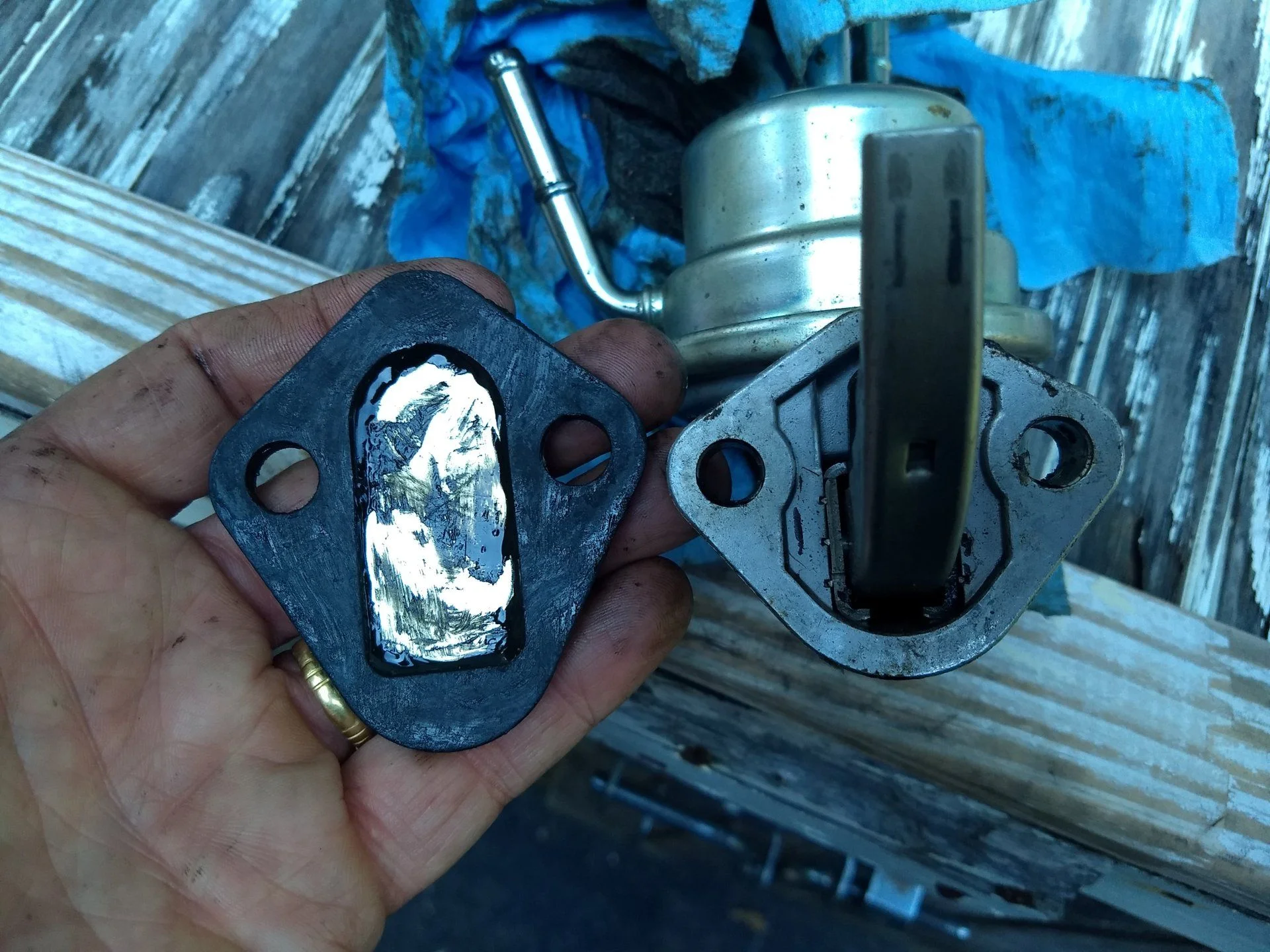

Well I figured that fuel pump block off plate issue.... the plate is different shape than the fuel pump flange and it is no doubt leaking down at the bottom where the gasket doesn't cover properly. Solved with a stock gasket on this plate. (was that mentioned earlier?)

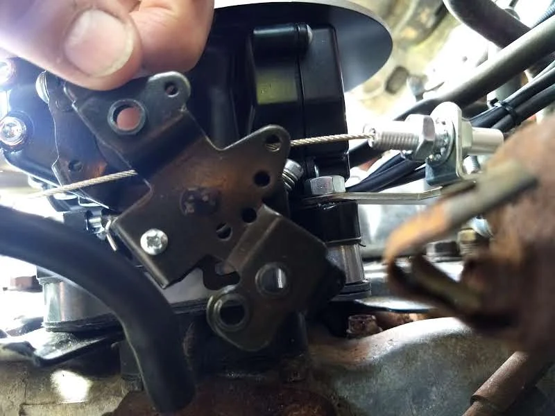

Looking for pics of how people hooked their throttle CABLE to the Sniper. I have Jim S's (formerly Downey) cable rig and it is not making sense to me.
What plate did you use? I have the manafree one with no issues.

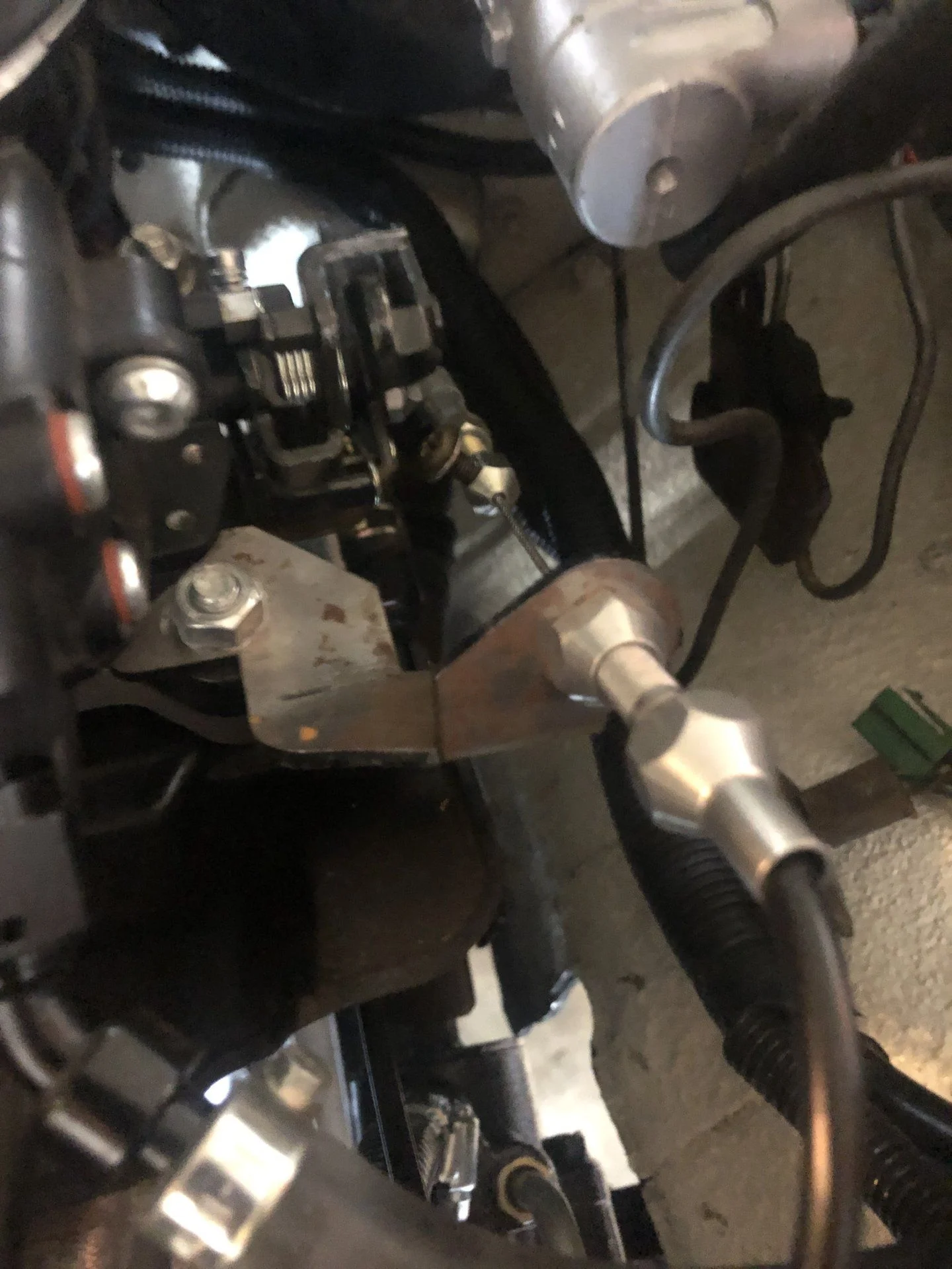

This is using a FJ40 throttle cable bracket off the edge of the sniper. Downey cable that Dustin did not use because I messed up my other cable.
How is the cable attached to the throttle lever?
What truck do you have again?
The easiest way if it’s a 60 is to use the upper mount where the hand throttle goes. It takes a small plastic grommet. SoR has them and I think @FJ60Cam has them and the carb end brackets in stock.
I meant on the Holley itself where the cable terminates.
I have the cable running through the firewall I have the bracket to hold the sheathing part of the cable I just don't have the mechanism to attach it to the throttle lever on the sniper. I got a kit from Jim of Downey fame but it is either incomplete or incorrect for this application.
@woytovich how again did you stop your leak? I have one as well at the block off plate. Not big time, but I didnt use rtv either. I'd have ran the man a fre one but they were out of stock at the time so I used one from Jegs.
The best way to seal the block off plate is to remove the fuel pump spacer, make sure the block is 100% clean of the old gasket, clean with brake cleaner, then use RTV only. Let it cure before firing the engine.
I left the spacer on as it seemed pretty well stuck to the block, I cleaned it up, used a stock gasket and it's not leaking. Oh and I used shorter bolts because the block off plate is thinner than the flange on the fuel pump was.

How do I attach the cable to this hole in the Sniper?
2015082
Use a throttle swivel clamp.
Take a look here:

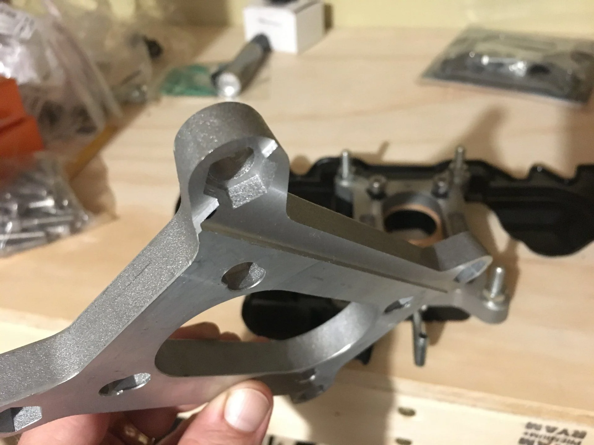

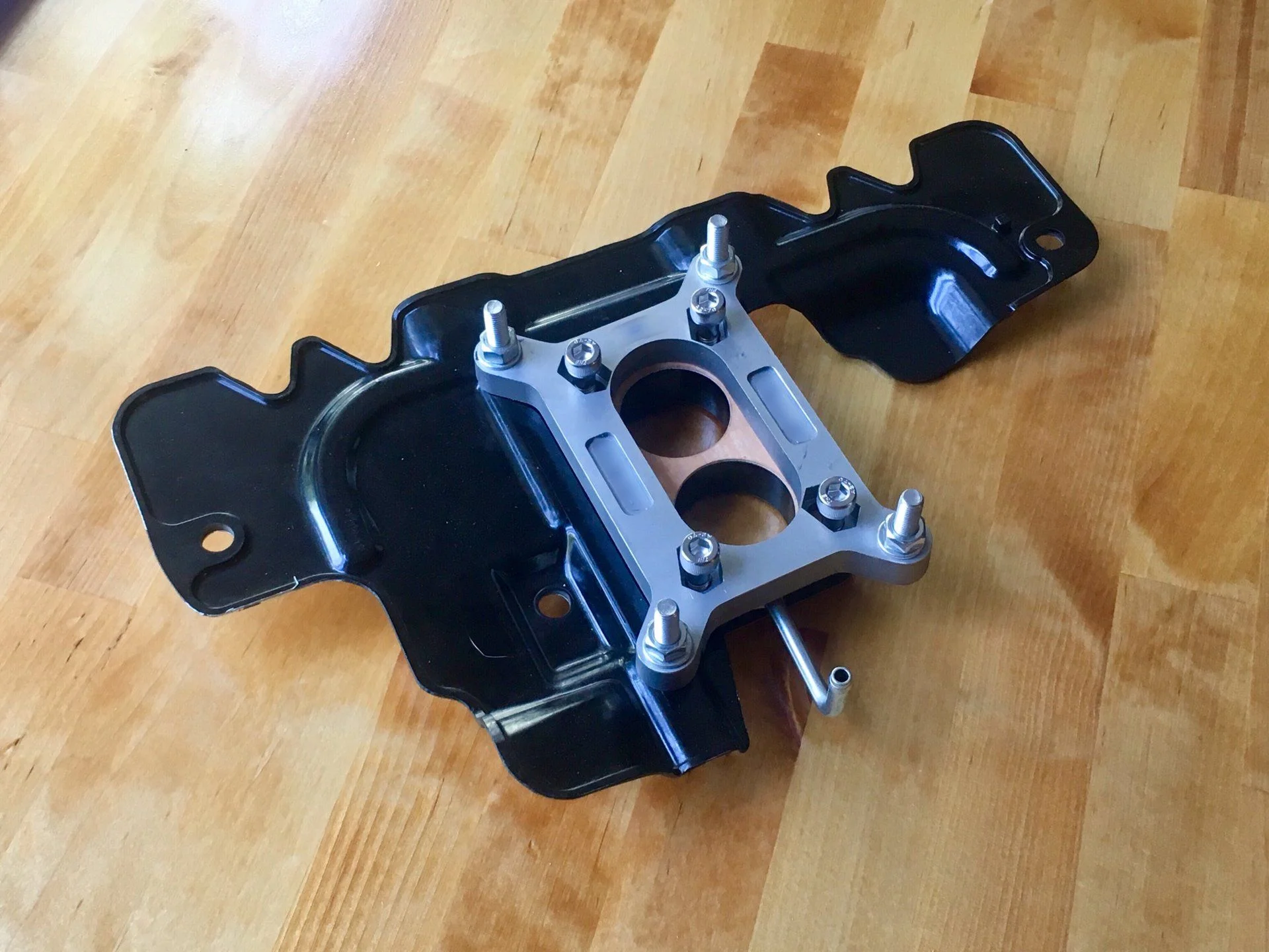

Redline cruisers are making a really nice one now, but not cheap. Downey still has some and then there is a Mr.Gasket you can use, but will need to take a dremel to it for bolt holes to work. I've seen them all work. If you haven't bought the Sniper yet @FJ60Cam is offering the most complete 2f kit I've seen for a great price with everything you need in it. He may sell just the adapter as well, check with him.

Give me a shout. We modify an inexpensive off-the-shelf adapter so that it sits on the FJ60 carb insulator, which is perfect for getting the height to clear the manifold studs and also acts as a heat shield for the Sniper computer. Comes with all mounting hardware.
I try to keep new carb insulators in stock too.
