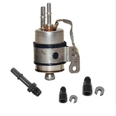

That pump looks right. Make sure you get the fittings you want for the inlet & outlet, and bracket (usually cheaper in kit form). The corvette filter replaces the big filter, so you don’t need that.
You can buy a 20’ roll of the 3/8 Earl’s Vapor Guard Hose, which seems to be the Gates Barricade but at a better price, and have some left over.
Here’s a kit with all the pieces. You can probably find the individual parts in the LS swap threads and maybe get it cheaper. Don’t forget you need AN fittings on either side of these. It starts to add up.
AN fittings to go hose to stock hard lines.... right? So 3 total?
I would run new 3/8 from the Filter/regulator to the Sniper
