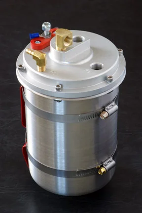

I think I'm going to go with a frame rail mounted fuel pump. Even though I bought the pump from Cam I'm not sure I have the stomach for dropping the tank and going through all that is necessary to install it in-tank.
I'm also not up for the surge tank option.

The frame mounted pumps work great. @wngrog has been running one on his AFI system with no issues for a couple years maybe. I know if several guys running them in non-Toyota rigs and have zero issues.
The in tank pump is cool now it’s done. Would I do it again... no... complete pain in the ass. The surge pump is looking like the less labor intensive setup at the moment and can’t wait to hear some feed back once everyone has some miles on them.

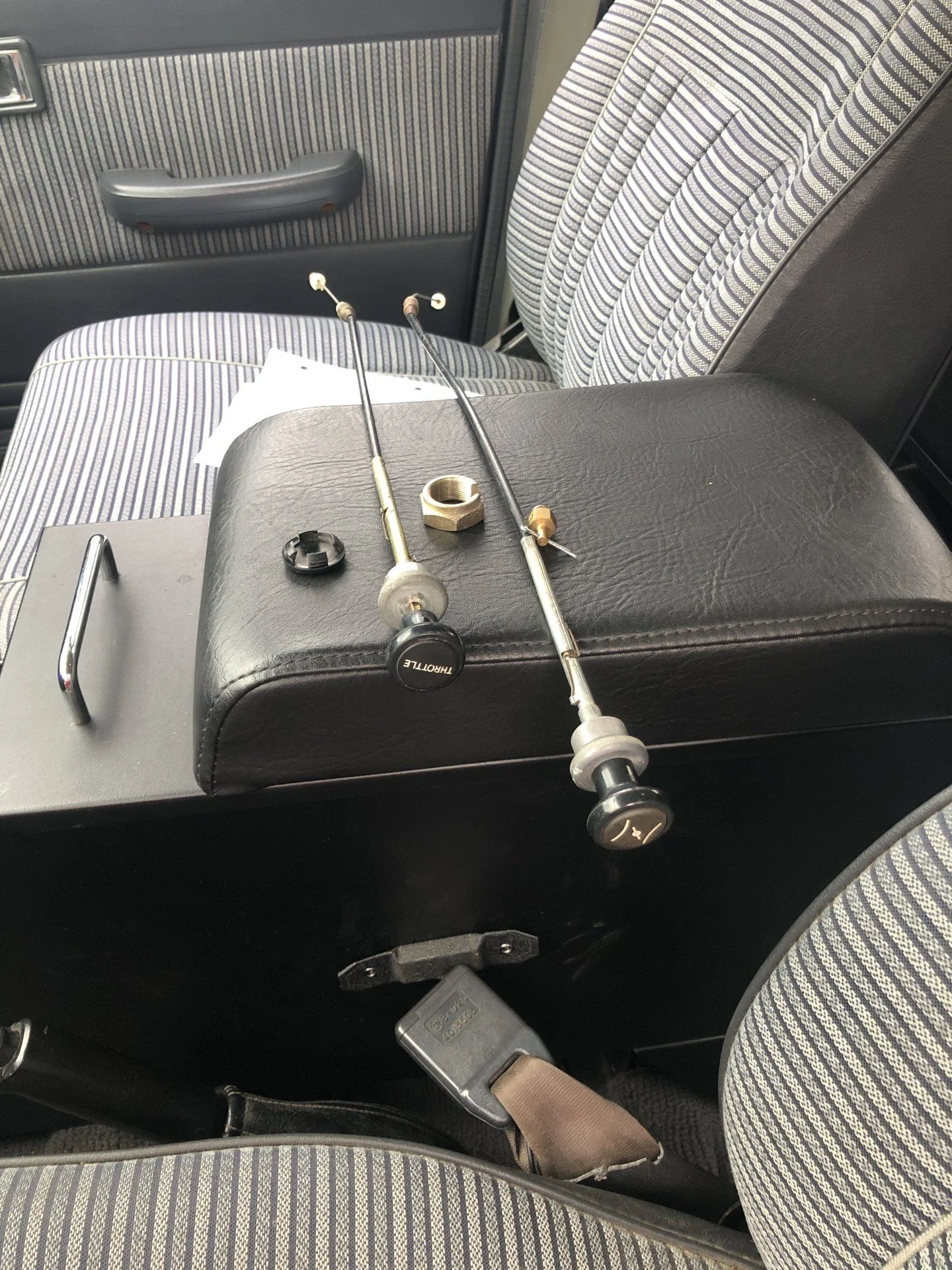

With my setup I want to run a hand throttle. I used the rod to adapt my pedal to the tbi so that left my hand throttle bracket free on my pedal. I currently have two hand throttles both different lengths. Neither are the correct length I need. I believe my pedal angle changed slightly having a rod setup. Does anyone know an easy way to extend or shorted a throttle cable?
What’s the purpose of hand throttles, if there’s no pto accessories? Or do you have other plans?
Side note no idea how to lengthen or extend. My only though would be to treat like the universal cables. Cut cable and sheath then run the little threaded barrel on the end.

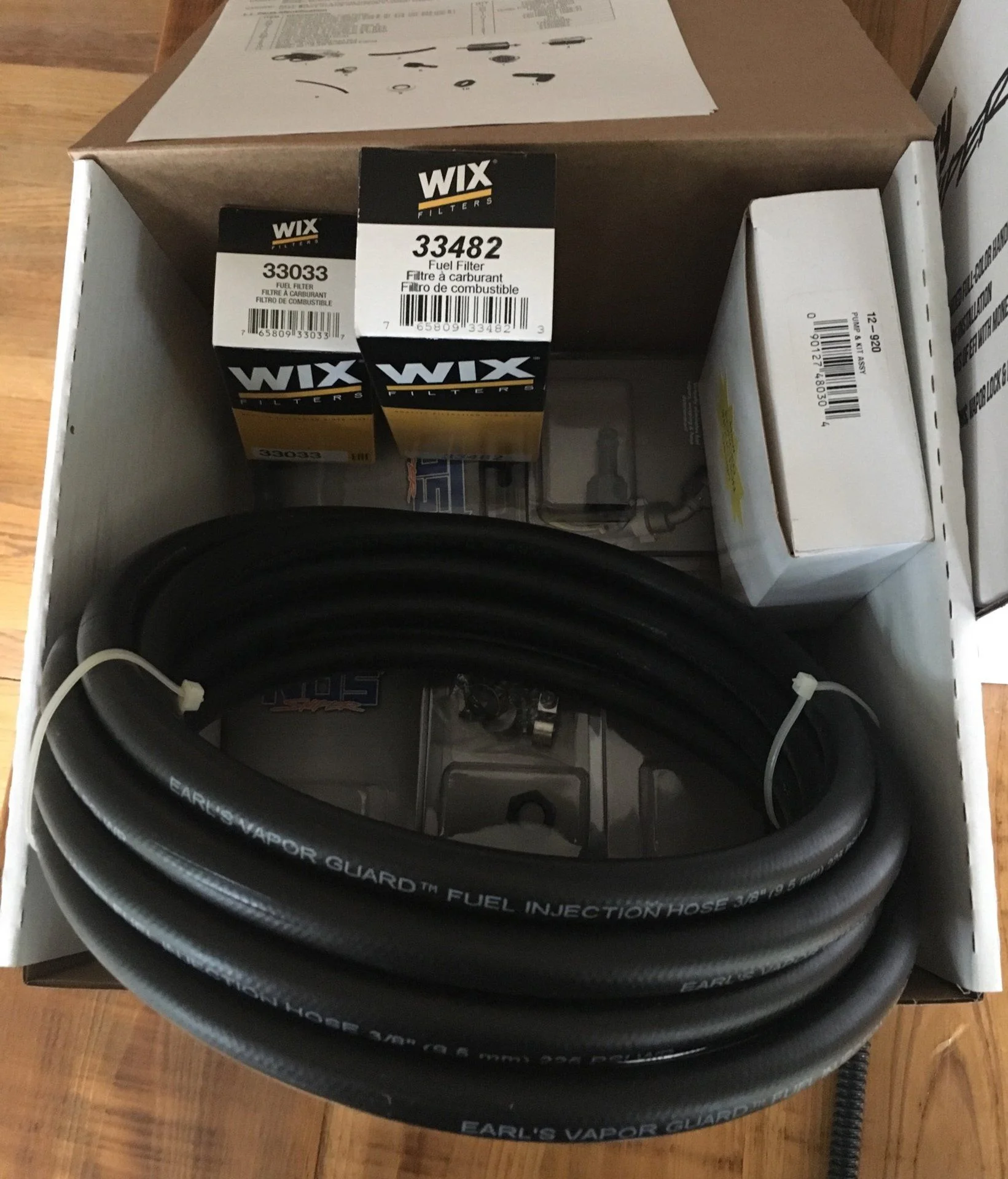

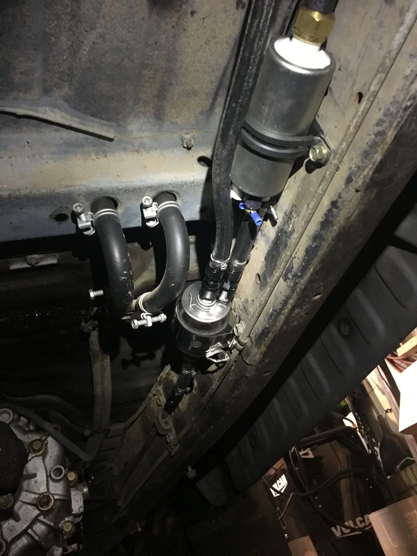

I used the external pump that came with the Sniper kit on the Delta Beast build, with great results. Runs great, pump is silent. Plumbed with all new 3/8 fuel injection hose throughout.
The 12-920 fuel kit had a Walbro pump in it, which should be this one:
I did a another install a few months later using the Sniper kit w/included fuel pump and they changed the supplied pump to an MSD branded pump.

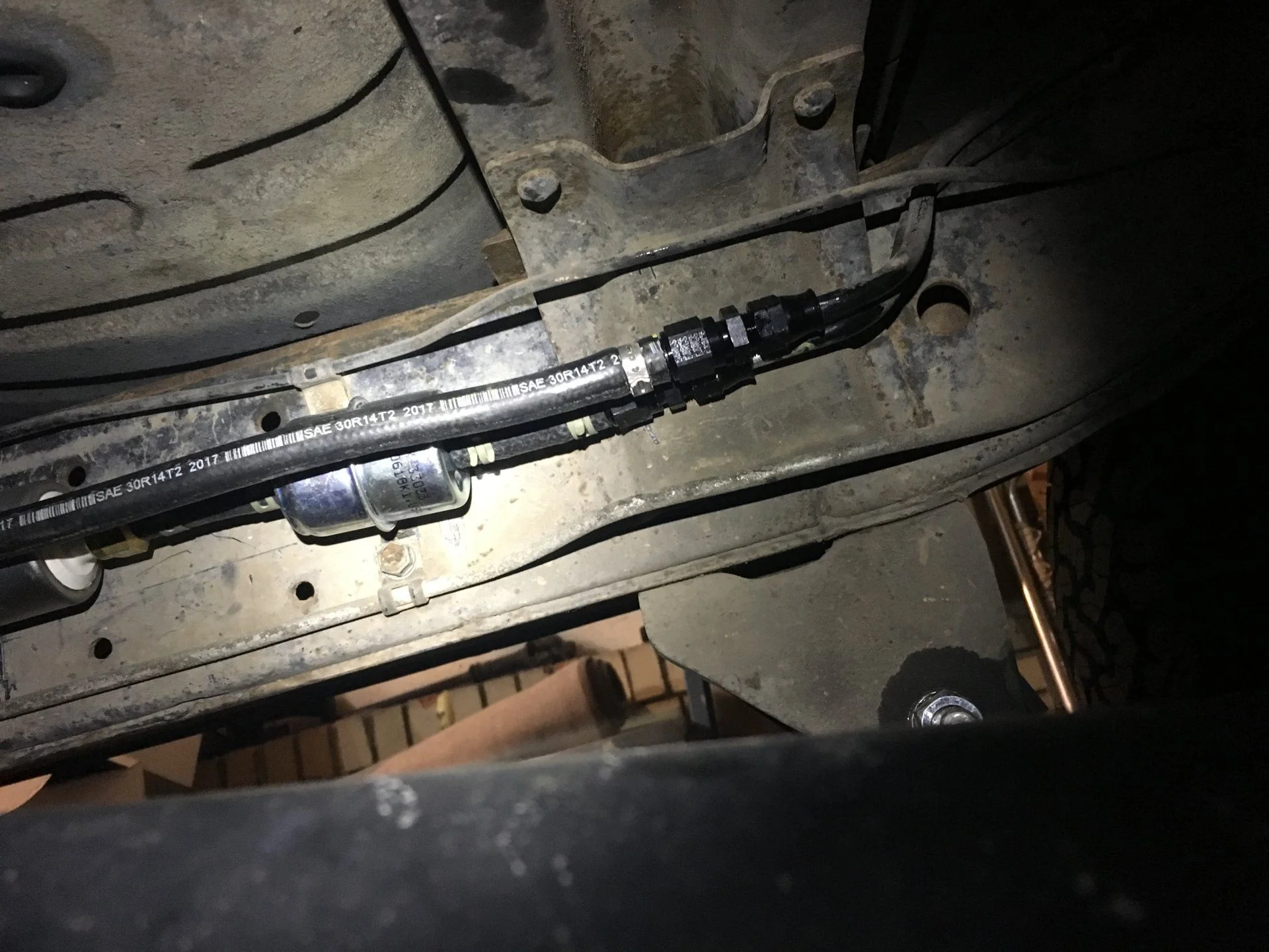

That one was plumbed into the factory FJ60 hardlines with AN compression fittings and a Corvette filter/pressure regulator which sends the return back to the tank and only a single supply line to the Sniper.
That pump was noisy. Truck ran great.

Cam: are you saying the 12-920 kit's pump is really the Walbro GSL391? If so it is $100 cheaper and comes with 6an fittings...?
If all of this is correct... what an compression fitting did you use to go from the Walbro to the factory hard lines?
Cam: is there a specific Corvette regulator/filter? I think I'm going to copy your set-up and, as always, specifics help when trying to copy!
I used the factory return line on mine with simple fuel injection clamps and fuel injection hose.
