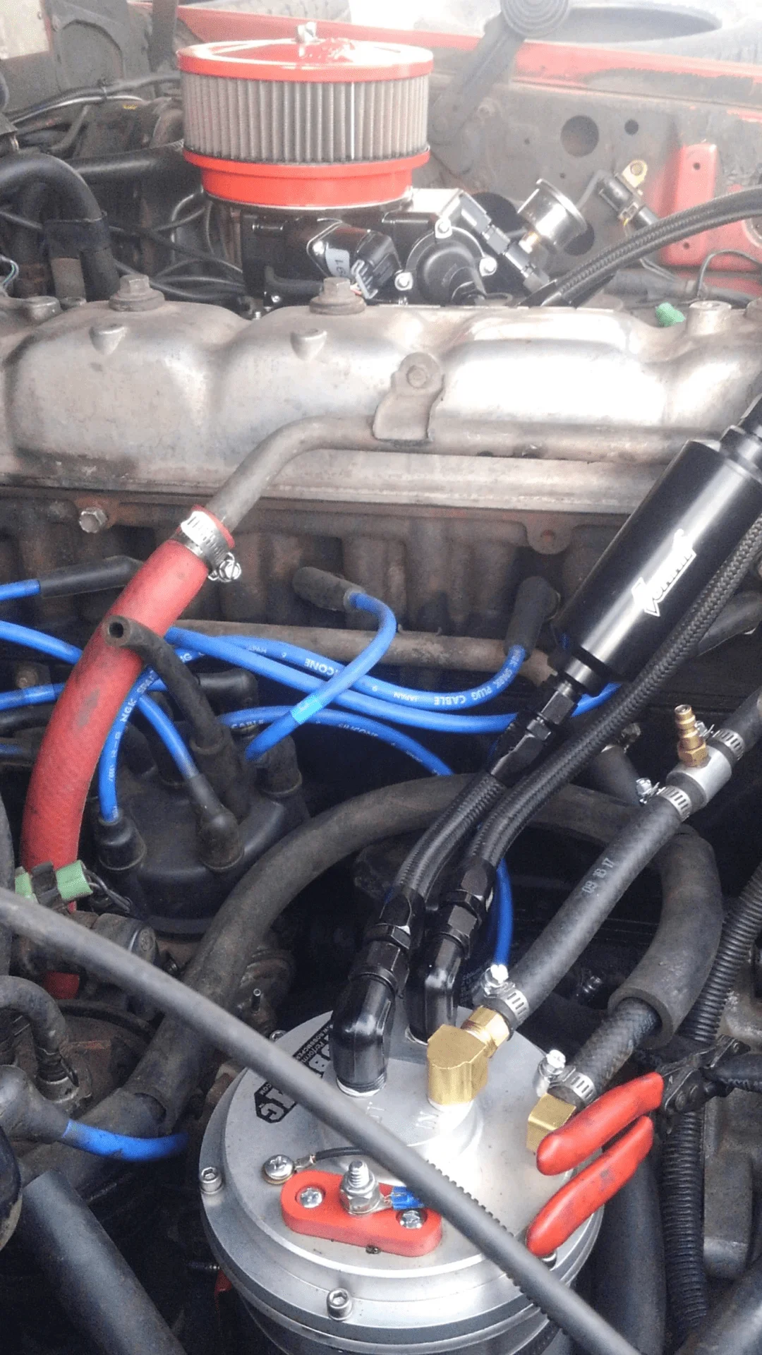

Man that is clean and I love the air cleaner setup!! how is the single fuel line running?
Runs great - I talked to an engineer at Holley about a few things and he blessed this setup with the Corvette filter.
There is a weird pulsing that you can hear in the hard line that is bolted to the firewall. Not yet sure if it is from the pump that came with the master kit (not using that one any more, I don’t like the one theybstarted sending) or is some kind of feedback from the injectors.
Long story, but this truck needs a new fuel tank before we can swap parts to find out (was previously drained & flushed, but still producing rust).
There is a weird pulsing that you can hear in the hard line that is bolted to the firewall. Not yet sure if it is from the pump that came with the master kit (not using that one any more, I don’t like the one they started sending) or is some kind of feedback from the injectors.
Can't wait till you get it all worked out! Sounds like it is time for a long range tank for with an in tank pump the 60. That air cleaner makes it super clean under there.
