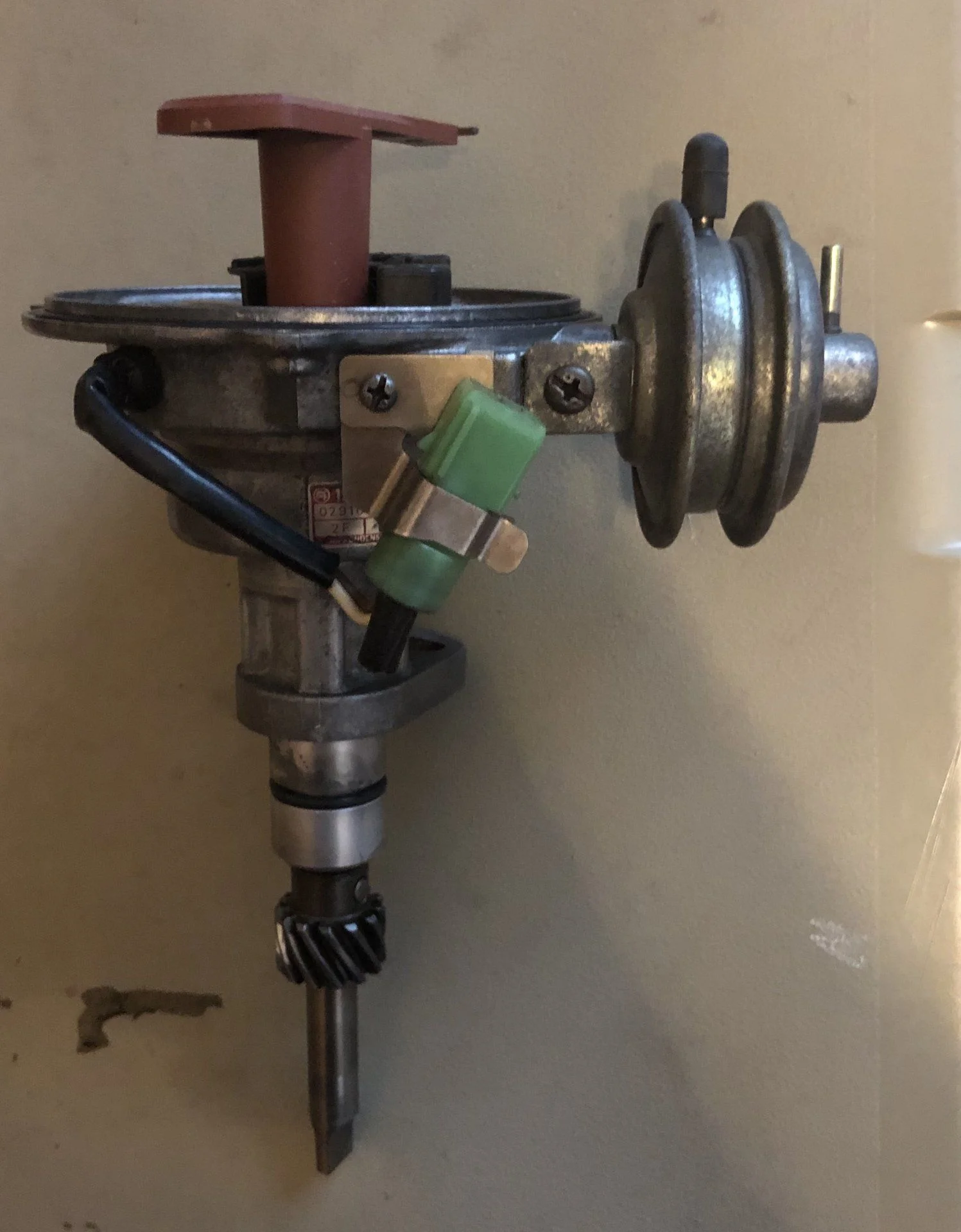

Hopefully I can get this stabbed this morning before I head out of town for work. A fresh recurved dizzy from @FJ40Jim
