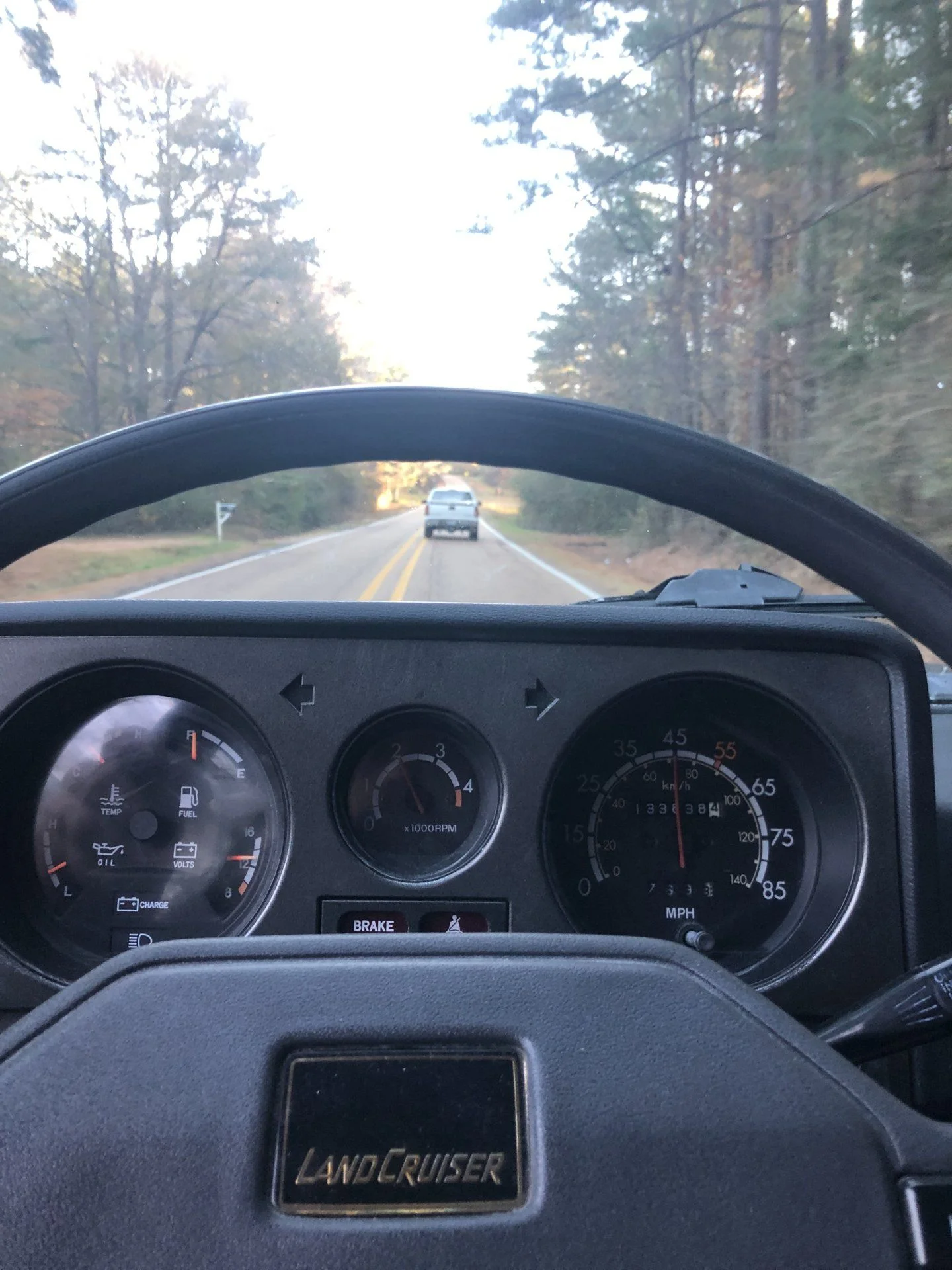

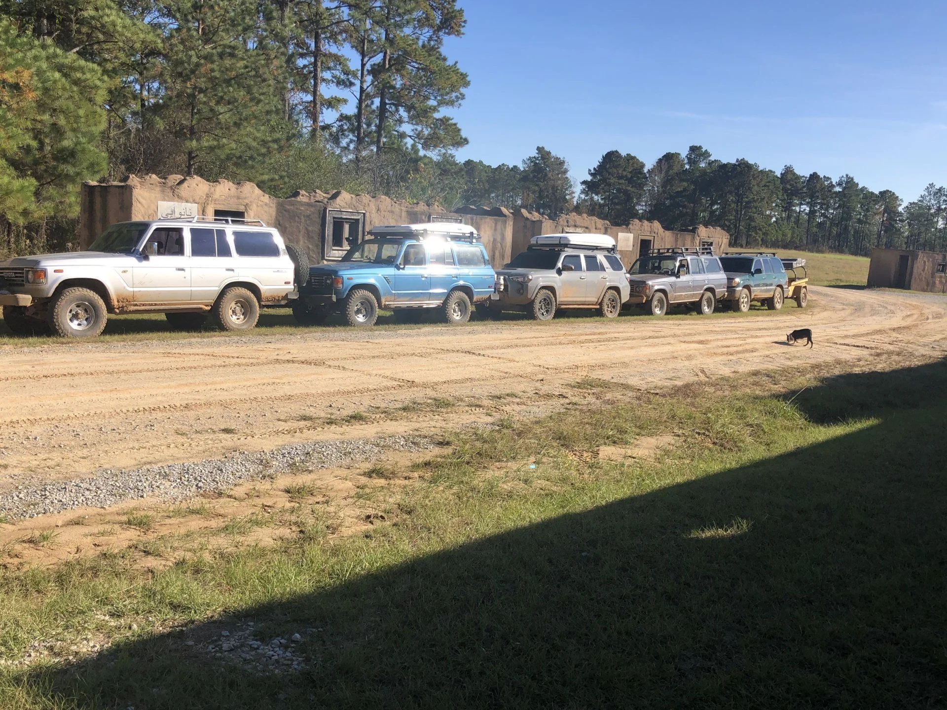

Put about 350 miles on the 60 on a day trip Sunday. Holley ran great. The running is really settling in. My Jimc recurved dizzy is showing up today. Will report when I get it on if it makes a difference.
That looks like fun. I'd even take the mud over the BS trails in Texas.
You need to go out and find em. There are some epic backroads in Texas.
