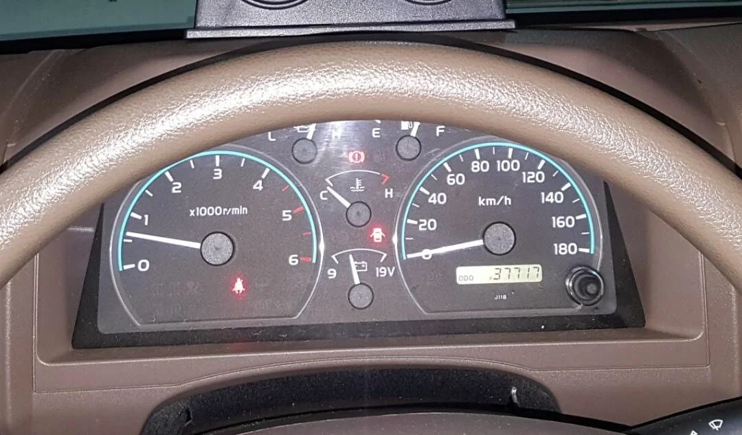

Just for posterity and documenting purposes, two great friends of mine (@Gun Runner 5 and @omarluis) sent me pictures of their tachometers on a factory 1HZ equipped 70-series (HZJ77 and HZJ76). The 1HZ redlines at 4500 rpm as shown on the photos below:
I will keep in mind that anything above 4500 rpm is not good :)

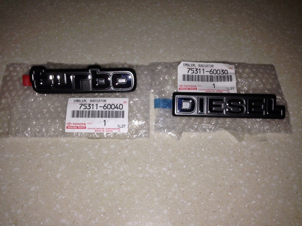

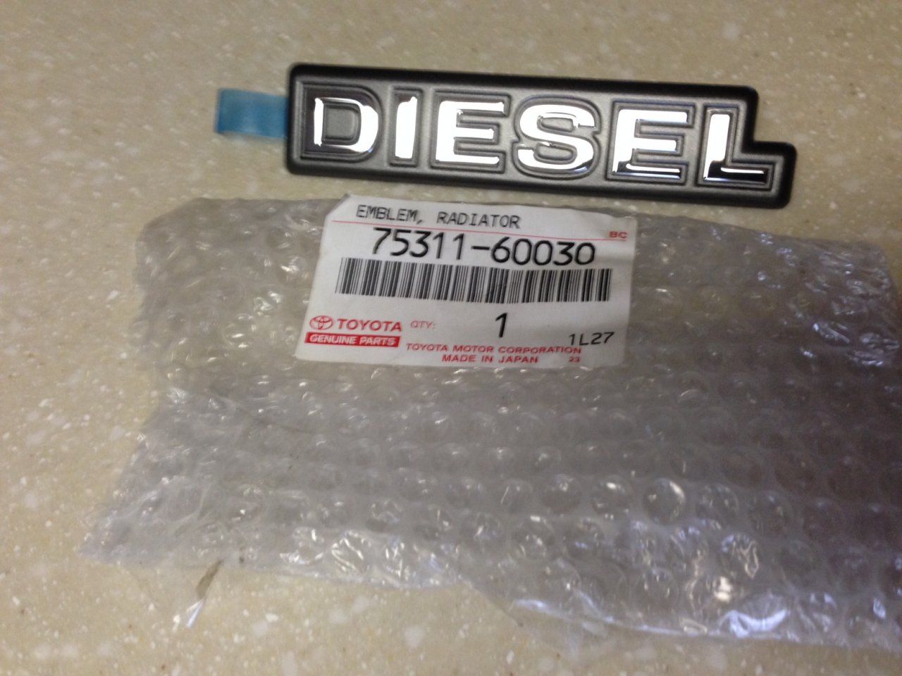

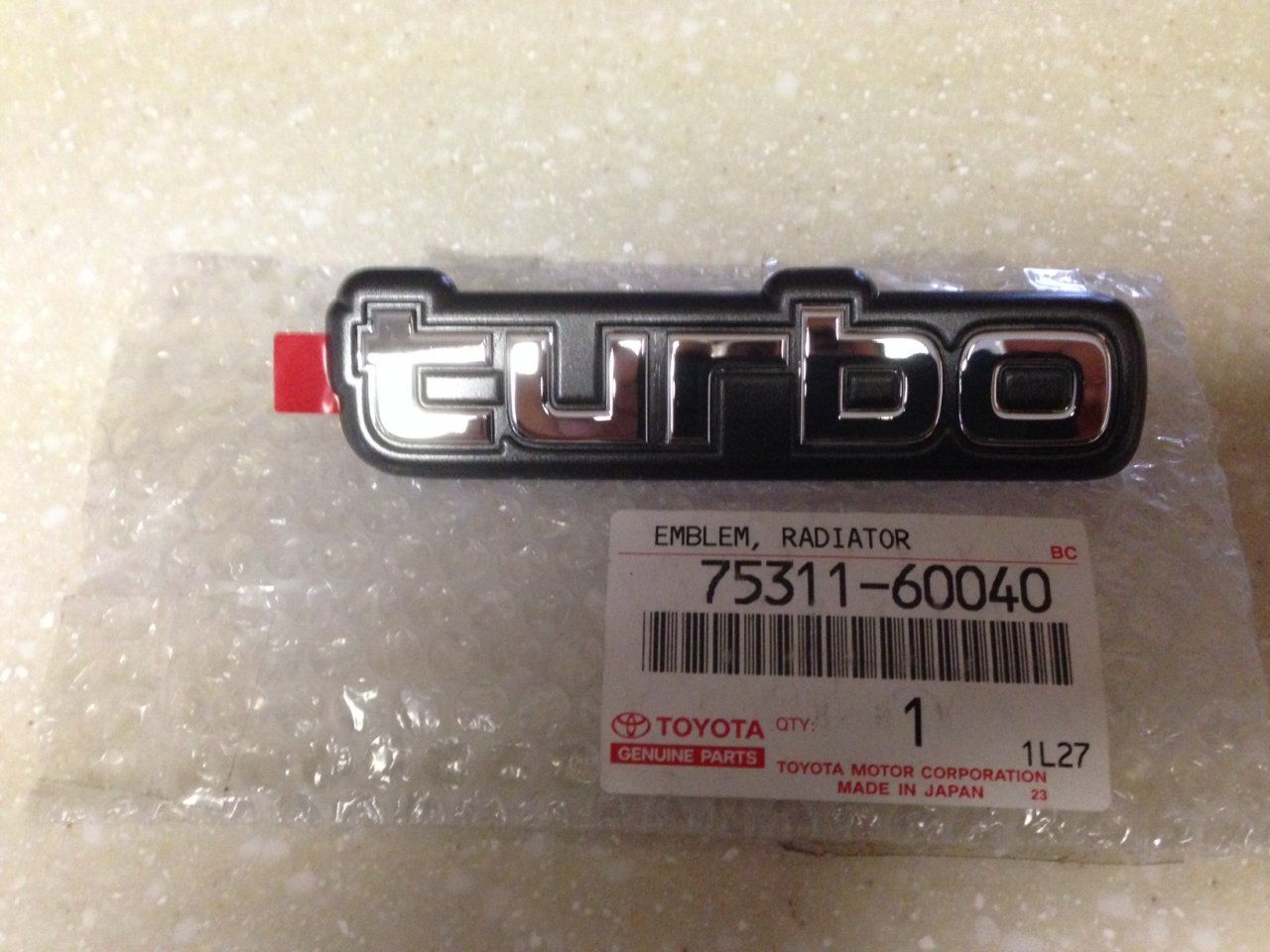

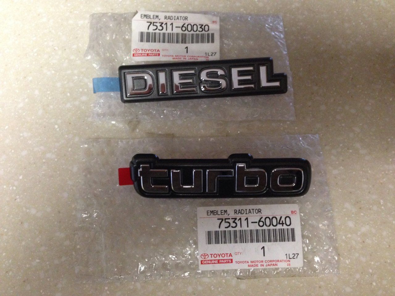

Thought I would post this here as well, but for those wanting/needing a Toyota Turbo or Diesel emblem, I recently purchased a set from Cruiserparts and they came in the mail yesterday. I paid about $20 each and they are really nice. They are plastic-made and have two little non-threaded prongs in the back to align it properly. They also come with emblem tape already on the back.
Here are the part numbers for both and maybe Onur @beno or Dan @cruiserdan might still be able to source them through the regular Toyota channels:

hello Alberto can you sell me the diesel emblem part: 75311-60030?
Thanks! :cheers:

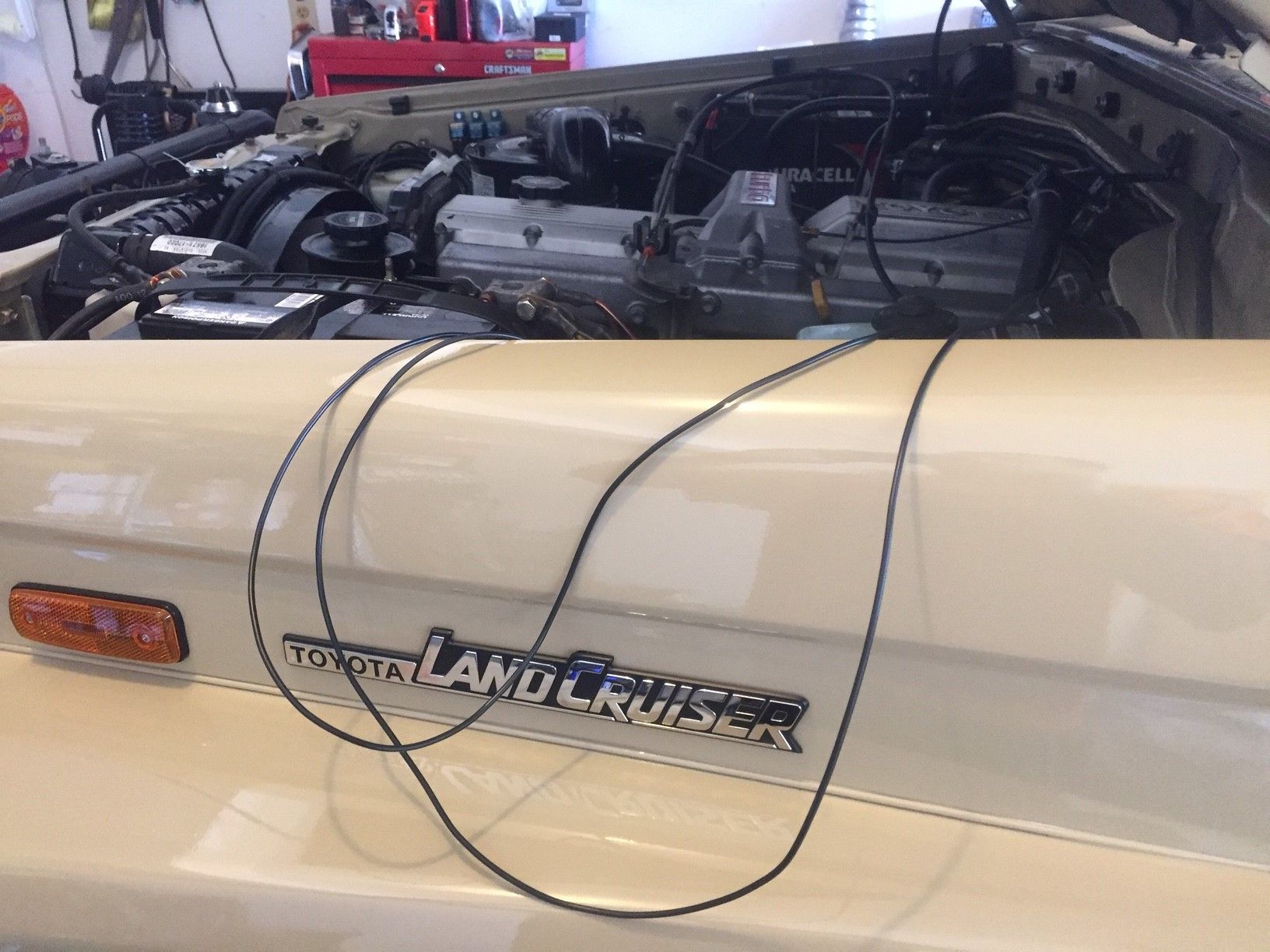

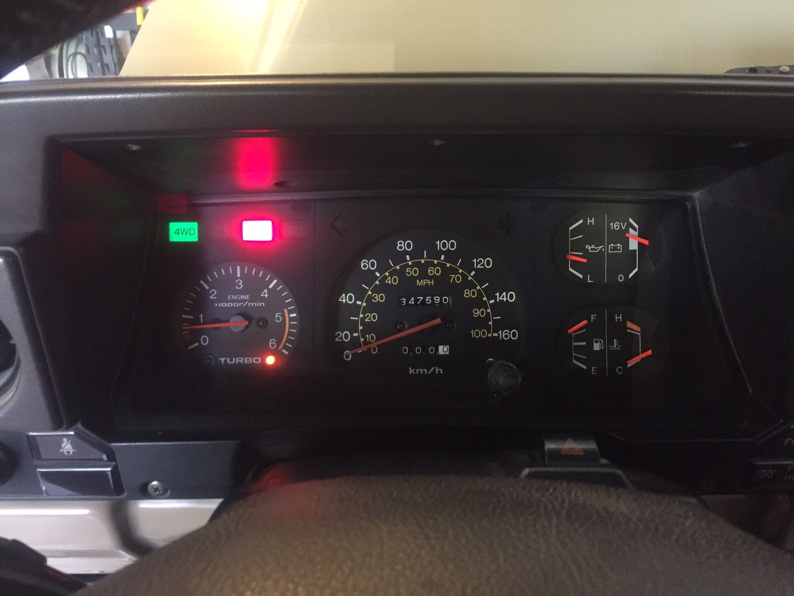

I ran two wires from the 1HZ injection pump Tach sensor to the old bell-housing plug on the BJ70 wiring harness, I ran these wires quick and dirty to see if it would work just that simple and sure enough, it came to life!
I then cleaned the wires and ran them along the factory wire loom. The amber light next to the Turbo word stays on all the time. I know that Chris ran into the same thing, but it really doesn't bother me much. I don't have the boost and overboost sensors, so those lights will not be connected anyways.
