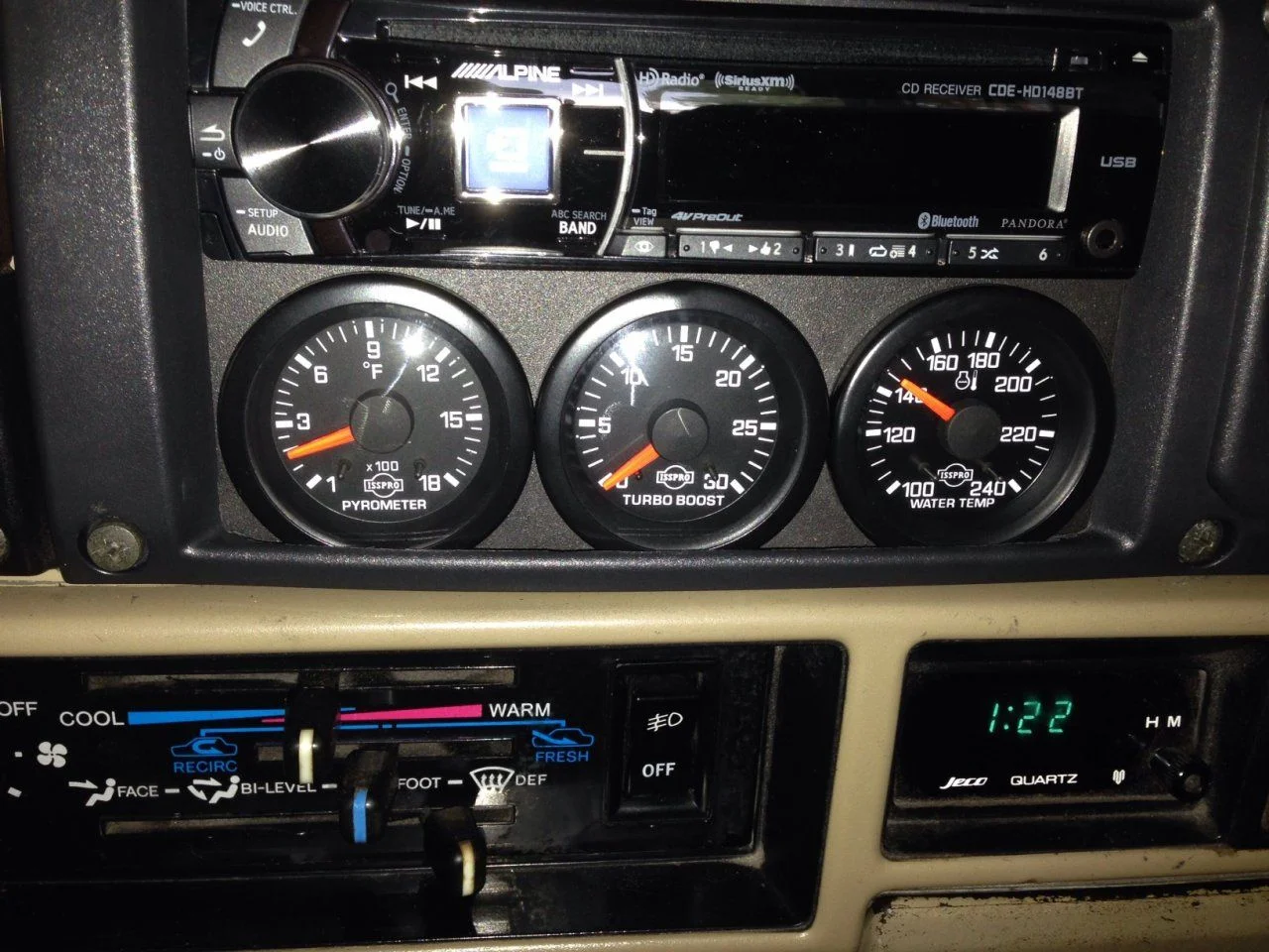

I know it has been a long while since I have posted anything here. Life and work got in the way of my Land Cruiser fun.
I guess that I never posted a photo with all the gauges done and working so here they are. The switches shown on the first photo is what I will use as indicator lights for the engagement of the cable-lockers. I wish I could find a 12V Tachometer with the proper indicator lights, but these ones will do the job. The truck was just idling on the second photo, hence the cold readings.

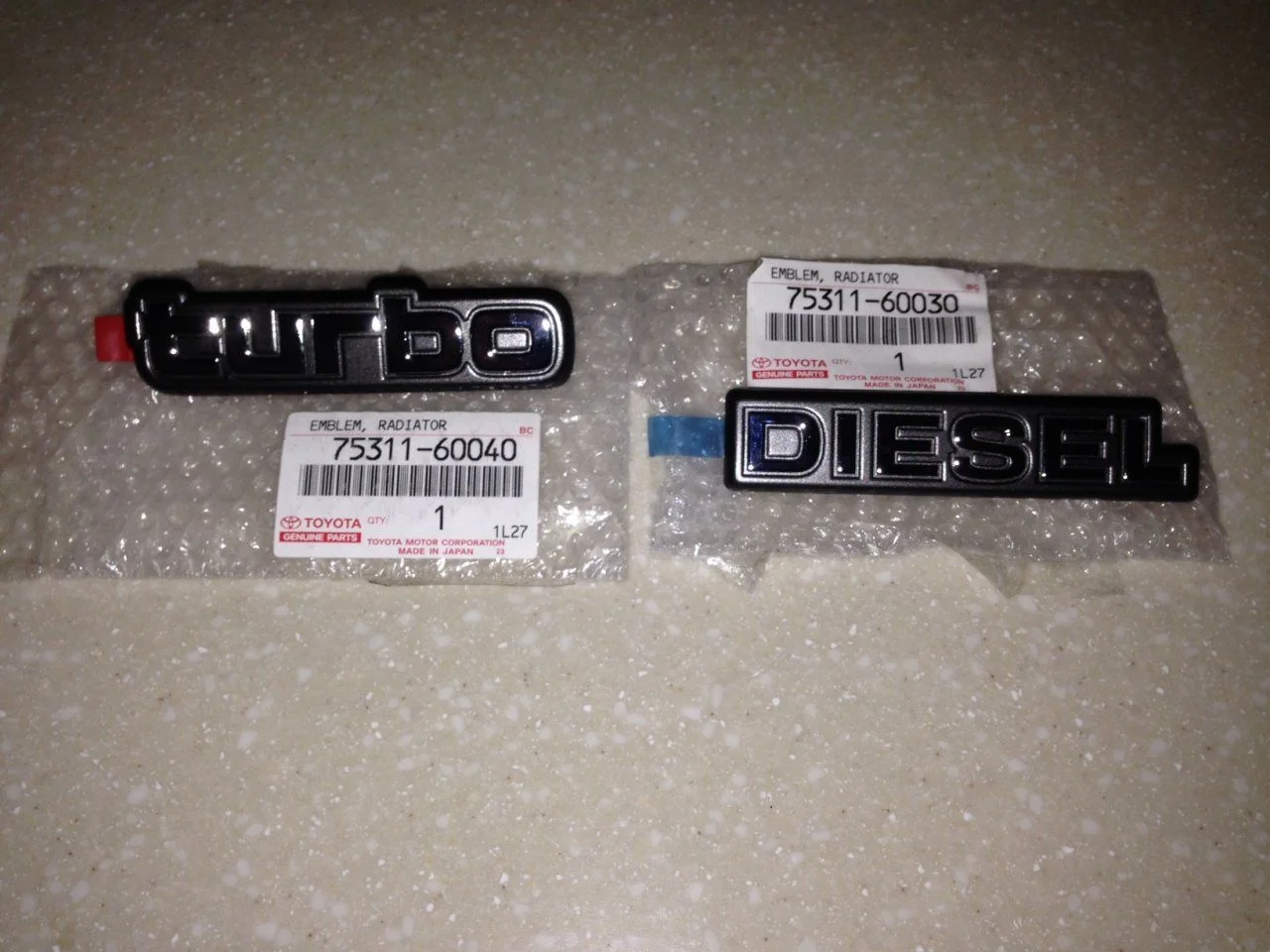

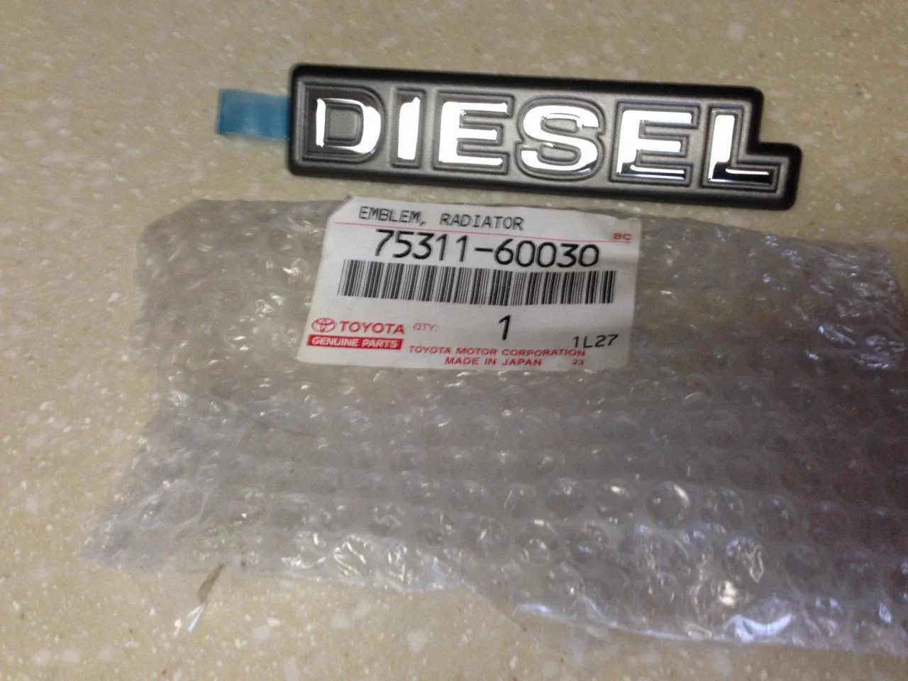

Thought I would post this here as well, but for those wanting/needing a Toyota Turbo or Diesel emblem, I recently purchased a set from Cruiserparts and they came in the mail yesterday. I paid about $20 each and they are really nice. They are plastic-made and have two little non-threaded prongs in the back to align it properly. They also come with emblem tape already on the back.
Here are the part numbers for both and maybe Onur @beno or Dan @cruiserdan might still be able to source them through the regular Toyota channels:

Those numbers are not live in this market.
CruiserAddiction (Akella)
75311-60030 valid number $16.65 USD (no stock at present)
75311-60040 valid number $16.31 USD (no stock at present)

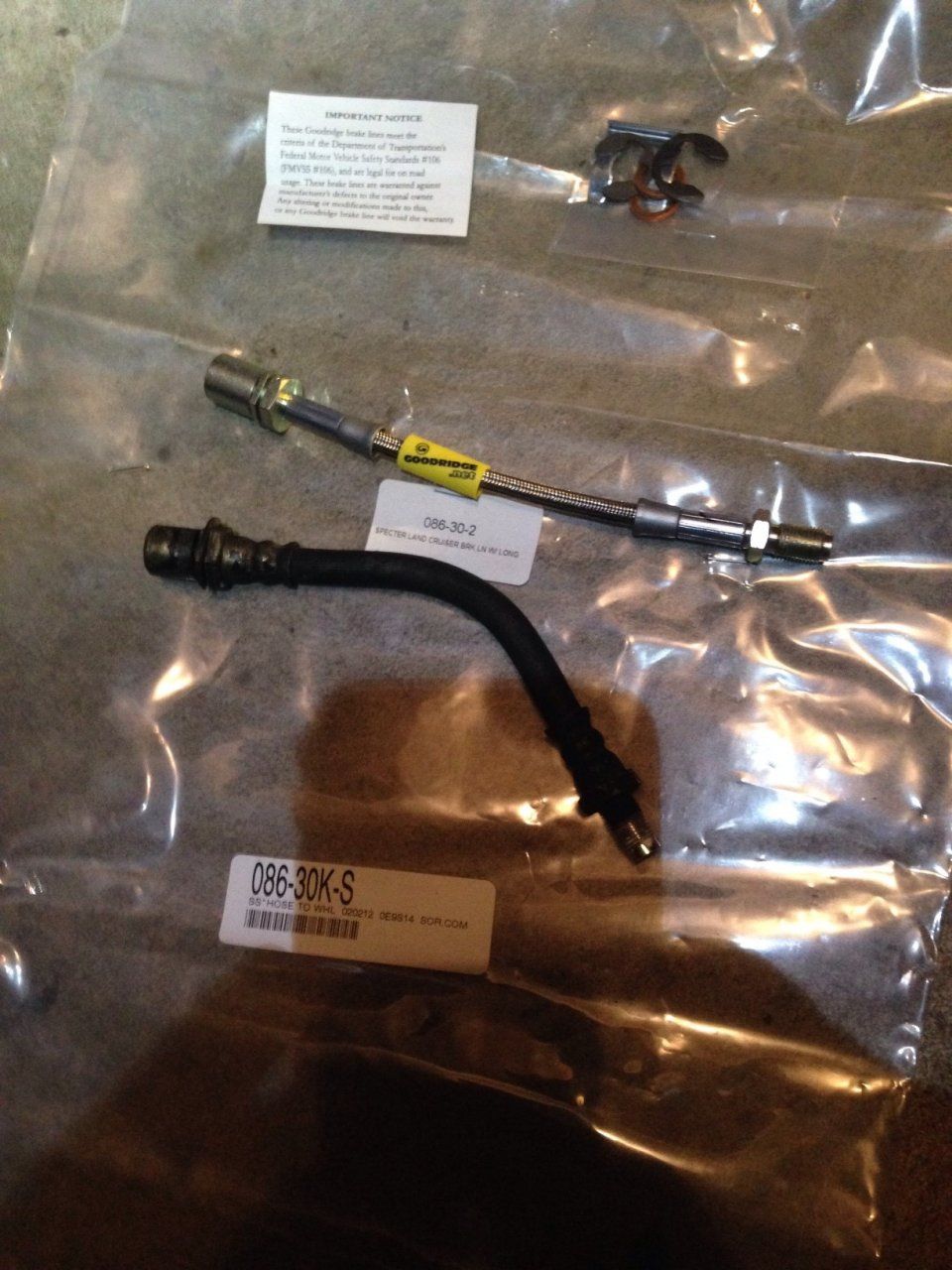

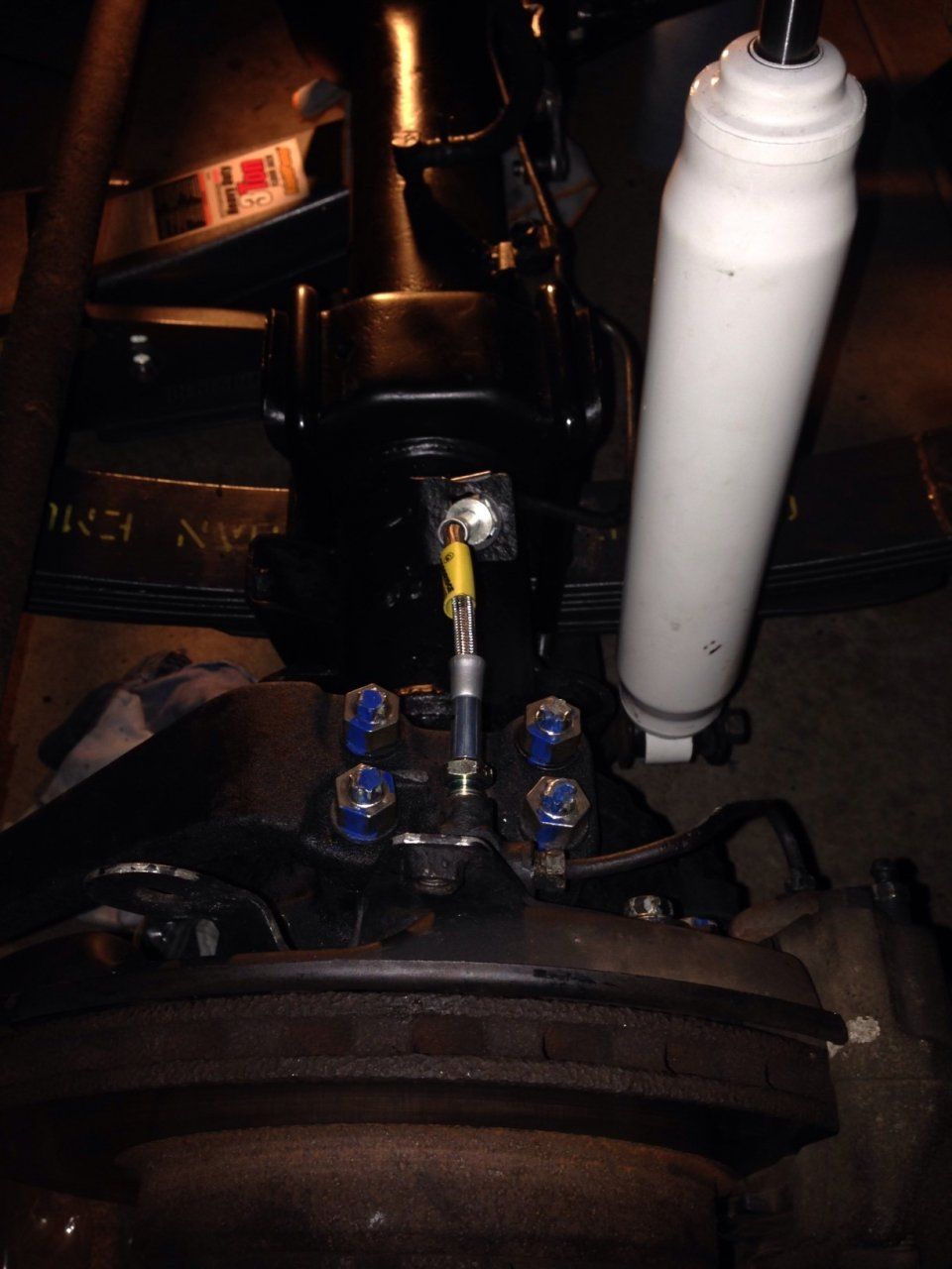

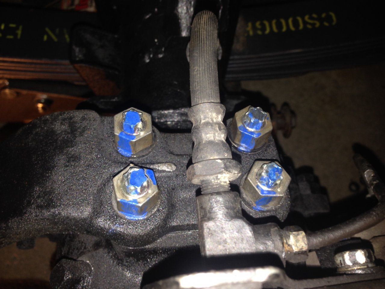

Replaced the rubber house from axle housing to dust shield with a SS one from SOR
Hey, I am trying to find SS brake line replacements for my deteriorating front caliper hoses on my 1988 BJ74 and my search turned up this thread. After searching that part # on SOR.com it says this in the description:
"Stainless Steel Braided Front Brake Line To Wheel-
7 1/2 inches long-Fits 8/80-1/90 FJ60 & FJ62-Depending on application, this hose is longer than stock-For Stainless Steel Braided Brake Hose Kit see #086-30KA-KIT"
Would that fit my vehicle or do I need 086-30ka-kit? Or, maybe that kit is just with the same lines + the rear too? (which could probably use replacing as well)
Thanks for the info!
-Nick
Hey Nick @Delirium,
The little hose from axle housing to dust-shield is listed on the www.sor.com as part number 086-30K-S "Stainless Steel Braided Front Line to Wheel" as you have mentioned. This is what you will need to replace a single caliper rubber hose (not sure if they come in sets of two).
The brake parts on the early 70-series (including your BJ74) are much of the same (not to say identical) to the same vintage year 60/62 series. The 086-30KA-KIT that you mentioned is the one I bought and it comes with all the hoses you need to replace your brake-rubber hoses with stainless steel lines. Four (4) SS hoses are included in that kit:
- Two (2) that go from the axle housing to the dust shields (short pieces, one per side)
- One (1) that goes from the frame fitting to the front axle
- One (1) that goes from the frame fitting to the rear axle
The two hoses from the frame to the axles are longer than factory so you can use them if you put any sort of lift on your truck. That was the main reason why I bought the kit.
Hope this helps!
-Alberto
Ok, cool - that is exactly what I needed to know and I really appreciate the info! I'll just order that kit then. Thanks Alberto.
