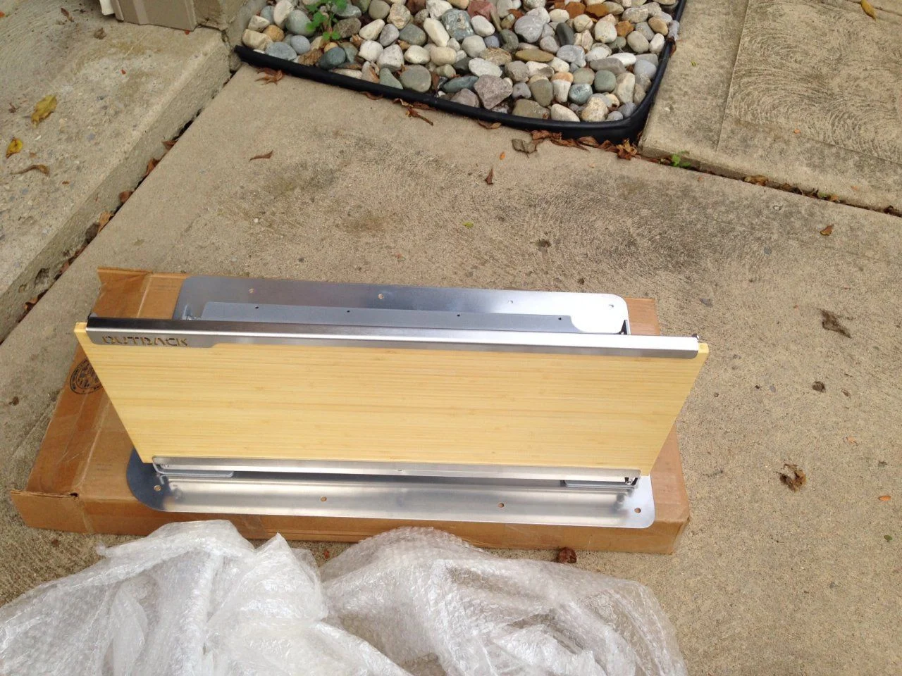

I have always wanted to add a table (or horizontal workspace) to the rear doors of the 70. Here is a photo of the table set-up on Omar's @omarluis FZJ71 in Venezuela:
Despite the fact that you could buy one ready to use, and that it has openings to store additional items on the unused cavities of the door, I wasn't completely sold with the style or construction of the ones offered in Venezuela. They seem to be made with plywood wrapped with door panel fabric. It is functional, and it works, just not what I had in mind for mine.
I started looking at different options and I came across the build that Expeditions 7 @cruiseroutfit on a couple of VDJ78 to drive the vehicles through several countries around the world:
http://expeditionportal.com/expeditions-7-modifying-a-vehicle-to-drive-around-the-world/
I noted a very nice an clean table set-up that seemed to be made of stainless steel with some sort of cutting board, too. After reading a little bit on the Expedition Portal site, I saw that some of the work was done at Adventure Trailers and browsed their website for more photos:
http://adventuretrailers.com/e7/
Some photos from Expedition Portal and Adventure Trailer's website:
From what I could tell, they have built aluminum or Stainless Steel door panels to replace the factory cardboard panels, and then attached the table set-up to this metal panel. I was not sure if the table was sourced locally (in the U.S.) or outside of the country.
I then stumbled over this thread on Expedition Portal Forum that talks (with some level of detail) about the different tables offered in the U.S.:
http://www.expeditionportal.com/forum/threads/77277-JK-Tailgate-Tables-The-lowdown
The thread was very informative and it talked about the price and surface space on the different available options. I then noticed that the one used on the Expeditions 7 vehicle was the Adventure Trailers Trailgater Table for a Jeep JK. I started looking at where to buy such table and the cheapest place I found was a store called Rebel Off-Road and it had free shipping, too. The guys at Rebel Off-Road were great to deal with (there is also a small YouTube video on their website on how simple and useful this table set-up is):
http://www.rebeloffroad.com/product-p/jktrailgater.htm
I also called Adventure Trailers (AT) to see if, by any chance, they had made a template of the door panels that they used on the Expeditions 7 (E7) VDJ78 vehicles. I talked to Martyn Davies over AT about what I wanted and he mentioned that the panels of the E7 vehicles were made of Aluminum, but sadly, they didn't make a template out of them. However, he said that if I sent him my original door panels, they could easily replicate them and sell me a set. Martyn was great to deal with and very responsive to all my questions. I sent Martyn my door panels and a few days later I got aluminum panels made from AT. Martyn kept my original door panels in case they were asked by other 70 series owners to build more of these. Get in touch with Martyn if you want some of these panels made.
Since Greg has returned the E7 trucks to Utah at the conclusion of the trip and they are museun pieces now, perhaps I couild get my hands on one of the tables......:hmm:
Who am I kidding?
I claim no intellectual ownership of this, but I wanted to document what they used as I think it is very nice, clean, and very useful (in case anybody else wants to use the same set-up).
First, remove the factory door panels:
Then, install the nutserts provided by Adventure Trailers:
There was some additional trimming to the corners of the panels and increasing the fastener hole size to make them fit, but nothing major to be honest:
6mm nutserts?
And then prepare for the table install. I measured (with the door panel off), about 2" from the top of the panel to the top of the table. These located the two center holes on a little ridge that the door has on it. The two top center fasteners have nutserts that go into the door itself, the others, have nutserts attached directly to the aluminum panel, as the holes lined up with open spaces of the door structure (hope this makes sense).
6mm nutserts?
Hi Dan,
Sadly, the bolts and nutserts used were not metric :confused:.
Adventure Trailers provided Stainless Steel (SS) hardware and the nutserts to go with them, but they were 1/4-20 (non-metric). I bought a nutsert tool, extra nutserts, and extra SS bolts as I wanted to use the same bolts and nutserts for the table and door panels. The table comes with some plastic inserts and self-tapping stainless steel screws that would work for a 5-minute install on a Jeep JK. I didn't use any of the hardware provided with the table as it is a "custom" work :)
