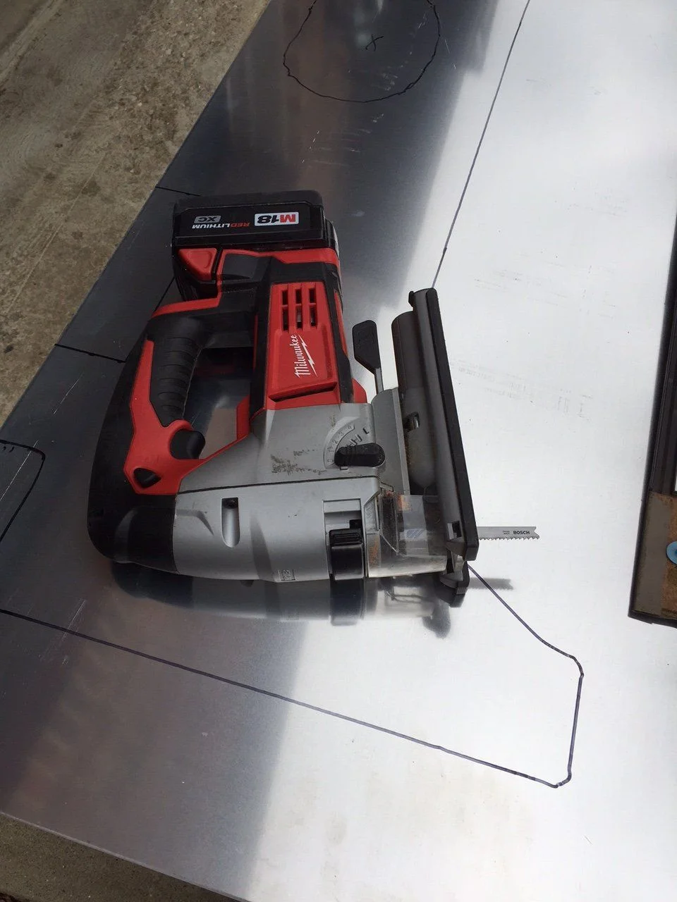

The rear side panels were partially broken from holding the weight of a 6x9 speaker on a thin piece of cardboard. Also, I want to mount additional items to the side panels (power outlets and auxiliary reading lights). To follow the aluminum theme I used on the rear doors, well, aluiminum seemed to be the material of choice :)
I bought a 4' x 4' piece of aluminum from the local steel metal supplier and used a Jig Saw to shape the panels.
