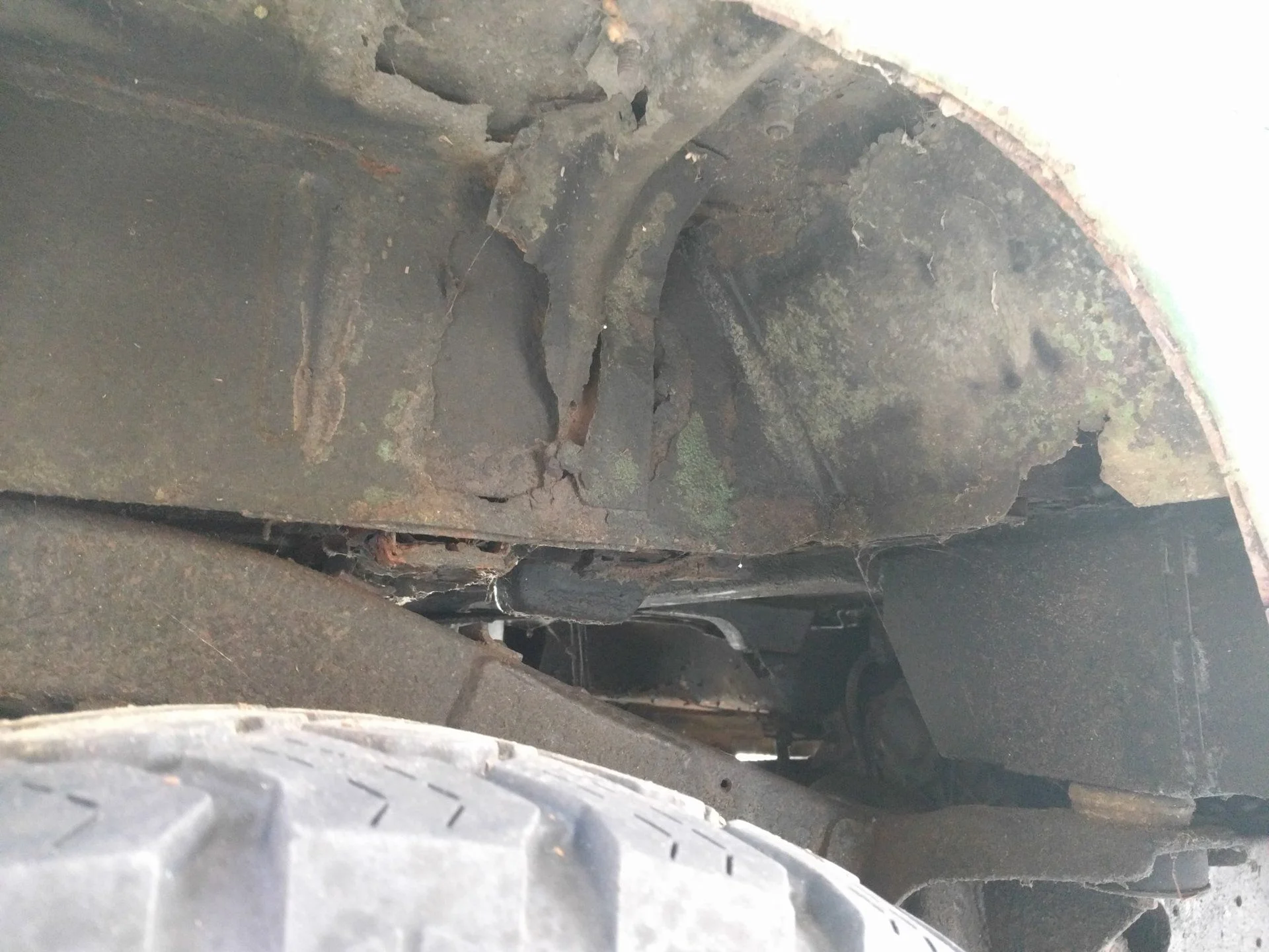

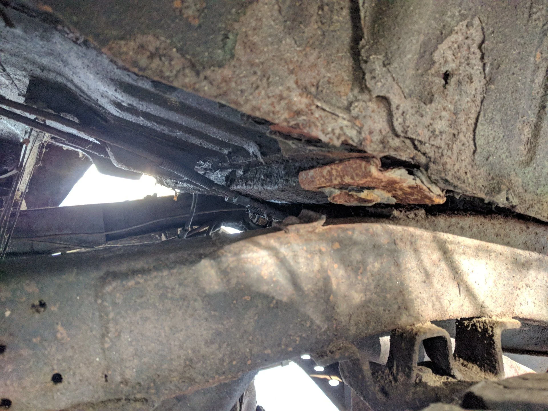

I am currently looking at purchasing a stock 1982 FJ40 for $3500. When I looked the car over I was surprised at how rust free the frame was, however there was a couple of spots on the frame that stood out to me as abnormal.
1) The steel body mounts where the rear of the body rests appear to be broken or cut off for some reason (as seen in picture). I’m not sure how these could be gone given how thick the steel is that they are made out of. They are broken like this on both sides of the frame. Has anyone seen anything like this before? Also, is there anywhere that these pieces can be purchased as they only appear to be riveted on?
2) There appears to be a section of 1/4” plate steel welded onto on the frame just forward of the rear axle on both sides of the frame for some reason (as seen in pictures). I looked at it as best as I could and didn’t see any cracks, or rust through the frame, but I can’t think of any reason for this other than those other than structural integrity?

It's possible that a PO has had the rear part of the frame replaced since, like my '82, they become like used tissue paper back there. I don't know where Northborough is, but if it's in the North East, the end of the frame should be rotted out.

I hadn’t even thought about the rear part of the frame being replaced. I’ll look at it closer when I check it out next. The rear end of the frame isn’t rotted out at all! That’s why I’m so suspicious 😂. Thank you for the response!

The frame usually rots along the bottom inner channel near the rear spring front perches and at the very rear of the frame rails and spring gussets. The PO didn’t weld those plates on because he was bored. Look at the inside of the frame rails. And, is that a weld bead I see on the frame rail just above the plates? Perhaps a butt weld that was then reinforced with the plate?
Check those areas and report back. But even if the frame is good, that looks like a parts truck just from those few photos.

Edit: good god. I just got a better look at the inner “frame rail” in the second pic. The frame is toast and has been poorly patched back together.
So I looked closer at the pictures that I have and it appears that Billmc is correct. I can see a bead of weld on both sides of the frame that wwould indicate that the rear section had been cut off and replaced. I didn't even notice that. Thank you Bill.

It needs at least a frame and a tub. It needs a lot more than bodywork. It’s a parts truck and a bad one at that.
I would never encourage somebody to try to restore something with a bad frame and a bad tub when there are plenty of solid trucks to start from. It just doesn’t make sense.

I suspect you’re insinuating that I haven’t seen enough to make an informed decision. The frame is gone! And the few pics of the tub show huge holes and the front floors are gone. I suppose the aprons are probably still solid. They don’t rust too often.
Who would intentionally restore a car with a bad frame when they don’t have to? It’s not the last FJ40 left on earth and there’s no emotional attachment to this one. It doesn’t need to be saved to carry on the species. When most people restore cars that shouldn’t be restored it’s because they’re emotionally attached or because they got screwed over and didn’t know what they were looking at when they bought the car.

the need to replace the rear part of the frame because of it being wasted, the rest of it is suspect, around the rear of the front hangers and all along the middle section, my guess is the inner box will be an issue.
